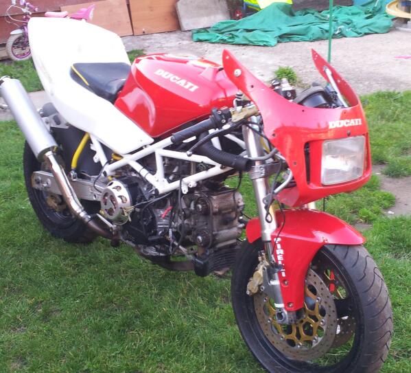

    Seat unit cut for rear light clearance and fitted.
    Steve b

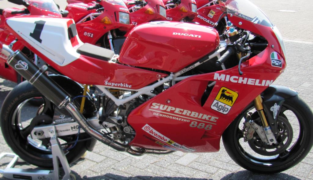

    1993 white frame, silver on gold decals is on a pic above.

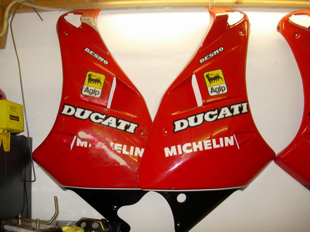

  5. More good news!
    My contact in holland Rudy has found me the rubber air ducts, 888 sp3 fairing lowers, battery box and all fairing mount brackets also a 888/851 front subframe as the one i have is the wrong one.
    Fairings need a tidy and paint, but now i have everything to complete :biggrin:

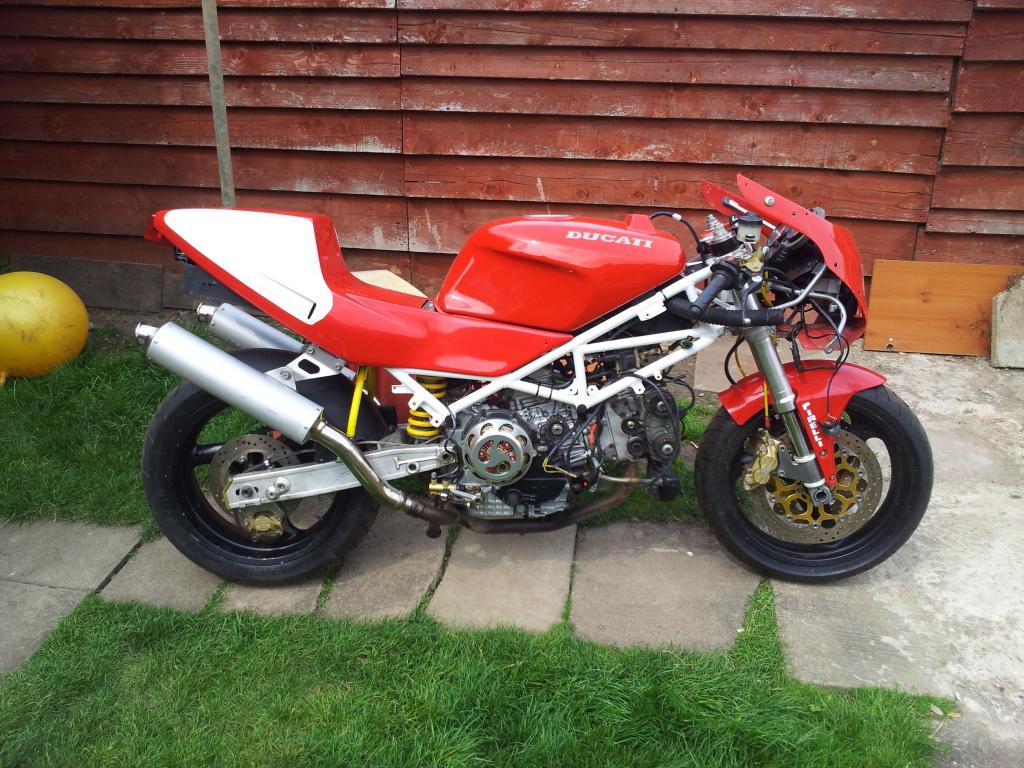

    Painted seat unit!
    A couple of runs in the clear coat to sand out then polish.
    I tested the gold pin stripe with a coat of clear and it started to pickle.. Shite said you could clearcoat over on the description!
    Will add the decals and pin strip etc when clear has hardened.

  10. I used rattle cans for the paint with a good quality clear coat.
    The colours a good match with nissan red 2 coats followed by radiant red top coat, i used white primer.

  12. What Lacquer are you using Imola?, happy to 2k clear any bits you have next time your passing matey, need to go on light with the first coat on decals and let it flash off or it will pickle fella, I have just cleared over a decal from imageworks on my numberboard and it was all good....

  15. you will find it will pickle with 1k mate, it does react with certain things, if you use 2k in a well ventilated area (5 metres is the recommended HSE exclusion zone for localised vehicle repairs outside) that will be fine (with a suitable mask naturally)

  16. Thanks Jimmy, just ordered a kit of 2k clear.

  19. Temperature is key, too hot & it will cause texture, too cold & it will run, 21c is optimal mate
