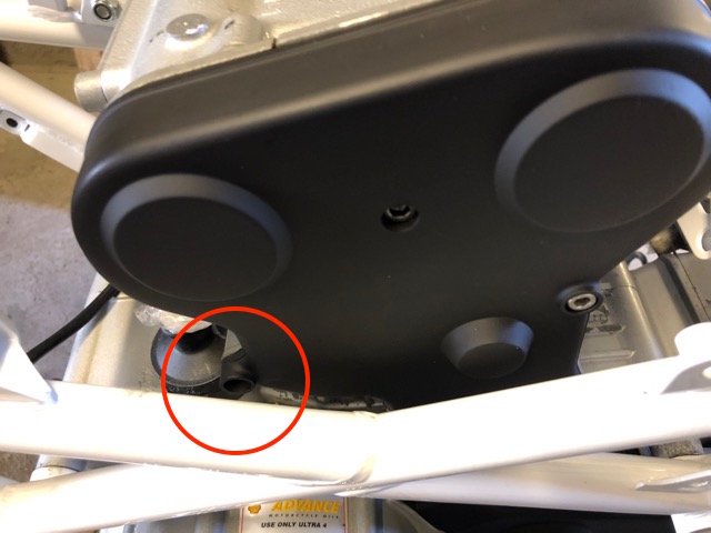

  3. Just avoided a potential future problem.. Only noticed by accident that one of the belt cover bolts was inaccessible once the engine was in the frame. Luckily noticed before anything else was fitted!
    Removed the engine and removed that bolt so belt servicing in the future won't require the engine removing!

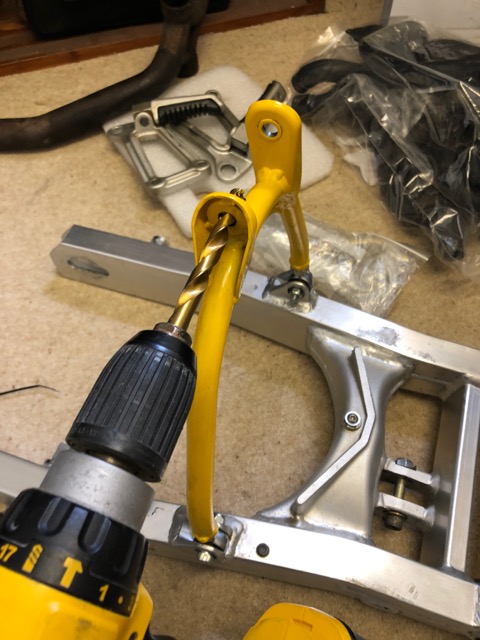

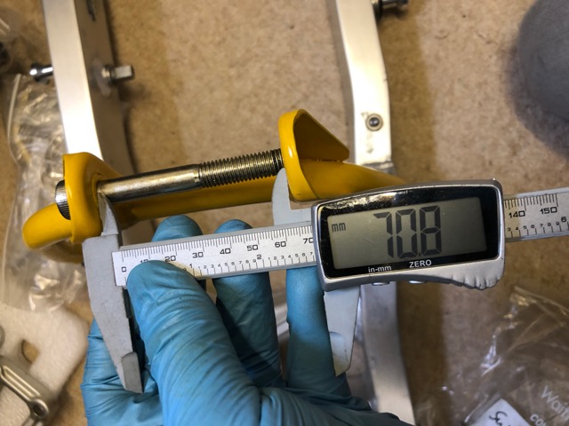

    Another small hold up - seems I have the wrong length bolt for the suspension hoop to suspension rocker, hopefully can still be ordered.
    After some research seems I need one from a 1994 888 not a 1992 - M10x95 mm (not M10x80 mm) Amazing how Ducati changed stuff like this back in the day and sometimes it seems at random!

  6. Thanks for all the info above, have been talking to Stein Dinse today. It is now confirmed that I need the hoop to rocker bolt from a 1994 model 888 which is longer at 95mm. They have the bolt but not the nut. Does anyone know what thread it is. I’ve tried fitting a standard lock nut on the 80mm bolt I have and it’s a different thread..
  7. It's the same bolt used on the ‘93 to ‘00 Monsters, and the same nut used on all three pivots on the rocker arm.
    Looks to be a 95mm long with M10x1.5mm thread.

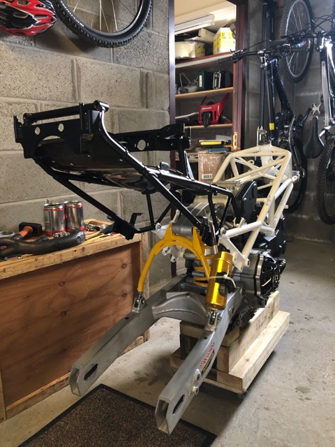

  8. A bit more progress today, with the TT schedule messed up Im getting more time than I expected this week..

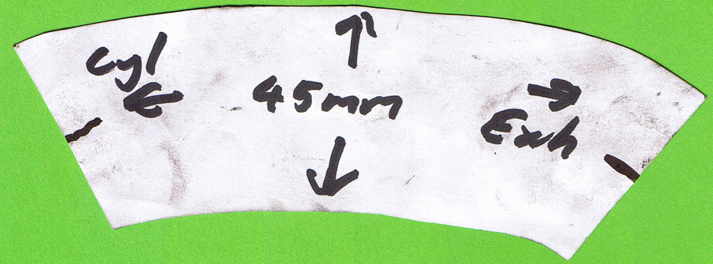

    Rear swing arm fitted and just working on the clearance for the rear cylinder exhaust header, this will require some modification to get the ST4 header through the 888 Swing arm !
  9. Would an early S4 pipe do the job? They had changed from the 888 style wishbone by then though?
  10. Thanks, I will look into that, I already have the ST4S headers so I will try and make those work if possible

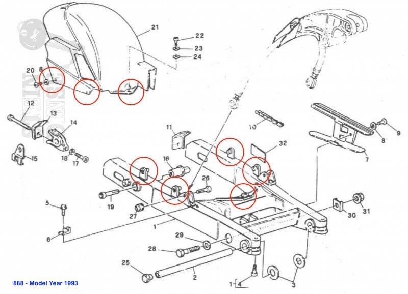

  11. Does anyone know which huggers fit my swingarm ? 851 / 888 / Monster ? Looking to get a carbon hugger fitted but some 888 options I have looked at have different mounting points :thinkingface:
  12. I believe the early Monsters used 888 swingarms so they should be compatible - maybe get a plastic one off flea-bay to check?
  13. On the 851/888 forum, there used to be a template to modify the rear header where it goes through the s/arm.
  14. Thanks ducati dad - I downloaded that and will use it today to try and get the header to pass through, I have also read you can remove a little of the metal on the swingarm to help too
  15. Thanks Harry, will compare drawings this morning to try and work it out

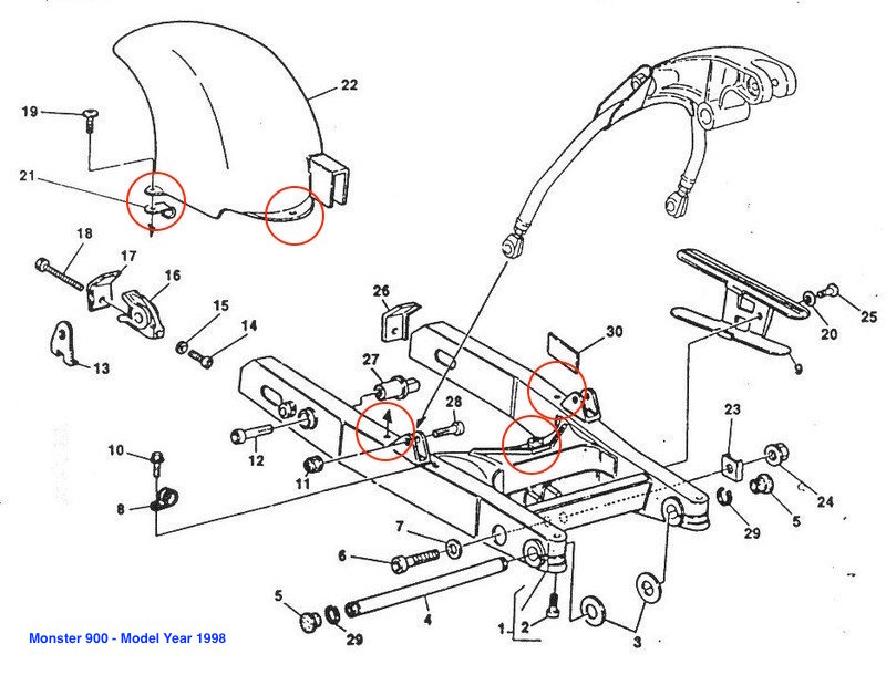

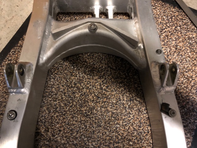

  16. So I need to identify the swingarm I have, from a little searching and comparing online drawings of the mudguard mounts I 'think' I have a 1998 Monster 900 Swingarm - can anyone confirm?
  17. Looks like my old 1996 Monster :upyeah:
