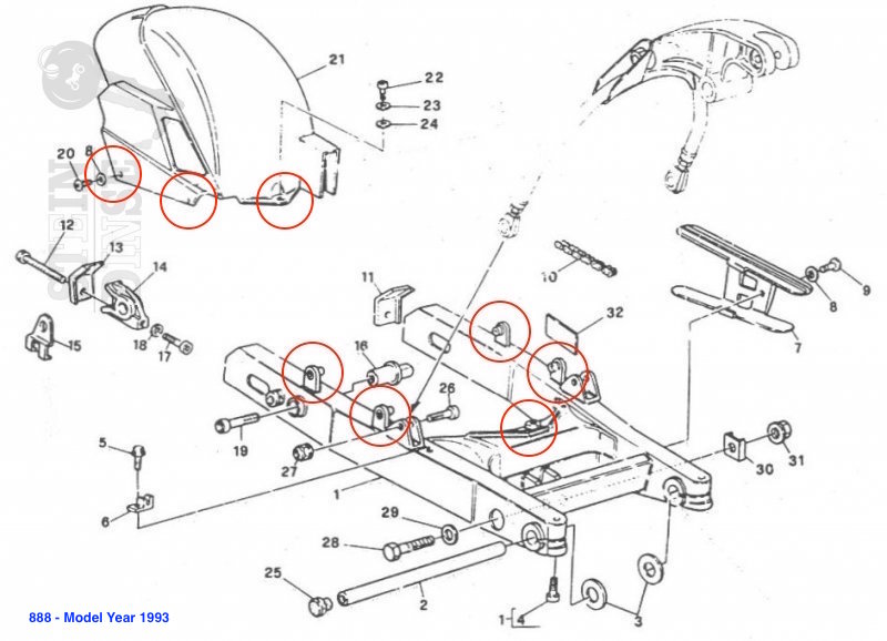

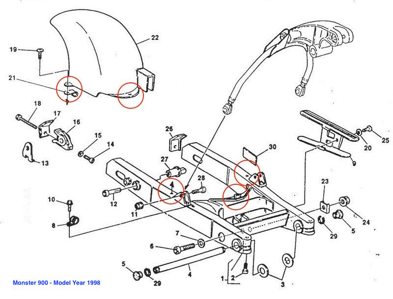

  1. Great! Do you know i the 600/750/900 huggers are all the same?

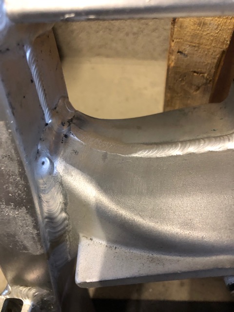

  2. Yes, it looks like the alloy swingarm for 1995 to 1999 M900 Monster.
    The ‘93 and ‘94 model year M900 Monsters had the tab fixings and 888 hugger.
    The M600, M750, M900Dark and some M900 (After the S was launched?) had steel swing arms.
  3. I don’t think the huggers for ally and steel swingarms are the same.
    The shape of the top of the swingarm differs between the wheel and shock, so the huggers vary to match that.

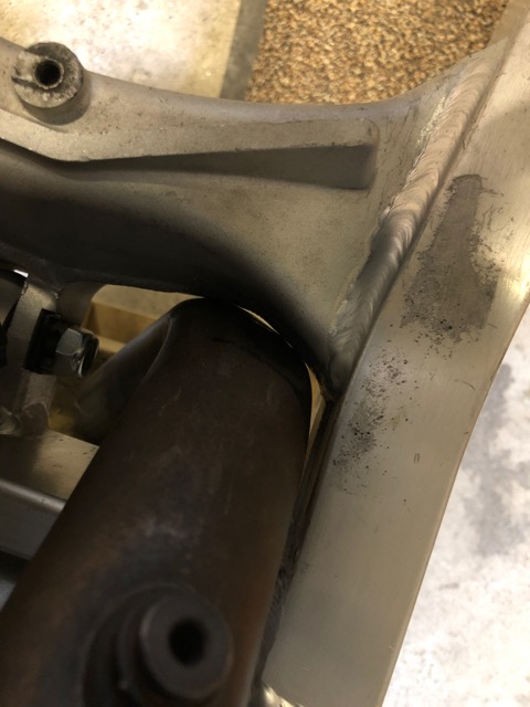

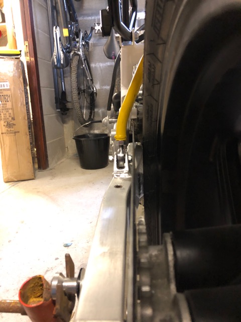

  4. A bit of work on the header and swing arm and we now have clearance to fit the two.
    The header needed a little squashing and the swing arm needed a little filing but now on full extension (past the max shock extension) they just touch so I am happy with that

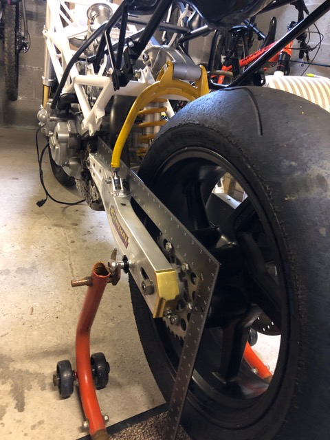

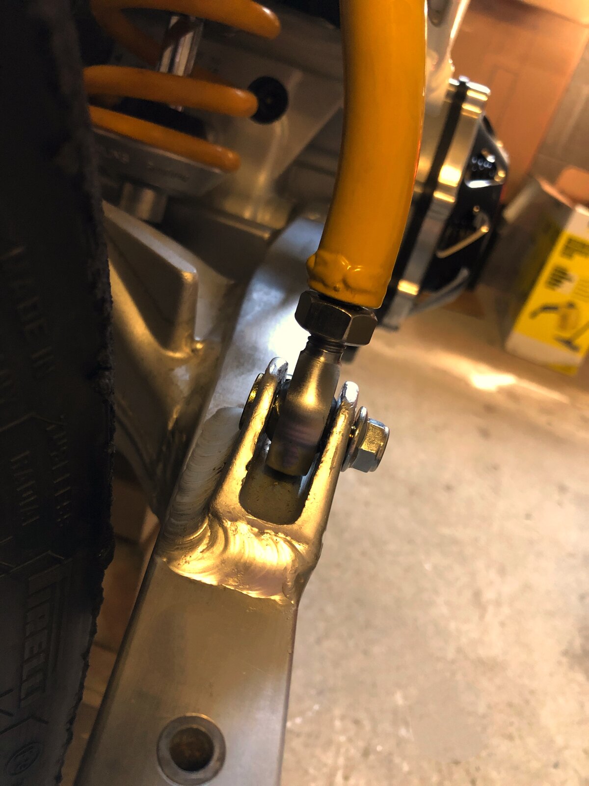

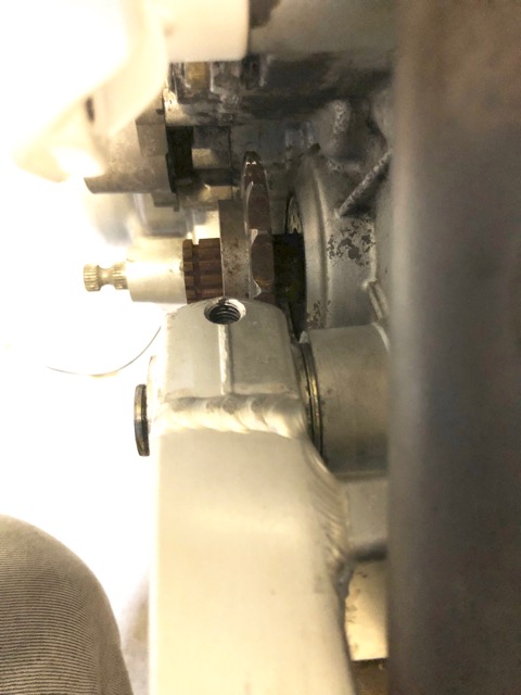

  5. Next job... chain alignment, I 'think' I can make the standard gearbox sprocket work with just some minor spacing
    The correct swingarm to suspension hoop bolts are on their way so, will get that space back for the chain once they are fitted..
  6. If necessary, looks like I could flip the gearbox sprocket for more clearance too

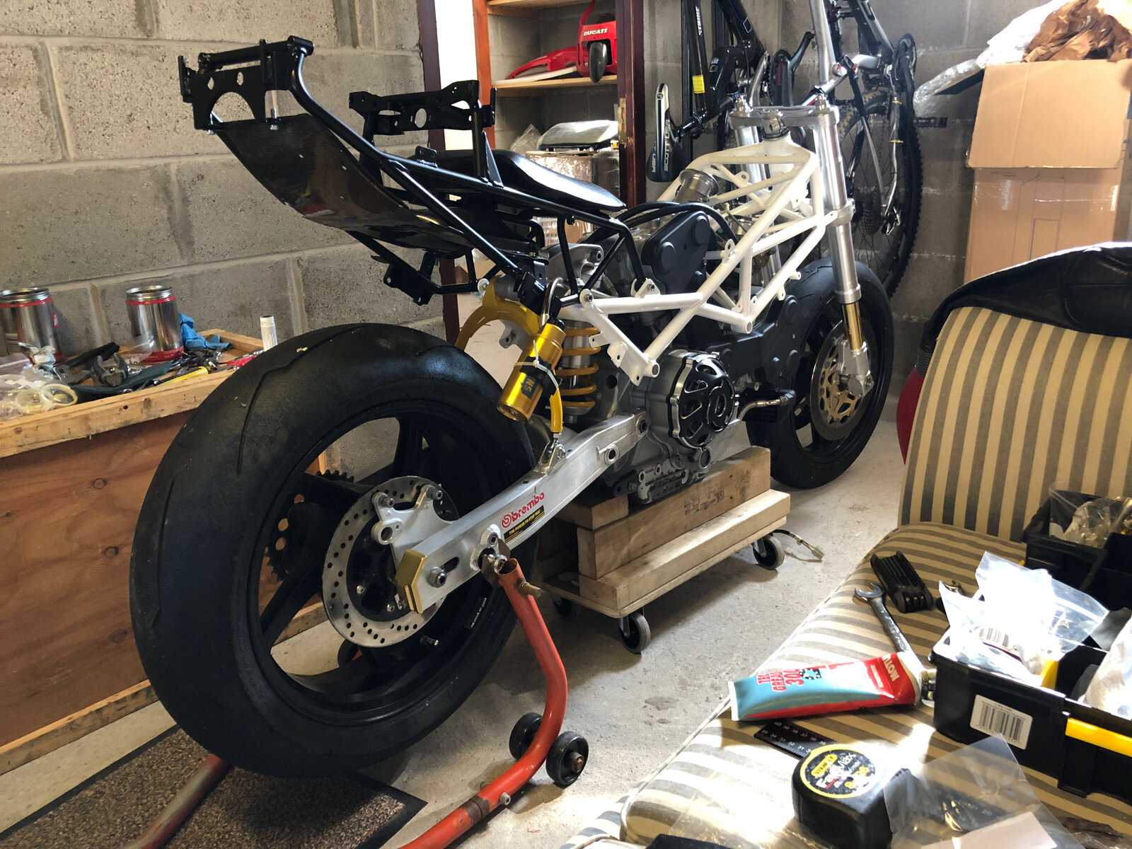

  12. Feel like things are progressing..

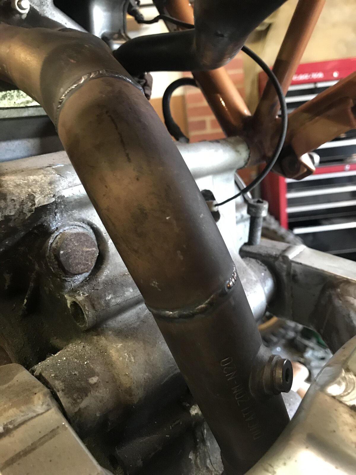

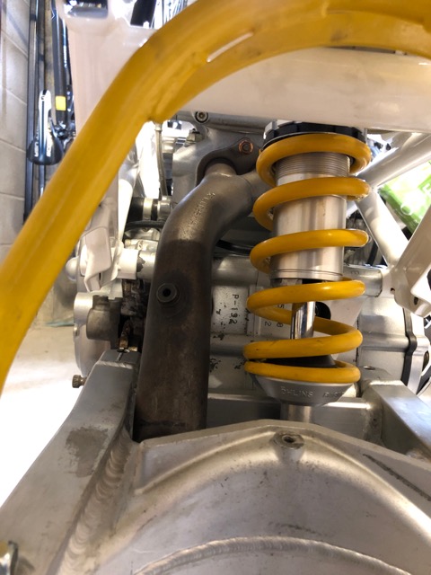

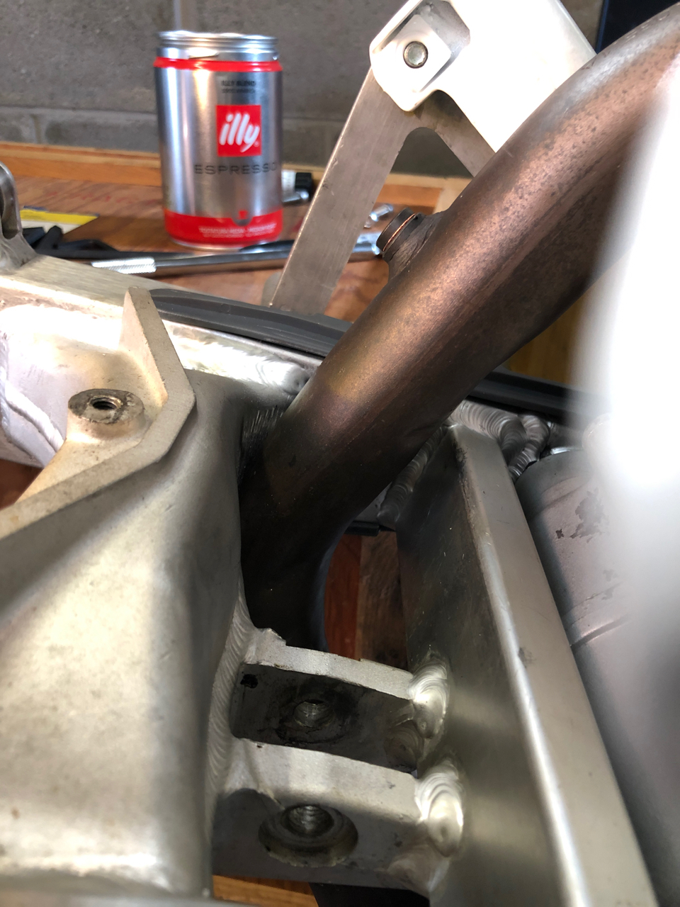

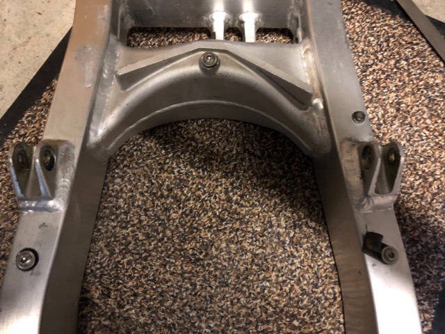

  16. Mmmm - this exhaust is just not happening... thought I had it done but fitting the front header makes it foul the swing arm really badly. Was hoping to avoid having a custom system made but maybe thats not possible?

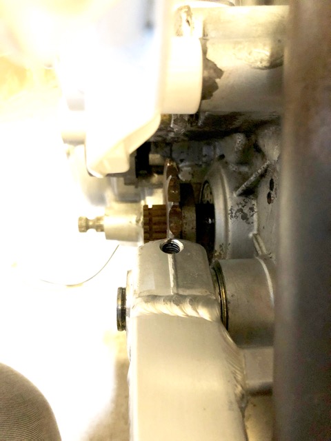

  17. 1264744E-3081-46E6-9EEA-81768405CD94.jpeg I had a similar problem with the ss swing arm. I had move the sensor boss too.
  18. Thanks Till, Have spent the night researching and it seems i'm going to need to find someone who is handy with welding gear at a minimum or, get a system made up
