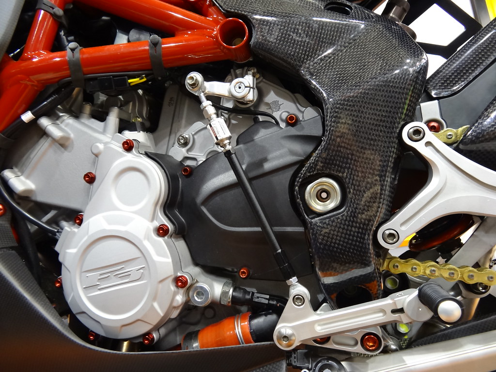

  14. Stole this from the MVAgusta.net pages, so worth signing up there. To retain the quickshift you need the action to ‘pull’ it like it does here still. But it’s obviously doable, that plate mounts on the side stand plate
  15. That's useful, thanks Phil. I have joined MV forum, nothing like as useful as DF. That pic looks like pedal is reversed, so might have to acquire some new rear-sets. Adjustment would be good as I am 1.92m (6'3").......

  19. Yes, rear sets top of list and race shift conversion.
