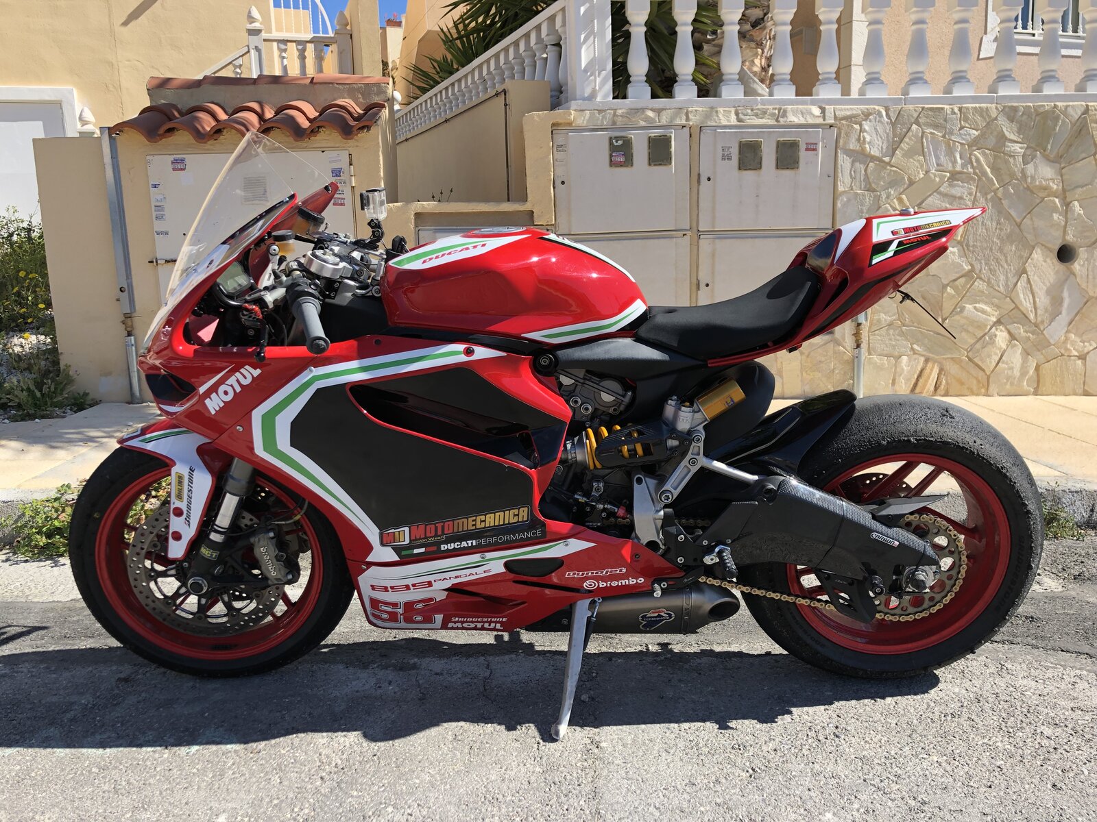

  19. I actually forgot about this thread I started when I bought the 899. I’ve had it over a year now and I love it.
    I bought it off the AOR race team like this: F11EC410-AE10-4698-8A78-239732C3F81E.jpeg
    It was a bit rough but it was all cosmetic and had a great spec as previously mentioned.
    It had had a full engine build by Moto Rapido with Carrillo rods, Sigma slipper and kit generator 180 miles prior to me buying it.
    It was replacing my 4C8 R1 track bike that I just couldn’t get on with and tried to kill me every time I rode it, so the deal was to see how I got on with the 899 before I spent any money tarting it up.
    Cartagena would be the bench mark as that’s the track I ride most with my fasted time being 1:56 on the R1.
    First time out on the 899 I managed 1:55 there so I was chuffed to see a little improvement at least. A year later and I’m down to 1:51 on the 899 round Cartagena.
    So...it was time to tart her up a bit...
    New paint was first:
    The MV style isn’t everyone’s cuppa but I love it.

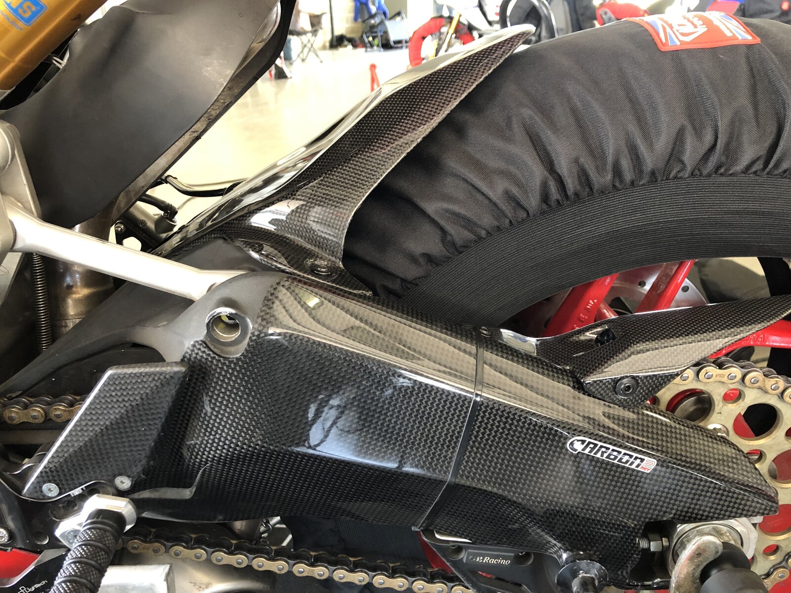

    I bought some carbon fibre - swingarm covers, shock cover, hugger and exhaust caps along with the HEL master cylinder and BSD blipper which is the best mod I’ve ever done on any bike.
    I had a new chain and sprockets fitted along with a fork service carried out.
    Got a carbon fiber exhaust cover waiting to be fitted when I get the chance as well.
    All in all I’m over the moon with it.
    I'm just back from 3 days out in Portimao with it and the bike ran brilliantly and scared a few of the bigger bikes too. Managed to run 2:03 in the fast group so I was happy with that and reckon if I'd stuck a new rear tyre on I could had a couple of seconds off that on the last day.
    Only thing left is to get some carbon wheels and then I think that’s it...unless a fancy dash comes up

    Forgot the Lightec carbon heel plates and chain guard.
