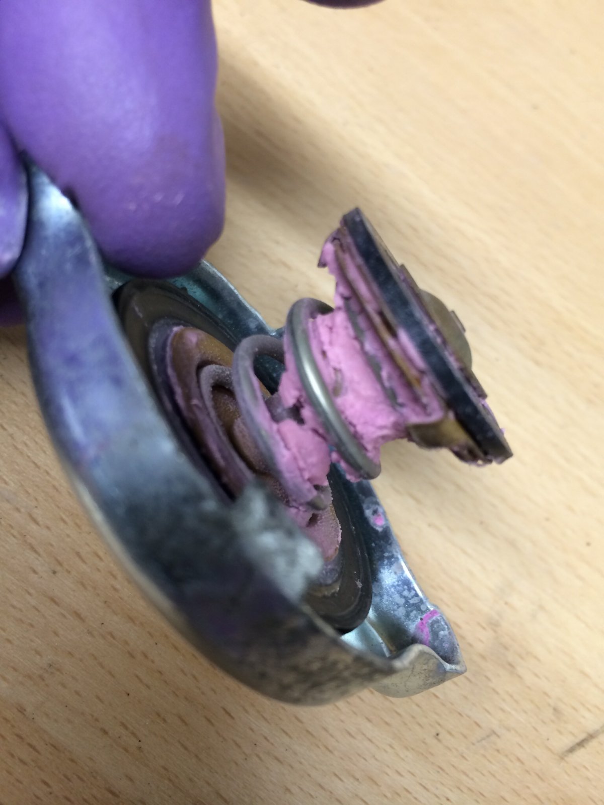

    Also I popped the radiator cap off and found this....
    Expansion tank is empty - I'm guessing it drained when the bike went over in Jerez... Bike was on its side for 5 minutes probably until they picked it up........Top radiator 2/3rds full of coolant....bike hasn't overheated. Anybody got any thoughts......??
  4. Replaced the bleed nipple and brakes all sorted now. The brakes feel nice. Little more initial travel than I'd like but then they quickly firm up very nicely....can't wait to try.....
    Spoke to MotoRapido and the view is the bike emptied its coolant tank when it was on its side and the residue on the expansion side has boiled up to form that wax. I did carry on riding the bike for the remaining days on it track but it stayed around the 80 degree mark on the gauge.
    I've flushed though the expansion tank system and topped up all the levels. I'll keep an eye on it.

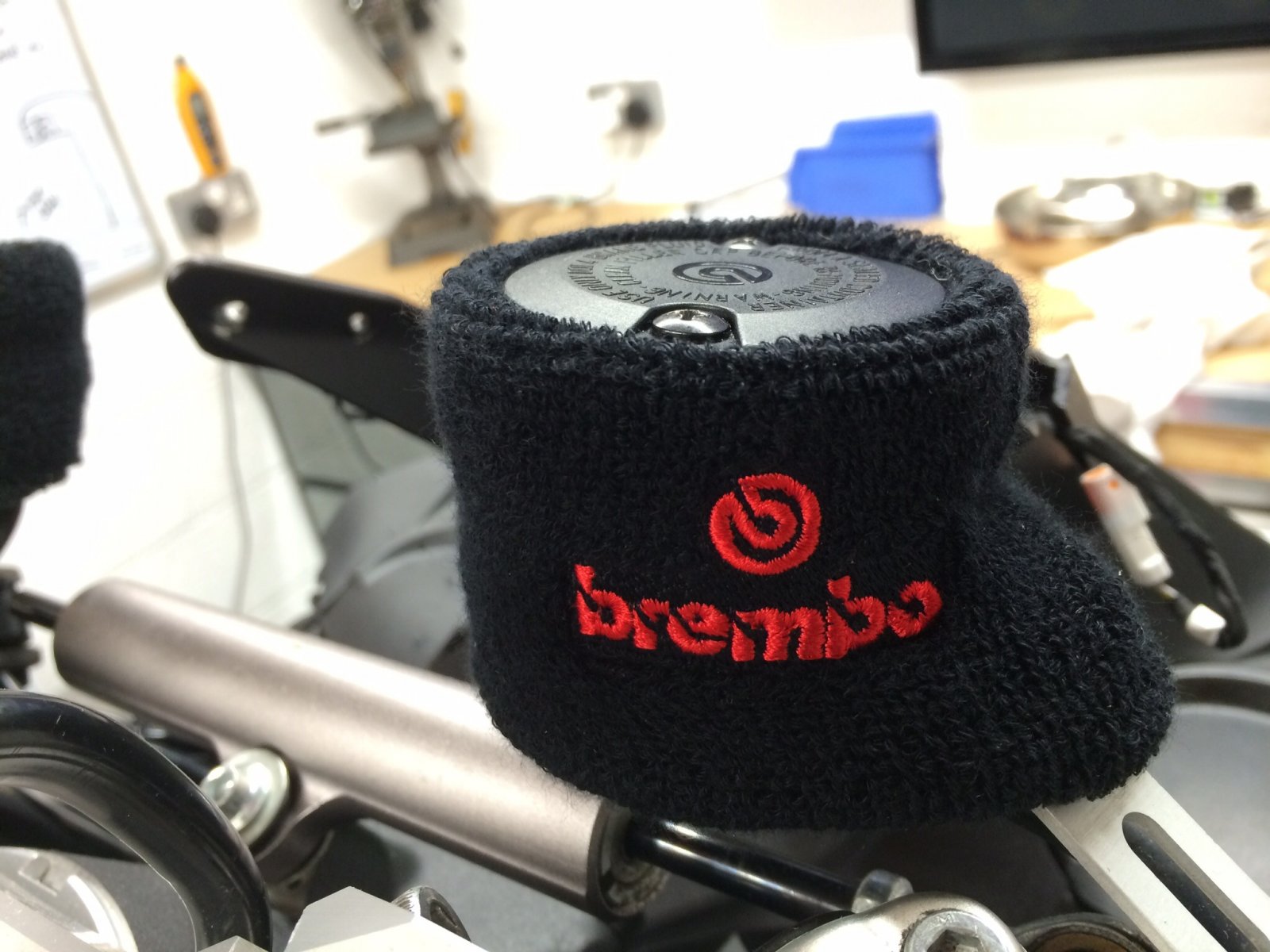

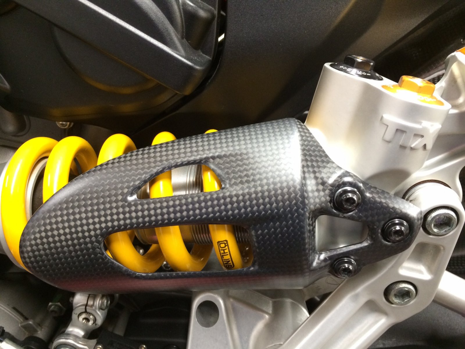

    Fitted a sock on the MC reservoir and a new carbon shock cover....

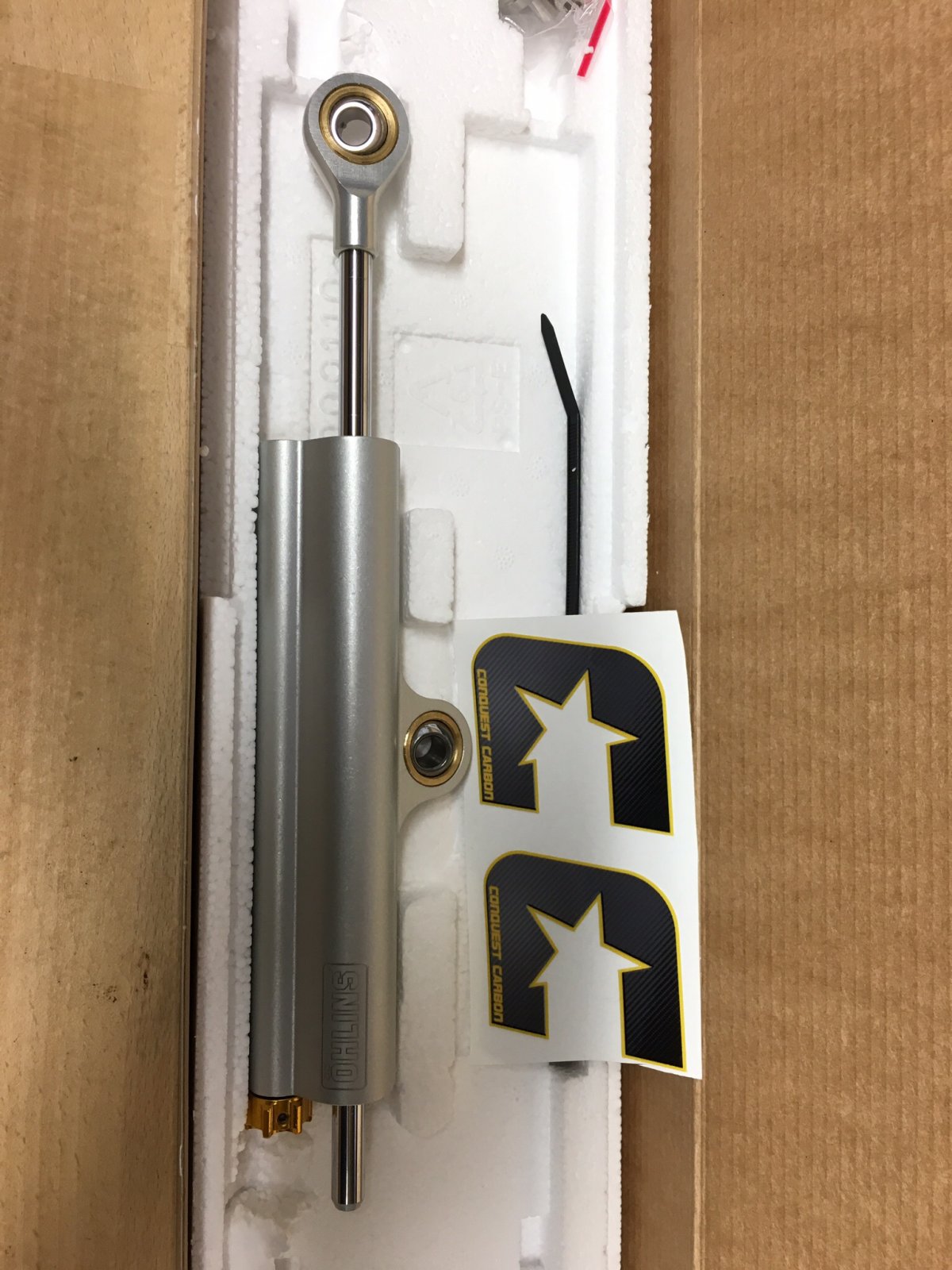

  11. This beauty arrived from Conquest Carbon today....have to say those guys are good.....
    Just look at that beautiful gold adjuster......

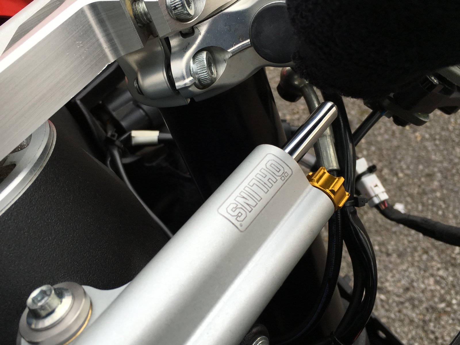

    Ohlins damper makes the bike feel more nimble - I don't like much steering damper on...

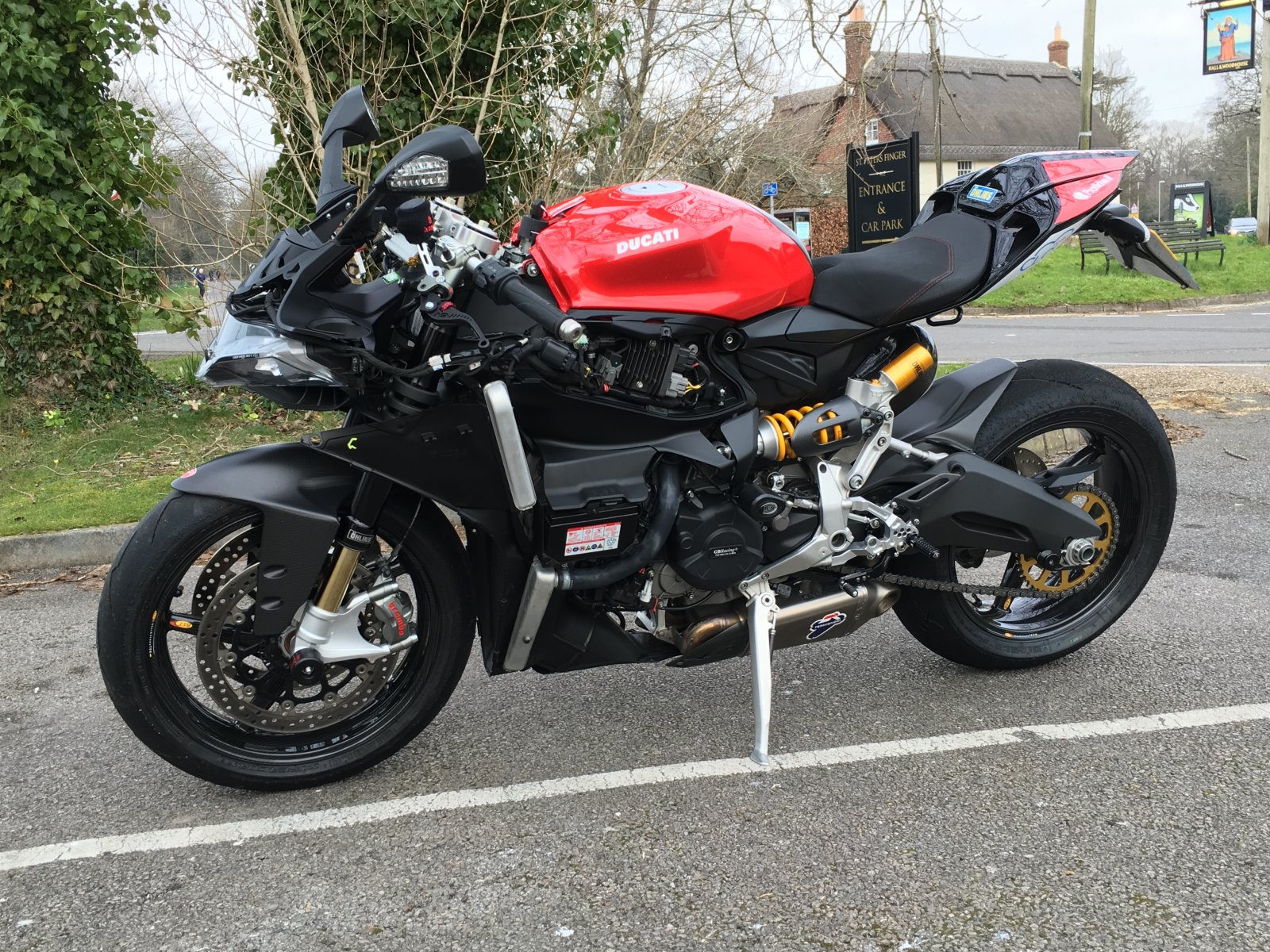

  13. JESUS CHRIST!!!
    How fast does this thing go because all ya front fairings have been blown off it.

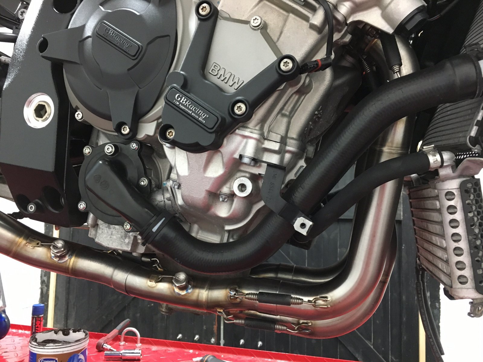

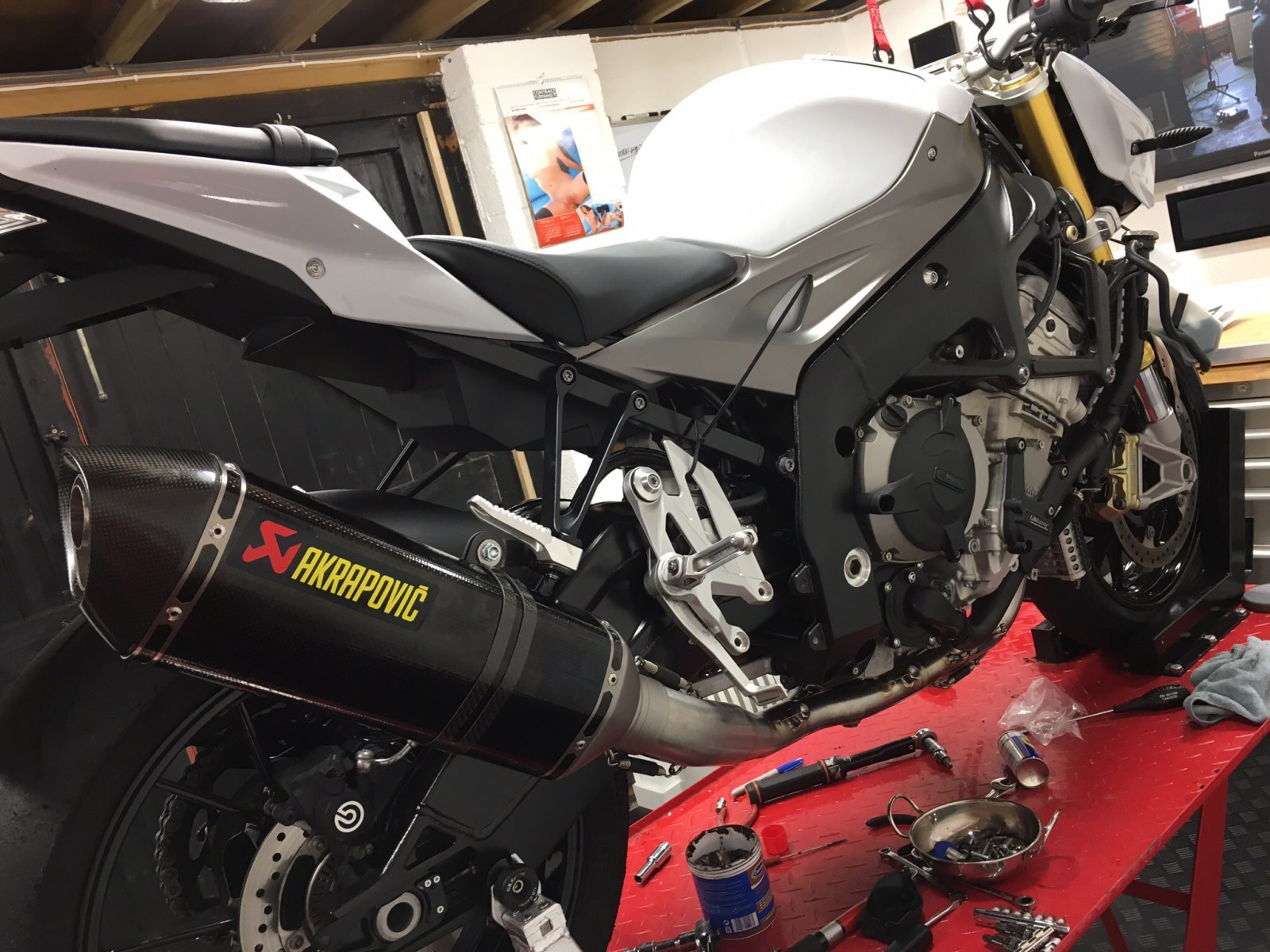

  17. Looking forward to getting the bike back in the workshop tomorrow to finish up. We spent the past few days putting a full Akra system on Bugles S1000R. Took us 7 hours....was quite a faff!

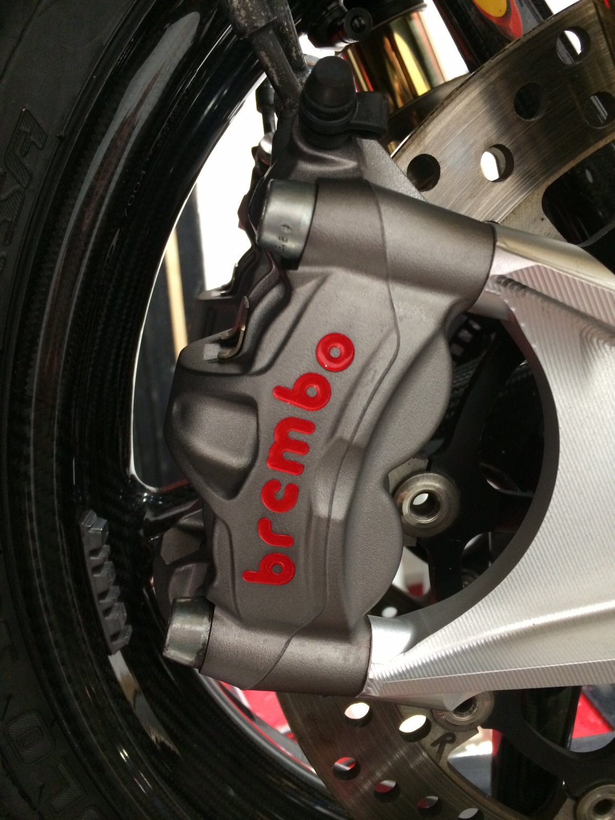

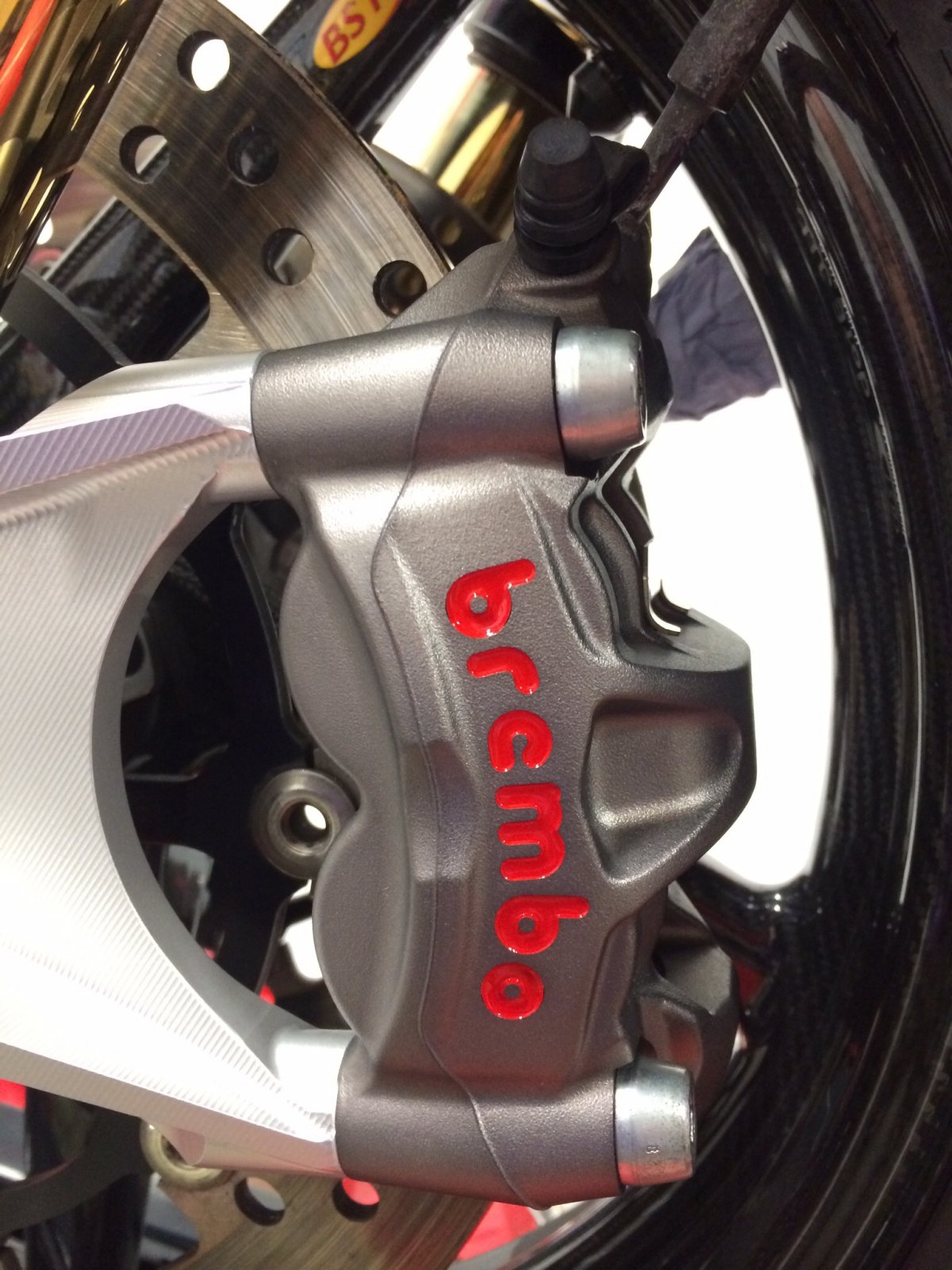

  19. Mate, you're putting some quality kit on your bike but can't believe you've fitted them M50's up with those scabbly brakelines and banjos. One word 'HEL'
  20. Yep the lines are pretty scabby. I think the previous owner kept the bike in the canal.
    I will get round to new lines when I'm confident the M50 transplant has worked.....
