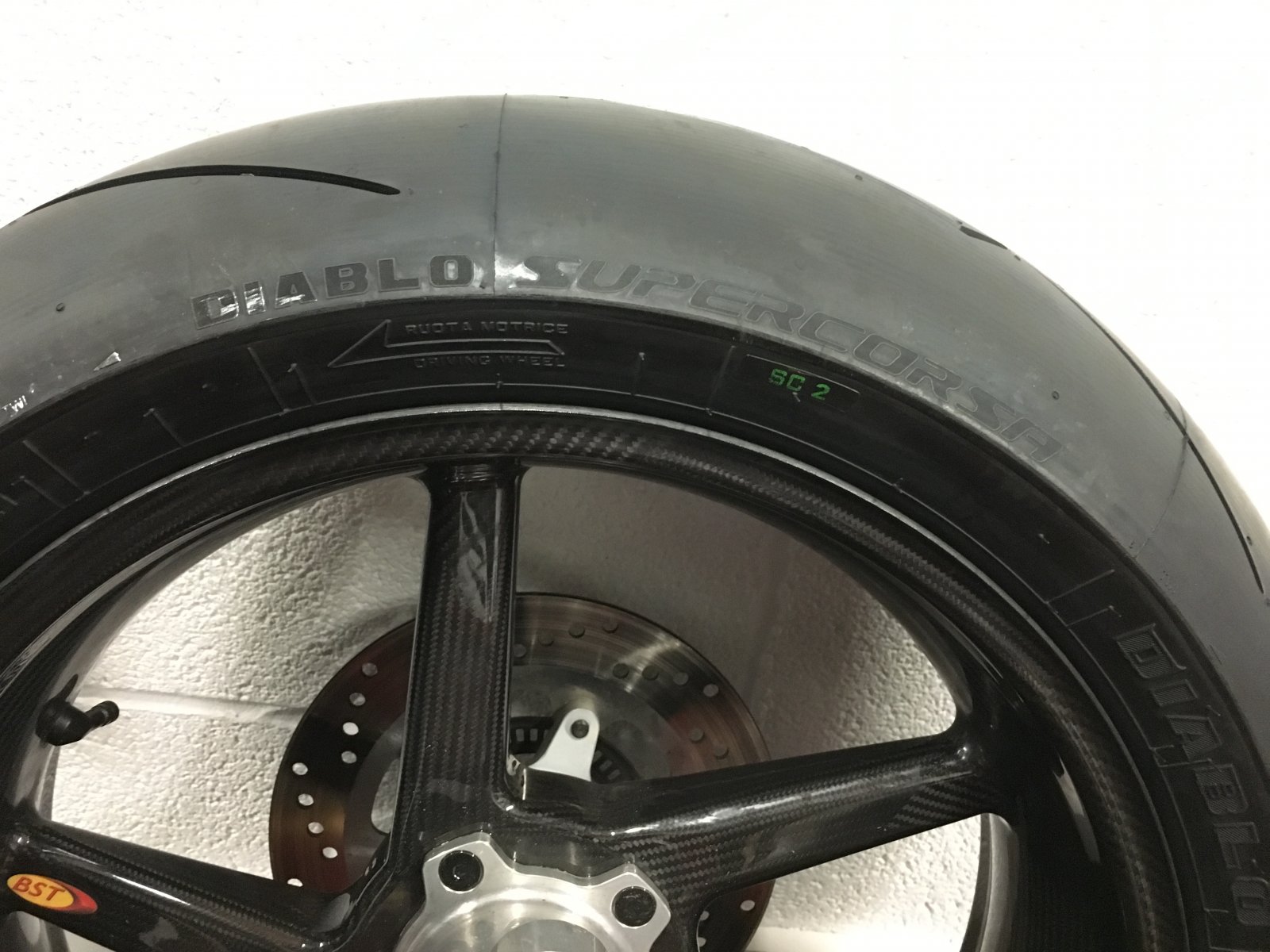

  1. Yummy SuperCorsas. Thanks to Jon at JT Tyres....

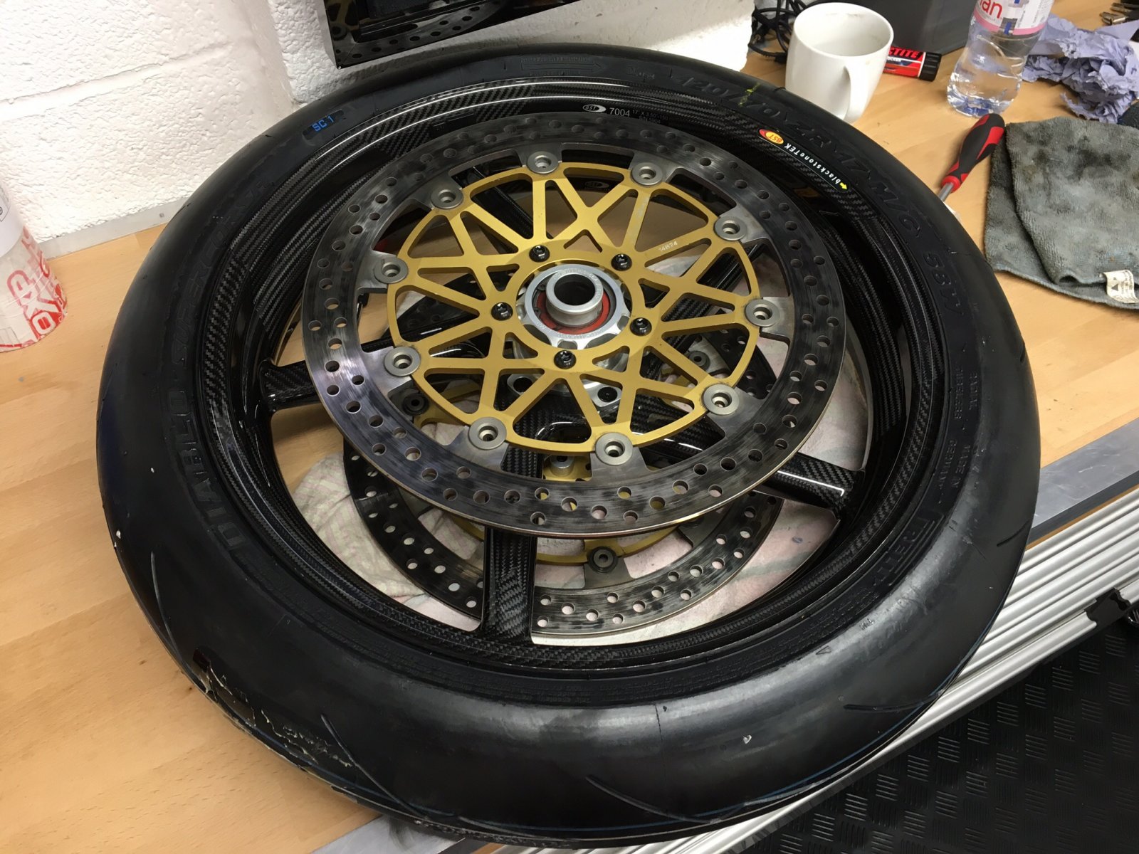

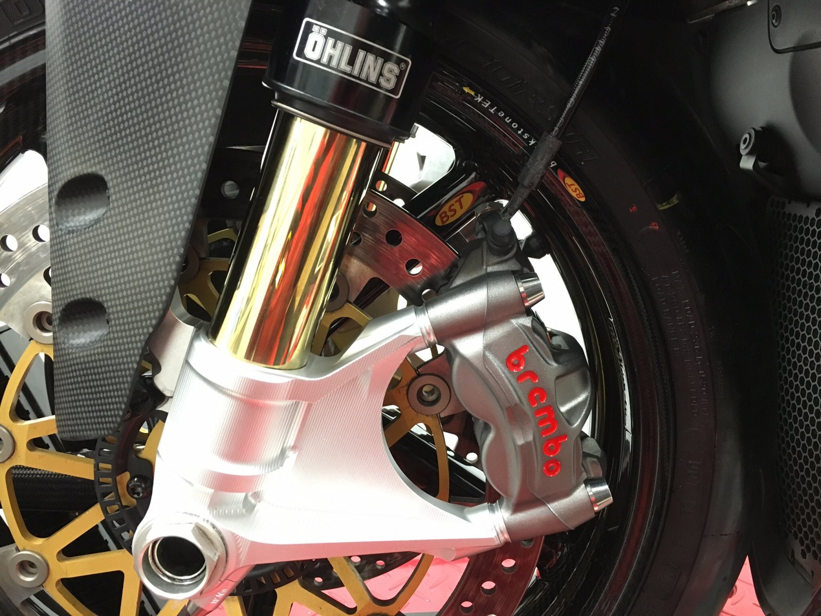

  2. Brembo Supersport discs fitted. 330mm and the correct disc friction surface depth for the M50s. Needed 5mm spacers and longer caliper bolts....took the opportunity to put some titanium disc bolts on....totally not necessary but they look nice...

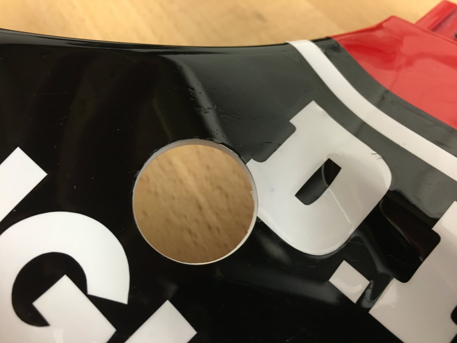

  4. Drilled a nice little porthole in the right lower fairing so I can keep an eye on the oil level....

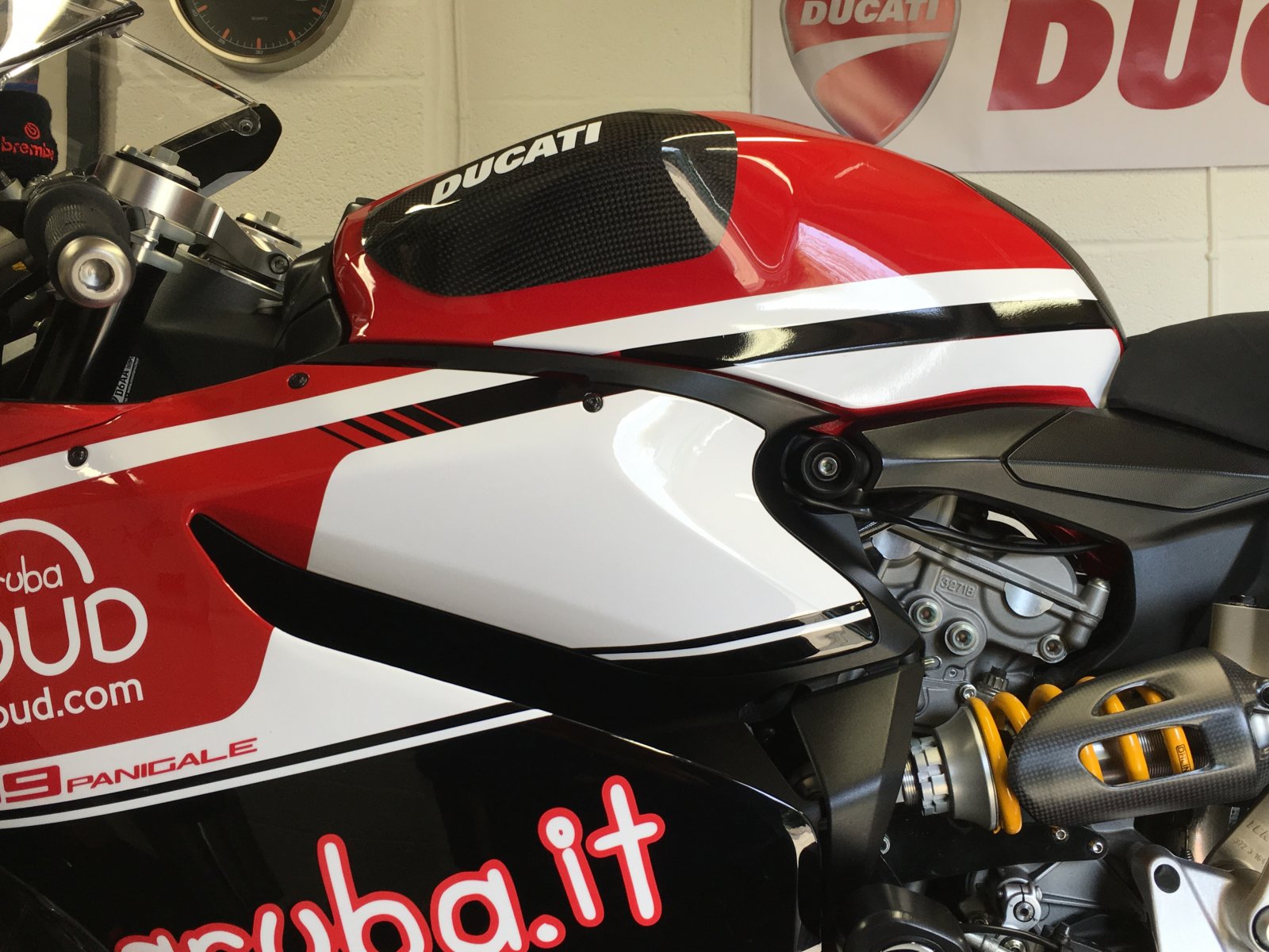

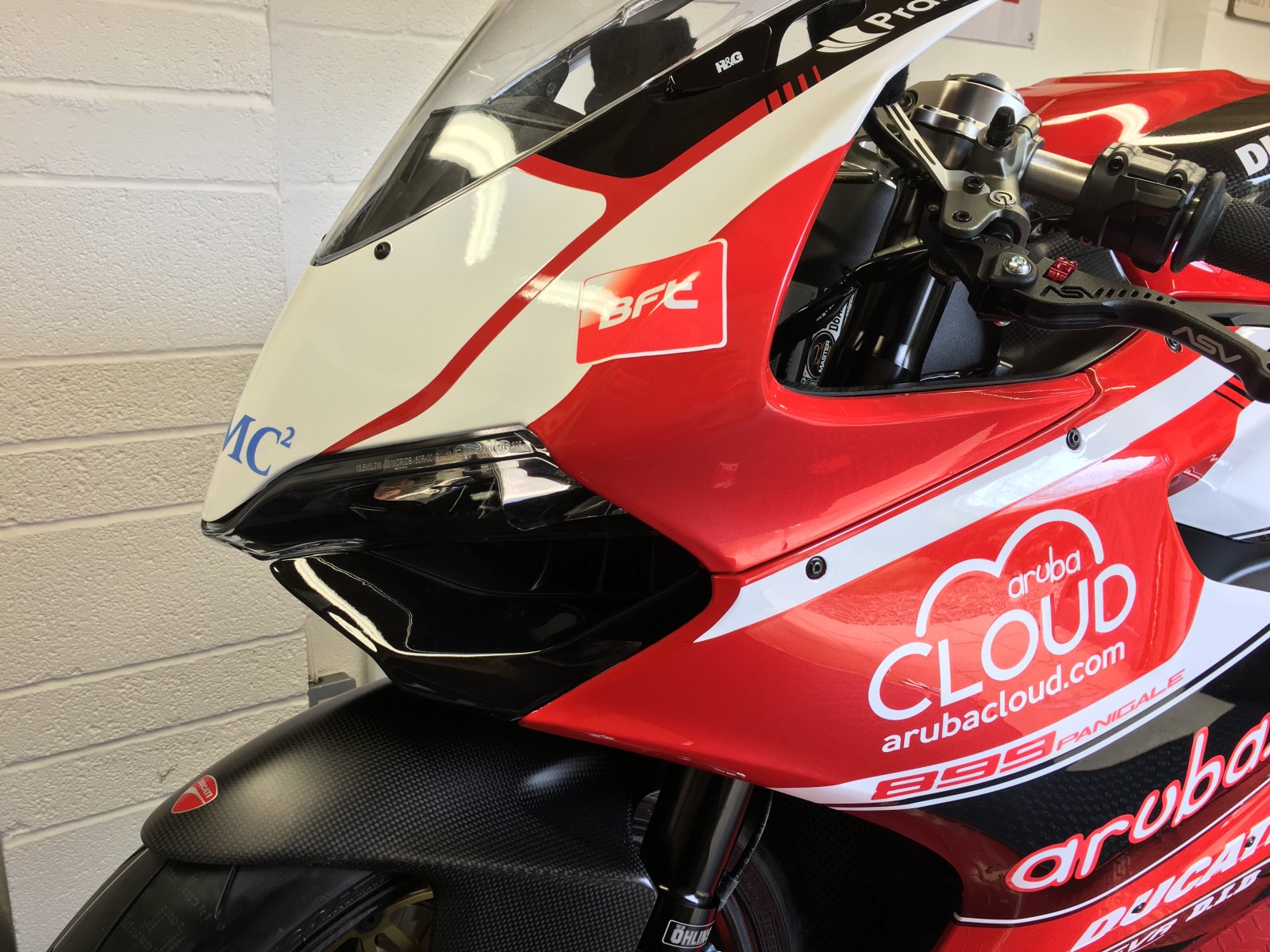

    Got the new top fairing on. Another hateful task on the Panigale....
    It's not a perfect colour match but close enough...

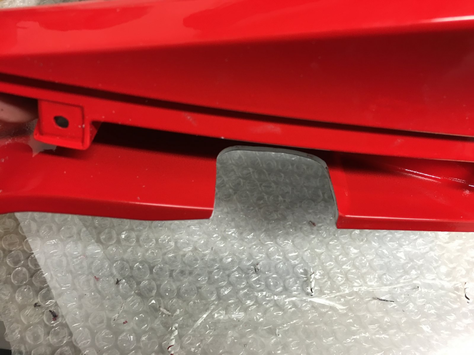

    Cut a little slot so I can get to the expansion tank cap without having to remove the fairing...
    Just got the tank decals to pop on now....

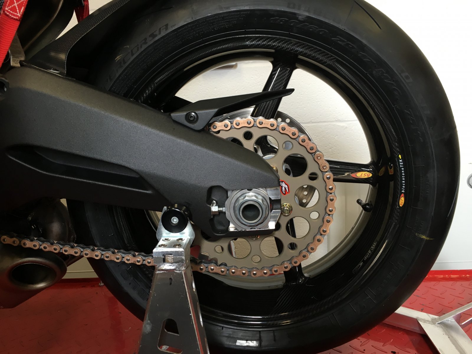

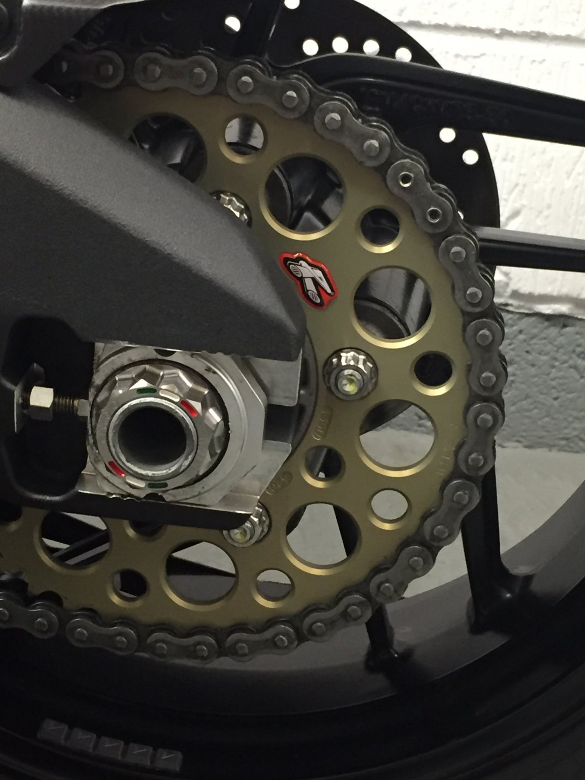

    Plus I think my Talon rear sprocket is out of true because despite fitting a new chain I've got a real tight spot in the same place every revolution of the rear wheel. Not a showstopper but a bit of a pain...gonna pop a DTI on it later and see what's what
  8. Lookin good pal[emoji106]
  9. Hi Joe
    How much difference did the discs make?
  10. Hey Matey, I don't know TBH I haven't taken the bike out since I fitted them.....

  11. I had the same after I put on a Renthal chain and sprocket kit, you could see the chain rising above the exhaust in sync with the rear wheel turning, I took the back wheel out again and turned the sprocket carrier / cush drive through 180 deg and put it back in, a lot better but not 100% perfect.
    If your sticking a DTI on it, you obviously know what your up to Joe :upyeah:

  14. Tested the Talon rear sprocket with a DTI. Got a 0.5mm variation on the radius. Enough to create a significant tight spot.....
    Only used it for 200miles, must've been like it from new and I mistakenly thought it was the chain.
    Ordered a new sprocket.....after wasting £70 on a new chain.

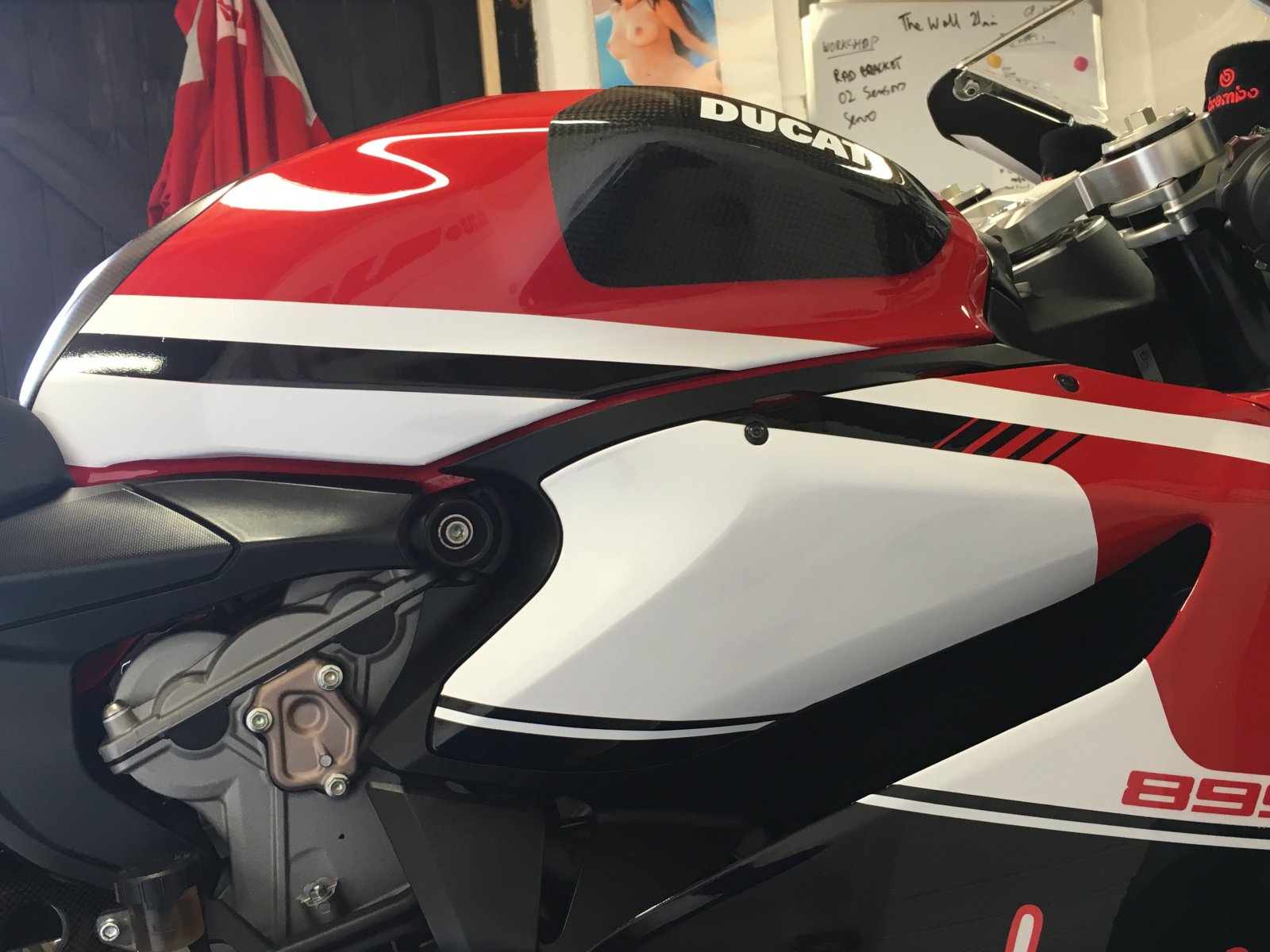

  15. Decals on. Not perfect but I'm happy enough.....
  16. Rental rear sprocket fitted. Perfectly round, but not as pretty coloured as the Talon!!!

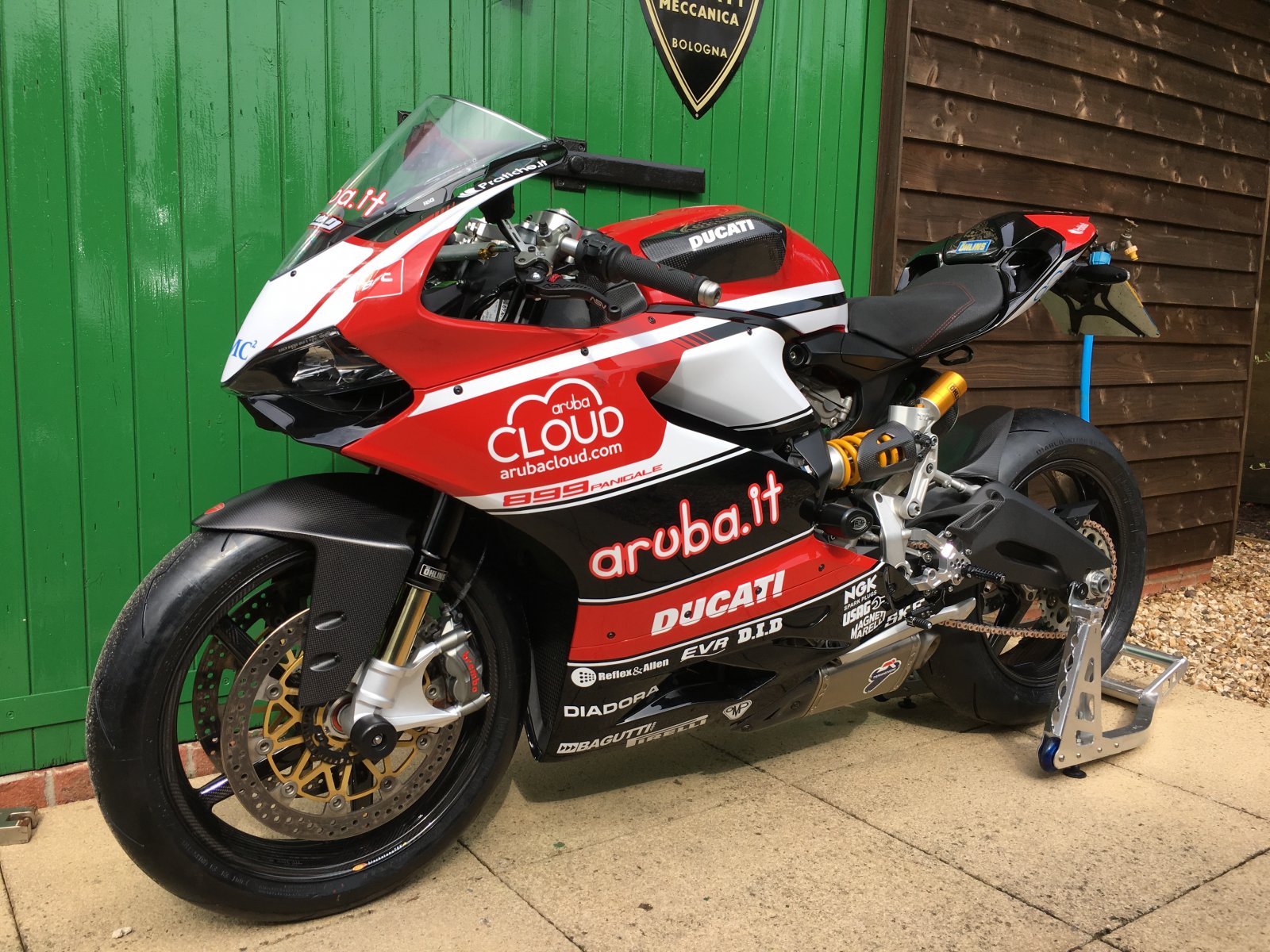

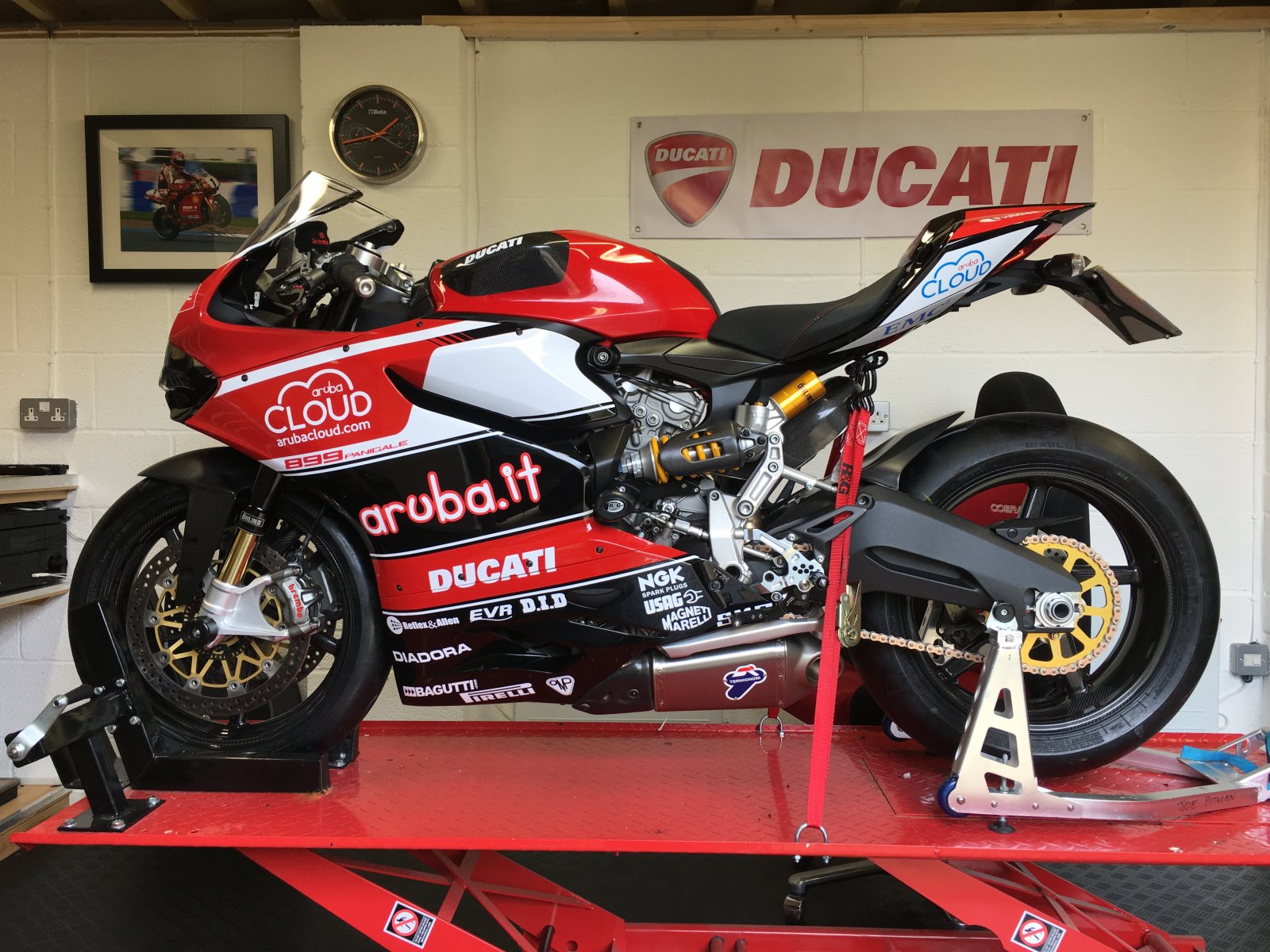

  17. Sneak preview of finished article, crap picture....Better pictures and full spec write up to follow....
  18. image.jpeg Pretty happy with mine. I ran a dti on it once fitted and it's perfectly true!
