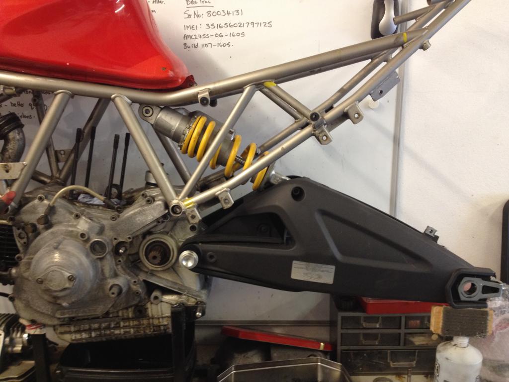

  1. I moved my pivot over on my monster frame to fit a 999 swingarm.
    Be careful if moving over on the frame, as this will have an effect on the exhaust outlet routing.
  2. I must say I do not like the tank, swinger combo
  3. that swingarm is pretty sweet, might have to look at one for my SS. I'll be interested in seeing how the shock sits, have you tried it with the stock unit?, will it go?
  4. Unfortunately the shock doesn't fit :frown: At the moment!!

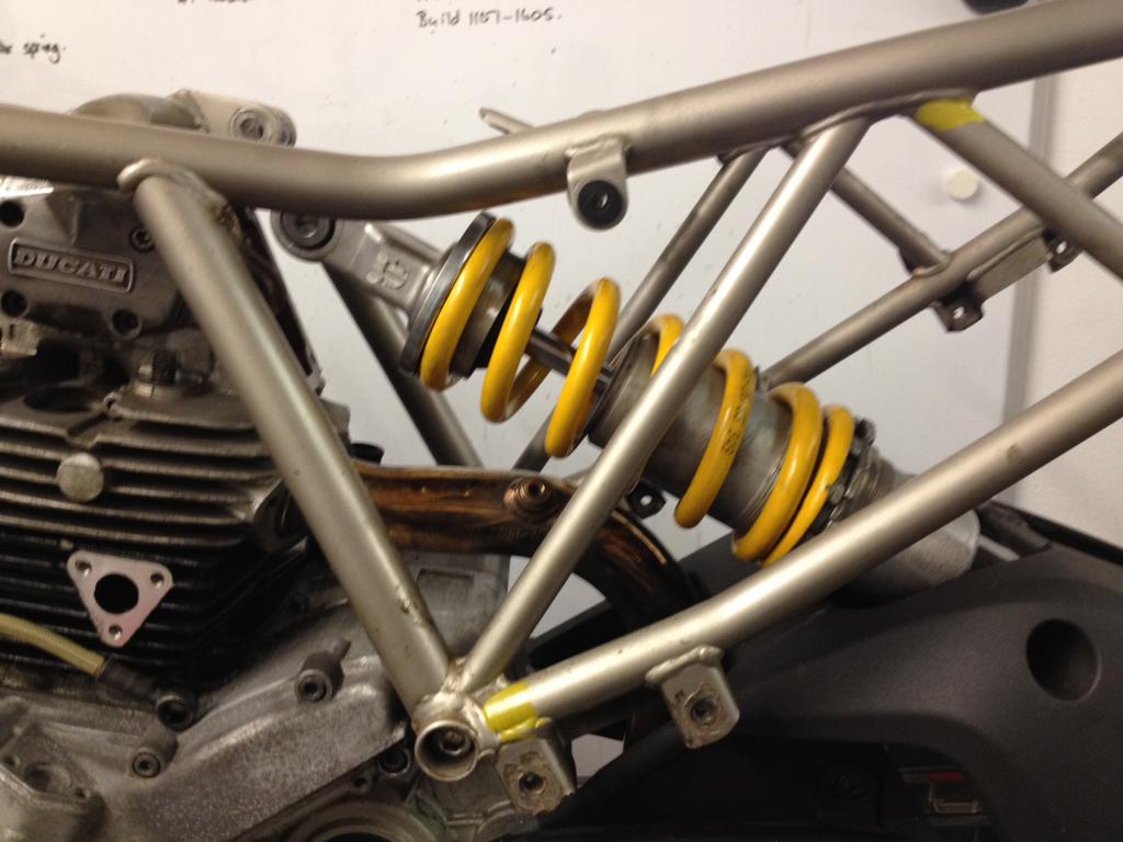

  12. Initially got myself a 900I.E frame for the bike thinking it would be ideal due to the lack of frame work at the back compared to carby frame, I also preferred the footpeg layout. However I tried the carby frame (The 1 I used as the mock up for my Water-cooled Superlight) and it fits the bill far better :rolleyes: typical. The rear of the frame is more level and will be easier to fit the seat unit.
    As for the pegs I'm gonna use a set of a 696 rearsets which means I can cut the rear of the frame of complete with the footpeg mounts (Roughly where the yellow marks are :eek:). The carby frame also gave me more clearance for the rear shock.....although not enough yet.
    I have an alloy swingarm that would slot right in but I wanted it to look slightly different and that would be tooo easy!

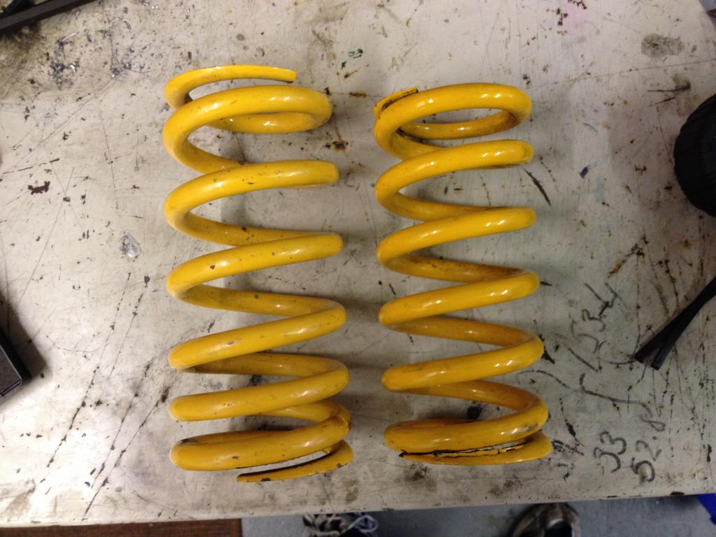

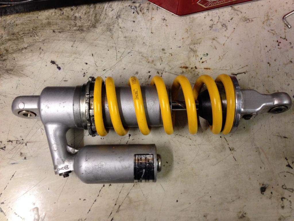

    So the 900SS shock measures 88mm in diameter and is a snug fit - not really enough frame to shock clearance (Cheers to Rick for measuring a 696 shock, thought this could be an option if it had a smaller diameter but they measure the same).
    So measured my Ohlins on the Superlight and that measures 80mm......mmmmh, just had the Ohlins serviced and had a new spring fitted so wondering if I can fit the old ohlins spring to the SS shock???

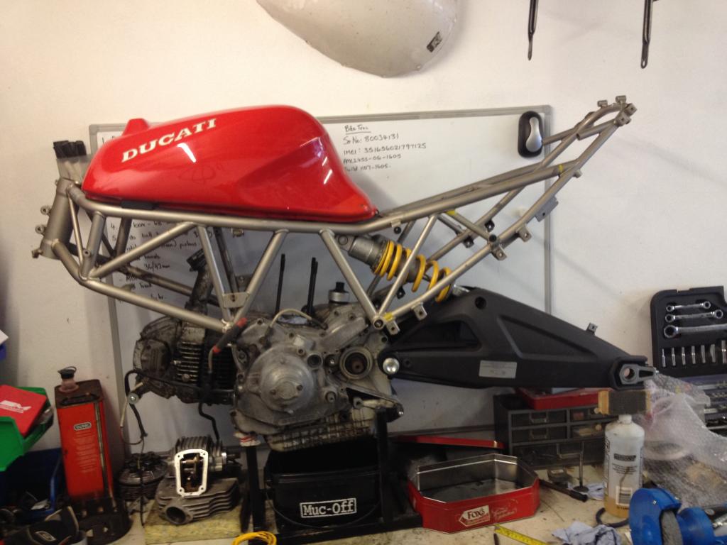

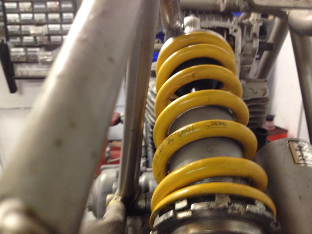

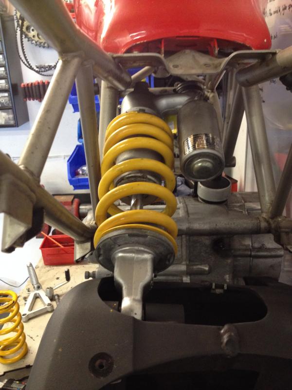

  13. Well stripped down the Showa and fitted the Ohlins spring, had to invert the shock to prevent catching on the swingarm (Bit snug, so will have to see how it goes but it does allow me to get dimensions and hopefully prevent cutting the frame :biggrin:).
    Stuck the rear cylinder head back on and the headers just to make sure I've got enough clearance all seems good so far, wheels are away for paint.

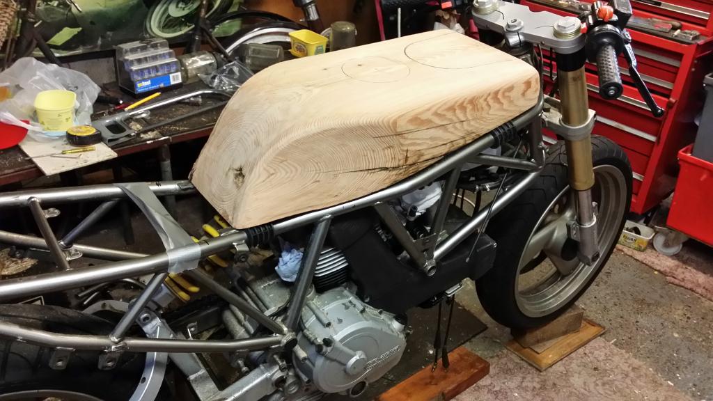

  14. hi,i am making some alloy f2 style tanks to fit the std ss frame,the ss frame is wider so you cant use the pantha f2 tank,i am just in the process of making the pattern for them. 20131221_134059.jpg

  16. let get this one out the way first and I will have a go,i have a Norton tank to eye up.
  17. if that swing arm's cast, I bet yu could machine out the shock clearance and fir that engine won't make any difference.
  18. Hi Sev did think that....could possibly take 5-8mm from the cast and space out on the outboard side?? However in the garage thought I would try and adapt and overcome. Delayed jumping in until Steve has a look at welding the frame to support the shock.
    Cheers Pablo
