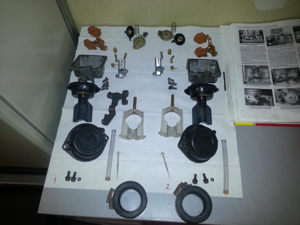

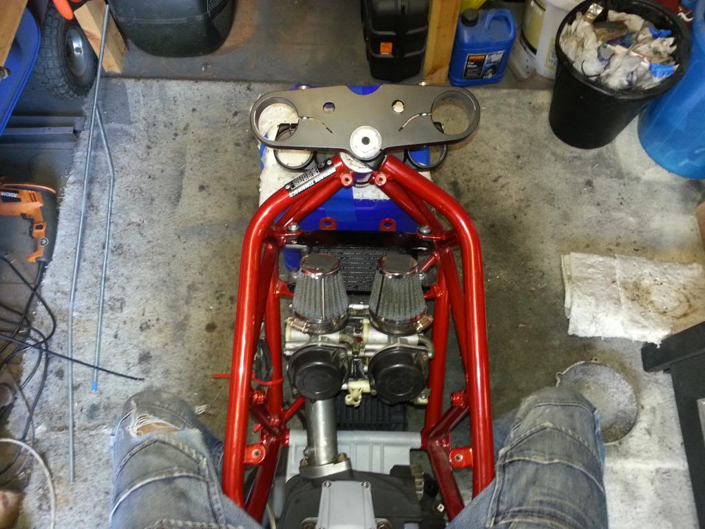

  4. Nice bit of progress made over the last few days. Managed to get the carbs apart (which I've never done before) and got them into a small ultrasonic bath at work. They were pretty clean anyway but I thought it was worth doing while I had the chance.
    Mounted the frame on the engine, mounted the swing arm, painted up the fork bottoms and fitted them with the clip ons.

  6. Stew, do you have the part numbers for the K&N filters? What jets/settings are you running with them? How have you mounted the coils etc? Now the air box has gone.
  7. Cheers Sev - I was actually reading through your '900 SS resurrection' earlier - that thing is gorgeous! Very inspiring! I can only imagine what it must have felt like going through everything that you did to get to the 'complete bike' stage. Superb.
    Supervee - I don't have the filter part numbers and I think they are K&N "style" generic ebay jobs. Regarding the jets/settings - I am entering a world that I've never set foot in before - when I had the carbs apart I inspected the needles and came to the conclusion that they are not standard. I took photos and was going to post on here to see if anyone could tell the difference but then I remembered someone doing this previously (Arquebus perhaps?) and I was going to search the thread first. When the bike is built and running my plan was to take it to get professionally set up. With the coils etc. I'll have to let you know as I get to that stage, as currently there is a big ball of cables on a shelf that I haven't touched since getting the bike!!

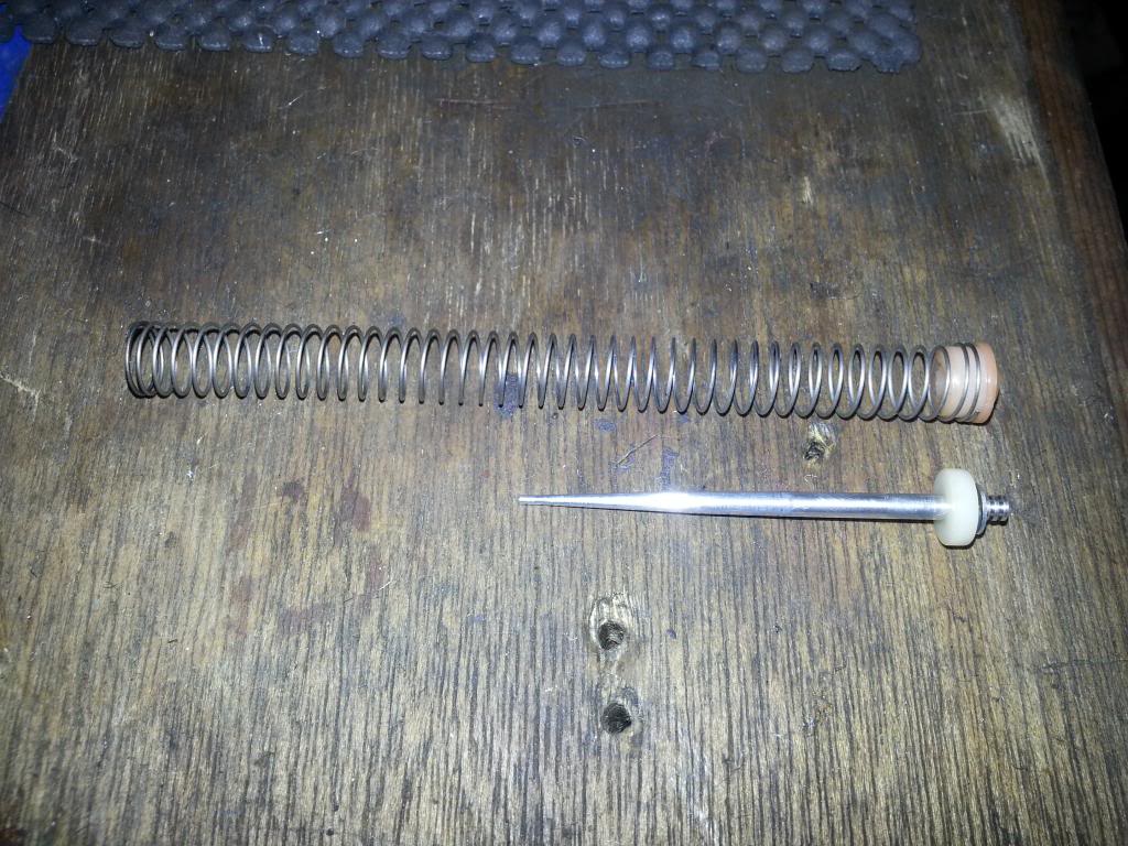

  12. I might be wrong but it looks as though you have Dynojet needles, but not Dynojet springs....
    Post a larger pic of spring and needle together??
    And...What does it have stamped into the main jets? Is there a little logo with the number??

  13. I took a couple of photos tonight. After taking a photo of the jets I've realised that what I thought was the 'main jet' is in fact the 'starter jet' - it has a wee number/logo on it.
    Cheers

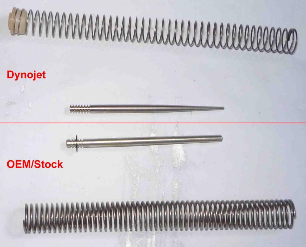

  14. If thre are no sizes or markings on it, that's a Dynojet needle but its a Mikuni main jet, but I can't read the size in your pic (stock size is 140).............the spring looks like a DJ one.
    Try comparing against this pic....the spring insert should be in the bottom one as well.
    You really need DJ jets in there.........size, probably 150.
    AL

  16. Yep, you are correct, the slotted one is the starter jet.........(I was tired when I was posting).....that should be a 70.
    The main jet is the one with the O ring..........
    ....Depending on which Stage DJ kit is fitted; for a Stage 2, I reckon you should have something close to a Dynojet 150 in there (my 750 has a 148); the OEM Mikuni would be a 140 with a square logo and the DJ will just have a number.
    What the pilot screws are set as is immaterial and only a guide.....the float heights will affect the number of turns out......So it may not be a bad idea to make a note of the float heights.
    Which DJ kit is fitted (stage 1 or 2 probably) can be determined by the airbox lid and the exhaust system.........If you have 'open' zorsts and 'open' airbox ie; missing or cut about (and I assume K&N cone filters would be the same as an open airbox), then the DJ kit should be a Stage 2.
    The needles are the same in either kit and DJ will replace those FOC if they are worn....however, with your K&Ns I'm guessing they are more 'open' than an 'open' airbox, so you may even need 155 DJ jets.
    AL
