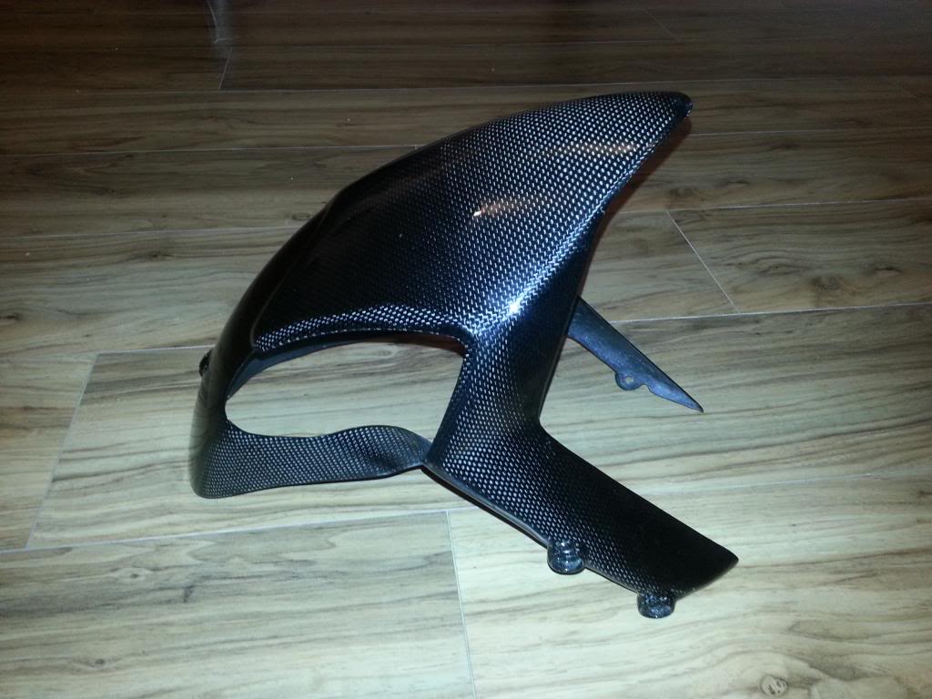

    Also, on another topic - I was routing about through the bits today and found the carbon front fender. I sized it up against the holes in the forks and it doesn't fit. I also found two brackets that have been made in an attempt to fit it but it is clear that the fender has never been used. Rather than modifying the existing brackets or even worse, the fender, I think I'll try selling it on here. It has no identifying markings but after a quick search on the web I think it could be the same as the following item (it looks identical anyway):
    THE CARBON KING MONSTER 696 796 1100 FRONT MUDGUARD FENDER FIBER DUCATI FIBRE | eBay
    Am I right in thinking that this might fit the '98 onwards supersports as well?
    Here's a couple of photos. The distance between fixing hole centres is approx. 70mm and the fender is in nearly new condition. I'll prob post in the classifieds too. Judging by other prices I'm thinking £75 + postage??
