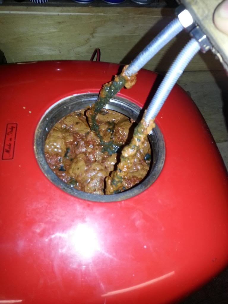

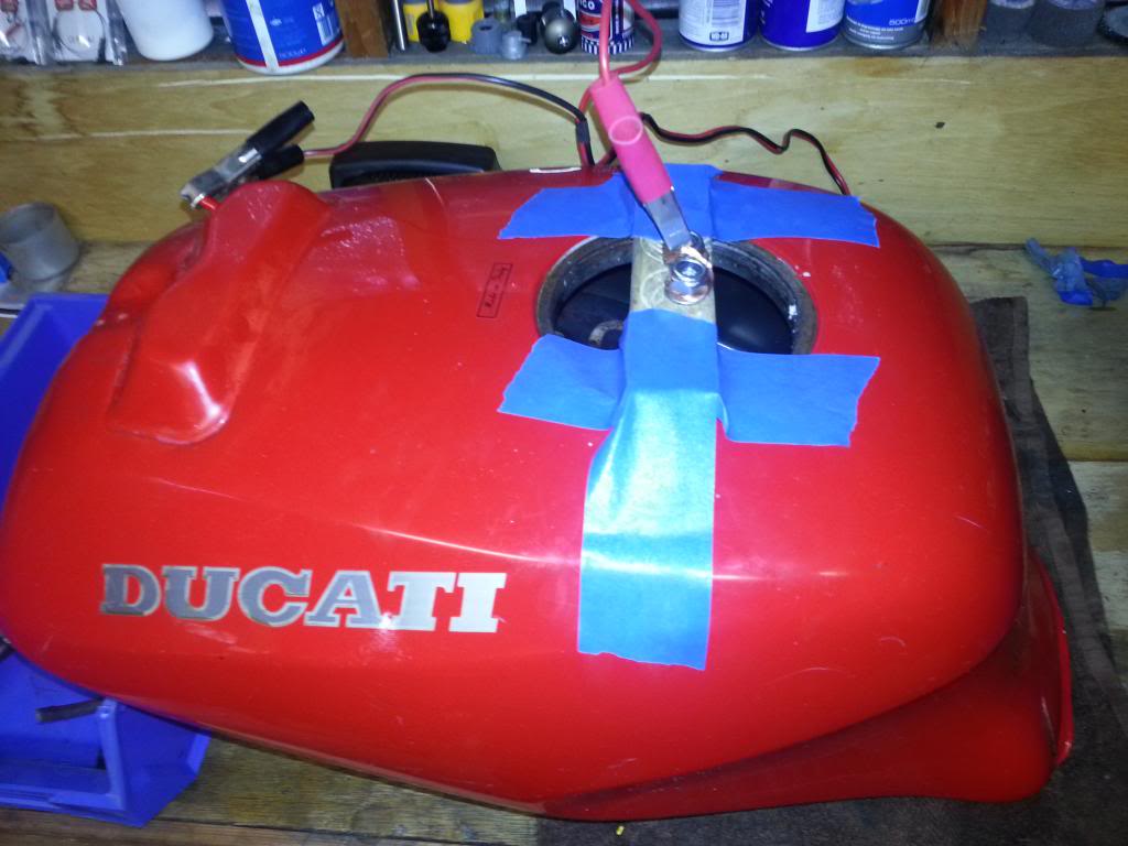

  1. Managed to get round to addressing the rust in the tank, pulled all the gubbins out (painful) and got a bit of electrolysis on the go. Left the 4A battery charger going for about 24 hours and was pleased with the results. Just waiting for the POR-15 kit to arrive to treat it.
  2. Tell us more about this electrolysis malarkey...... this looks highly entertaining and mightily effective! Great thread by the way - loving your work!
  3. I'm not that clued up on the exact chemistry of the process, but it basically pulls the rust from a surface and transfers it to a 'sacrificial annode' (in this case the threaded rod). I used a 4A battery charger, connecting the positive clamp to the threaded rod and the negative to the fuel valve on the underside of the tank (moved after the top photo), the solution closes the circuit. Turn it on and you instantly see little bubbles coming of the metal.
    I'd heard about the process in the past, so just Youtube'd it and gave it a blast. Just be careful about what you use to make the solution more conductive as the first time I tried it out I'm pretty sure I ended up producing hydrogen chloride! You live and learn I suppose . . . :rolleyes:
  4. Not for long, if you make too much Hydrogen Chloride... :wink:

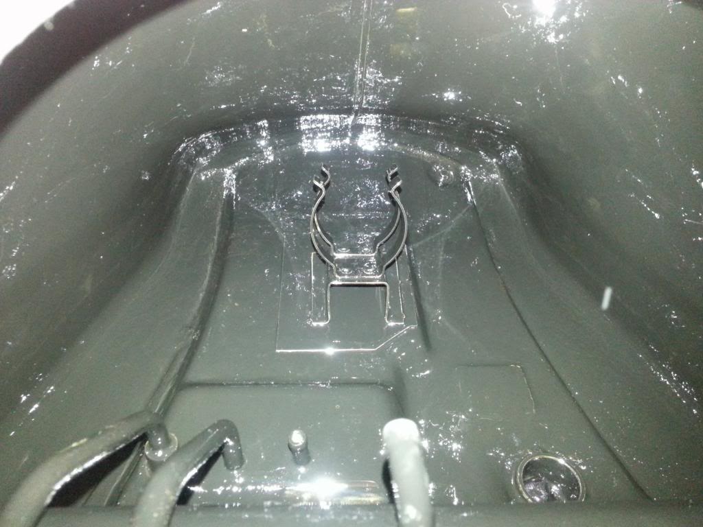

  5. Got the tank POR-15'd up. Pretty easy stuff to work with but I ended up getting it everywhere! Lucky the tank is going to be painted. I used sponges cable-tied to the end of metal rods as brushes to get in all the nooks and crannies (the kit comes with a nifty one as well). Pleased with the final result. Have contacted a local powder coater about coating the shock spring, have to drop it off today or Monday. For £20 I'm happy with doing that until I've had the bike running. After that I can think about different shock or spring, if needed. Hunting down a chain and sprockets at the moment. Onwards and upwards . . .

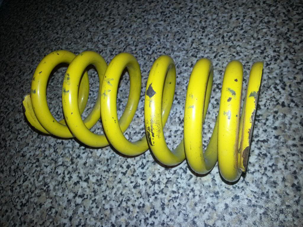

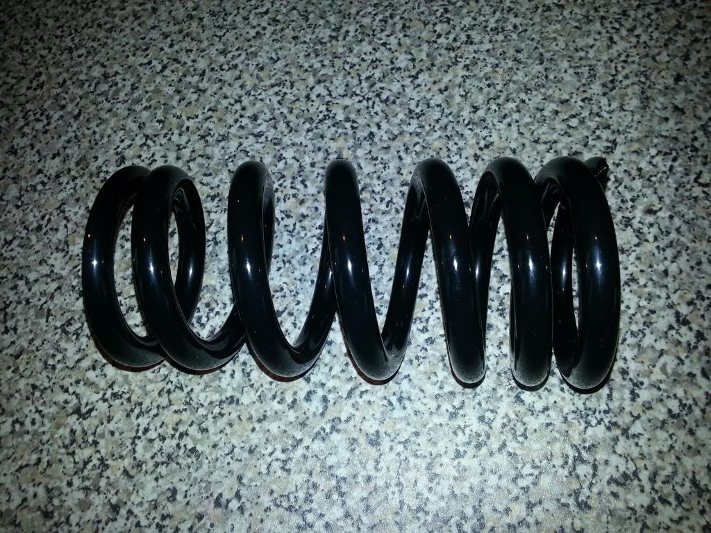

  15. Just picked up the newly powder coated shock spring. Pleased with difference - it should look good on the bike.
    Also, working my way through cleaning up the exhaust pipes, and fittings. They come up quite nice with a wire wheel and some elbow grease!
    Spring before:
    Spring after:
