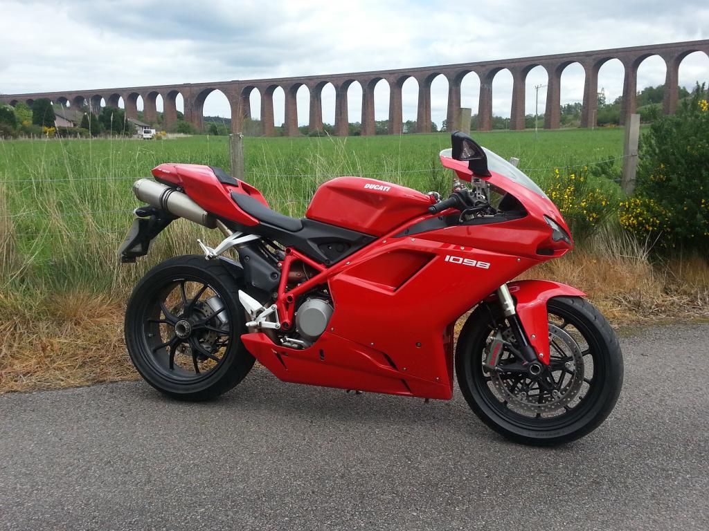

  17. Yesterday, I bought what is going to be a serious distraction to my project . . . . !
    (When the roads are dry ;))
  18. You bet.
    Really like what your doing to your SS, it's going to look better than the 1098.
  19. Nice Viaduct!!
