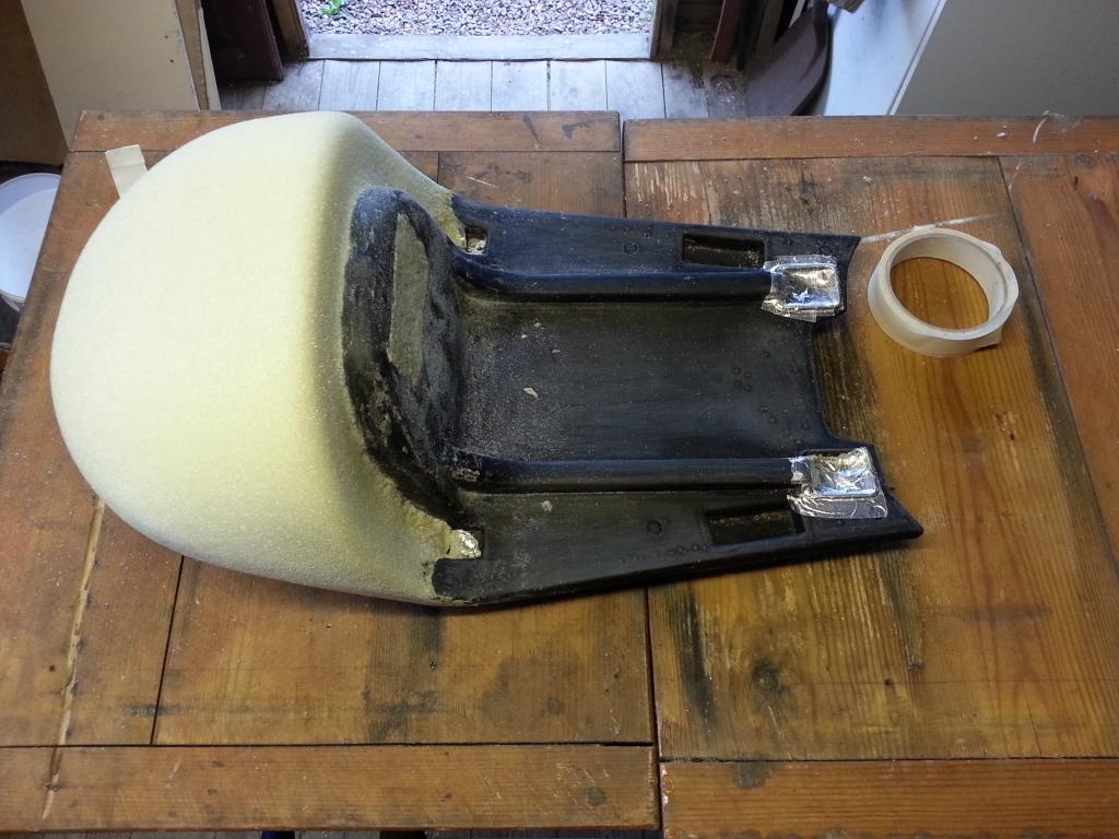

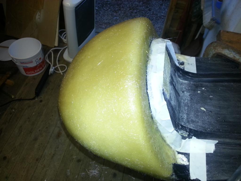

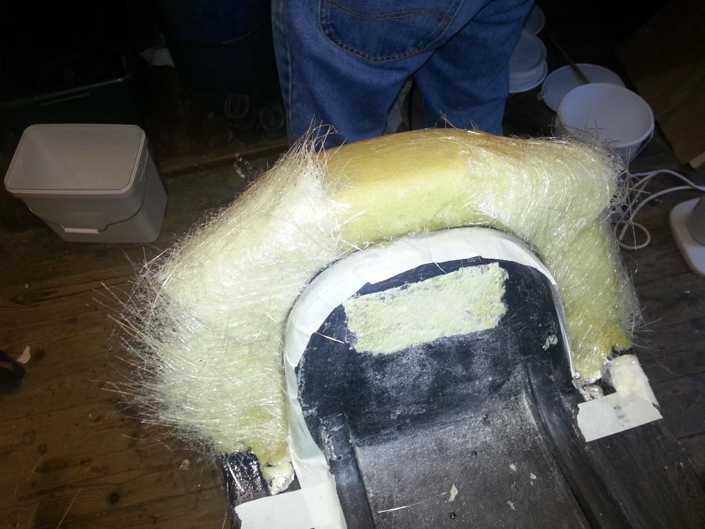

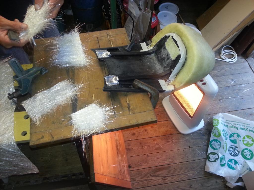

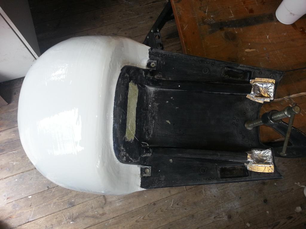

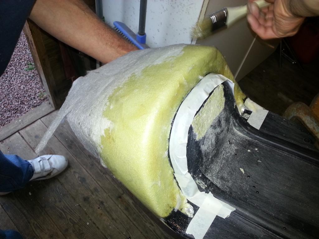

  5. It's been a good while since my last update - The 1098 is proving to be quite a distraction! Anyway, yesterday and today was spent fibre glassing and gel coating the seat unit. The process went very well as the old man, who used to do fibre glass repairs, was helping me. Firstly a couple of layers of tissue was applied and allowed to set, then two layers of the fibre glass were applied and allowed to set. Then the whole thing was rubbed down and cleaned up with acetone. Then two coats of gel coat were applied, ready to be rubbed down tomorrow. Then the seat unit, tank and front fender will be given to a friend who is going to paint them up for me.

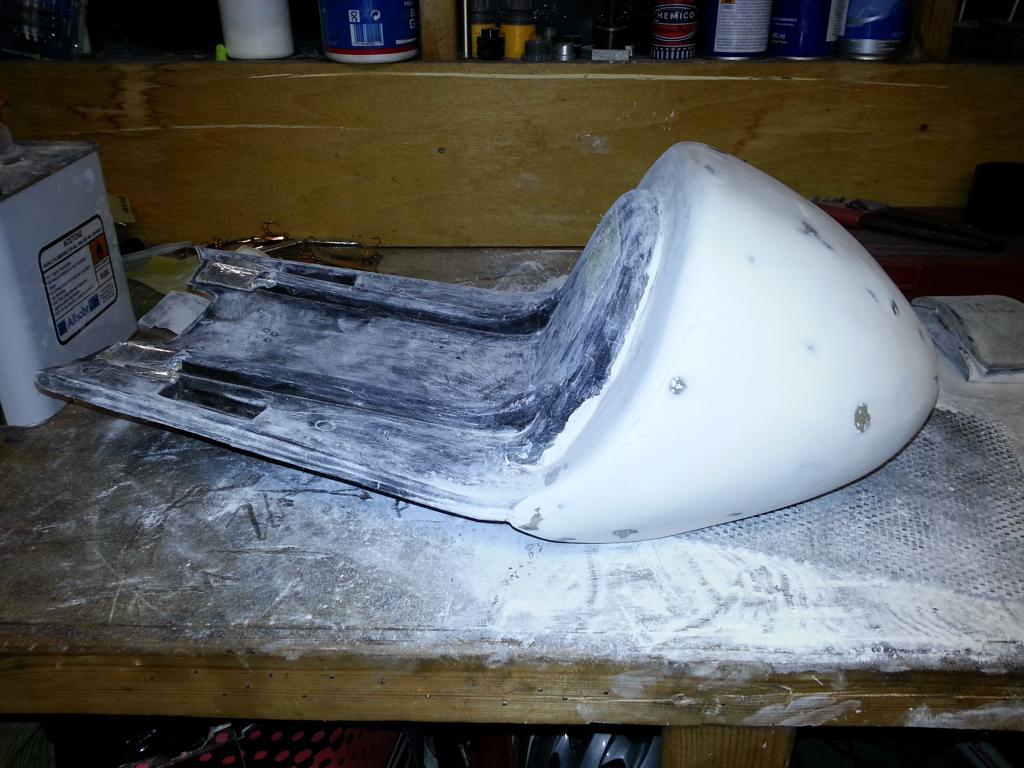

  7. Never. Ending. Sanding. :Bored:
  8. Has it ended yet?
  9. It's never ending..... apparently!

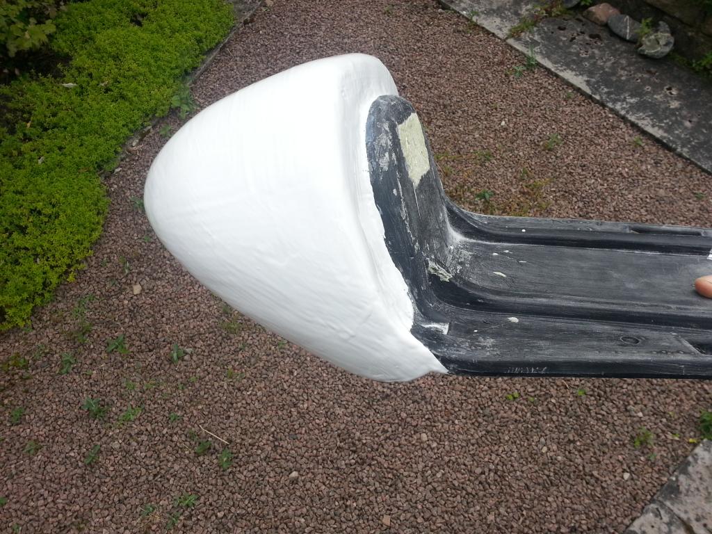

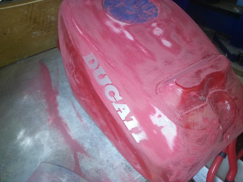

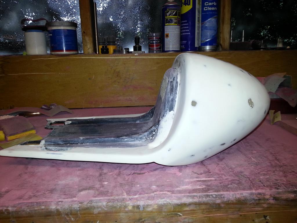

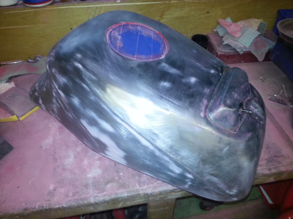

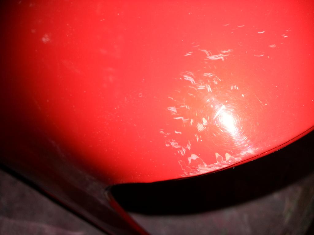

  10. Haha - Yeah, still ongoing!
  11. It's amazing how much dust such a small project can produce.
  12. With the weather being utterly shit, there's been no excuses over the last couple of days so I've been progressing with the build. So with a fair amount of sanding done that's the seat unit good to go. I made the decision to gel coat the edges as well as the back end so as to leave a smoother area between the 'hump' and the edges. Also, the tank has been rubbed down and I've included a photo of the front fender showing the chipping. All 3 items are now going to be given to my painter mate. The new battery has been delivered. It's getting there . . .
  13. fair play Stew for getting those decals off the tank. Not a nice job!
  14. 80 grit did the job Sev!
