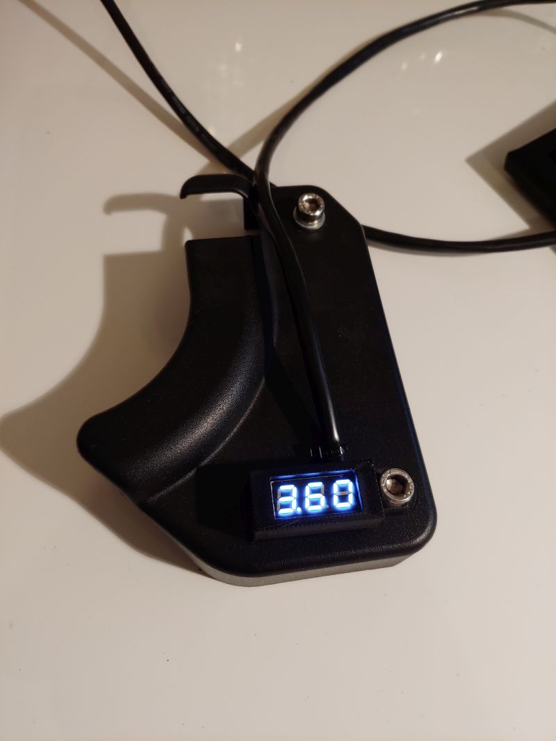

  2. Tested with engine running, idled at ~1500 revs and showed 20Vac. was at around 2500 revs and it showed 30 Vac. Should be ok. Ordered a new part from Stein Dinse because I don't have to adapt the wiring loom. It's a drop-in replacement witouth over-voltage protection so I'll be fitting a Voltmeter, connected to the output of the regulator.
    Tiny, should'nt disturb much. Can be removed without a trace. Shows from 5 to 30 Volts with 1% deviation.
