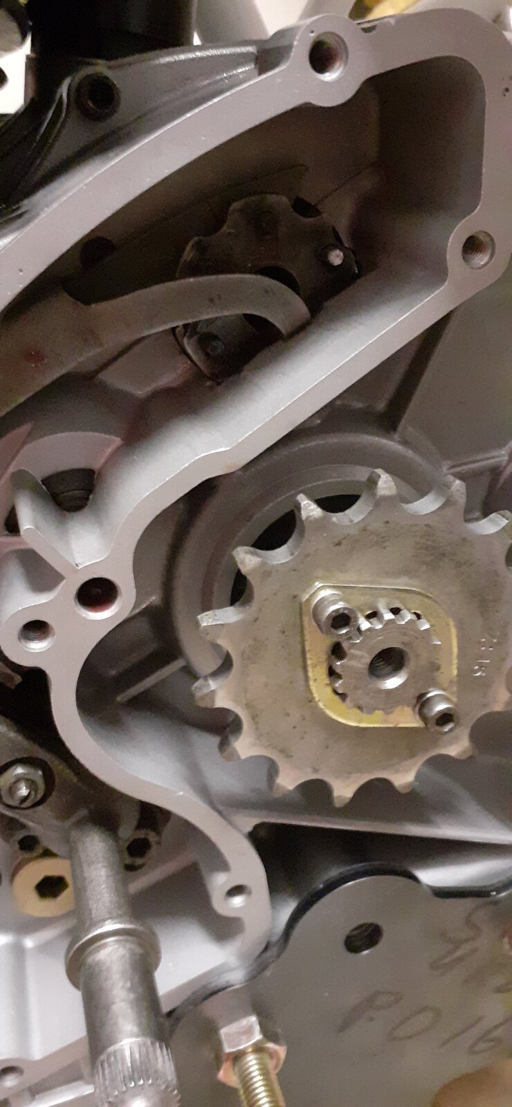

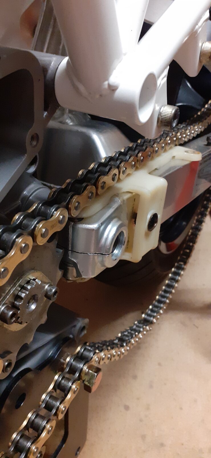

  6. Next one.
    I put the chain guide on and emediately it looked out of position. There is a raised section on chain guide which I presume corresponds with the rollers on the chain.
    This looks to be way out, see gap to swing arm.
    I did buy a second had chain guide. I will have a look and check if the one fitted is the original.
    Anyone had similar problem.
    Cheers Gaz
  7. Yes, when I put in a different gearbox and the shaft was longer
  8. Desmo,
    This is the original set up. Just hoping it's the wrong chain guide.
    Cheers Gaz

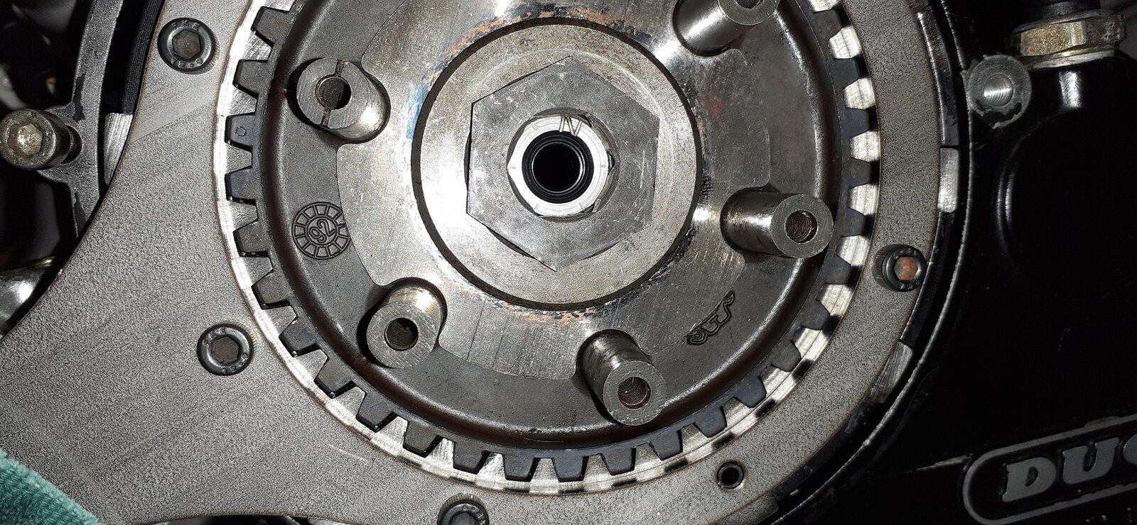

  9. Conflicting Clutch Centre nut torque values.
    Had a search on forum and both 140 & 180/190 are quoted. Haynes says 180/190, ducati workshop manual says 137/147.
    1992 model - anyone got a definitive answer.
    Also there is a mark on the end of the shaft - does that need to line up with anything I can't see it mentioned anywhere.
    Cheers Gaz
    #49 gaz92, Aug 30, 2022

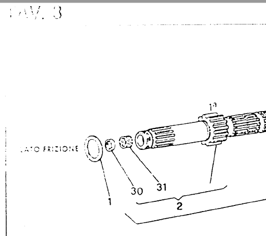

  10. Another question.
    Just watch a video (Andy's MC Obsession) and noticed he put a shim in behind the clutch hub. I am pretty sure I kept everything together but don't seen to have on. Not sure but think its item 1 see below.
    Also there are a few different size shims, how do you decide which one?
    Cheers Gaz
  11. Ok peep your time is up.
    1. Going 137/147Nm as per Ducati workshop manual.
    2. Don't think the marks on the shaft line up with anything - looked at quite a few videos and people seem just to put the hub straight on with out checking anything.
    3. I might have been mistaken about the shim or spacer again can't see it on other videos.
    Sorry for confusion
    Cheers Gaz

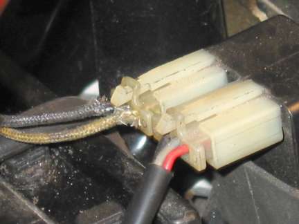

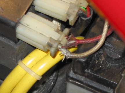

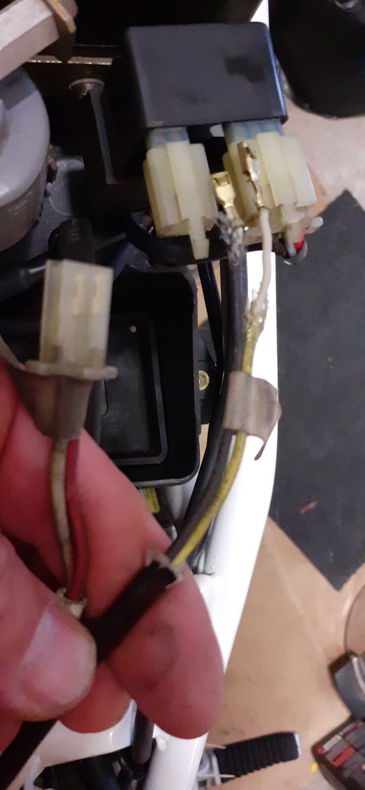

  12. Got a photo of left ignition (red cable right white left) can't see from my photos and I think it was covered in tape which side black and yellow is.
    Would appreciate anyone with a 1992 900ss if they could have a quick check.
    Many thanks on anticipation.
    Cheers Gaz
  13. According to Brad Black (from the other Ducati forum) left to right is red white black yellow.
    Image sent
  14. Sorry, should be white red black white - dementia rules.
  15. Here are pictures of the pick up wires to the igntion units taken when I had a 900SS 15 years ago.
    Horizontal
    Vertical
    Hope that helps.
  16. That's great thanks both of you.
    Cheers Gaz

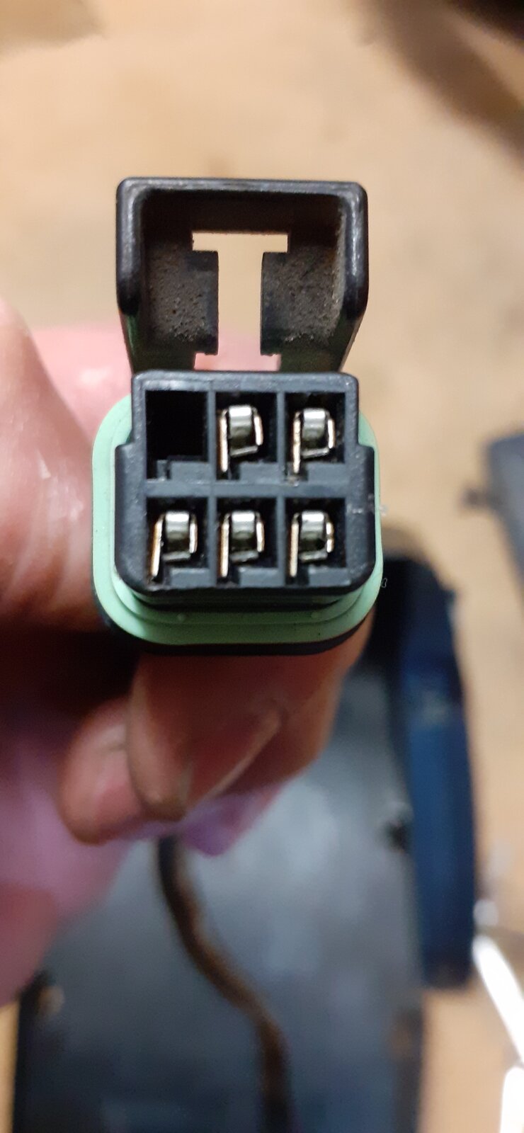

  17. Been trawling Internet for info on this connector and de- pinning, got fed up, anyone know what it is and how to de-pin. Rear brake light and indicators.
    Cheers Gaz
  18. Ok, so you can't de-pin them.
    I think it's called a Metri-Pack 150.2 pull to seat which means it's put in backwards hence no de-pinning facility.
    Cheers Gaz.
