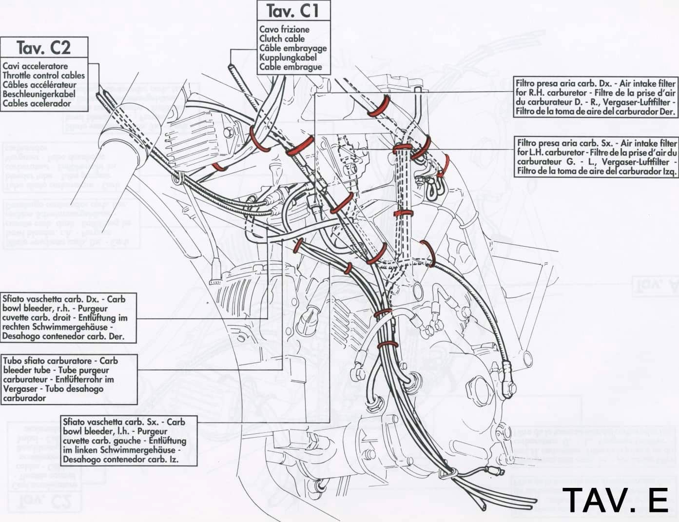

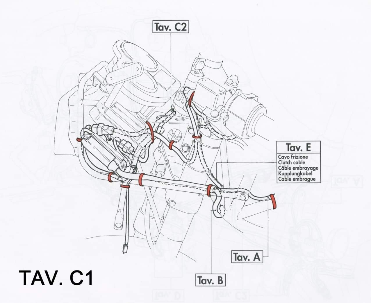

  7. You have probably already seen this one.
  8. And this one

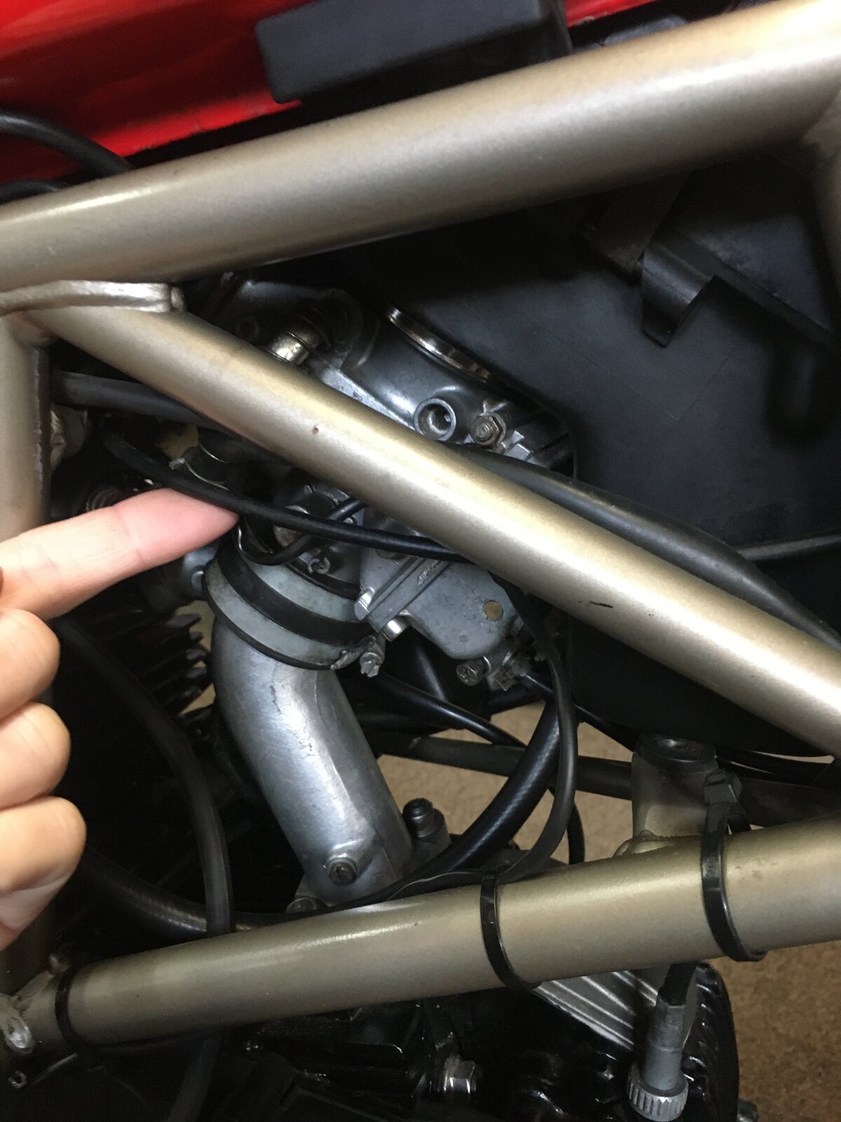

  9. Apologies, Apologies, I am a Dufus (sorry it was late I have a new dog which is keeping me up and will blame it on brain fade).
    Its the choke cable that is coming up a bit short. I have got a set of these picture Roadtrip thanks very much.
    I have the choke cable coming off the carbs and running in a downward direction along a diagonal brace in the frame and tie wrapped (the horizontal one in the picture and exiting frame at my finger). I am wondering if I should direct the cable upwards to the top member of the frame to shorten the run.
    Cheers Gaz
    #69 gaz92, Jan 13, 2023
  10. From memory, the choke cable ran alongside the air box at the top frame member
  11. Derek,
    Makes a bit more sense, I was trying to hide cables behind the frame to neaten it up (a bit of OCD), but think I need to let this one run where you said, thanks.
    Cheers Gaz

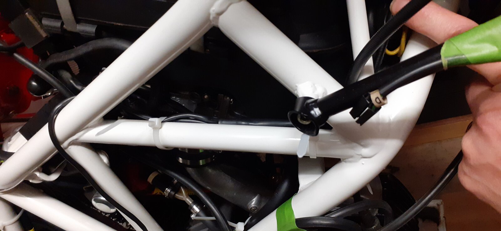

  12. Not to say mine is 100% correct but it works, loosely hanging not clip tied to the frame, would try to avoid cable/frame rub if possible.

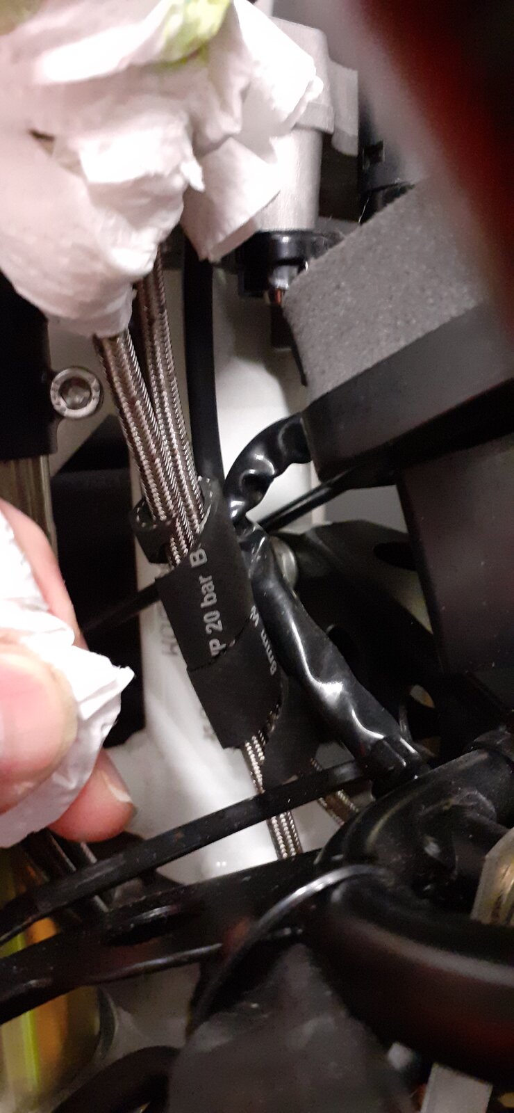

  13. Roadtrip, Thanks, yes will take the ties off and let it run free. On the brake hoses I cut some spirals of fuel hose to help with rubbing, at least it will protect one part.
    Cheers Gaz
