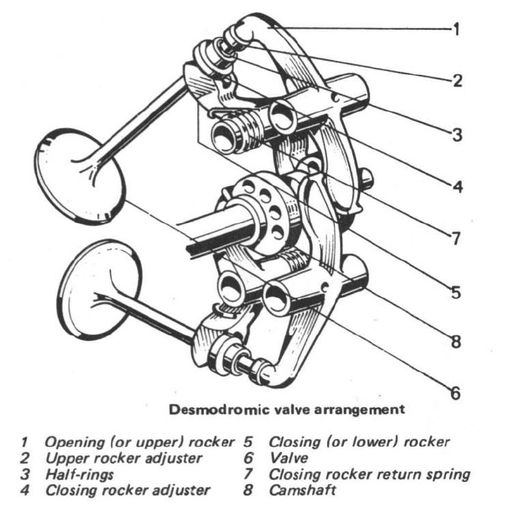

  4. Thanks, I'm learning about my bike, which makes me happy. I think a diagram would help at this point though.

  8. I think I'm mostly there with figuring out how the desmo system works...just a couple of things outstanding:
    -The gap between the cams and followers/rockers - presumably there's a thin film of oil which prevents the wear but still allows the cam to act on the follower?
    -If the valve clearances are set cold, what happens as the engine warms up?

    Oil is fed to all components in the Desmo to prevent wear, but yes, basically your on the right track.
    The clearances are in there to allow for the expansion of components due to temperature.
