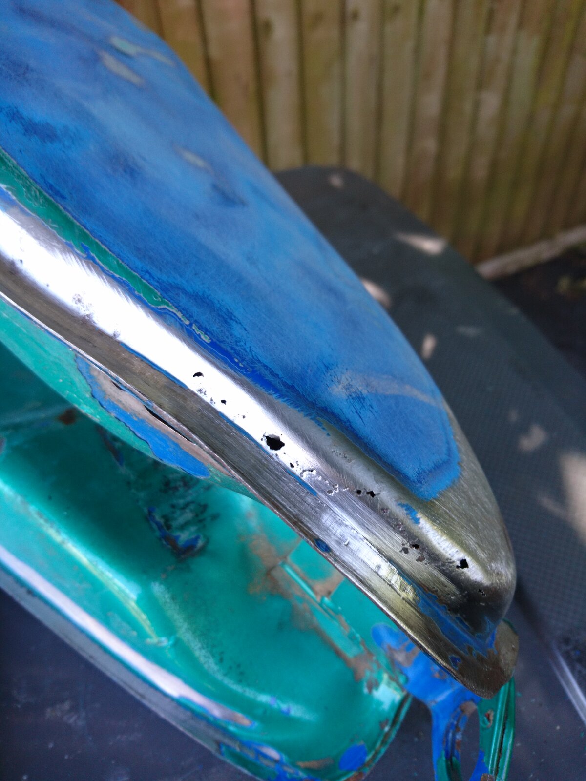

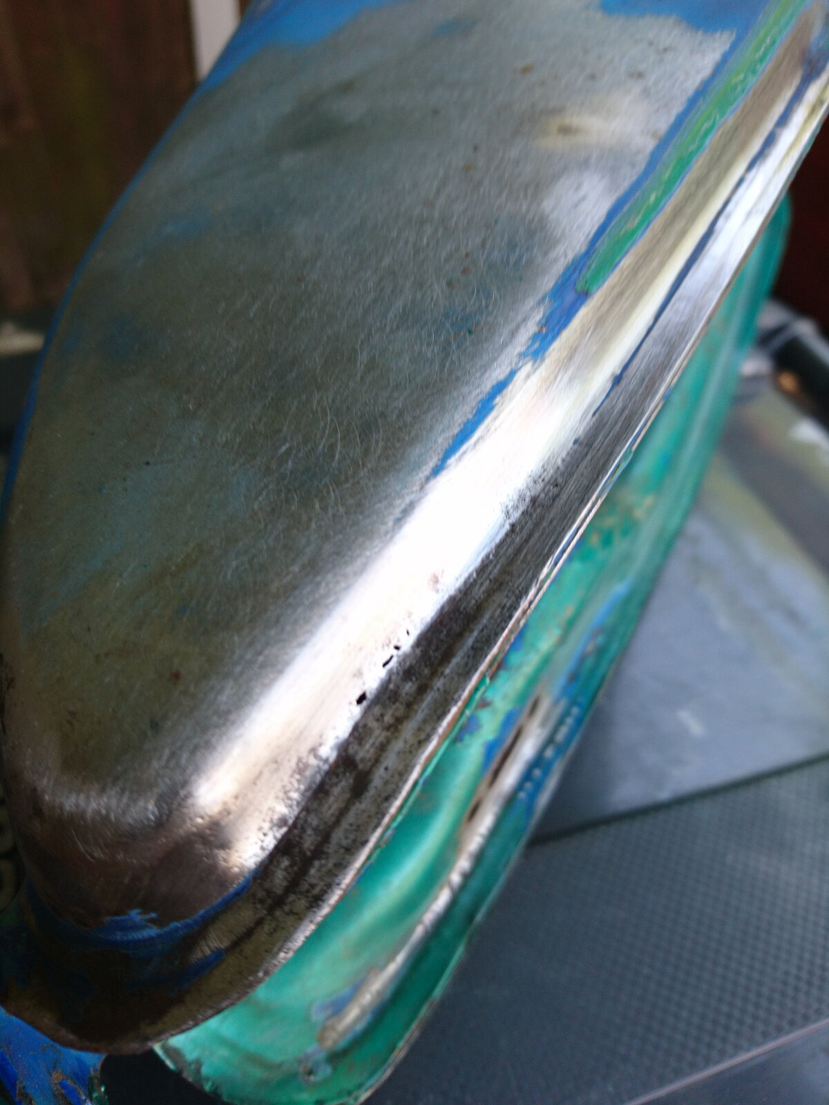

    I've since rung around a few places and bike engineering types and they all reccomended Frost for repair stuff. Apparently the repair material must be designed to be ethanol proof. So I bought their "fix the pinholes from the outside" gloop. £22.
    The two pics show the pinholes. I will let you all know if it works in a week or so.
    I have a spare tank, so this is test to see whether it really works. If it does bonus!
