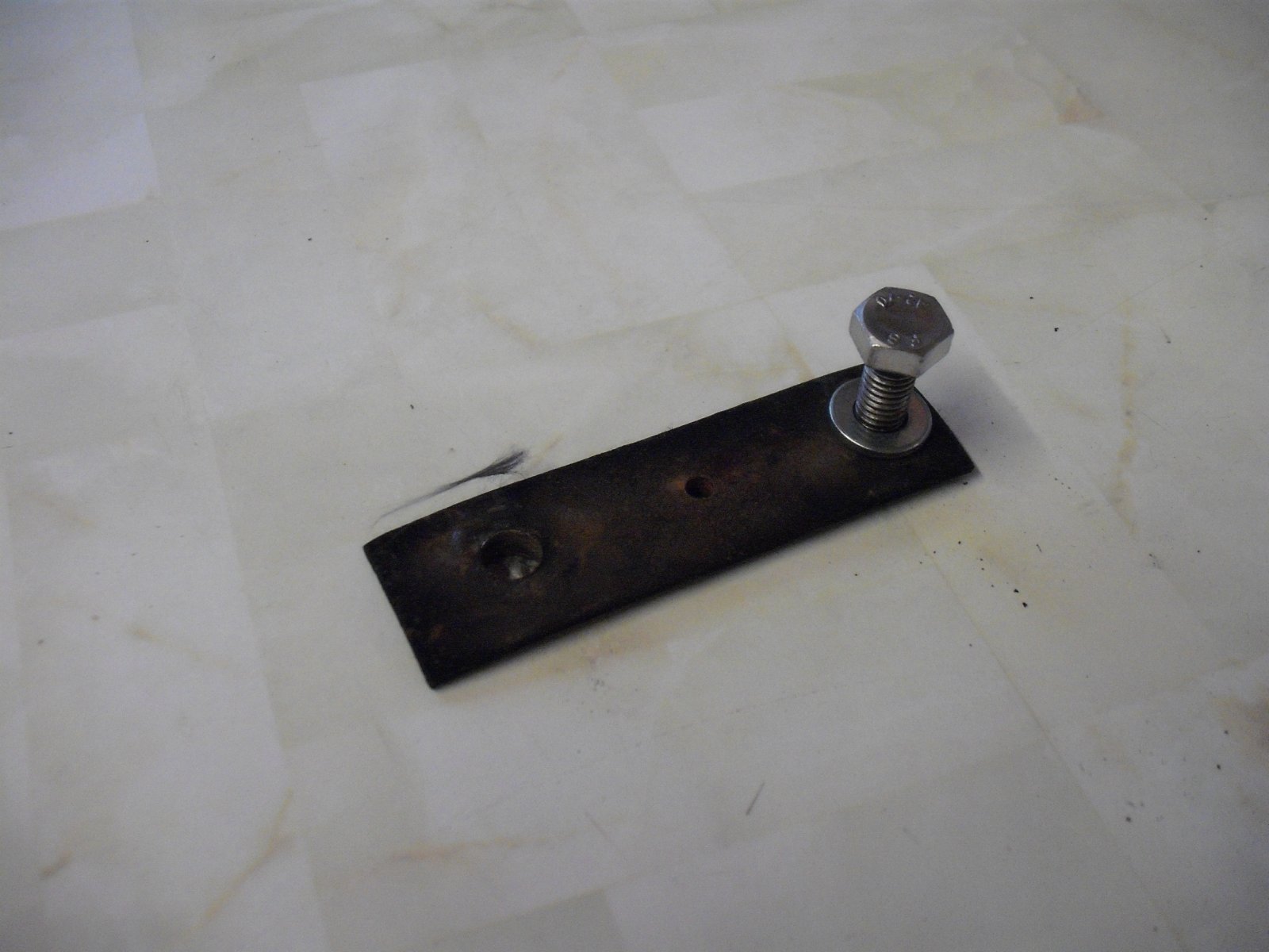

  2. inside my cans were plates with a thread in for the bolts
    held in place with a rivet

  3. Thanks, guys. No, these must be different to the Monster cans (though I can't see why; my Termis are labelled 'Monster', so the fit must be the same...). I can't push the sawn off end in at all, and what's under the skin can't be a plate, 'cos it turns freely. (the plate would be a better solution) I can see that if I could cut/grind the bolt to below the level of the can then I could drill out the rivets on the end (yes - rivetted) and slide the skin off, etc. I'll scratch my head about it some more....
