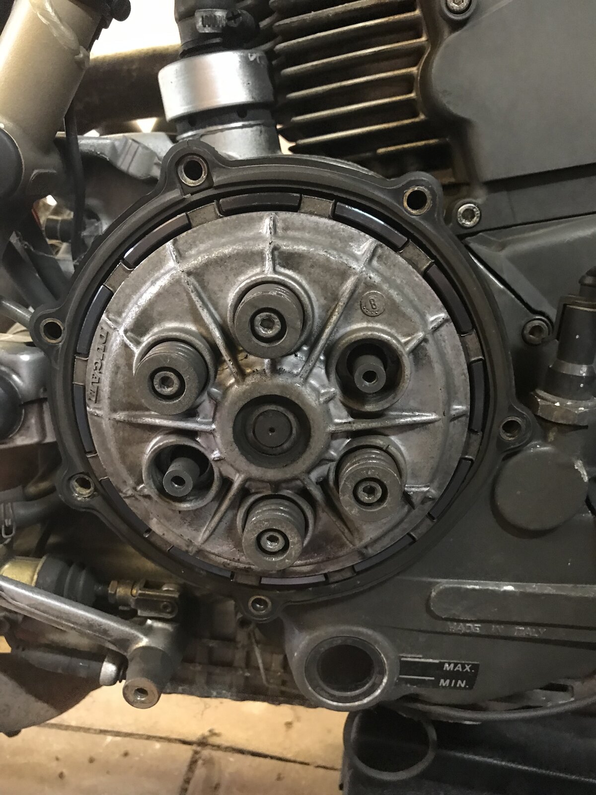

    Thought I’d try removing a couple of clutch springs to see how much difference it makes.
    I was surprised how much lighter it felt at the lever.
    While the cover is off is it worth stripping and cleaning the clutch ( not had any problems with it). If so how is best to clean it ?
    Would using an airline with it assembled do any good ?
  4. Now your there I'd take off the other 4, remove all the plates (keep them in order!), clean them, check their thickness, clean out the basket with brake cleaner, dry & reassemble. It'll take maybe 30 mins.
  5. That makes sense. Will have to get some brake cleaner tomorrow.
    Can I use that on the plates too ?
  6. Piece of coat hanger wire is good to keep them in order and to hang them up to clean off with brake cleaner. Will feel like new once you reassemble.

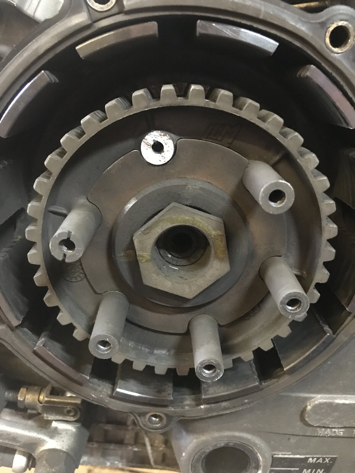

    If I’m not fitting two of the springs, will I get away with still using this ?
  11. Yuck. How did that happen? Provided all the bits are out of the clutch you may get away with it but in the long run it’ll have to be replaced sometime.
  12. Crappy Allen head bolt, tapped a slightly bigger torx in and when I turned it it broke off. Perhaps it was already weak or something.
    Still got to clean it all out so shouldn’t be any bits left in there. Will get a replacement when I can but money for bike is very tight at the moment.
    Will probably try it and see how it goes o_O
  13. I would run it myself but replace at earliest convenience
  14. Yes, I think I will try it and see, unless someone comes along and shouts ‘NOOO’ before I get it back on the road. (Could be a while).
    I can’t see it causing any other damage though.
  15. Battery needs to be a minimum of 12.6 Volts to be functional - if it never gets above 12.3 V, chuck it.
    When fully charged, 13+ Volts is normal, but it will drop down quite a bit in a day - so expect to see it around 12.8 V after two days with no use.
    Change the clutch basket as asap. Had one similar on our outfit - I saw it coming through the outer casing while I was over the side - and then it exploded completely, luckily I had moved out of the way to tap the driver to tell him to stop.

  20. If I am going to replace the clutch where's the best place to buy from. I had a quick look about and Stein-dinse seemed ok, though their website won't load now.
    Perhaps a stupid question too, but will I get away with just replacing the broken center, or should I replace the whole clutch ?
