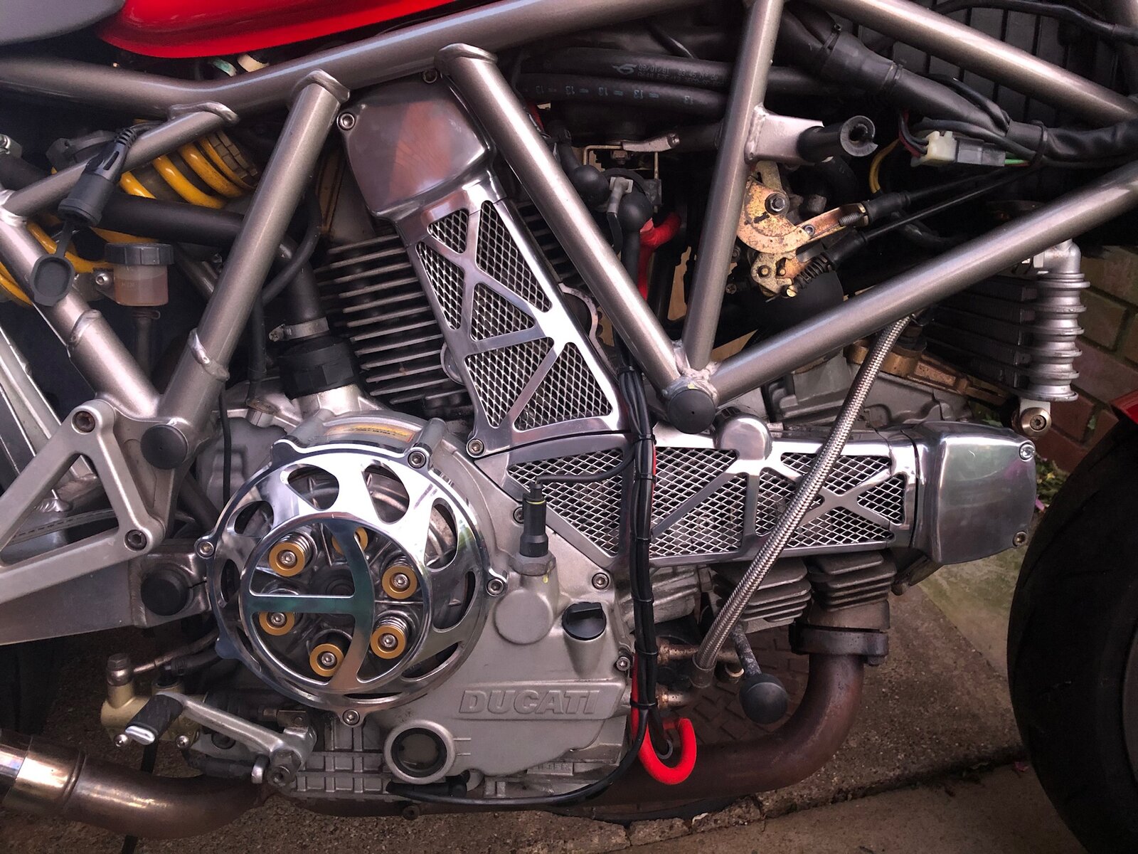

  8. Yes, clutch is back together. To be honest it wasn’t until after I’d assembled it and pulled the lever that I noticed.

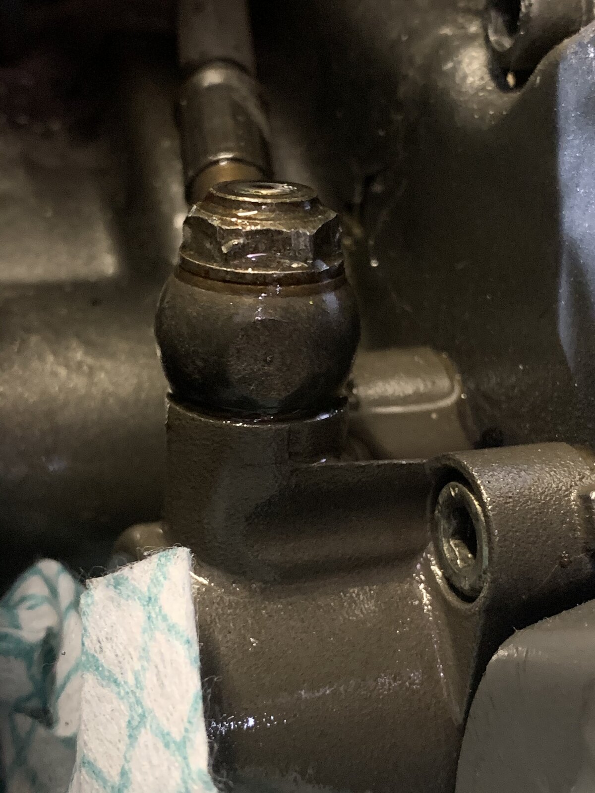

    Clutch Bleed nipple broke off.
    Think I might just leave everything loose, what could go wrong then o_O

  10. Managed to get the bolt out, will have to order a new one and bleed nipple.
    Not sure if it’s me but a previous owner appears to have tightened everything far beyond what is necessary.
    Is there a good place to order a ‘complete’ set of bolts ?
    Looking closer today and most seem to be nearly rounded off already.
  11. That's the main problem with used motorcycles, the Arnold Schwarzenegger mechanic, always to tight and nothing done by feel! You could look here for parts, it's where i get most of my bits but someone might know somewhere else.
