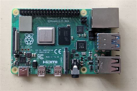

  3. I think that is Windows only unfortunately, I have been looking at GuzziDiag too - which has a Linux version, but that doesn't seem to work on a raspberry Pi.
  4. I just did a quick search and found an old Arduino-based project (looks defunct tho'), so there's stuff out there. I'm also interested in a Pi or similar CAN project but unfirtunately haven't the time. I'll search again tho and post again if I find anything. The JPDiag bloke is worth talking to - looks like he does it to help people... Have a search here too - there have been many CAN-diagnostics questions...
  5. I might join the JP Diag forum and ask the question there too.
    Wondered about the GuzziDiag one having a PI version, as it already has a Linux version.
    My thinking is a Pi based diagnostic tool, maybe even permanently mounted somewhere to record the data too.
  6. What on earth is a raspberry pi :thinkingface:
  7. IT witchcraft Paul - don't ask :bucktooth:
  8. I guess a starting point would be a Can interface for the PI, something like this
    https://www.amazon.co.uk/USB-Conver...9Y2xpY2tSZWRpcmVjdCZkb05vdExvZ0NsaWNrPXRydWU=

  13. Looks like GuzziDiag uses OBD (ELM327) to connect to the ECU.
    For what I'd like to do perhaps getting GuzziDiag working on the PI will do it.

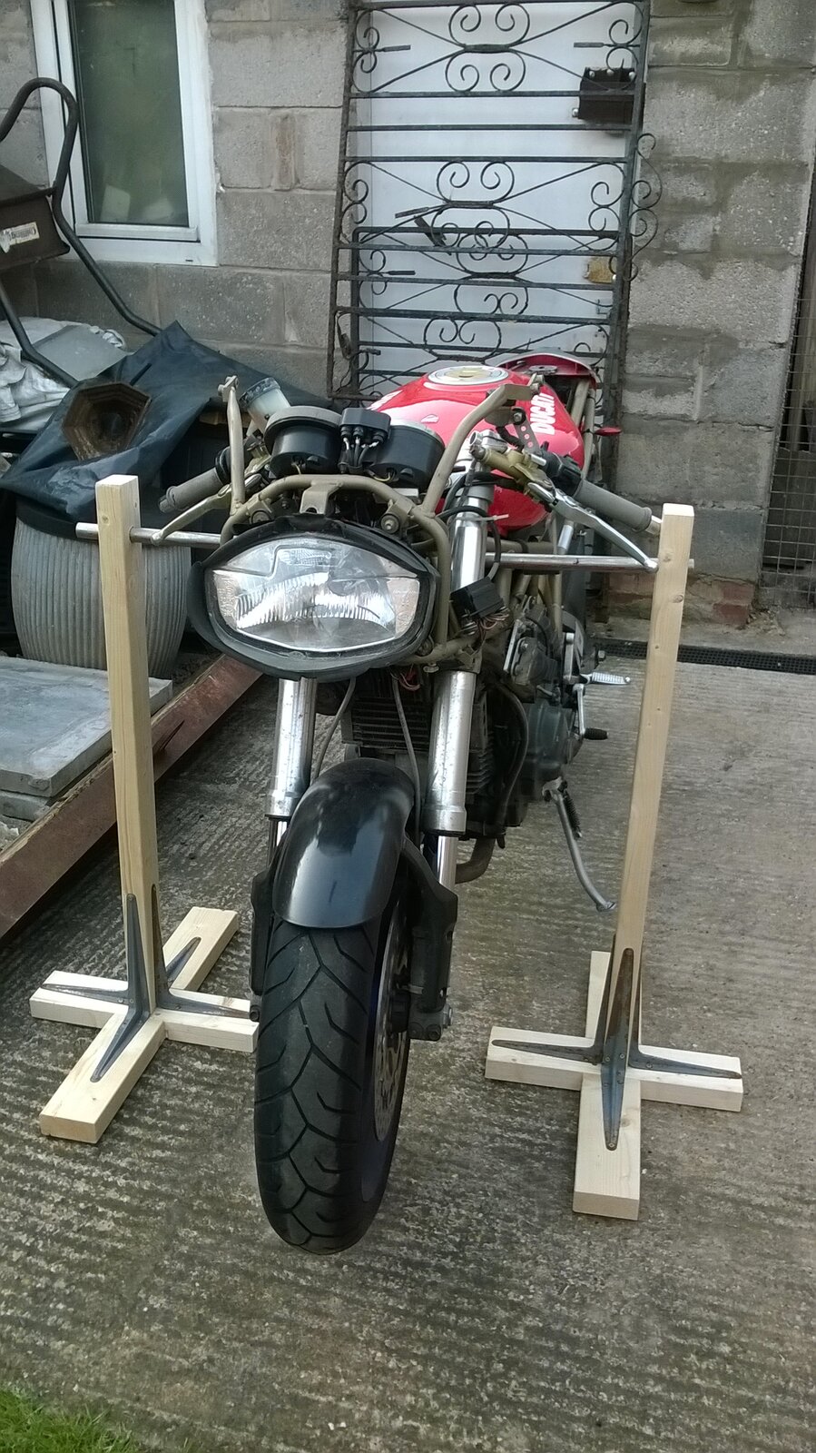

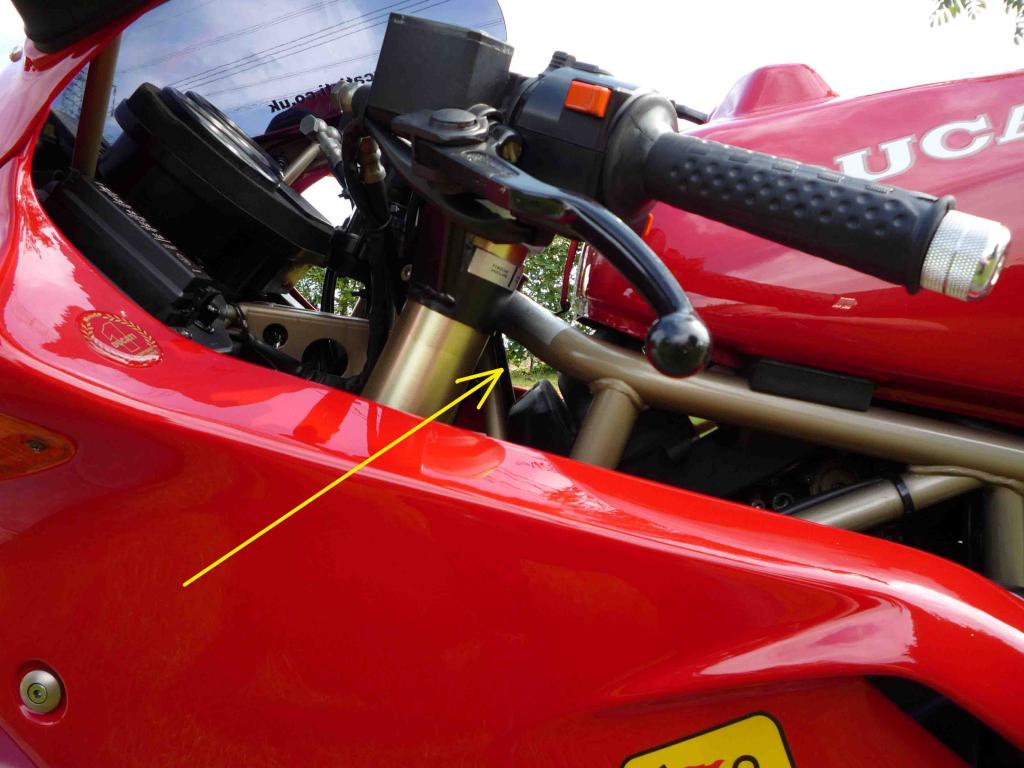

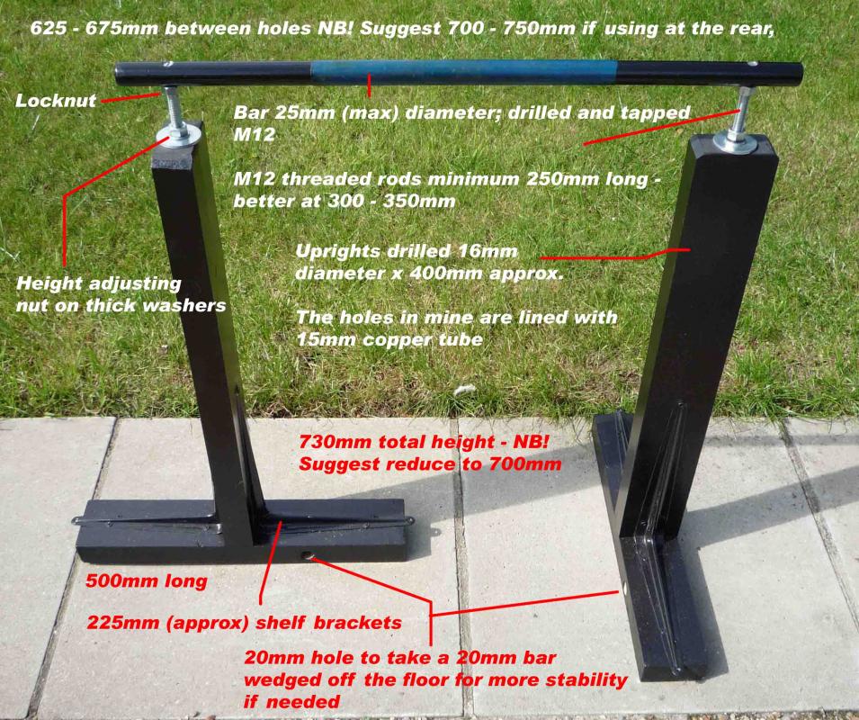

    Any way to ‘Jack’ the front up without taking the exhausts off ?
  16. If the bike is supported on something like an Abbastand or axle stands below inverted rider footrests you can put a jack under the starter motor. Put it as near to the starter flange as possible to minimise the twisting moment on the crankcase as the starter on these models isn't supported at the other end.
  17. Bricks under the front tyre :thinkingface:
    You're welcome :D
  18. various ways to suspend the front of the bike probably easiest way is is al's licenced stands with a bar through the frame at the headstock first 2 pics curtesy of al
  19. By Al I guess you mean @Arquebus ?
    A while back he'd said he no longer had a need for his stands, I was going to buy them but didn't get round to sorting it out. Don't think he has been on the site for a while, hope he is ok.
    I like your version too, perhaps have a go at that myself, thank you.
