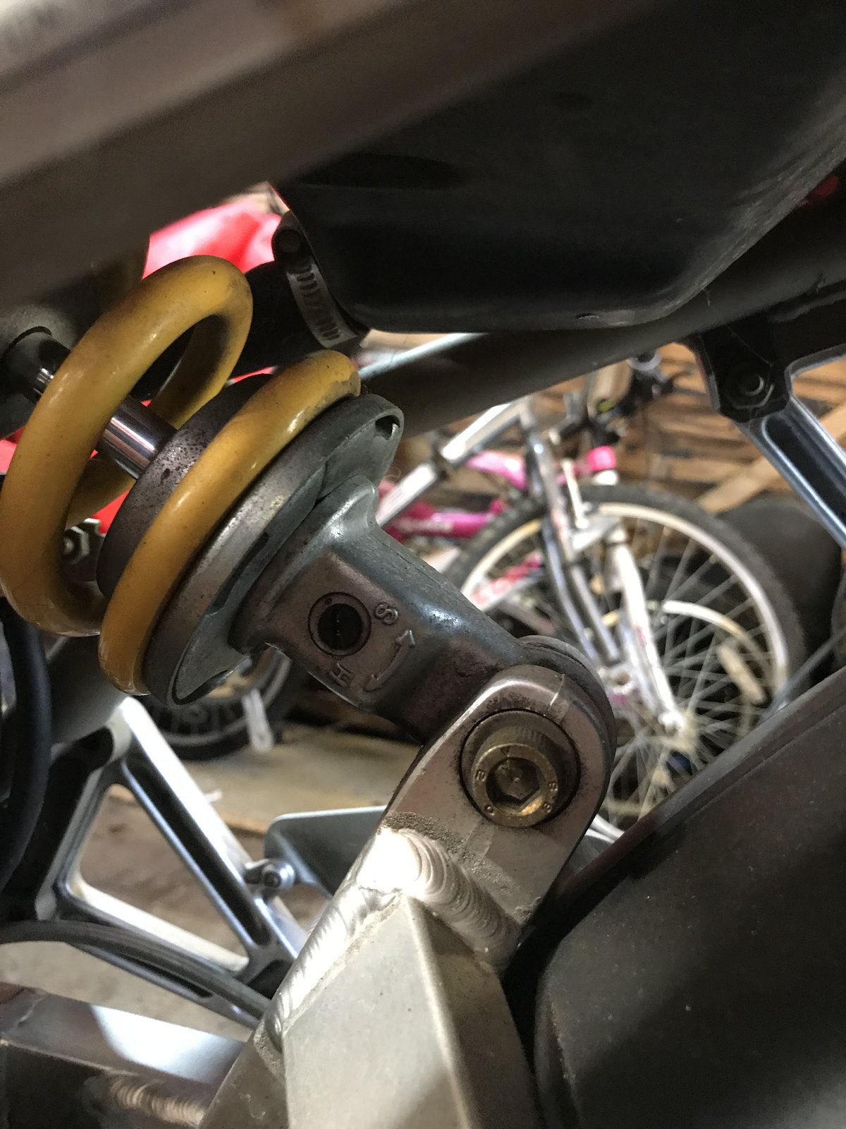

  2. Perhaps he was a shorta*se like me; but it would be interesting to know if the bike still has an OEM rear shock, or if he fitted a longer one which would speed up the steering as well.

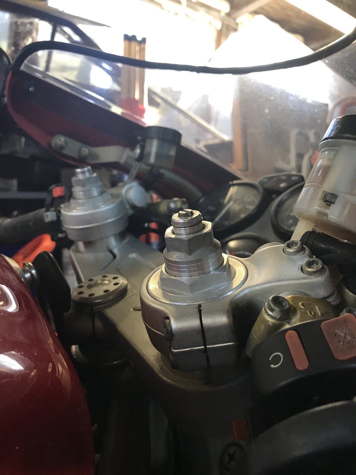

    The front felt very firm to me too, not sure if it’s been modified.

  12. Suspension would appear to be OEM Showa front and rear (I don't think the front are Marzocchis). If it is very stiff at the front, you could try easing the preload a bit - anti-clockwise turns of the 'nut' below the slotted adjuster so another ring shows. (Keep a note of what you do, in case you want to put it back).
    I see what you mean about the fork tops though - the clip-ons are roughly in the right position on the fork tops, but the forks are definitely through the top yoke more than I would expect.
  13. Will try setting everything as standard and see how it feels then I think. May well try lighter oil in the forks though.

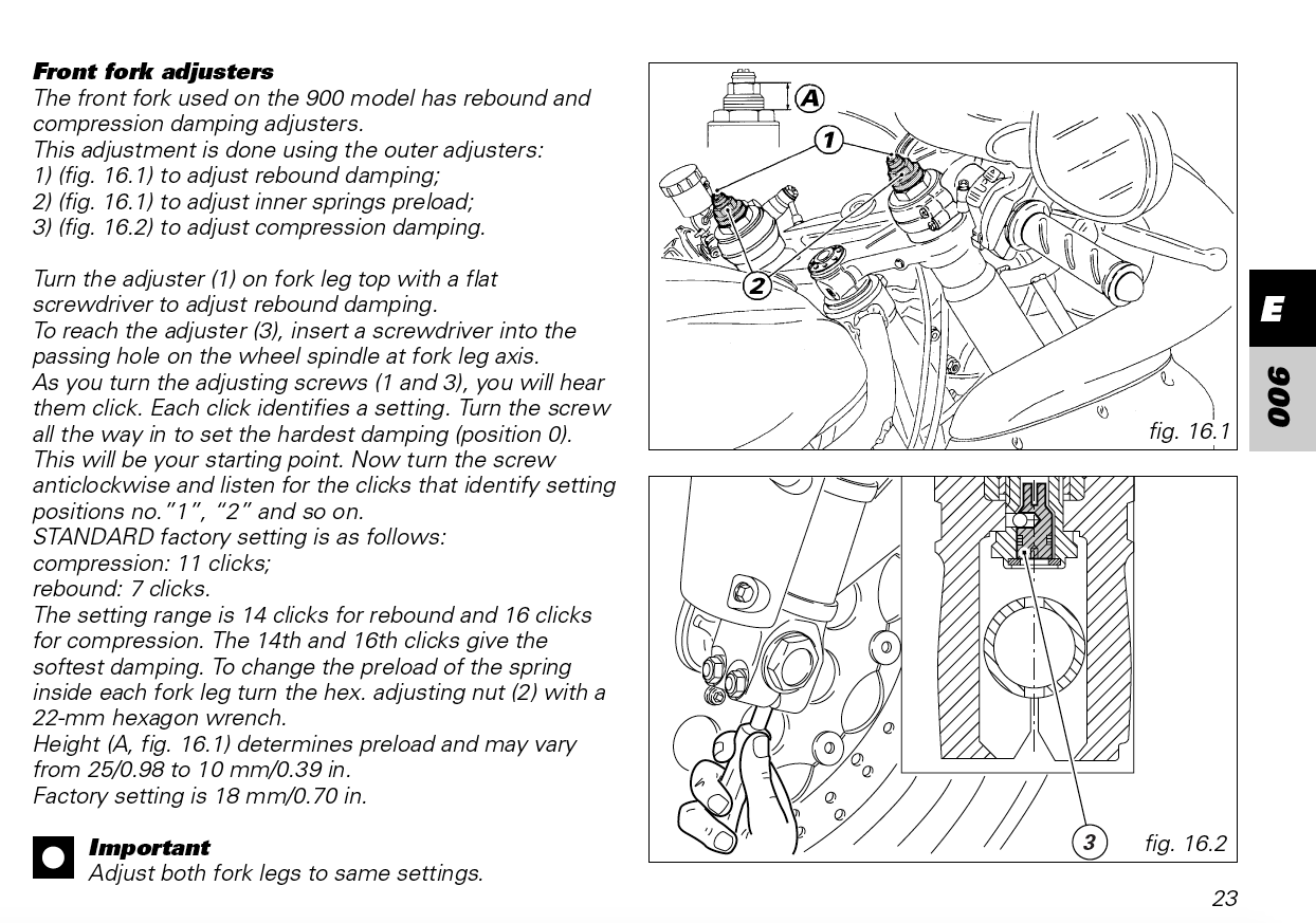

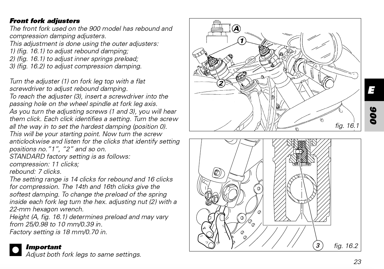

  14. Standard settings for front forks, assuming std 7.5 w oil :

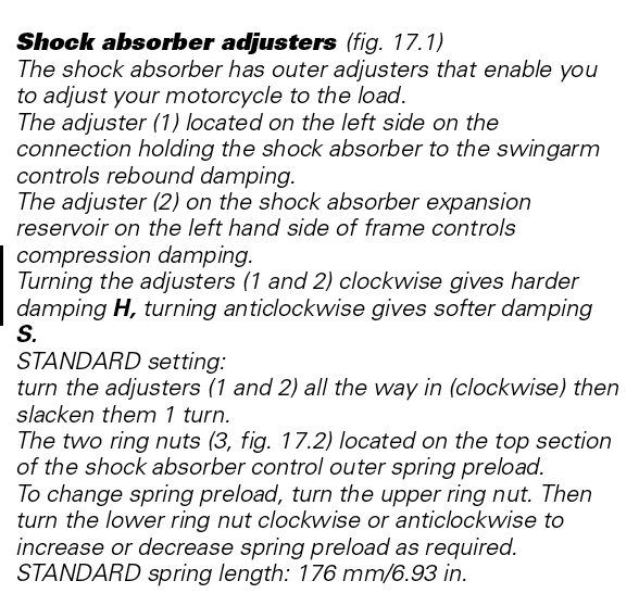

    And for rear shock:
  15. Thank you for that, is it from the Haynes manual ? I have one somewhere but don't tend to use it much :D
  16. No, it's from the official Ducati manual.
  17. I should get one really.
  18. Hard to read.
    The English translation from Italian is rubbish
