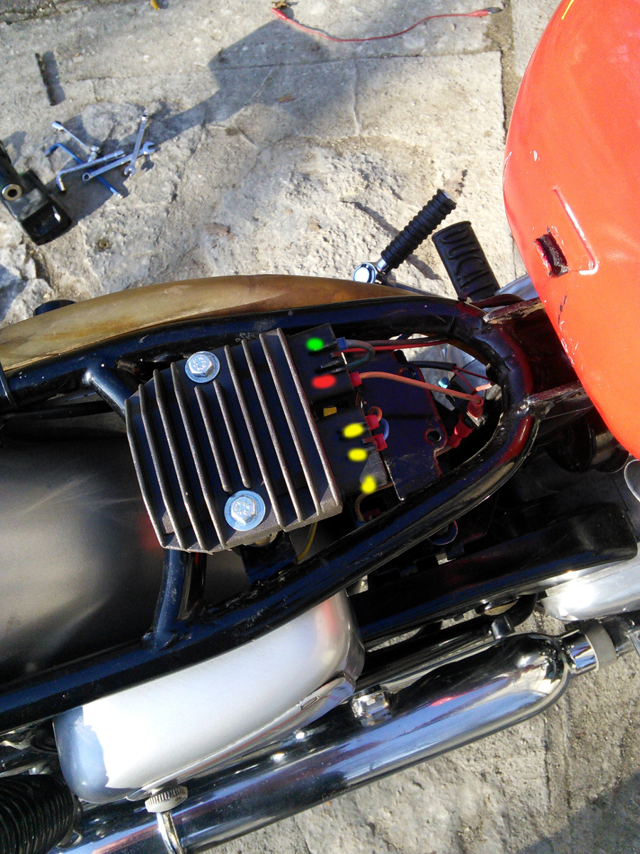

  1. My 750 came with an RR51 two wire Electrex reg/rec.
    Never gave me any trouble in seven years although I suspect it would have done if I hadn't sorted out the wiring and connections properly.
    Basically the RR51 is so simple to fit - no hacking about of anything, uses the same backplate to aid cooling etc - disadvantage IMO is cost.
    However, a mate of mine had a good idea to improve the cooling the OEM reg/rec on his 900 SS - in addition to the ally backplate, he reverse fitted a scrap OEM one to the back plate after having dug out the guts. It was then mounted below the original frame mounting point, so it didn't foul anything.
  2. If the original is working ok, what's the advantage in replacing it??
  3. The original has had its problems in the past, before we owned the bike. The connectors have burnt at some stage and someone has done a poor repair on them. I will change the reg/rec for a mosfet one and rewire it anyway. That way the charging system might prove more reliable. The ST2 system is a very weak point on the bike and knowing this I fitted a voltmeter ages ago.
