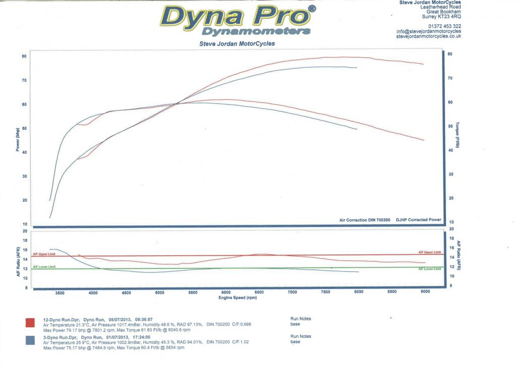

  1. After the bike dumping it fuel tank over my engine twice in the last month I ended up replacing the float seats, needles and mixture screws on the flatslides. I decided enough was enough and booked the bike ito a rolling road setup at steve Jordan motorcycles in Great bookham.
    Yesterday I went to pick her up. Steve had to wait for main jets to arrive, gone are the days of the dyno station with draws and draws of flatslide jets of all shapes and sizes.
    He changed the main jet to a 150 and set the float height to 12mm. I haven't checked what the mixture screw was set at but one thing is certain compared to what it was like before it pulls like a train and also there is a noticeably different bark to the exhaust not, its so much more crisp and sharp.

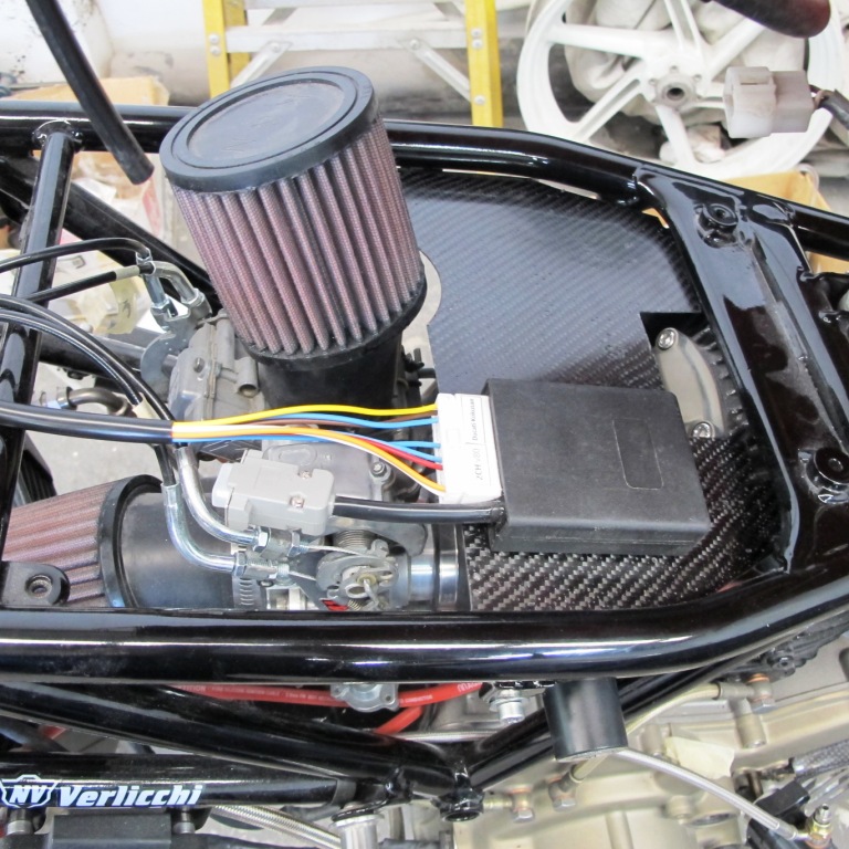

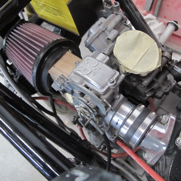

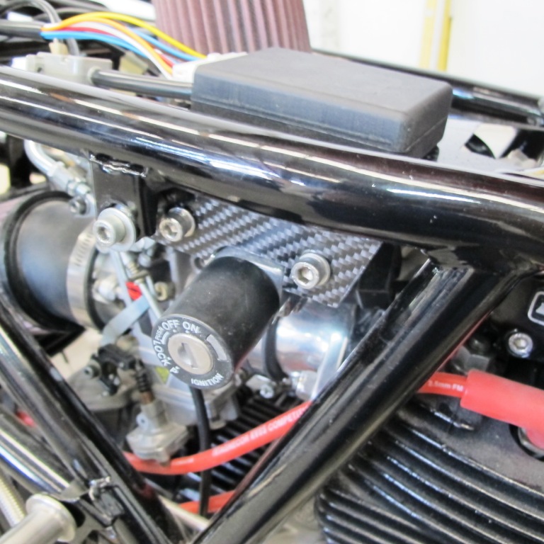

  11. Hi Sev
    I had the same dilemma when I started rebuilding my '89. The solution I've ended up with is to make a carbon fibre plate for under the tank, which the electrics sit on-hang off (Ignition barrel off one side, starter solenoid off the other). And I've mounted the coils well away from the Ignitech, hanging off the lower frame rail. See pics. Over the course of development I decided I wanted to turn the bike into a torque-beast with 90mm long CNC machined velocity stacks - represented by the bit of 2x4 in the last pic. Had to make sure I could get them in! - so I made another battery box with the battery (the yellow thing in the carbon thing) mounted longitudinally in front of the vertical FCR.

    I'm really impressed at how you've packaged this, and the end result looks superb. How do you find the split fcr's over the downdraft pairs?
    The close ratio box... how cool is that!
    With the ignitech did you alter the map at all or is it as it came out of the box so to speak?

  13. Hi Sev, sorry for your loss mate.
    Actually, I'm still (re)building it - have just run out of money in the meantime. I'm documenting the build on Ducati MS. 1989 Supersport Performance Rebuild is the name of the thread. Can't wait to sample the results! The close ratio box is only really a benefit for racing (this is my road bike) but, like everything on my bike, it was 'different' so when it came up, it was a handy replacement for mine which was stuffed. Yep, I'll revise the Ignition map: have put DP cams and adjustable pulleys into her and am going to add a TPS, so will have to carefully dial her in. Big job.
