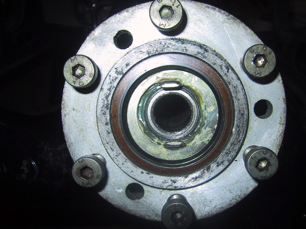

  1. I think I will correct myself before someone else does. Had a niggling feeling so measured the parts with verniers and there is a difference in wheel gear dia and worm gear dia all be it very small and the housing the wheel gear goes in is also different. So to the naked eye they do look the same but dig deeper. So as AL says drives not interchangeable, lesson learnt.
    Cheers,
    Gaz
  2. You aren't showing the main bit......you need to show the big drive washer and the hub recess.
    AL.
  3. Hope this is what you want.
    Cheers
    Gaz
  4. Earlier carby wheel and drive washer.....
    ...axle / bearing I assume is 17mm?
    AL.
    #24 Ghost Rider, Jul 21, 2012
  5. Update:
    The shop replaced the speedo drive p/n 49810081A ('96 bikes on) with p/n 49810071A (pre '96).
    Just posting this in the unlikely event anyone finds themselves in the same situation.
    Now have a properly working speedo.
    Thanks to everyone's help.
    Cheers,
    Humbug
  6. Well, there you go.....however, the drives don't really relate very well to the year of registration or year of manufacture of a bike........It's all down to the wheel and the date stamped on one of the spokes.....and I can't tell you exactly when the change took place, which is hardly surprising as I don't think Ducati can either.
    As I have mentioned before, the easy way to tell instantly without removing anything from the bike, just look at the retaining lip for the brake disc on the speedo drive side.
    If the lip is approx 4mm wide, it's the later wheel; if the lip is approx 6mm wide, it's the earlier one.
    AL.
