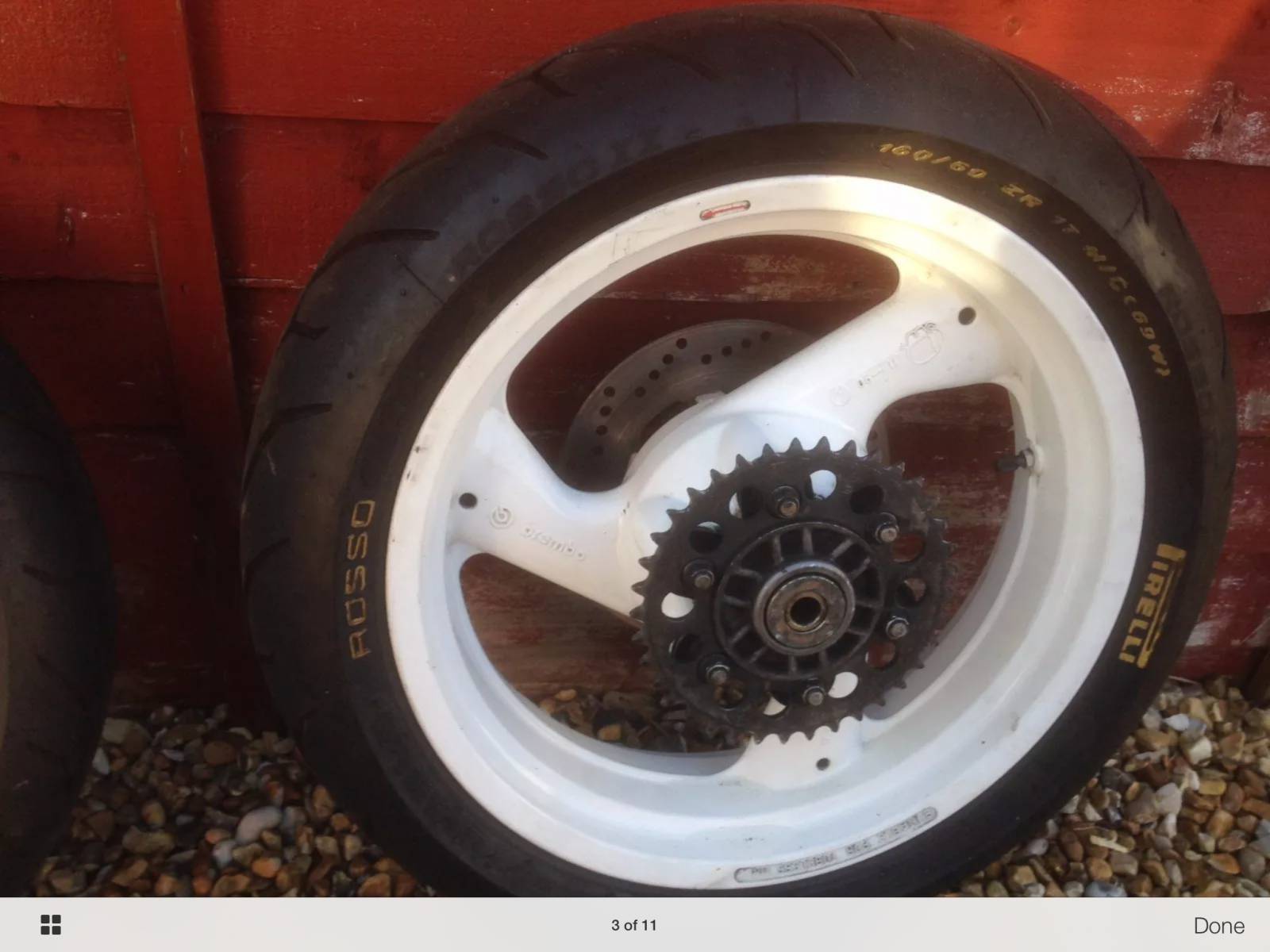

  4. This is the rear with brembo and cagiva elephant
  5. Apart from the ellyfant, it looks the same as a carbed SS one........What's the axle diameter and wheel rim width? Should be 17mm and 5.5"; and the diameter at 17".
    The front will cause you a problem...........There are two axles sizes on the carbed SS (17mm and 20mm).....although the bearings and internal spacers can be changed to suit whichever axle, the machining in the two hubs for speedo drives is entirely different as are the actual speedo drive units......basically not interchangeable.
    So you will need to establish which speedo drive you have and hope that it will fit one of the carbed SS wheels.
  6. Thanks for your help, I should never listen to flea bay sellers that they will fit no problem.
  7. Don't take my word for definite that they won't fit or can't be made to fit..............but I'm certain you will have problems, particularly with the front.
    'Chris' on this forum should be able to confirm one way or the other.

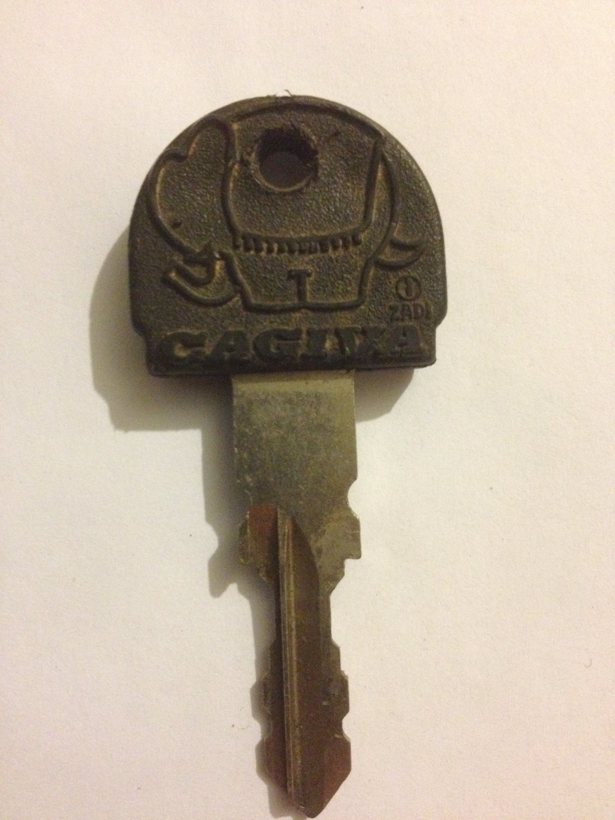

  18. As you probably gathered, it's not from an Elefant - sorry PompeyPete. The only non-spoke wheels fitted to an Elefant were on the 125 2-strokes and they were narrower/different cush-drive/smaller axle. It looks like an early wheel as fitted to first belt 900/750SS (around 89/90) and then next carb 900/750SS and also 851. Interchangeable with later Monster as well providing axle checked out. Cagiva always had a thing about putting their Elefant logo* on every part on their bikes particularly around that era regardless of whether they were manufactured 'in-house' or not. (Ford U.K. were the same I know from personal experience). They even put it on key at one stage!
    *and nothing to do with the 'Elefant' models either necessarily
