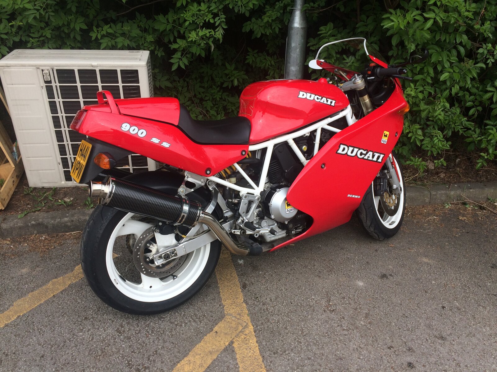

  11. 8533F7FC-598F-4746-8BD5-1398FDBFEFED.jpeg When I first rebuilt the carbs on mine I fired her up and was gutted to have a steady backfire from the horizontal cylinder, approx every 10 seconds BANG!, then I remembered I hadn’t set the mixture screws, doh!, one more turn out on that carb and the bike ran perfectly, phew!, that was a few thousand miles ago and she’s never missed a beat, it surprised me how quickly she starts from cold after sorting the carbs, barely turns a full revolution on the starter and she’s running, hopefully it will all go as well for you tomorrow.
