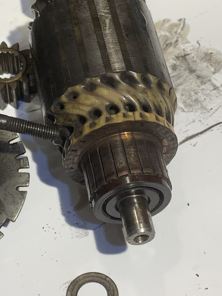

  1. I had similar issue with 298 - starter just stopped turning. In the end I discovered it was petrol in the oil, eaten through the starter gasket. I had to replace the starter motor.

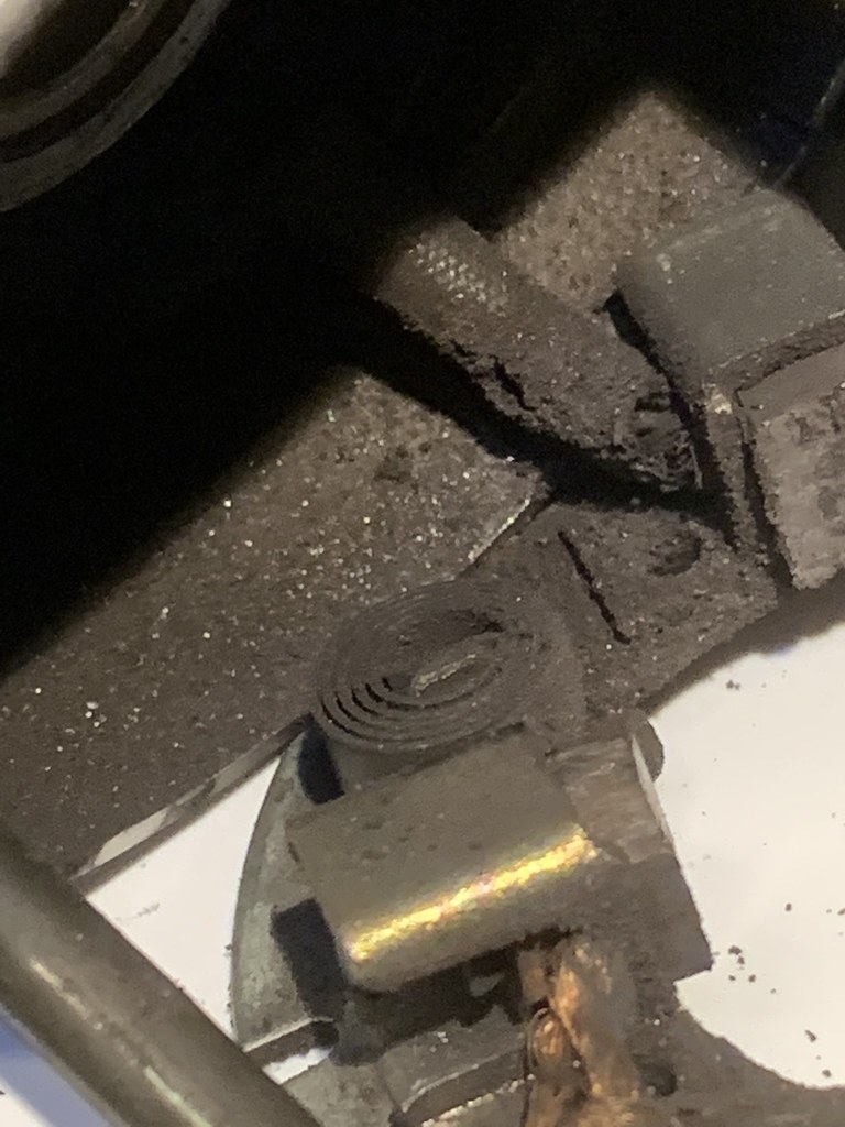

  2. Looks like you’ve had your money’s worth out of those brushes :upyeah: Great you’re getting going again.

  5. Short update,
    Replacement brushes came through really quickly, however a little jiggery pokery was needed as the bakelte insulator and positive connection post were ever so slightly different from the original.
    Nothing a little filing and sanding didnt cure, Anyhow, starter motor tested, back on the bike and now works great.
