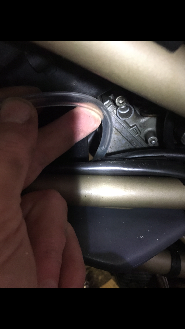

    If you connect a clear tube to the float bowl drain and hold it upright, it will give you the fuel level in the bowl.
    As far as I am aware, that level in the tube should be near that casting line or, 15.5 to 16.5mm below the bottom of the 'Mikuni' word.

  2. Further to Al’s post above I found info on another site stating that with the floats set at 14mm the level in the clear pipe should be level with centre of the circular feature (with pin) on the side of the carb, this confirms the fuel level is correct, It’s possible to set the floats correctly but still have an incorrect fuel level for various reasons, leaking needle valve for example, so it’s worth confirming th level with the clear pipe, photo of my M900 and as you can see it’s nice and level with the circular feature (actually it’s difficult to confirm from the photo due to the angle it was taken at but trust me it was level).
  3. That pin is roughly in the same location as the casting line I mentioned (and roughly the same dimension I mentioned).
    I reckon the OP's problem might be low-ish fuel level in the float bowl (IE 14mm float measurement) and leaking float needle valves.......if the fuel level was higher, it might then be peeing out of the overflow pipes.

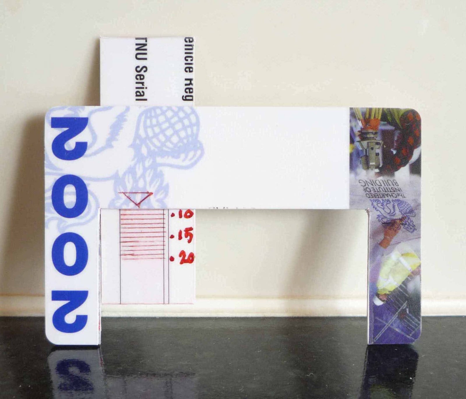

    I made a measuring gauge using two credit cards as the frame, with a sliding cut down card in the middle, but I can't find a photo of it. If I have time I will dig it out and take another photo.
    The photo below will give you an idea, though (and how to hold the carb).

  6. Nice gauge...
    I too made my own but it was much cruder than that, still effective though :)
  7. I didn't make that one.....I think that is a Cycleworks photo.
    Post a pic of yours if you have it handy......I can't find mine at the moment.

  11. Found the photo I was looking for.....funnily enough on this forum.
    Get two cards and cut them both identical so the legs are straight and will sit across the float assembly without touching it and the bottom of the legs sit on the gasket face.
    Take a third card and trim two pieces the same size as the legs but full height.
    They go between the other two cards as spacers so there is a gap between the middle of the two shaped cards.
    Stick the legs and spacers all together....supaglue worked on mine.
    Cut another piece off the third card and slide it between, if it all fits nicely then mark it in mm.
    The photo shows it reading 9mm float height.

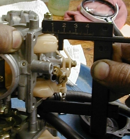

  12. Interesting they show the diamond shape float should be measured, but at least it isn't 14mm on that side!
    I guess there could be a difference of 3mm between the rectangular float and the diamond one.
