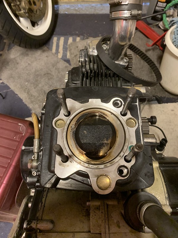

  5. Here is my level marker..... the level is showing a little high as the bike is sat on a paddock stand tilted slightly over to the right.
    Having topped the oil up and triple checked the levels, I started the beast which ran and ticked over fine however as you can see from the photos oil is obviously still entering the combustion chamber and being pushed out the exhaust.
    There is a distinct amount of unburnt wet oil being pushed from the exhaust joint which is spattering over the frame.
    On another note, I cleaned the exhaust pipes out with meths before startup so its not "residual" oil.

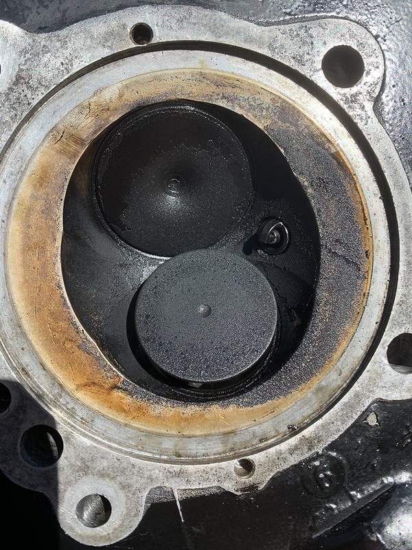

  10. Right folks, back again with this damn oil leak...... An hour this morning separated the frame from the engine. I popped the vertical head off to be confronted with the following.
    I took the head off VERY carefully so as not to disturb any telltales in relation to the oil path.
    What is clear is that oil is getting into the combustion chamber and being fired out the exhaust port, quite a bit of it from the looks.
    In the right of the cylinder looking forward are the oil feed with the green o ring and the two oil returns with the black o rings.
    There is no evidence of oil leaks around these o rings or the oil feed.
    On the rear mating face of the cylinder, there are traces of oil where it appears that oil is being forced between the joint under pressure.
    The head itself appears normal with the exception of being a little coked up because of the rich running.
    I took the head to my table in the back garden in the sunshine where I removed the inspection covers and all appears normal.
    The seals are in as new condition, which is to be expected as the valve guides and seats were replaced in this head.
    just to make sure, I flipped the head over and filled the combustion chamber with meths then went and made a brew.
    Zero fluid loss so all is well in the head dept.

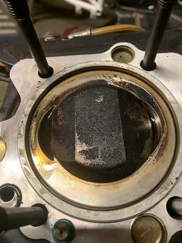

  11. Pull the barrel off and check the barrel, piston and rings.
  12. barrel off and piston out. Its an Arias HH8935.
    No apparent damage to the rings all of which are free moving. there is a tiny amount of wear on the piston skirts which corresponds to the "marks" if you can call them that, on the bores.
  13. although it's hard to see as still coated in oil from dismantling, the two corresponding faces on head and barrel required to seal the combustion chamber don't appear to show evidence of sealing as per usual, so despite healthy compression reading on that bore, it doesn't look to be oil-tight to me.
  14. Hi Chris, this is whats causing my consternation, There is zero evidence of a leak at the o ring seals. If there was I would assume the oil leak to be on the outside of the cylinder between the head and barrel and nothing in the combustion chamber.
    My feeling is that the oil on the mating faces has been forced out of the barrel under pressure together with the quantity coming from the exhaust port. Im not entirely convinced its anything to do with the "outside " of the oil circuit, i.e the o ring seals etc.
    Question, If it were anything to do with the cranckcase breather, wouldn't both cylinders be blowing oil?
  15. yes, both cylinders would be affected by a severely blocked crankcase breather but it's unlikely and would be unusual to affect combustion chambers to that degree. If it did happen, results wouldn't necessarily be identical in both cylinders is the short answer. Did you check breather gauze and pipes to catch tank and air filter? If you had crankcase compression as a result of compression and/or oil ring problems then you would see oil smoke puffing from crankcase breather exit (pipe removed) on a hot engine.Were there signs of excess oil in air filter body?
