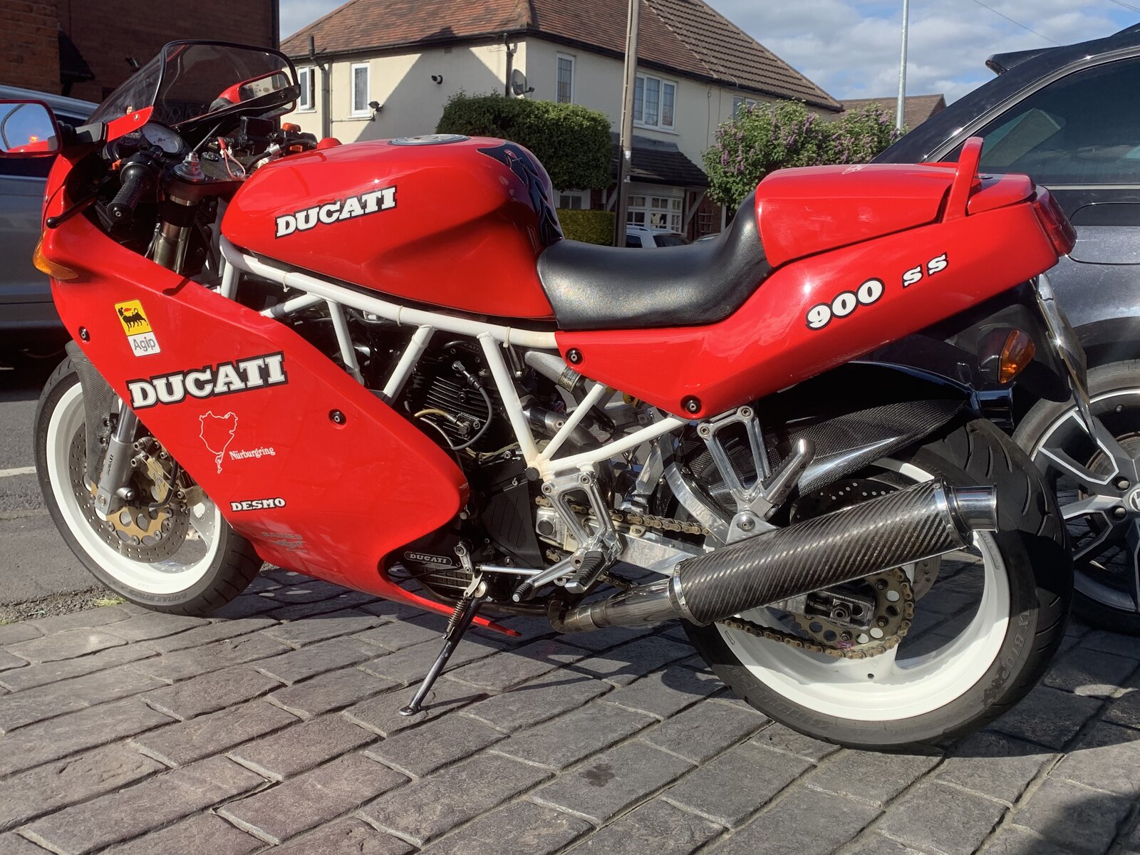

  10. IMG_9002[1].JPG Update. New clutch plates and steels in.
    Clutch bled, Chain adjusted, tyres kicked,
    22 mile gentle test run... she is oil tight strong and extremely responsive.
    Still starts, albeit temporarily, on one cylinder on choke but otherwise spot on.
    No longer a "hangar Queen" . Thanks everybody for your input.
    Just need to re torque the heads and adjust the tickover down a tad and shes a good un.
    One thing I have learned throughout this experience, is not to go down rabbit holes when following oil trails. I never even considered the front pot as being the problem as it had never come to the fore as being the issue.
    The piston replacement exercise appears to be the final piece in this very puzzling issue which at times was like trying to peice together the picture of the tiger on the frosties jigsaw puzzle.
    #130 Phartycr0c, May 17, 2020
  11. Its official, shes back! 110 miles of the running in process completed. The engine is strong long legged and beautifully fueled.
    response off the throttle is crisp and clean and she rolls on without hesitation. Not revved her past 5500 yet but at around 500 miles it will be an oil and filter change and then the shenanigans can progress a little more.
    I forgot just how much fun this bike is. I'm so pleased....
