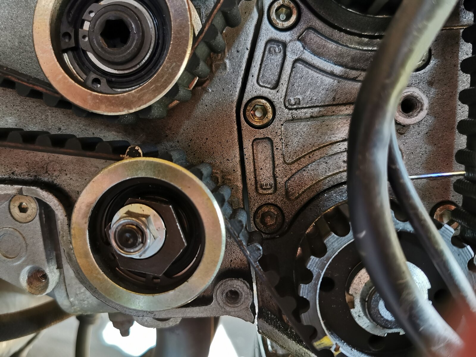

  1. Sorry meant no difference to belt gap when belts tensioned
  2. If they’re a little bigger wouldn’t that put belts closer ?

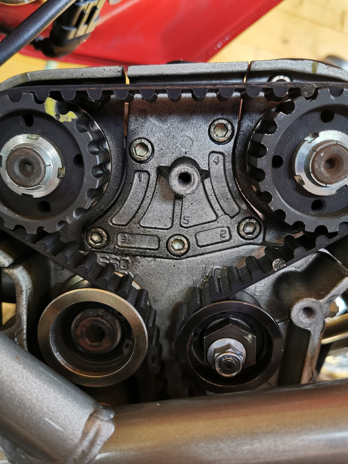

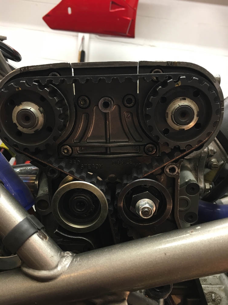

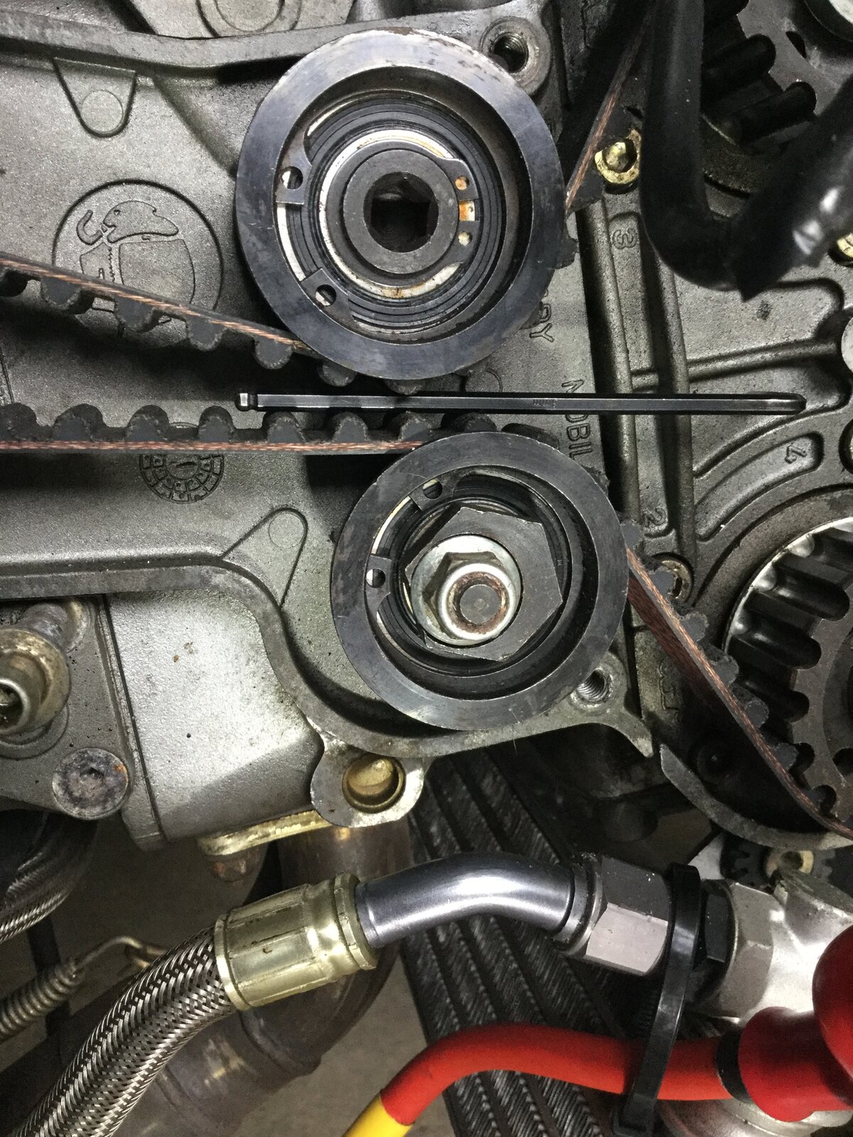

  3. So here’s a pic of the two with some Allen keys in for a rough guide, vertical has 4mm gap while the horizontal has 3mm gap.
    I’d love to see some 916 belts for comparison? D7AF2730-7278-4A41-B94D-86BC30557215.jpeg EAE91531-7AB8-4C0D-828A-55804DD97677.jpeg
  4. No, the bigger radius makes the run further on the roller and the pulley needs to sit further back to compensate. It does make them tighter to get on though.
    My research showed me there were three sizes of roller, each a different diameter; silver, black and gold, each one being a standard fit on a certain model but interchangeable on Desmoquattro engines.
  5. Interesting. Would they be a direct replacement as in take mine off and put these on with nothing else to do.
  6. Funny you should say tighter to get on the last change I was cursing getting the belts on this time it was easy
    I’ve ordered a new set from exact to put my mind at rest
  7. That’s about what I’m getting too , hopefully some one will post 916/996 pics
  8. No, using a larger pulley on one side only will slightly move (advance?) the belt position and so affect the cam timing - not sure by how much though?
    When I did mine I had the head skimmed for more compression which required the bigger pulleys to get the tension on what is now a shorter cylinder height but I also had the cam timing set to suit.

  9. Ok that’s a pity as it would have sorted our problem fairly easily thanks for that
  10. Here's my 916 before the skim work, so a standard 916;
    Not a super close up pic but you can see a decent gap.
    Here it is as is now with 1.2mm shorter cylinder and larger pulley;
    Quite close but been OK for over 10 years...

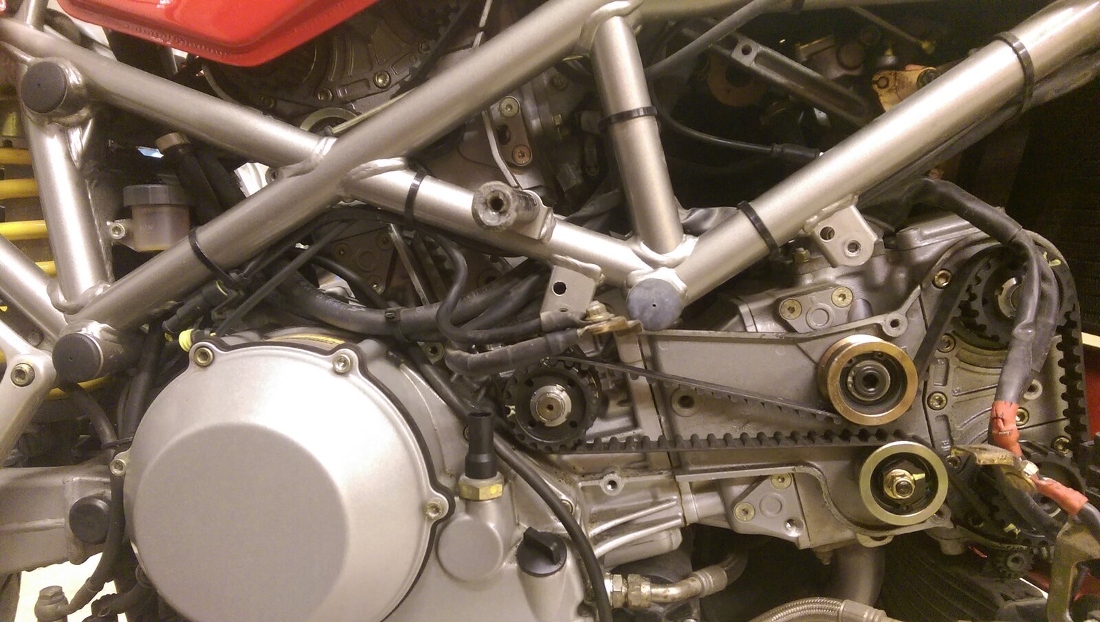

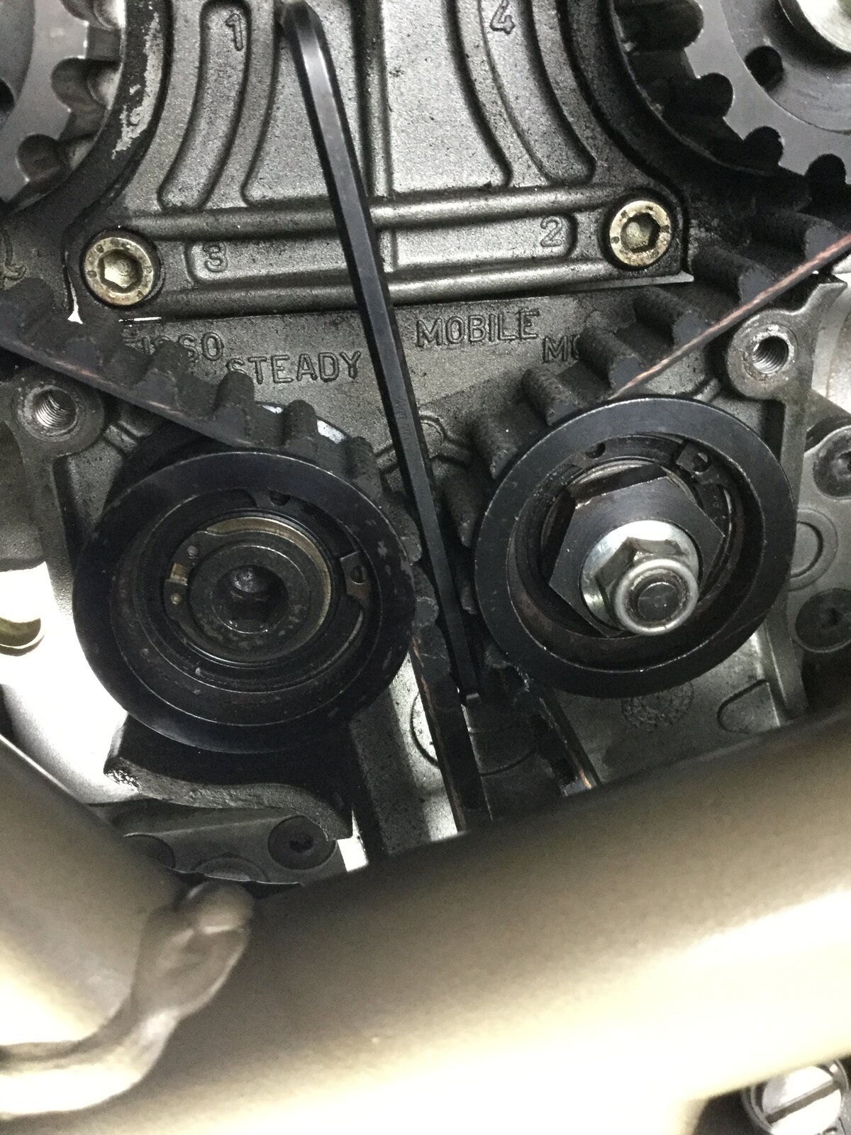

  15. I've just taken these pictures of my belts (ST4 916 engine) before I replace them for comparison of running clearances
  16. I don’t think it’s a problem as long as there is some room. What important is is that the tension is Super correct so the belts doesn’t weave to much, certainly after some use when they slack a bit. If you know what I mean :)
  17. I see you have the gold idler pulleys dukedesmo mentioned..
  18. Time to stop guessing then and get them tensioned correctly. Before I go any further.
  19. They were the standard fitment, it also has the 'Testa Bassa' 10mm lower exhaust camshaft head but I think the idler pulleys are the same fitment as standard 916. Those belts are Exact fit, the original Ducati belts fitted from factory as below;
  20. Agreed ... I've got the same bike , same pulleys
    If I'm not mistaken , the belts are slightly longer than a standard 916 belt ?

    .... I've often read about the 5mm allen key method of setting the tension , but never understood clearly
    what was being described .
    Where you supposed to be able to pass the allen key through ??
