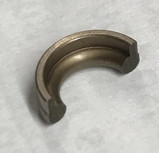

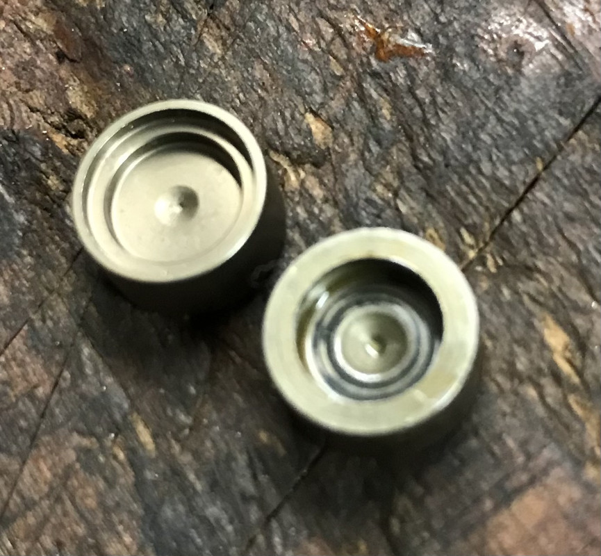

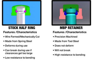

    Like I did for my 900SS, I decided to indulge this Diva with the MBP collets from EMSDuc, sold by LT Snyder. 16 of these little fellows and modified openers are needed for this conversion which will allow less valve lash fluctuation and therefore, more miles between each desmo service (20.000km intervals instead of 10.000km). 599D260F-4E77-4081-AA05-28D41BBFD0F6.jpeg EB79BE4A-4C15-42F3-B83B-100F2380F98C.jpeg 9A1F279C-5342-410C-BD1C-6409F138DDB3.jpeg E8D44E79-00E5-4808-99A4-C46AD4095CD3.jpeg

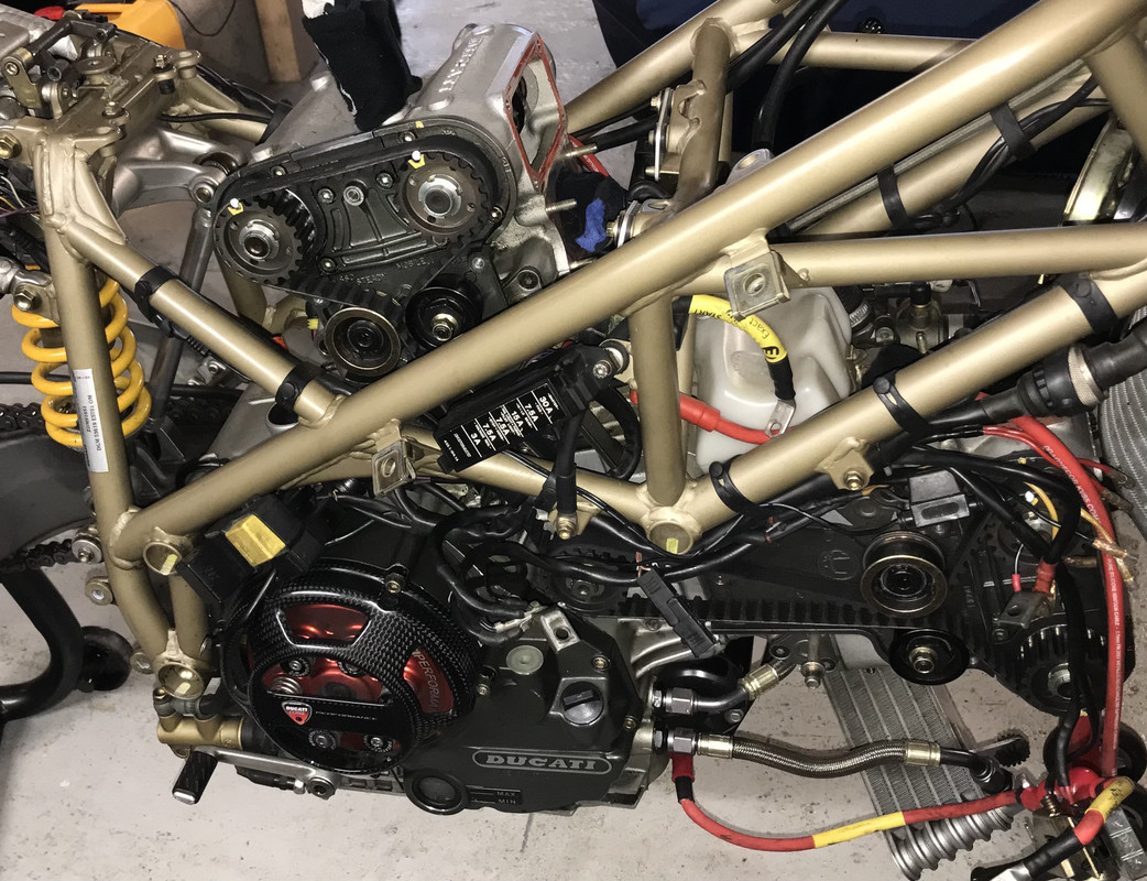

  4. Like it’s been said and written many times, stripping a well maintained clean Tamburini is an extremely rewarding experience. A bit like playing Lego when I was a kid. It’s a very quick thing to do. Everything on these bikes has been designed for that purpose…
    CDBAF4F0-F296-4769-9640-AAA717988956.jpeg 08D67881-9288-41EA-80E7-6B230DF43033.jpeg B6939E61-79D8-4ADD-858B-2BFE3C1AED55.jpeg

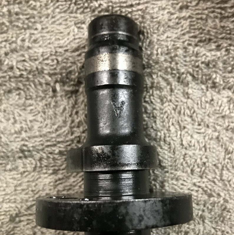

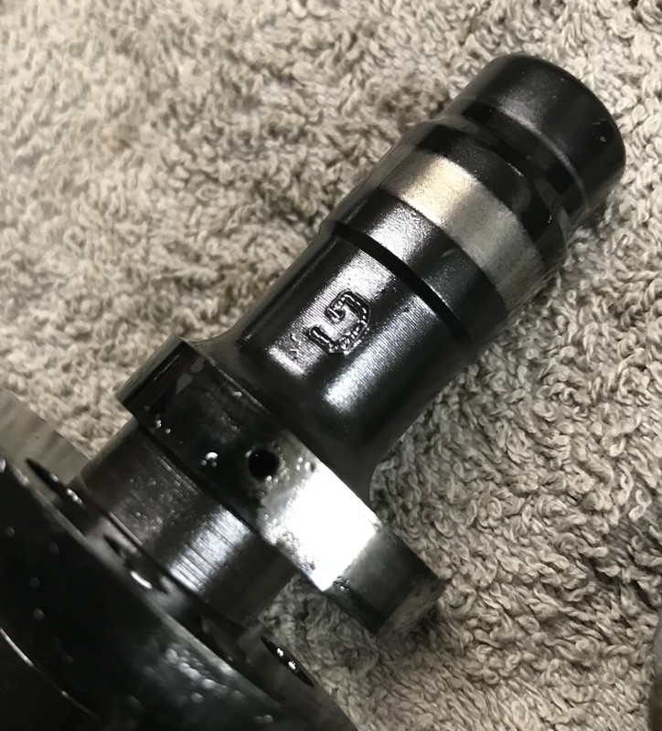

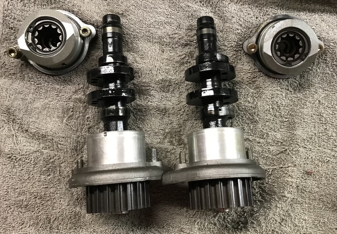

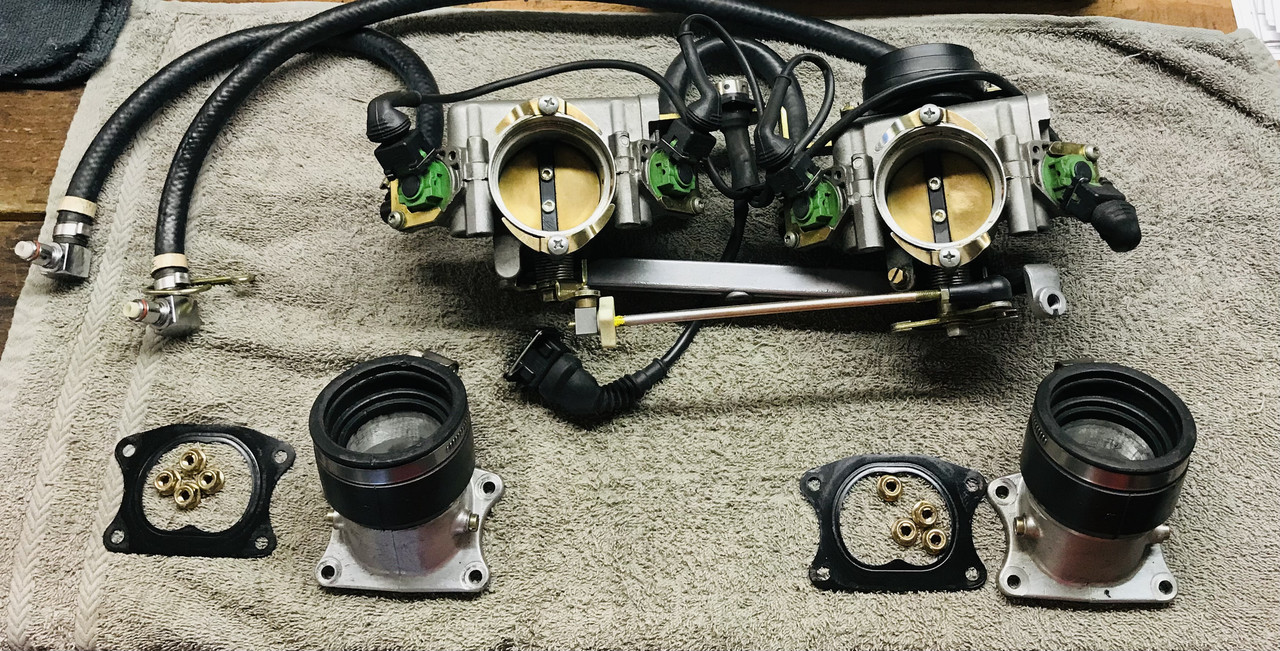

  5. Then you are left with parts that you can only marvel about… Some typical from a 916 SP3, like the dual injectors set/up, or the « A » and « G » cams.
    0D0C4674-FA1A-4922-AC60-AA79EF126515.jpeg F0468E50-8CCA-43EA-9BCA-154BDCEB23A5.jpeg E70A5800-2315-4834-8077-AB9A658BDF09.jpeg 0274852B-2895-4846-A286-B09324845DC6.jpeg

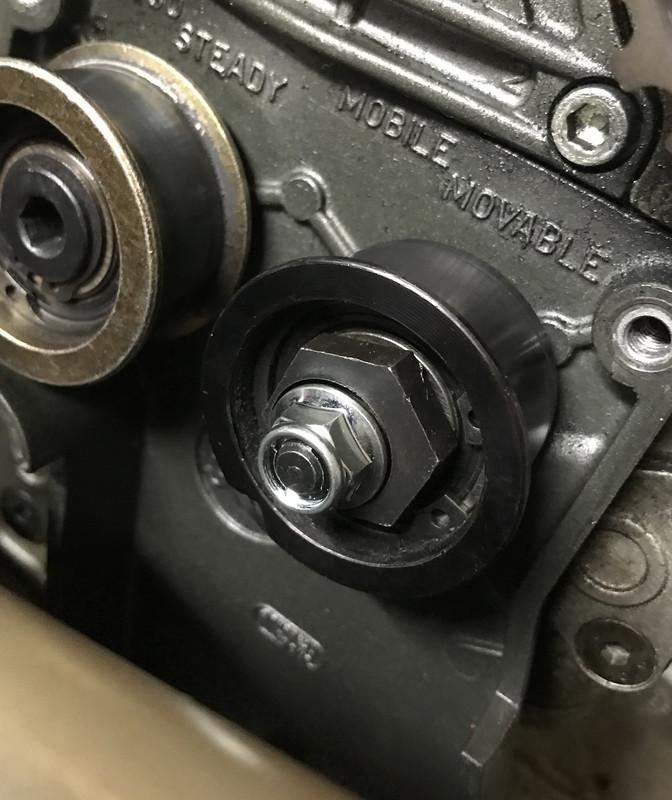

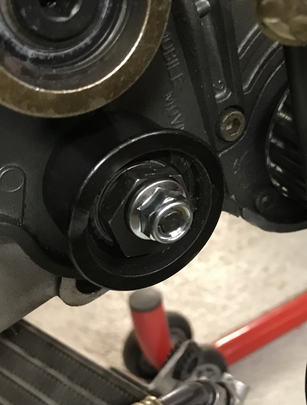

  6. Obviously, belts will be replaced, along with the tensioners Fuji lock nuts, which are supposed to be single use… 197F4DAE-A099-4D0C-A6EF-FCD1AC6BD5A0.jpeg 48E60710-0E57-49E6-8D26-ACC22CD396EB.jpeg

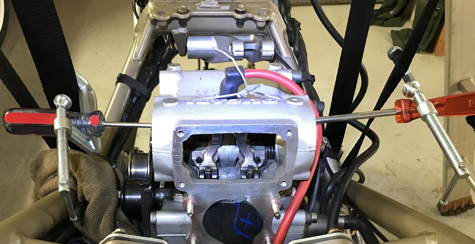

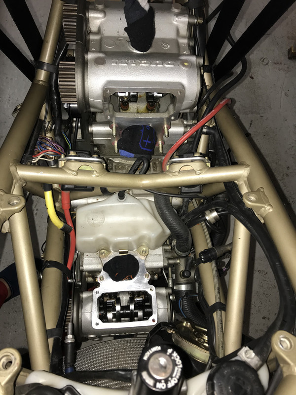

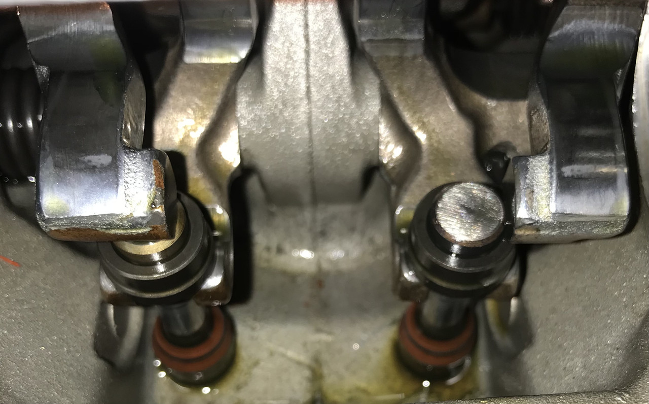

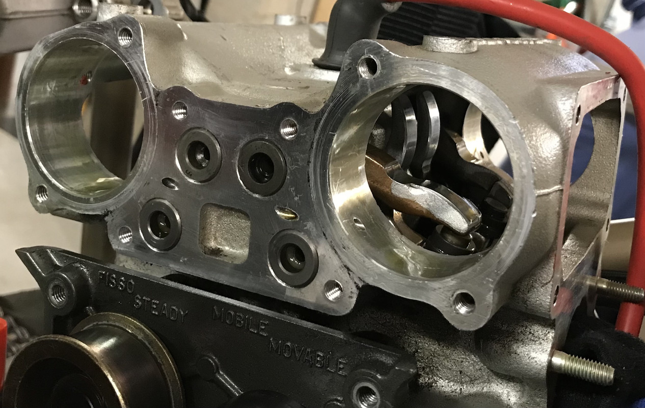

  7. And then, the deep dive inside the heads begins. With everything out of the way (rear shock, exhaust, and cams), access is actually quite decent.
    8E1F49CA-CC96-4D87-B7A1-A245AD09B6A0.jpeg 54FE74D4-D218-4D22-B880-EF4B001F8158.jpeg 536F50DC-2CA6-47F8-9F31-F12F517940FC.jpeg 06EDDD93-21AF-4C2F-985E-99D15EB567F8.jpeg

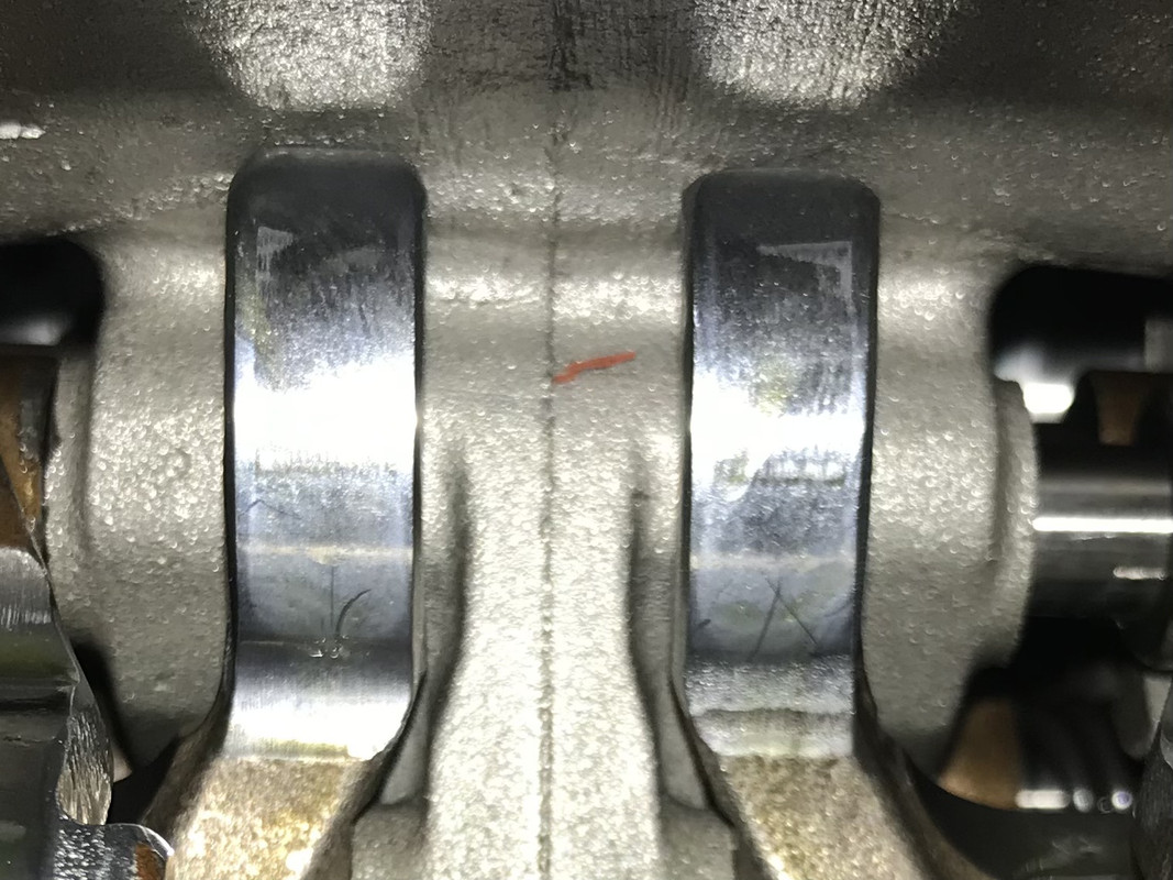

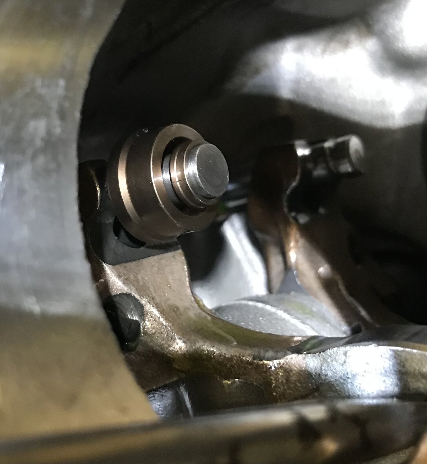

  8. And then, on to setting the clearances to where I want them, with the new MBP collets. Here’s what it looks like on the valve stem: 914B0DDD-A6A2-4426-83C8-FC6A4FF5C4B2.jpeg
    As for the clearances, I decided to follow LTSnyder recommendation, i.e. aiming at 0.10 everywhere, intake, exhaust, openers and closers. I know there are other ways of doing things out there, but I opted for this method this time round.
    Here are the clearances I measured at 4500km when I first got the bike, then what I found at 12.000km and finally where I set them:
    Vertical: 4500km => 12.000km => 12.000km set

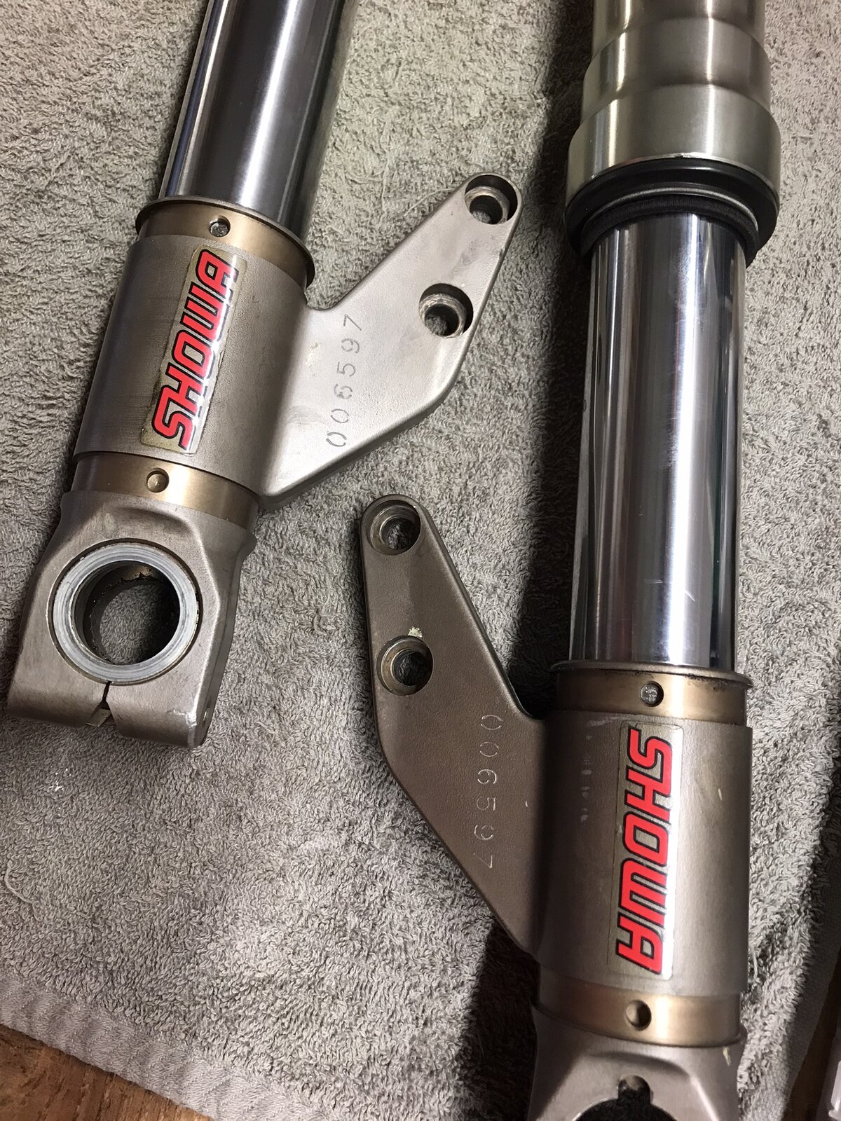

  9. I sent the forks out for maintenance so I will put the rest of the bike back together and will only be waiting for them to return home to wrap this « winter » gig up.

  17. The forks came back Monday. At this time of year, things go super quick, it’s really nice.

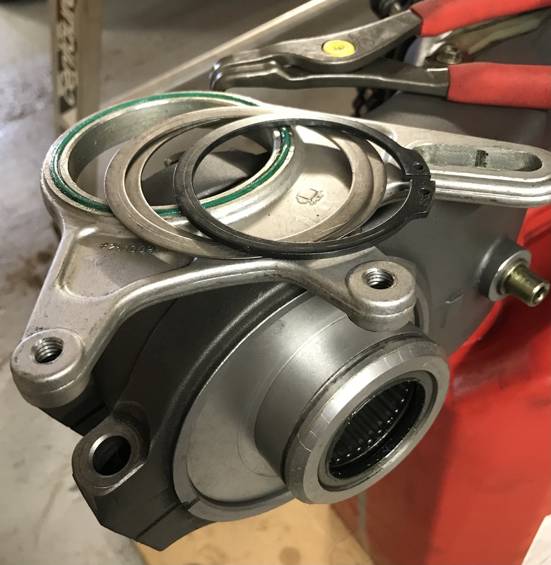

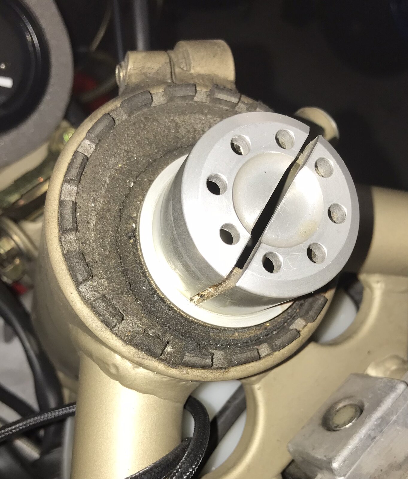

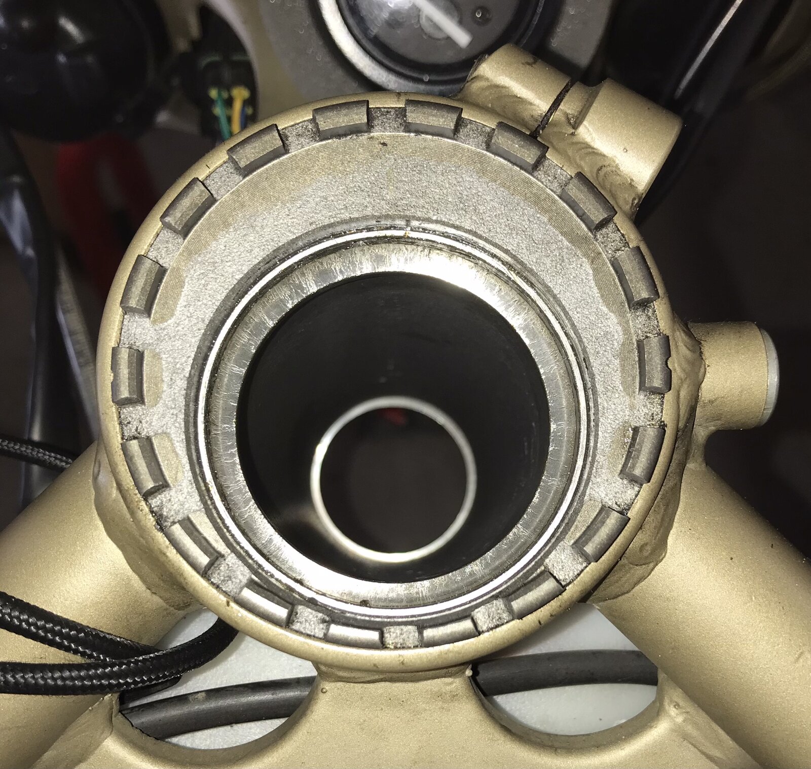

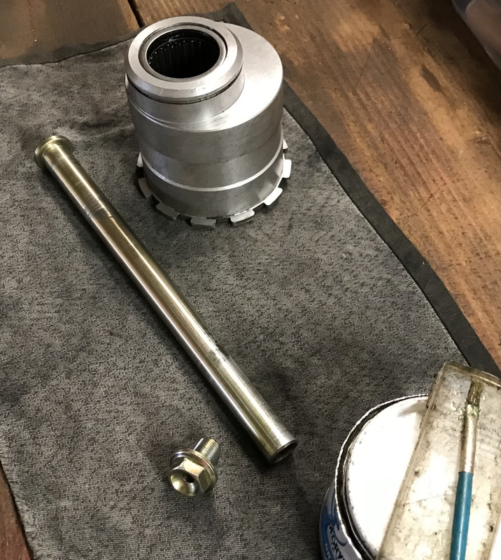

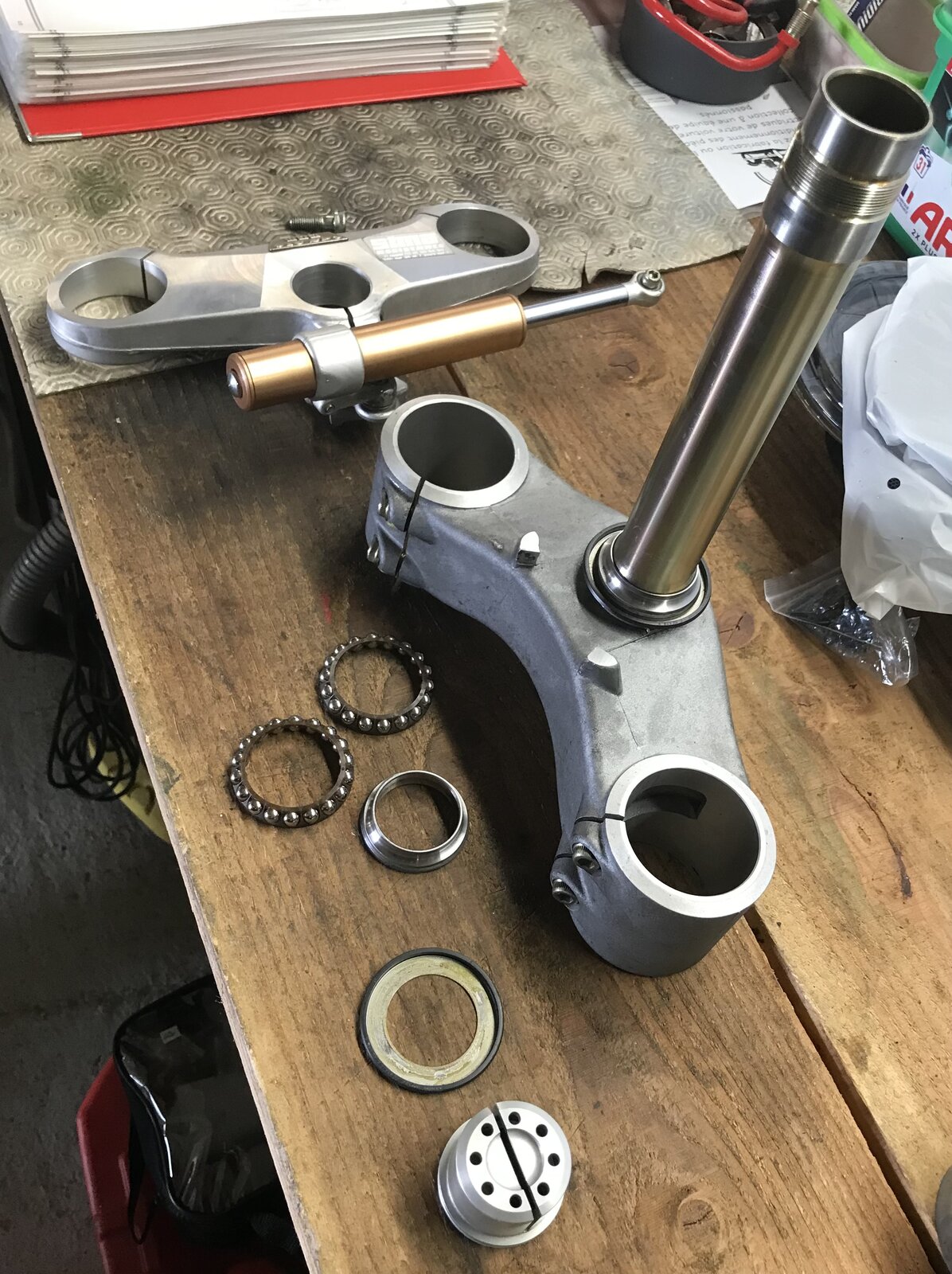

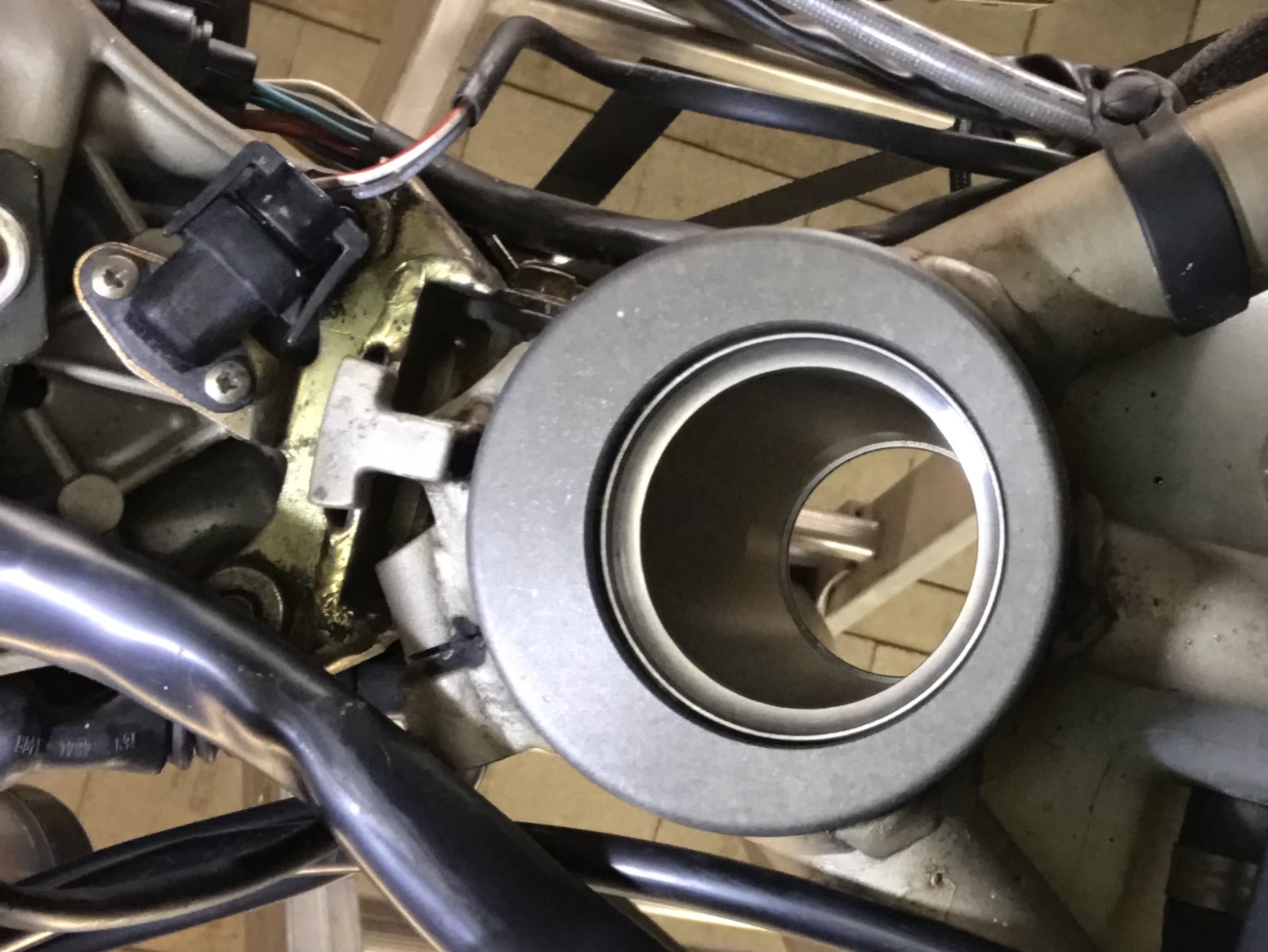

    Before putting them back on, I serviced the steering column. Well, this area is definitely a crusty one, even on a low miles dry riding only bike…:astonished: ACB7116F-376E-4190-B101-C1C86E4DFBB3.jpeg
    Below the lower tree is even worse. If you’ve never looked in there on your 50k miles all weather daily ride, may be you should…
    My OCD is feeling much better with everything cleaned, checked and re-packed with new grease.:D 1B273B96-3C9B-435C-A46D-A13706794F12.jpeg 5DC8B70A-FB20-4B1A-9219-420D39D148E6.jpeg 93C74B5E-E296-475F-B8AD-92FF4580032C.jpeg

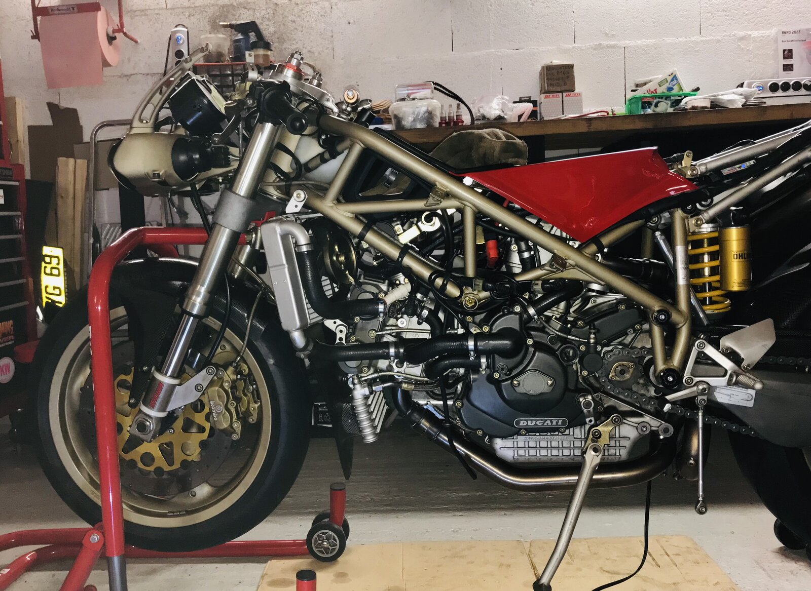

    The front is back on, looking good. C3D75CBC-597F-4103-95E1-307003D4490F.jpeg

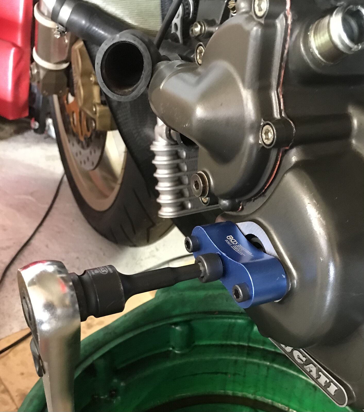

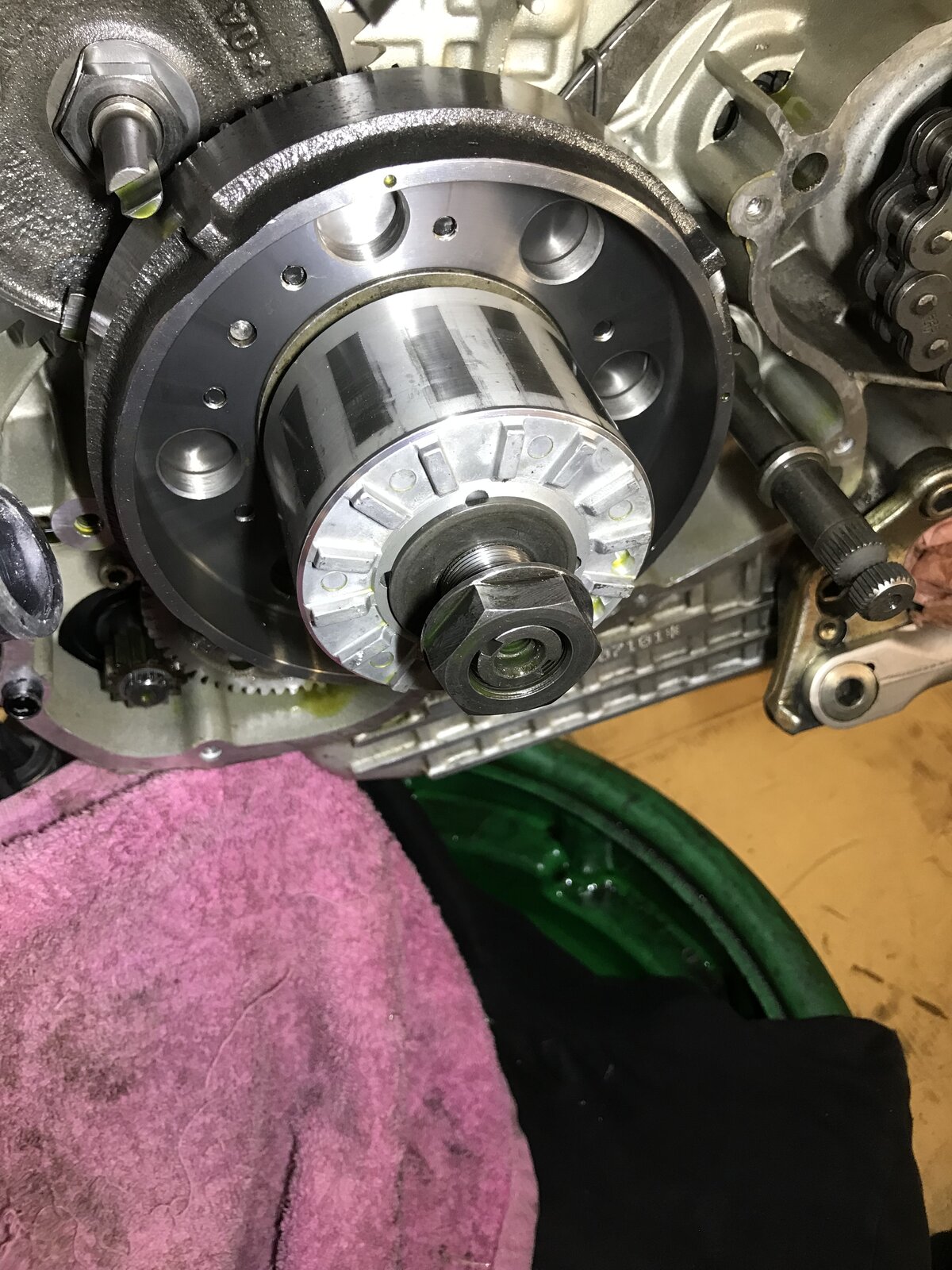

    At this stage, and before filling it up with fresh oil, I am thinking about draining the water coolant and opening the alternator cover to check the alternator nut. Never done that on a bike before, and I don’t have the alternator holding tool. I ordered the gasket and can remove the nut with my impact wrench. Just not sure how I can torque it back. Not really a fan of the oil filter strap wrench around the rotor method, to be honest…

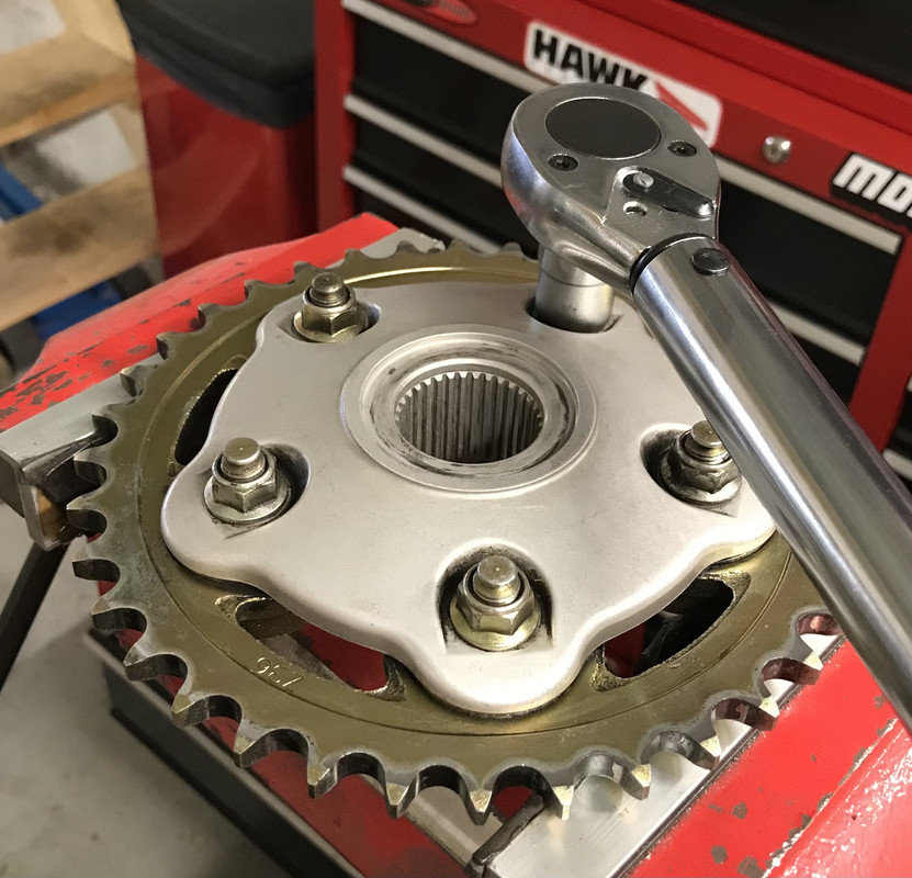

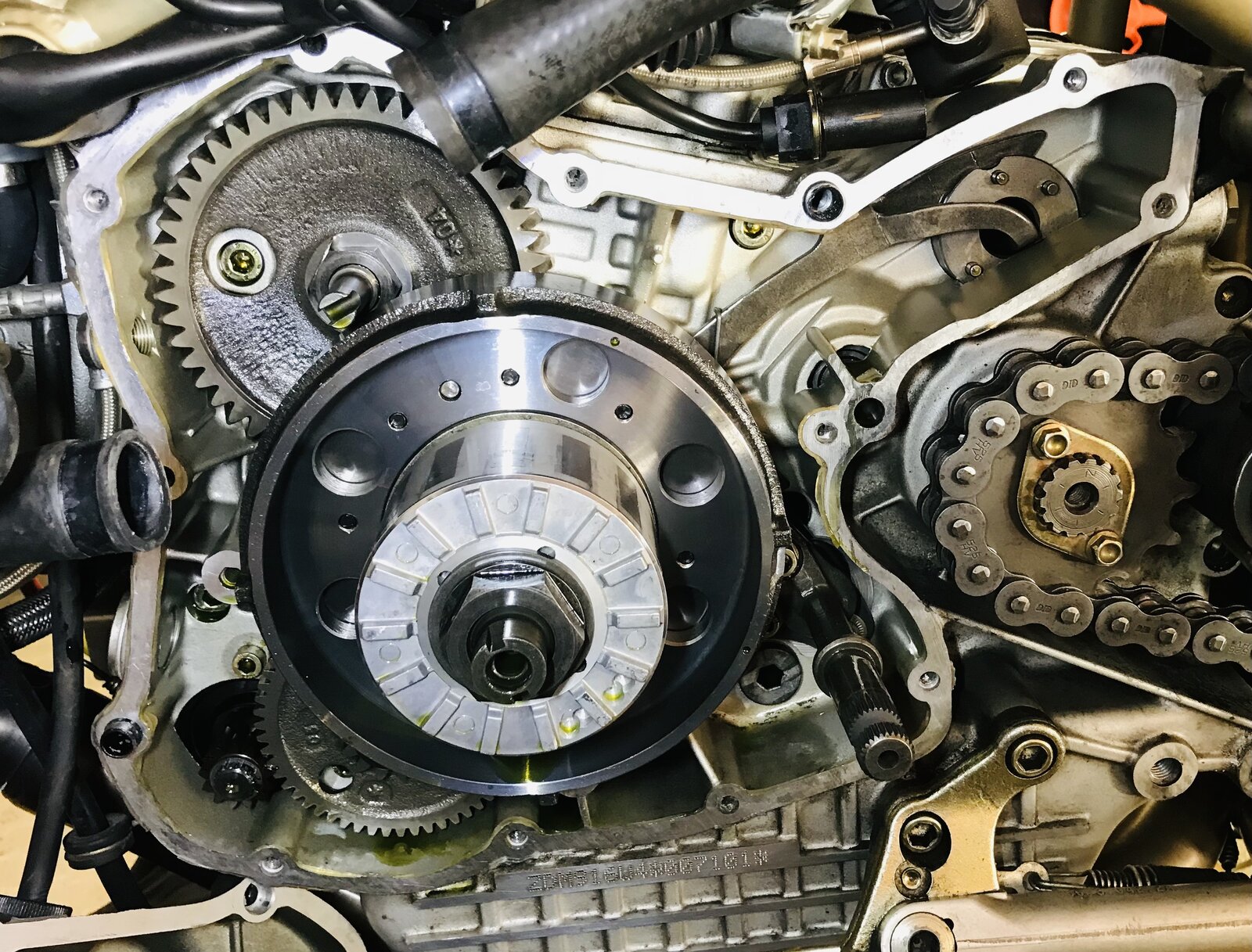

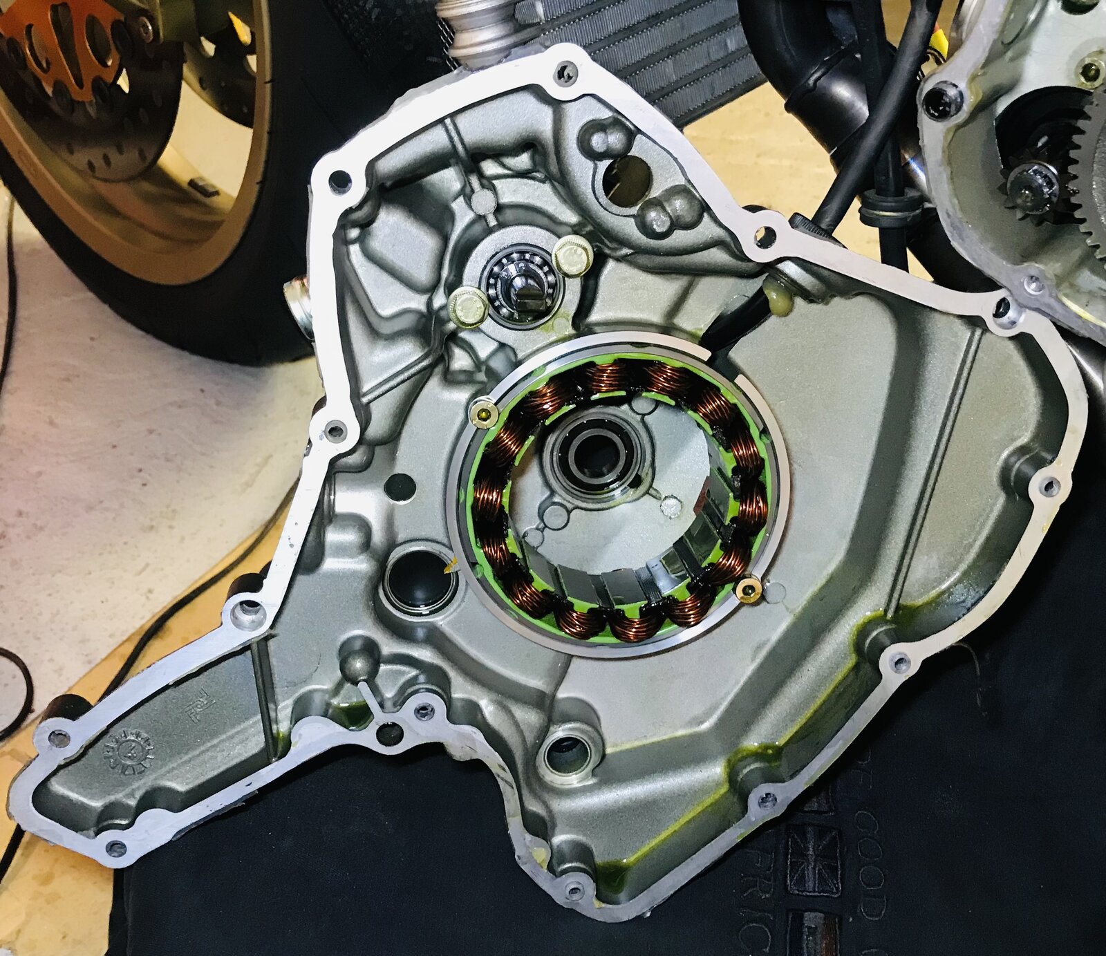

    I did something I had never before, so went very carefully. Removal of the alternator cover to check cover bearings (shaft and water pump) and the infamous alternator nut. Everything looks new in there, without much surprise. Good news is the alternator nut was pretty tight, nowhere near running away. 8D73874D-0005-4428-A218-430EC7BDCC7E.jpeg 0D9717A6-4410-400A-B77B-6C9886CBE839.jpeg 2805AAF8-10B2-4599-9FCC-8F5492F9E10B.jpeg 1129195C-9BA0-4900-943B-84E93EFBA445.jpeg 60FE09B0-DF94-4B41-A455-603FD51C6DAA.jpeg
    Now waiting for the rotor holding tool in order to torque it at 180 Nm with red Loctite. Looking up original tools (p/n 887130710) felt a little too costly for my liking. Instead, I ordered from a UK based company.
