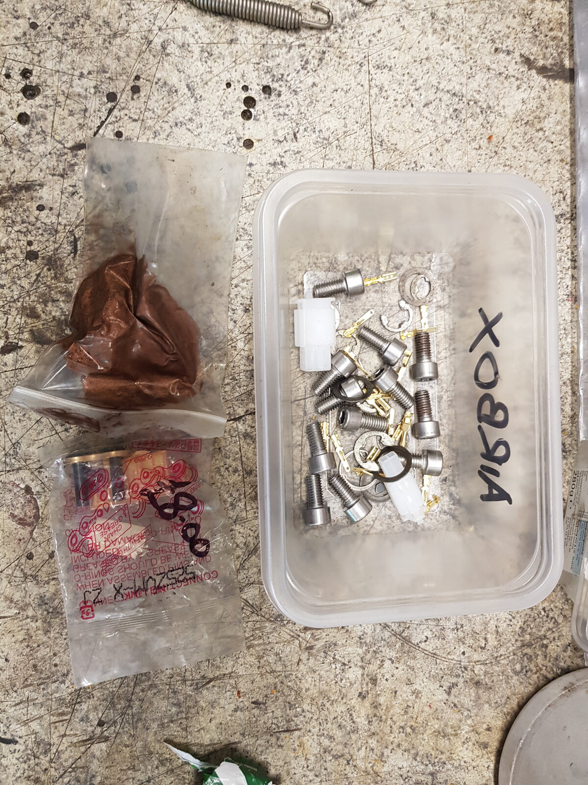

  5. So today, went to the bike shop and returned with goodies... 20190521_160313.jpg

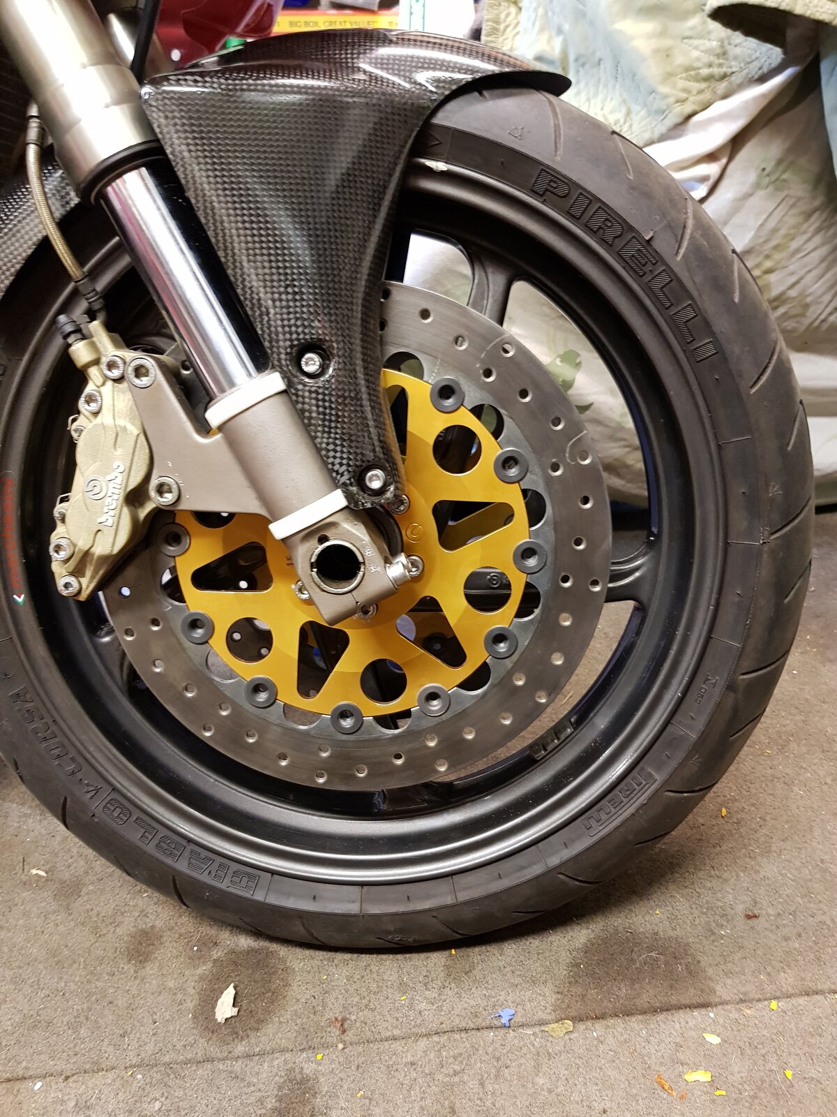

  6. So front wheel is done, new stainless bolts and clean, non rusty bobbins! 20190521_191033.jpg

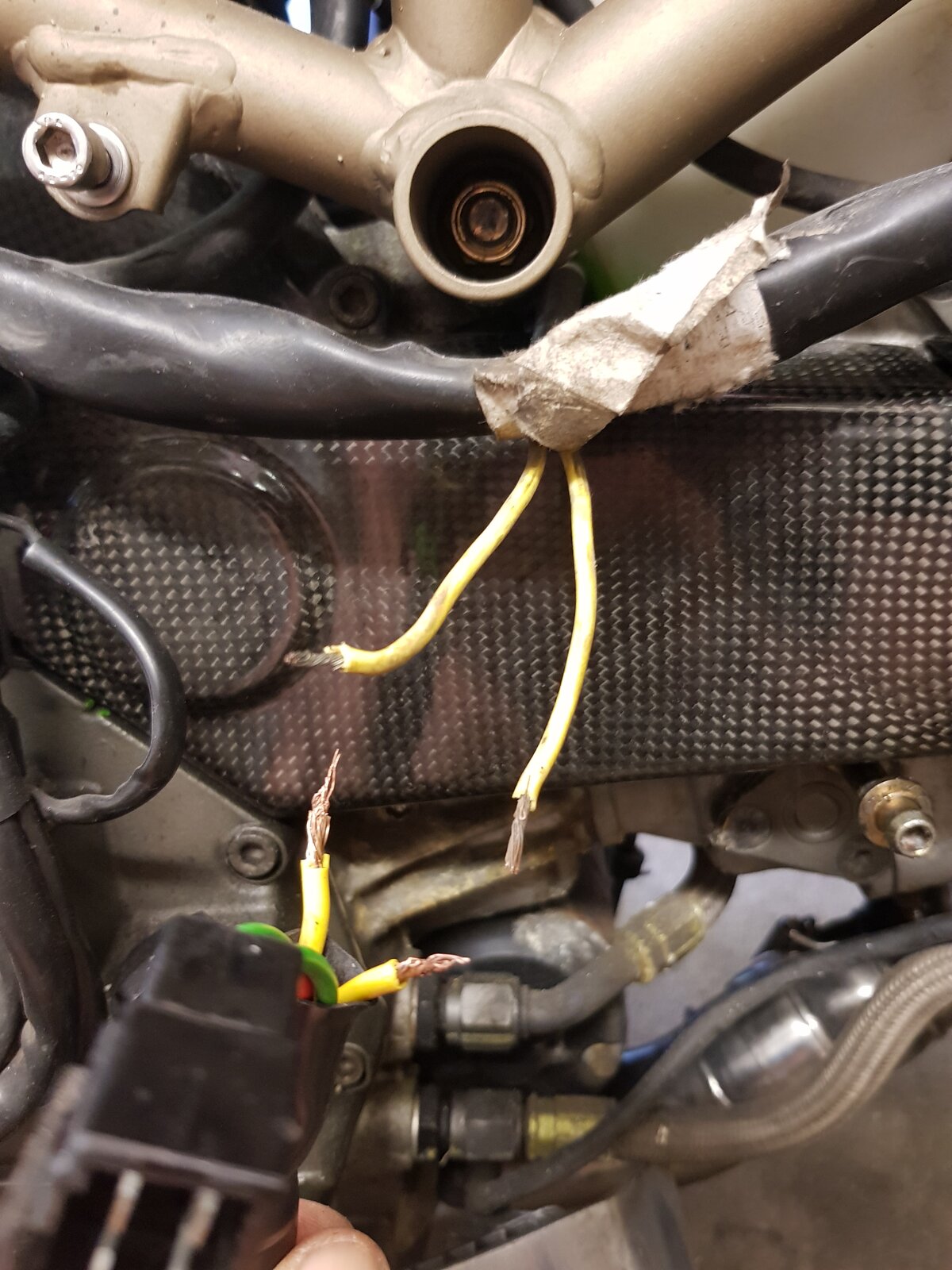

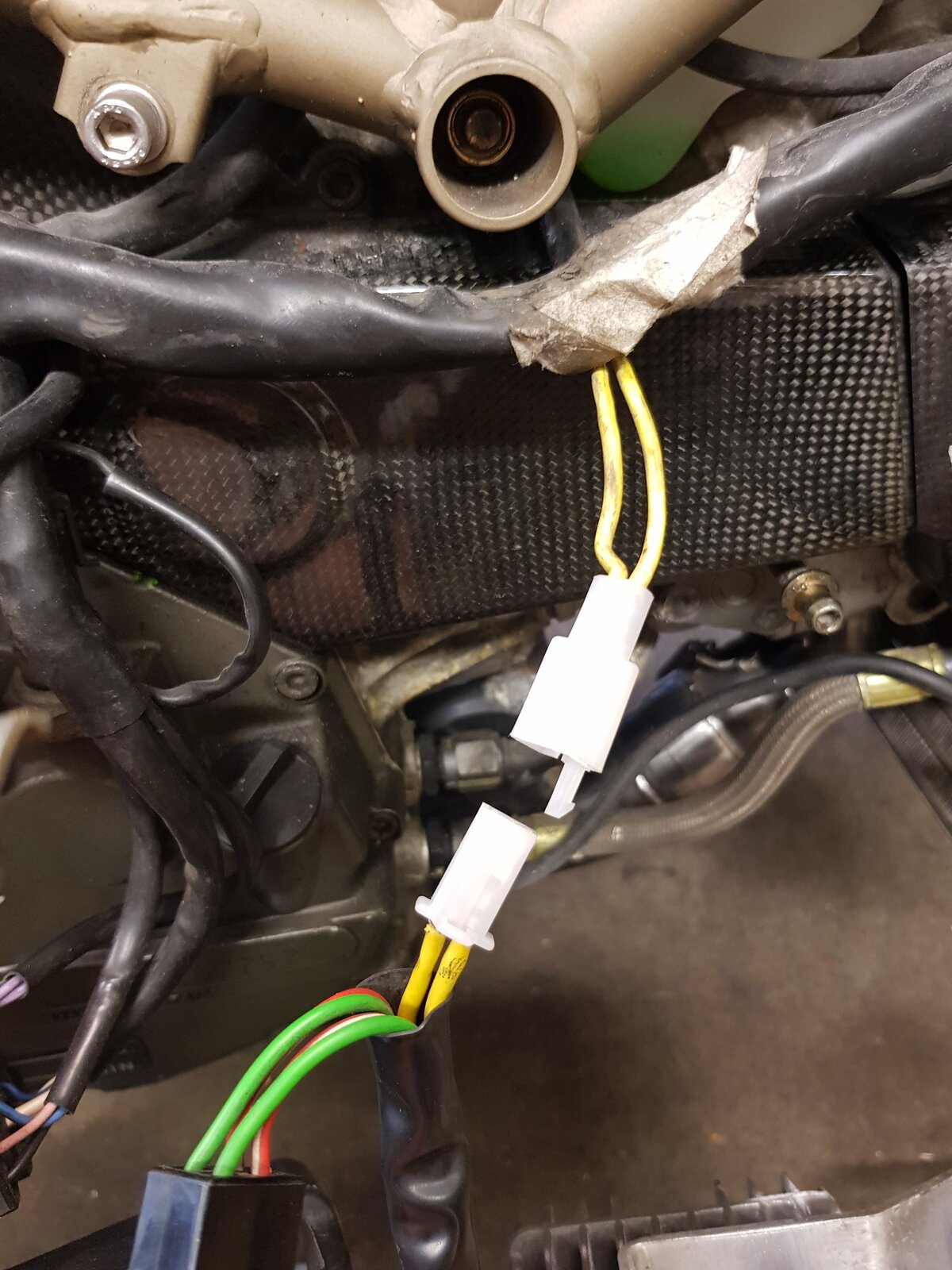

  7. Dodgy wiring sorted too.

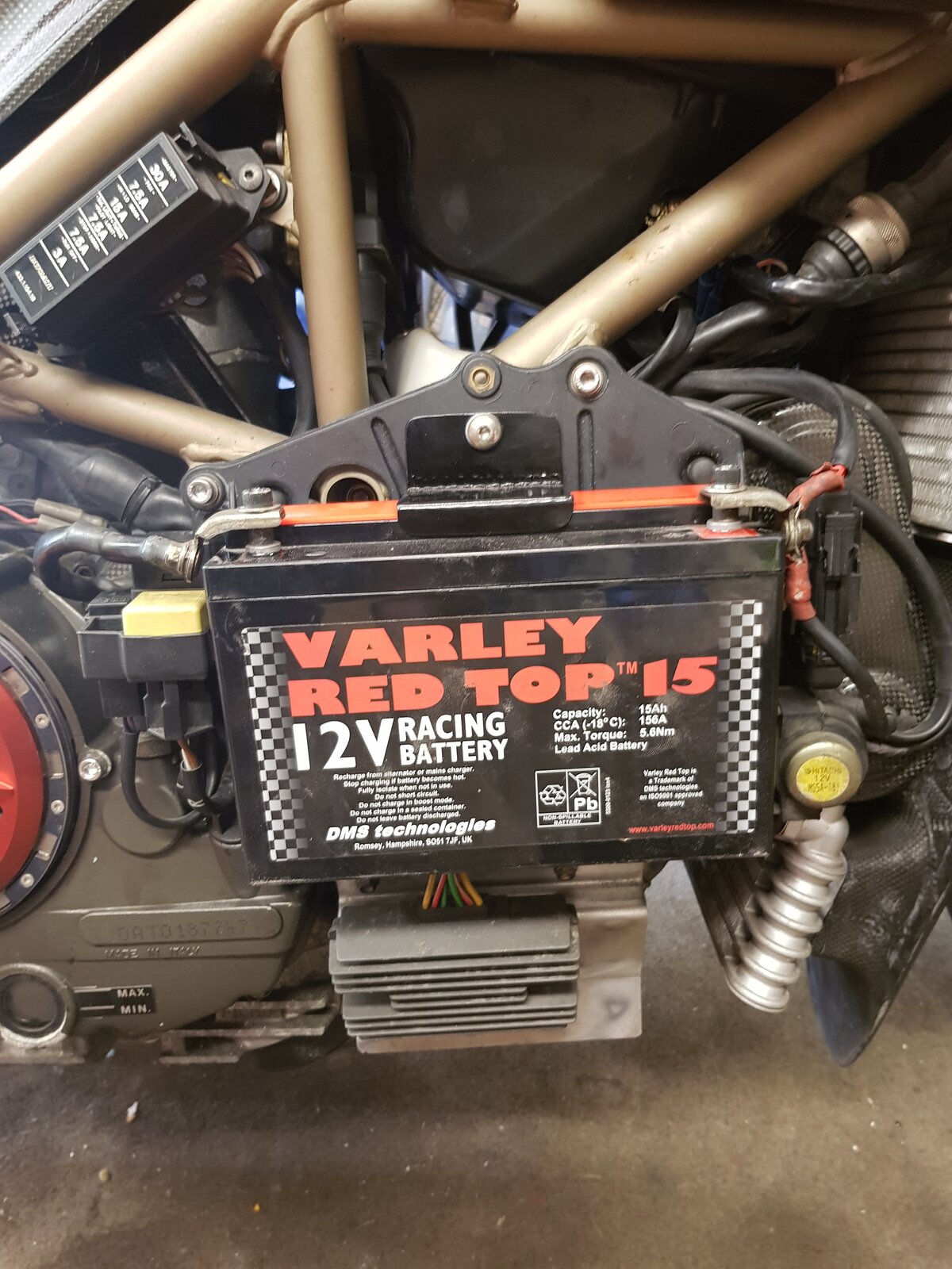

  8. Which enabled me to put the battery on with the bracket I made. 20190521_162722.jpg

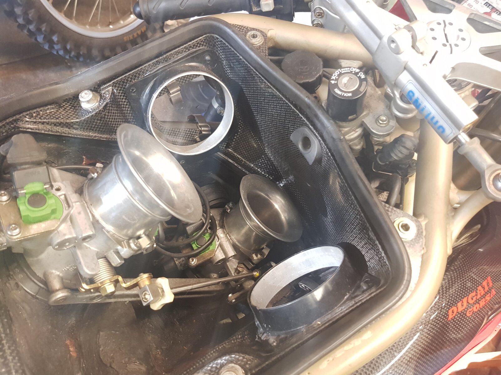

  9. 20190521_104401.jpg Indicators looking good with new paint and put back together. Cant remember how to wire them back in through the air ducts...any ideas?

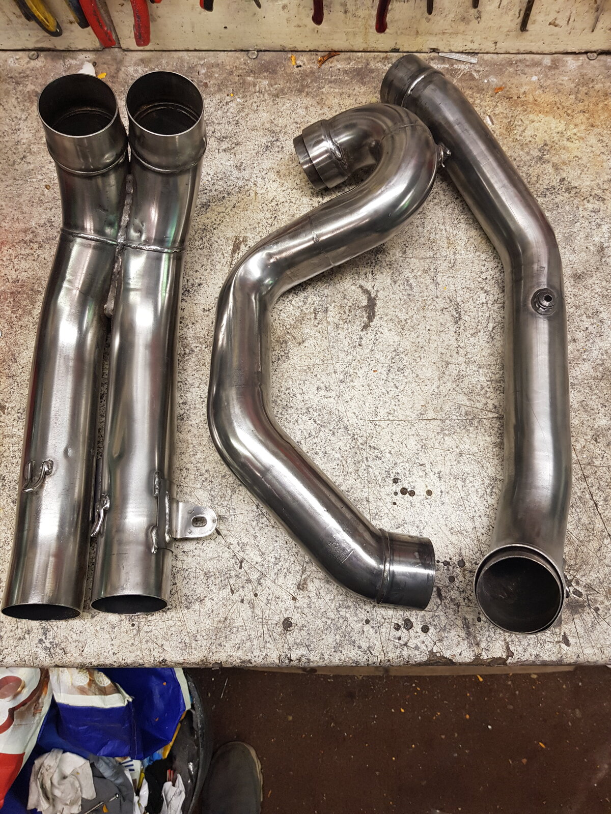

    Seeing as I shined the titanium up, thought it would just slip straight back on. Boy, was I wrong! 20190521_104401.jpg Any ideas how to get the exhaust back on and lined up so it doesn't pull the blue rubber bracket out of the frame!

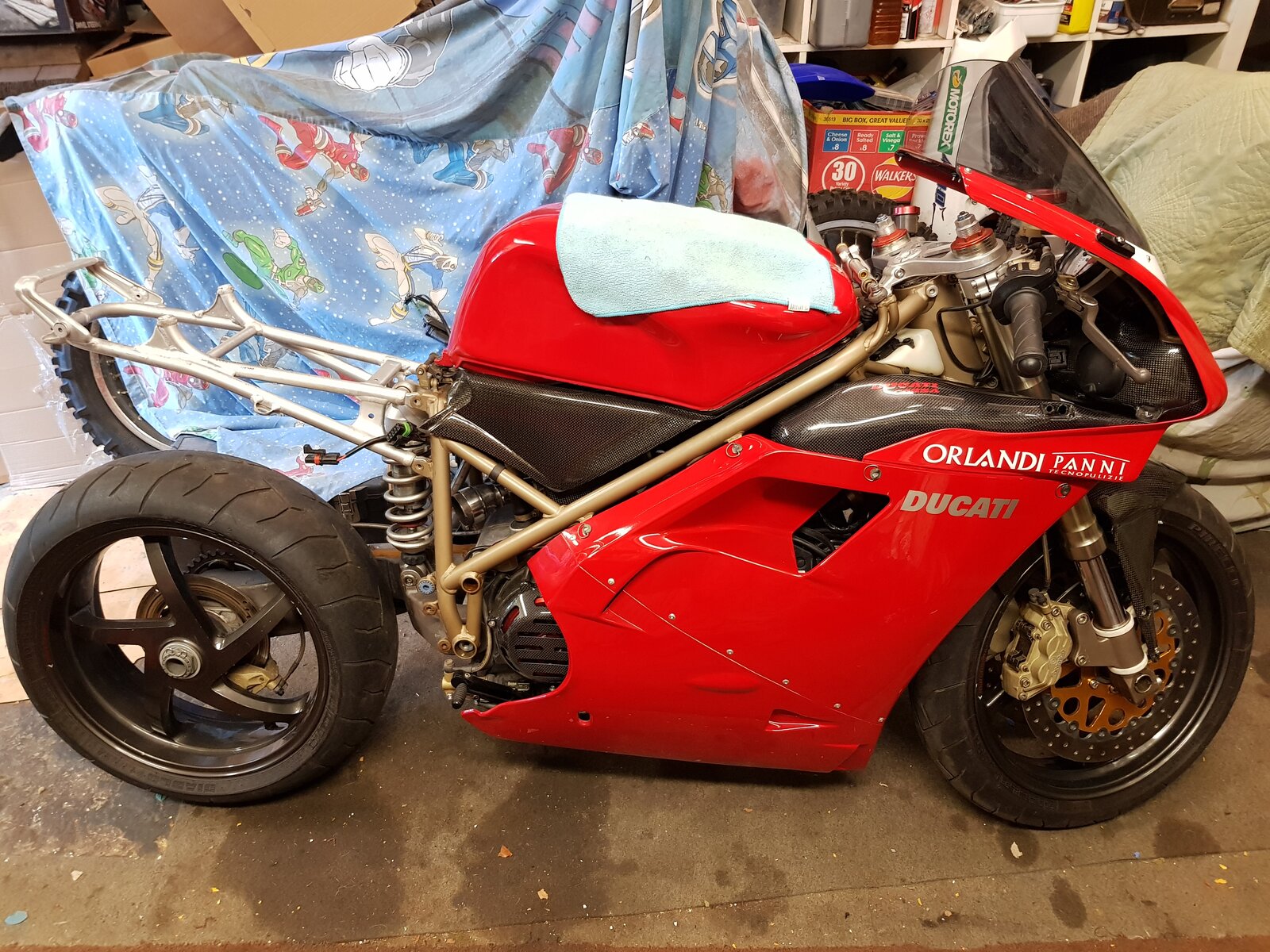

  10. +1 for what FinalEdition said above ^^^^
    Maybe it's just the angle of the photo but it looks as though it's sitting too low with the belly too close to the ground.

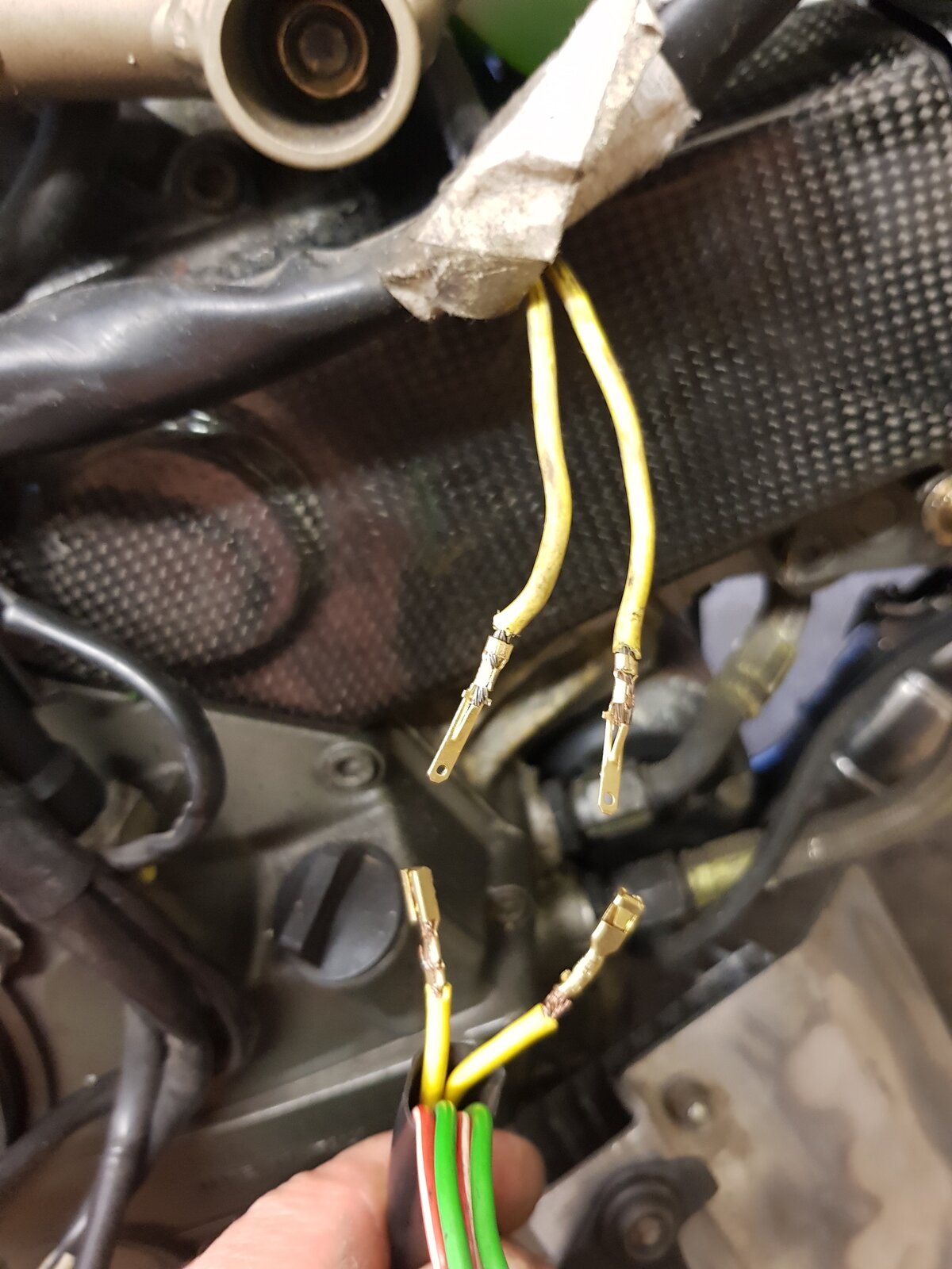

  11. Id've soldered the yellow wires rather than use connectors. The connectors can offer increased resistence, which leads to them getting hot and blackening. The net effect could (or so Ive been told) result in the reg/rec toasting itself.
    Mine are soldered now after also being replaced with heavier duty wires. Apparently the OEM wires are not rated as adequate for the load. They get hot.

  12. The pic is taken really high as I'm backed up against the work bench and cant get the whole bike in. I'll drag it outdoors and get another pic posted :)
  13. Cheers. I did wonder why the wires were heavier duty than all the others. They may well get soldered yet, I too distrust aftermarket connectors!
  14. The height of the rear subframe looks low and flat.
  15. I have found the original wires don't like soldering. There is a connector on them anyway. There is also another connector in the mix, if using a converter to a MOSFET reg/rec. Never had any trouble.
  16. it wants adjusting correctly with a datum tool...then everyone knows exactly where its at!
    in fairness you can see the rear subframe isnt bolted in yet ...thatll help with the appearance
  17. I had my stator rewound. So I had heavier duty wires installed at the same time. I solder the connection between RR and stator now. I got fed up of replacing RR's and batteries. My RR failures always took the battery with it. Im on my last Electrex which has lasted a fair while now. I used to do 1 or 2 a year and kept a spare under seat. Next will be mosfet one when it does toast itself.

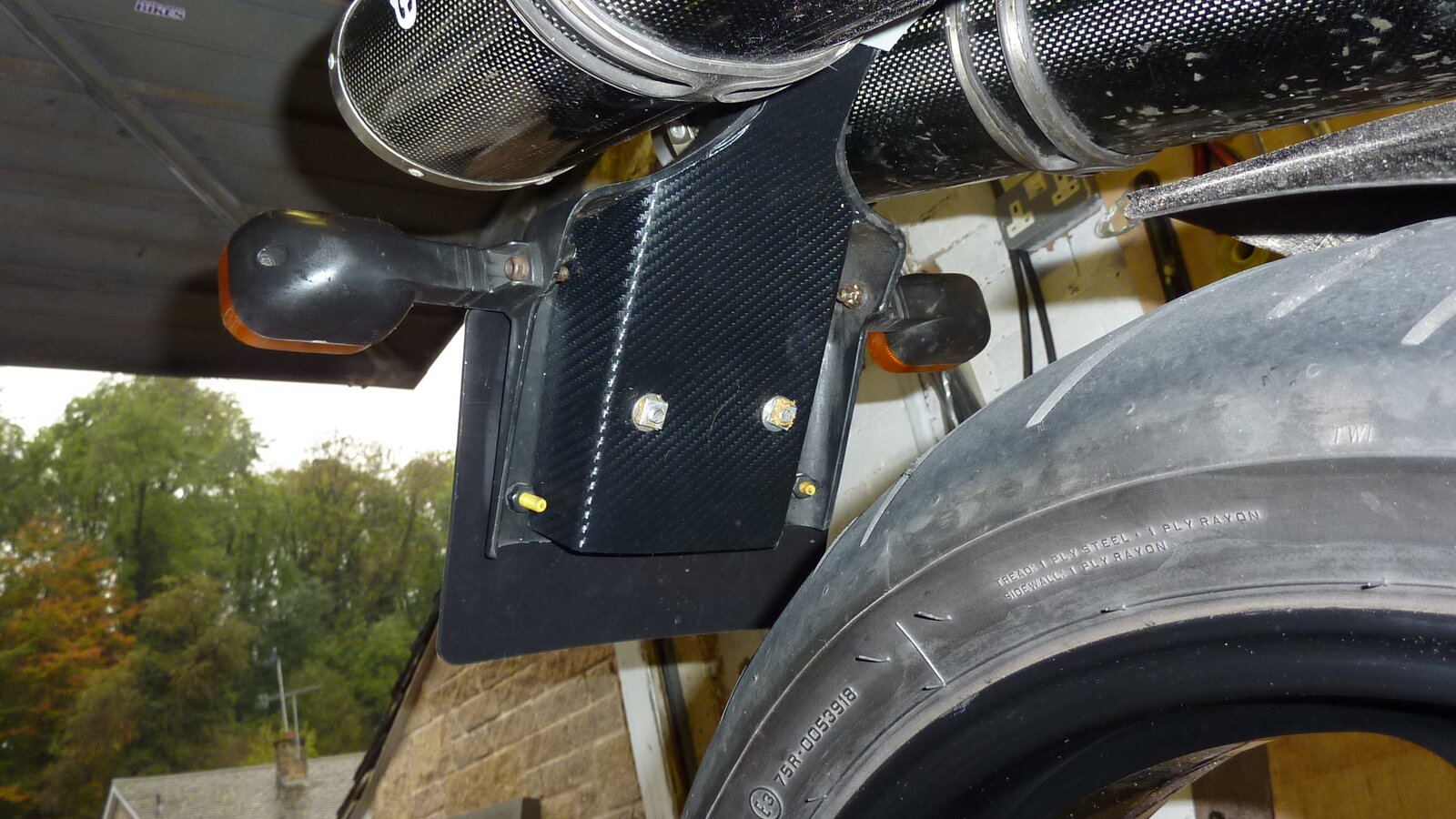

    Stupid place to put an RR. Next to a freaking hot manifold. Thingy on here (i forget) shifted it to rear no plate. An eminently sensible thing to do and one I intend to copy when my current one does nuke itself. I bought the cables etc in readiness. However, I hardly use my 916. Its last voyage was to the MOT station and its next will be the same journey. Which reminds me, I need to get a fork seal replaced...
  18. Mmm I think I might be Thingy!!
    It's been there about 7 years now, trouble free.
