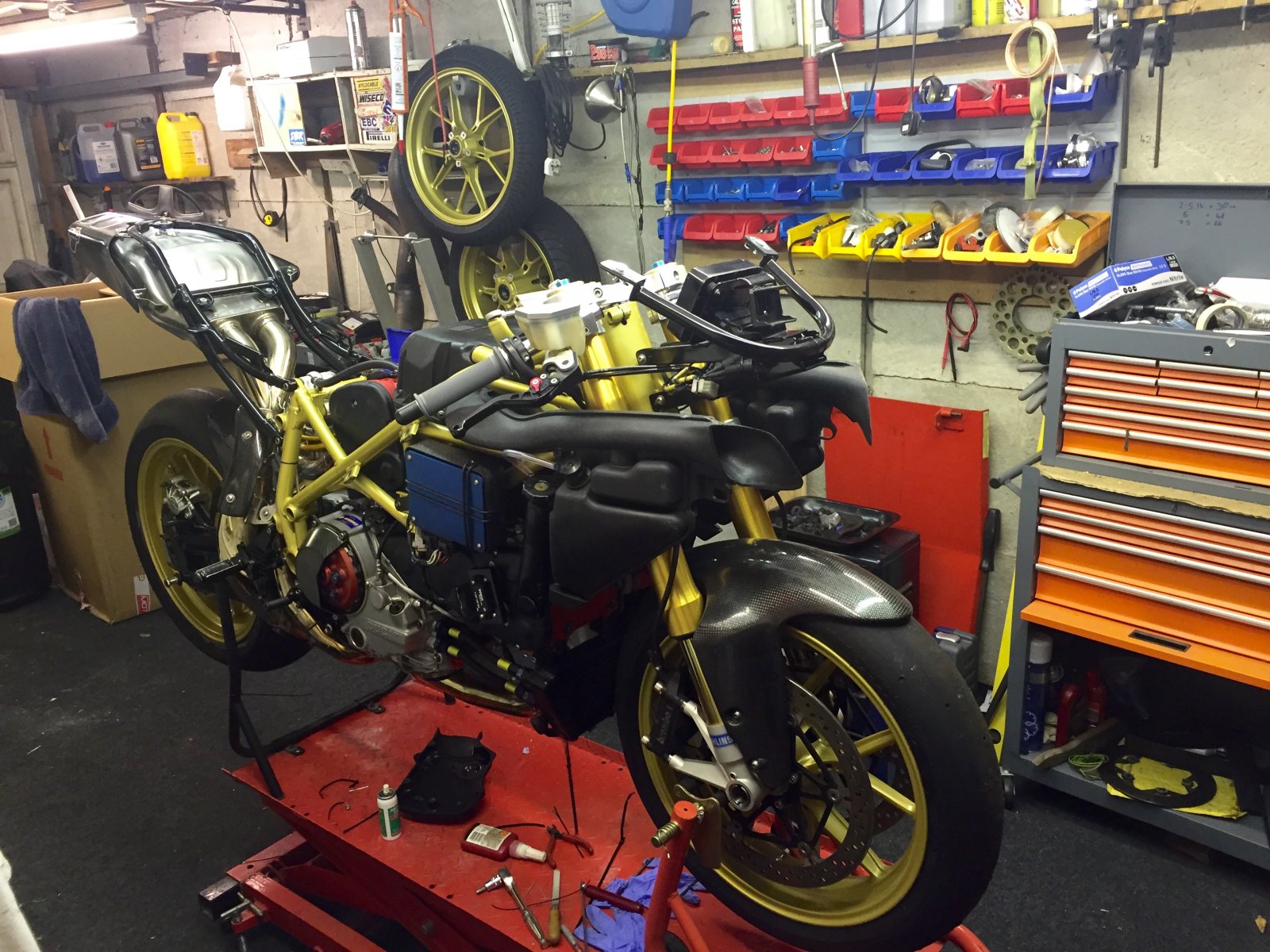

  10. Spent an hour or two on the 924 last night. I checked belt tension now they've run for 2 hours. I was surprised how much movement the idler and tensioner bearings had? I even removed the tensioner to check the bearing but they feel fine.
    Anyone else have an opinion on bearing float??
  11. I ran my 1098 after a belt change last week and there was no visible float in the tensioner or idler pulleys.
  12. Update from tonight. Investigated my belt pulley float and discovered the bearings are C4 (not the explosive) and one of them had more float than the others. So I bought some C3 spec (reduced float) and I'm much happier with how they feel. Right or wrong it just seems the best solution.

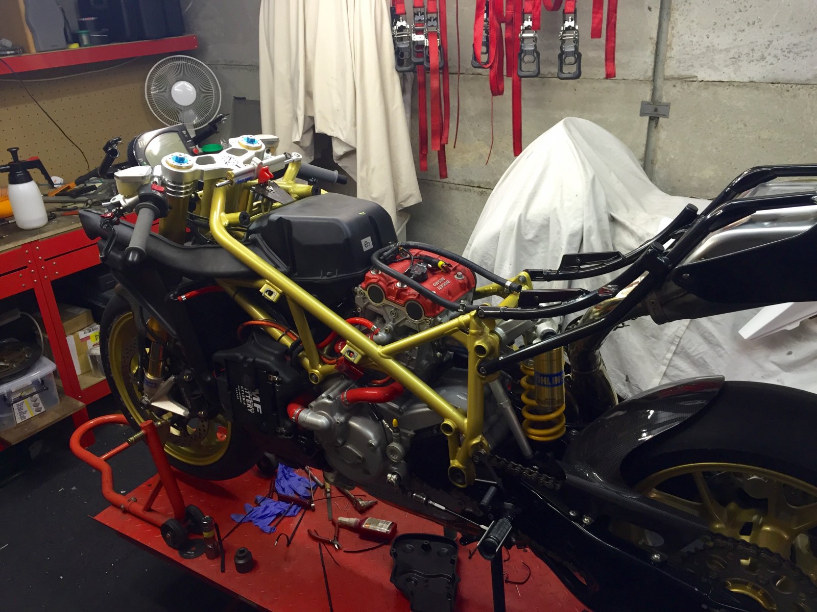

    Right then. It's ready

  13. Still loving the lemony/Limey frame colour!
    Looking good!
  14. Wow....
    It's those Ferrari-esque cam-covers that do it for me... :p
  15. Great build, and I really love the Ferrari style cam covers, they really do look ace!
