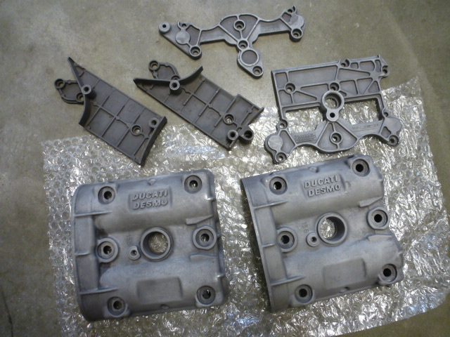

    Avoid letting it pool in the corners as it will pucker up rather than wrinkle.
    I clear lacquered mine and I'm dubious how durable it will be.
  3. Anybody interested in some 999 covers for the red paint?
    These are already unpainted.
    Great build, looking forward to see it in full race trim.

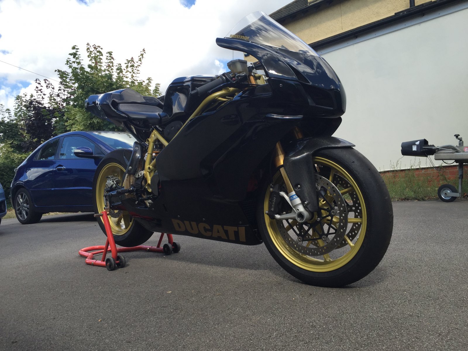

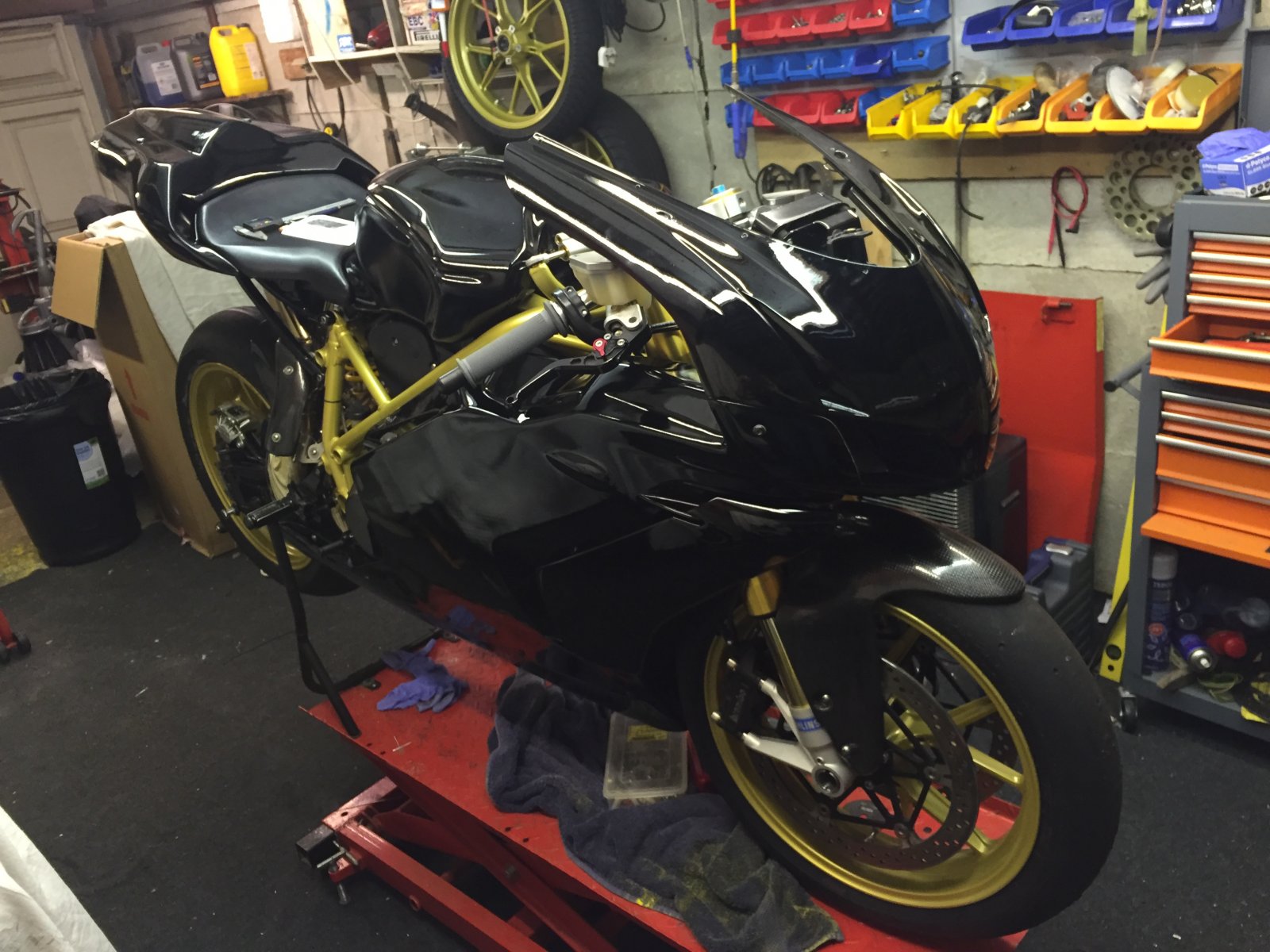

    Getting closer!
    • Disagree Disagree x 1
  10. That stand looks mighty close to disaster!
    Looking good!
  11. Not wishing to tempt fate. But.
    It's pretty stable. However I do tread carefully if I'm doing anything physical.
    Although it's a bastard to get the Ducati on there compared to the little Rs250. I may need to make a MKII version.

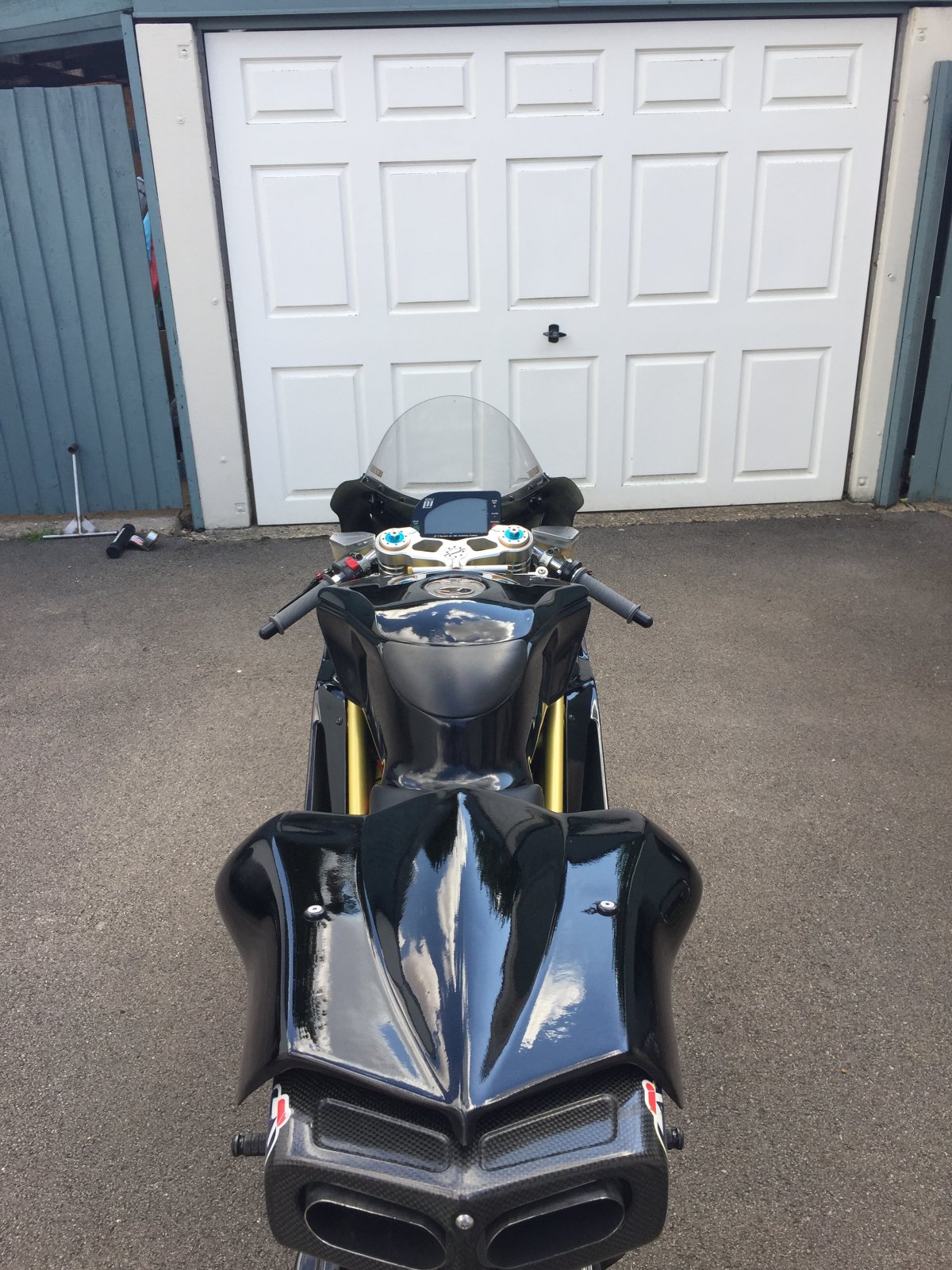

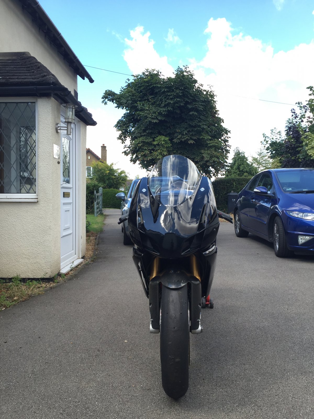

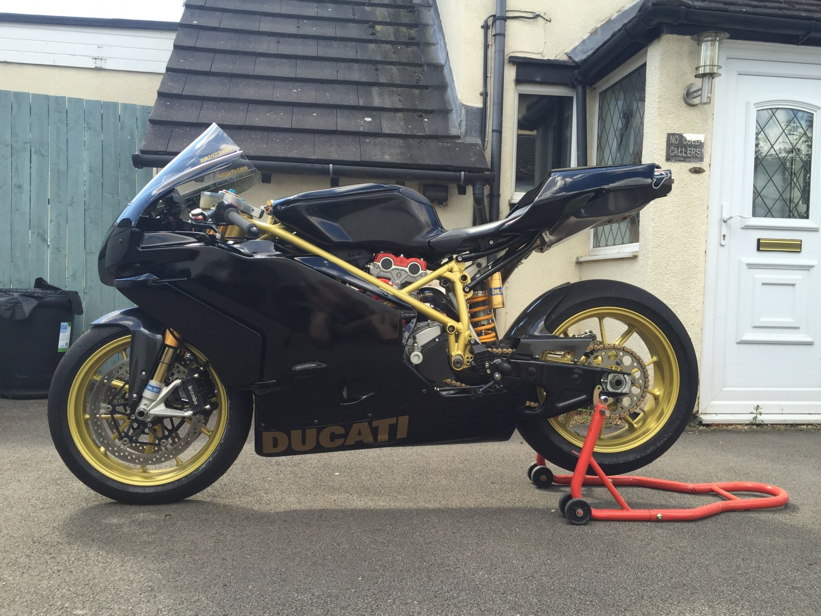

  12. It's official.
    It's finished.
    (As per unofficial forum rules. I've included the mandatory edge of frame rubbish bin.)
    • Like Like x 12
  13. Looks great mate, love the colour scheme, reminds me of a Night Burner (not that i'm old enough to remember them ;) )
  14. How does it run, can you feel a marked difference from the original lump?

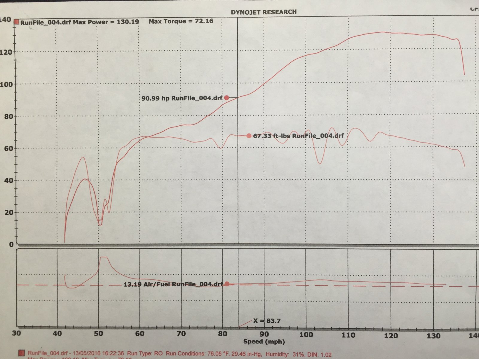

  20. image.jpeg Just Dug out the dyno graph.
    You can see the Huge lean throttle opening area. Which I've been working to resolve. The spikes on the torque curve is caused by the ignition pick up dropping out and why the graphs in mph not rpm.
