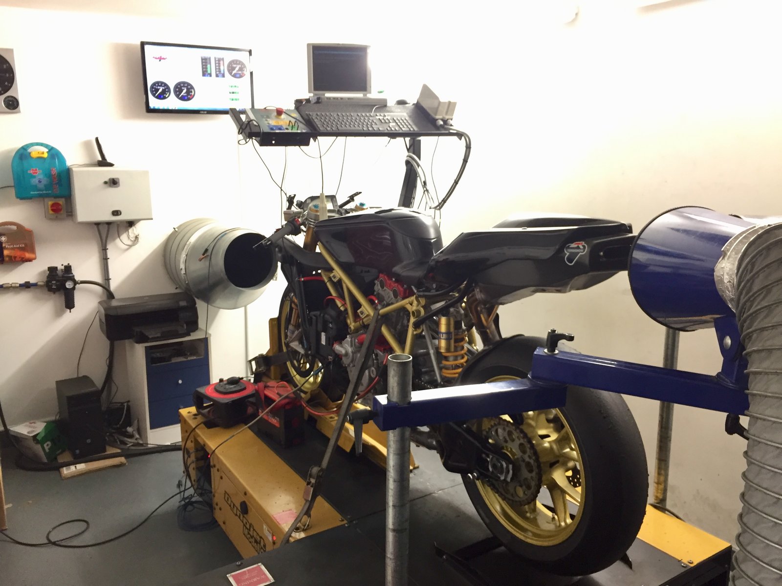

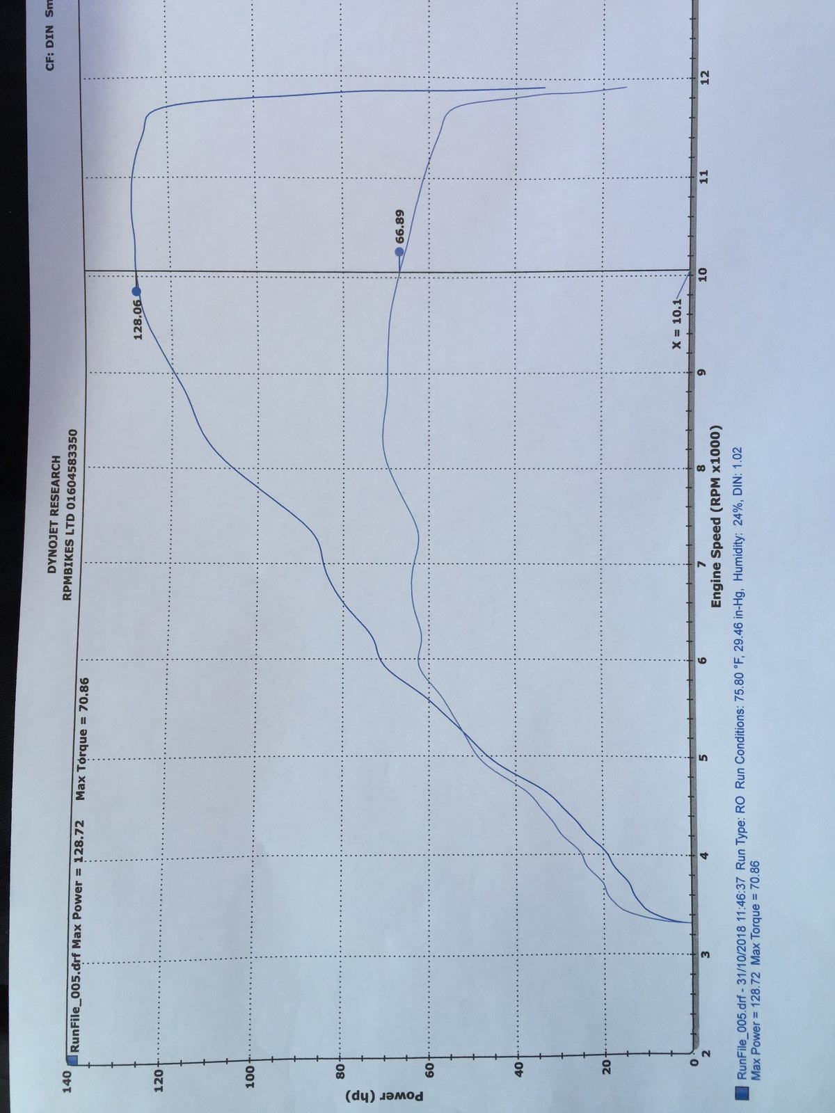

  16. I had a trip to the Rollers this morning. Once again a huge thank you to Ian at RPM for allowing me to use his lovely Dynojet set up. It was a bit chilly in there at first. But once the bike and the dyno brake were warmed up it was pretty much perfect conditions.
    I spent most the time working on high rpm, part throttle mapping and throttle transitions. Which all made sense and responded well to the changes in fueling. I also made a couple of power runs to satisfy my need to know how much it makes and to see how the power and torque curve look and to see where there are holes in power delivery. All looked reasonable.
    The headline figure if 128.7 @ the rear wheel was good enough for me.

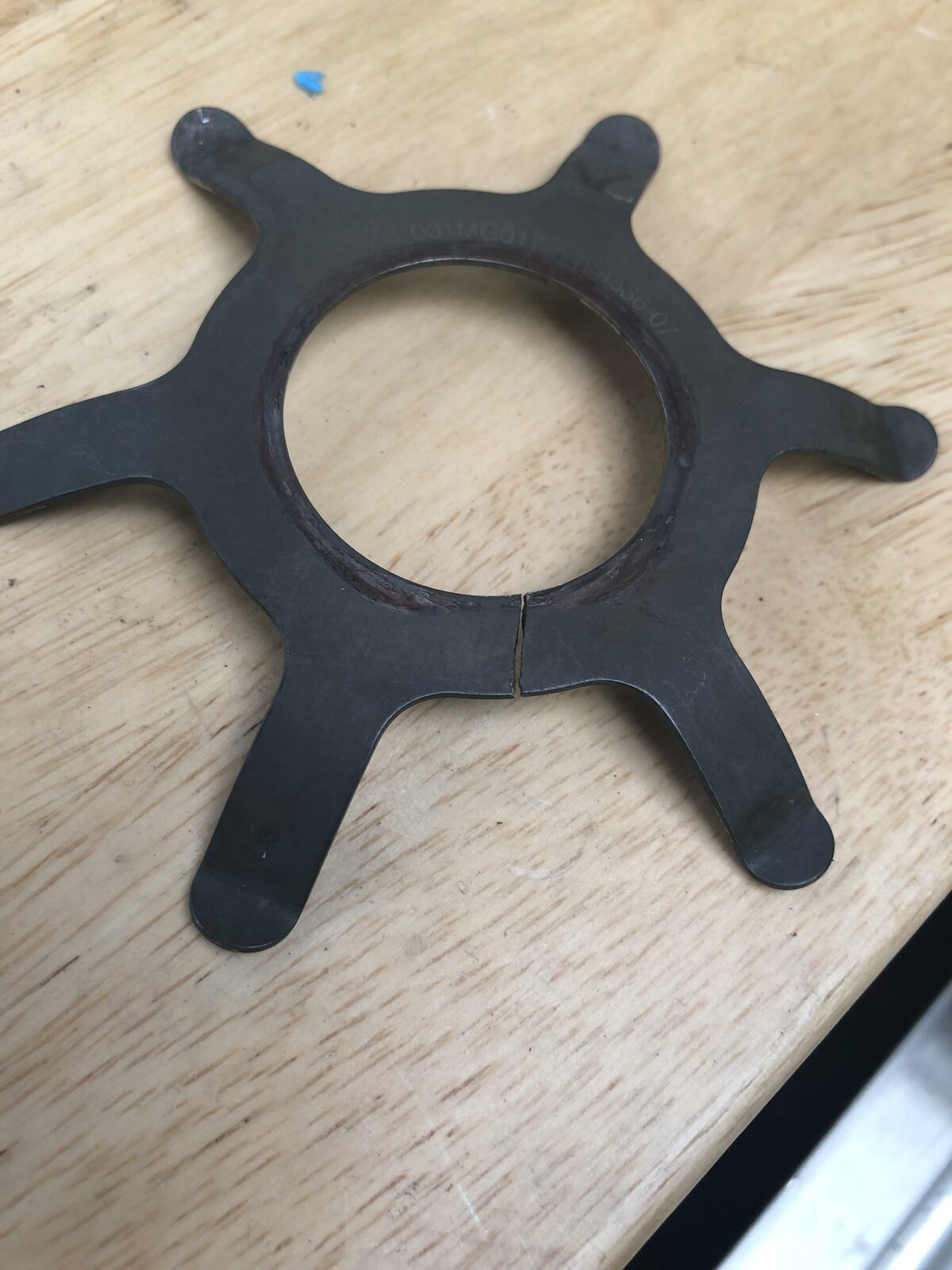

  17. After a few more outings on the 924 and now having the ignition and fuelling pretty good. ( I’m sure I could tweak it more )
    But. Since the build I’ve had a couple of clutch issues. The first was my error and easily rectified.
    And more recently. I’ve noticed a “knock” coming back through the lever when down shifting and inconsistent slip under heavy braking and multiple down shifts. To the point that the rear wheel momentarily locks.
    I had considered that removing the majority of the flywheel mass was causing the clutch loads to fluctuate.
    So after a quick strip down for visual check I found the primary spring had cracked.
    I do have a new spare spring so it’s not a big problem.
    I has anyone else suffered similar symptoms with light weight flywheel affecting an stm slipper?
