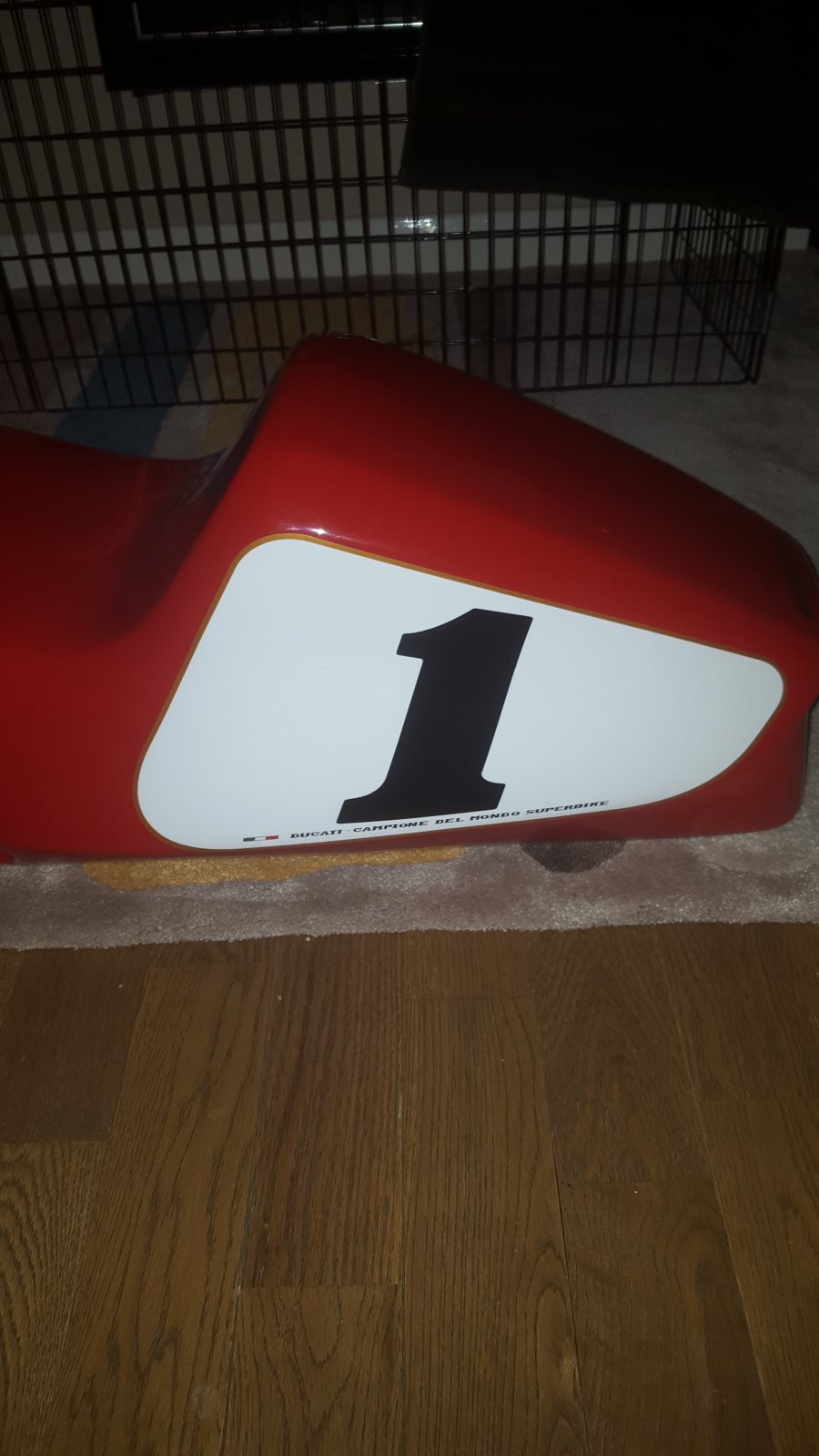

  5. You're lucky to have ready made panels for the seat unit. Mine had to be designed and painted on. And then the tape painted. And then the unit was painted again to get a level finish before lacquering.

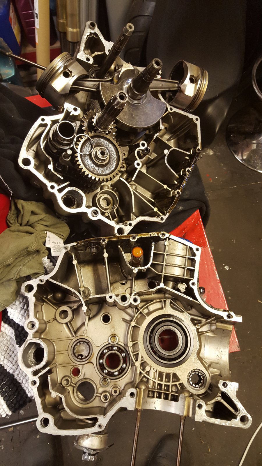

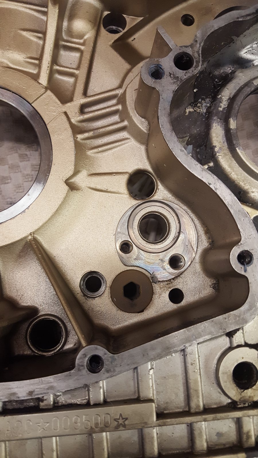

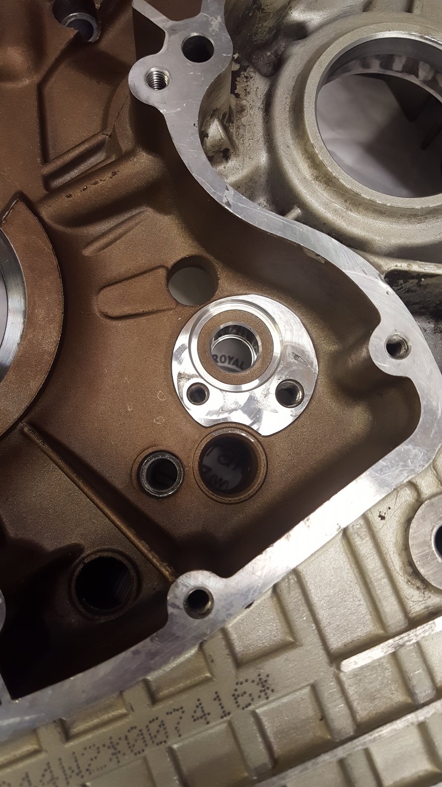

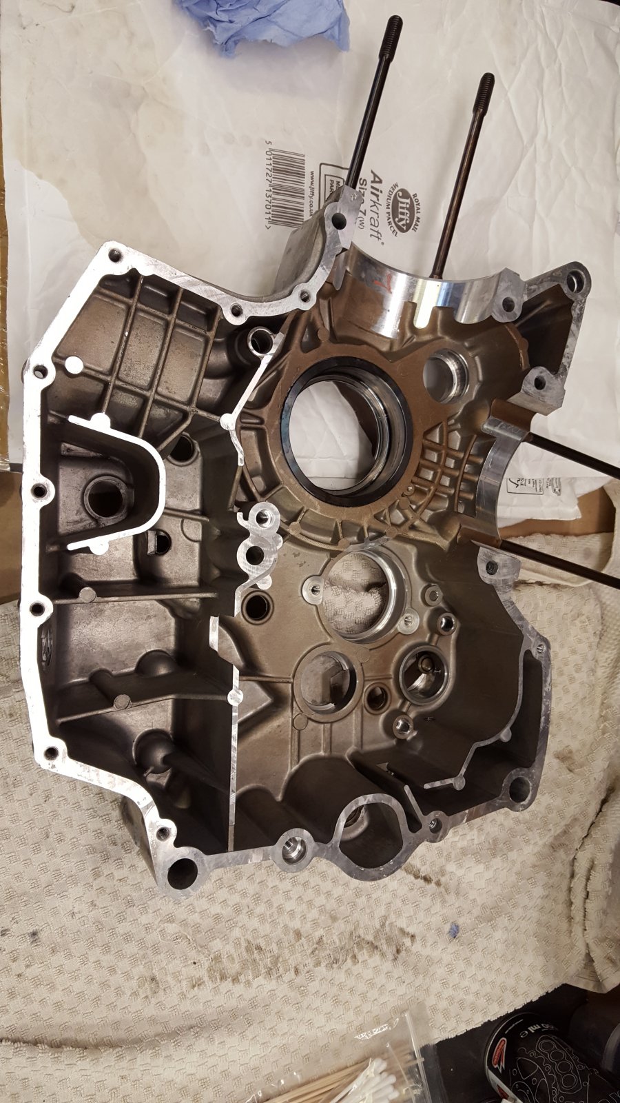

  11. Ok, figured I would start a seperate thread for the engine rebuild. This is one of the cases, I was cleaning them today. Nearly ready to start....
  12. The original cases have an oil pressure release on the inner wall, the ST2 cases I have, which I am using, just have an untapped hole. I have ordered a later oil pump which is meant to be better anyway. This will have the pressure release on it so I will have to tap and block the hole on the case.

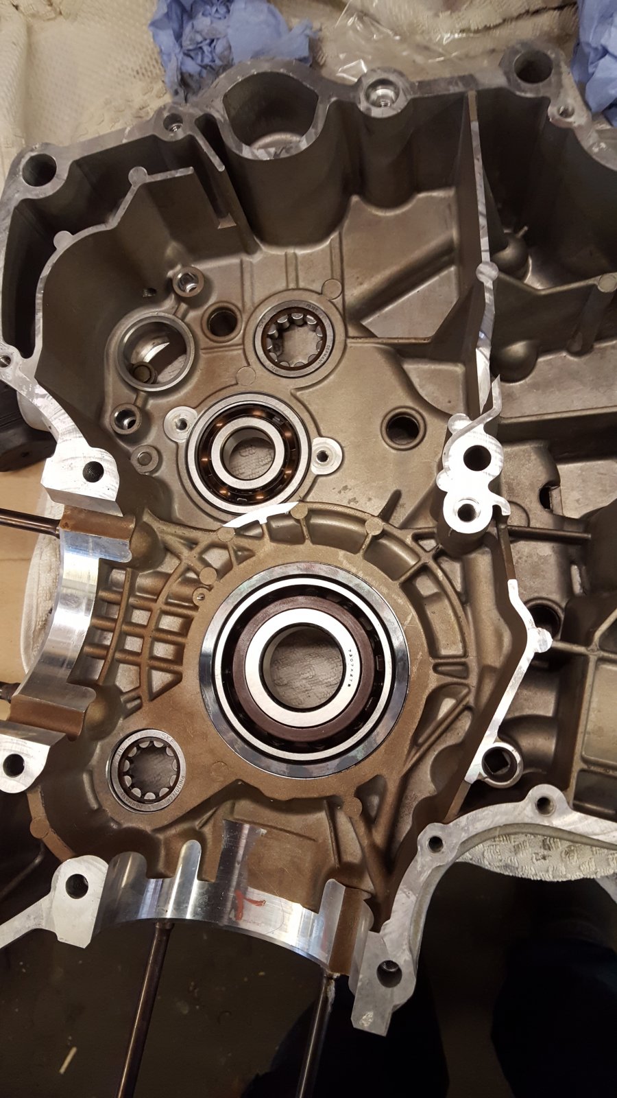

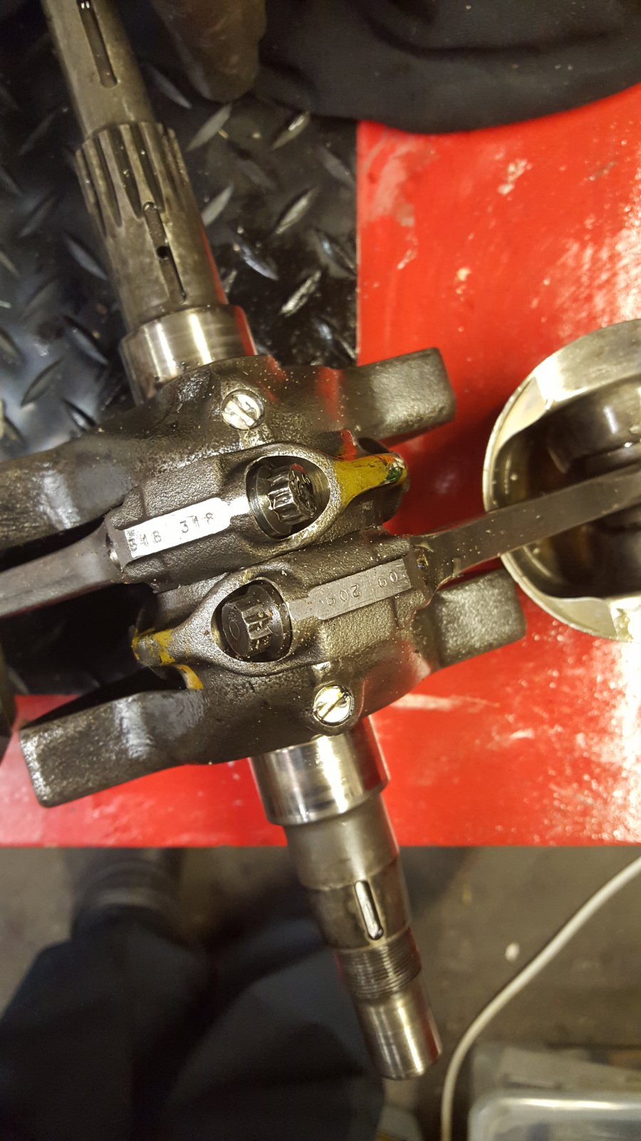

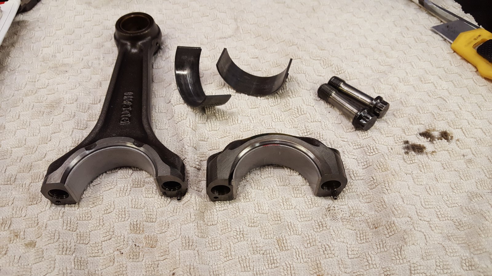

    Shiney new bearings in. Heated RHS case on bar heater, main just dropped in others required a little help.
  15. You may need to do some engineering work to fit a later pump? I used a DS1000 pump on my Monster as it has a greater flow and aside from the gearing being wrong (you can fit the old gear to the new pump), the oil intake port is significantly bigger - so much bigger that it won't seal to the port in the crankcase. I had to machine a bush to fit into the pump inlet to allow it to fit to the oil port and the sealing 'O' ring to not fall into the pump.
    Both of these mods will reduce the pump output somewhat, so I'm not sure exactly how much extra flow it does give?...
  16. Ok I will look out for that, its off an ST so its old too and just has the oil relief on it so not much difference I hope

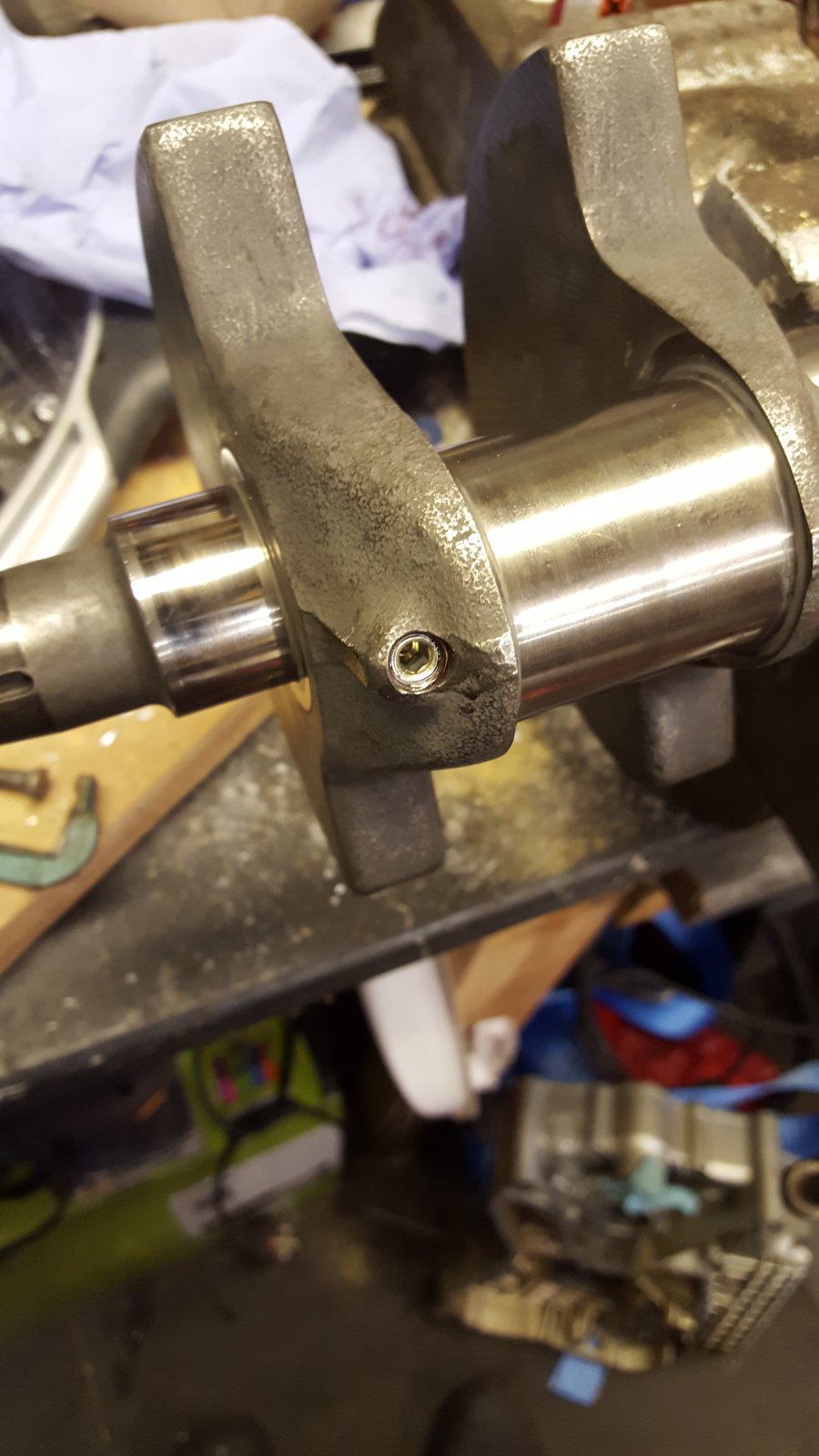

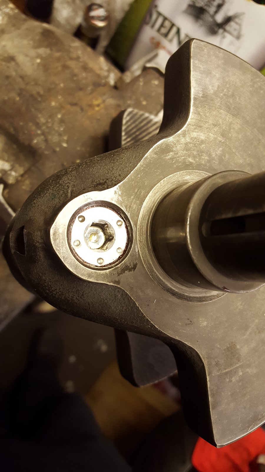

    New crank plug, permanent thread lock and punched 5 times
