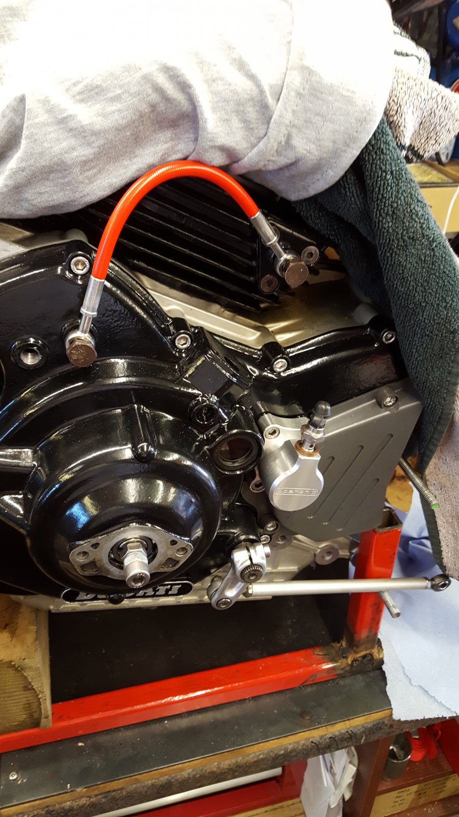

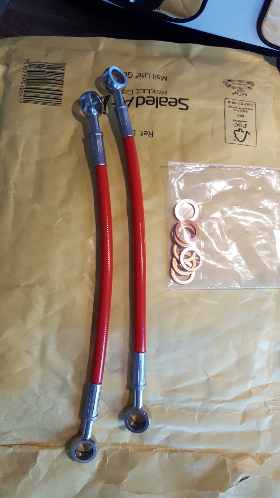

    Oil lines arrived, not quite lined up the unions there will be a slight twist but it'll be ok.
  4. I spoke too soon, you can twist the end gently and it'll move. Homemade stand needs painted too.... 1464865935637373693439.jpg
  5. "Send the buggers back"
    And look at those rusty old union bolts you are using.......:wink:
  6. Well spotted Al, new Hel stainless on their way, it was just a test fit.

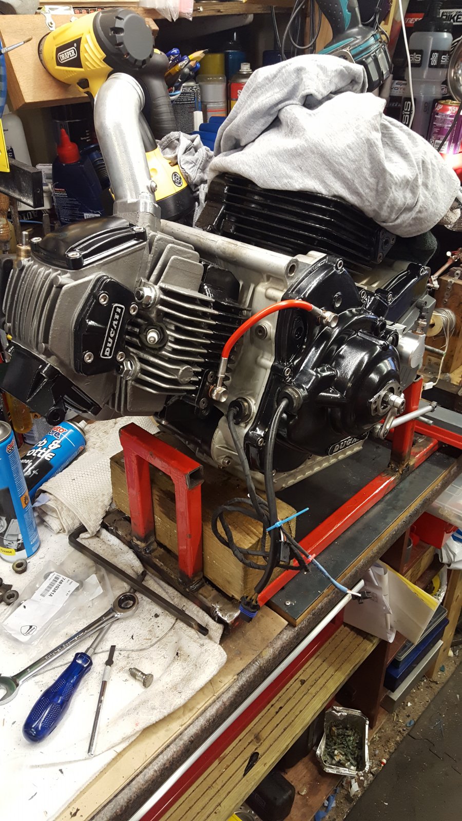

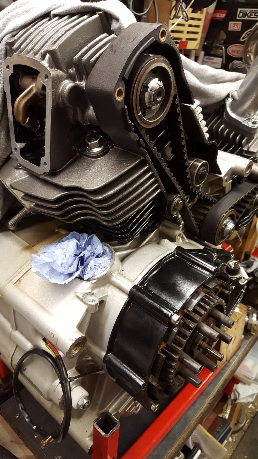

    Got my head screwed on tonight! Head nut tool twisted so needs more metal welded to strengthen. Oil lines look ok too, wasnt sure of the red I chose. Rebuild other head then into bike! Wow, getting there......

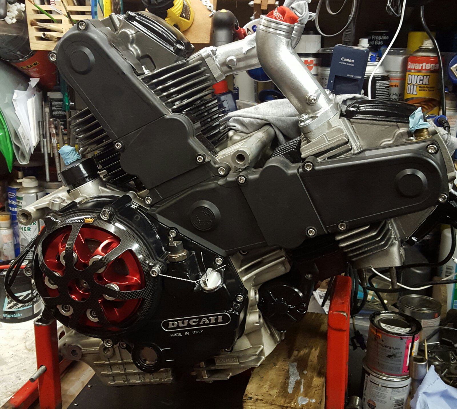

    Progress report, Vert head rebuilt and on, belts on...soon into frame!
    Ta Da!!!

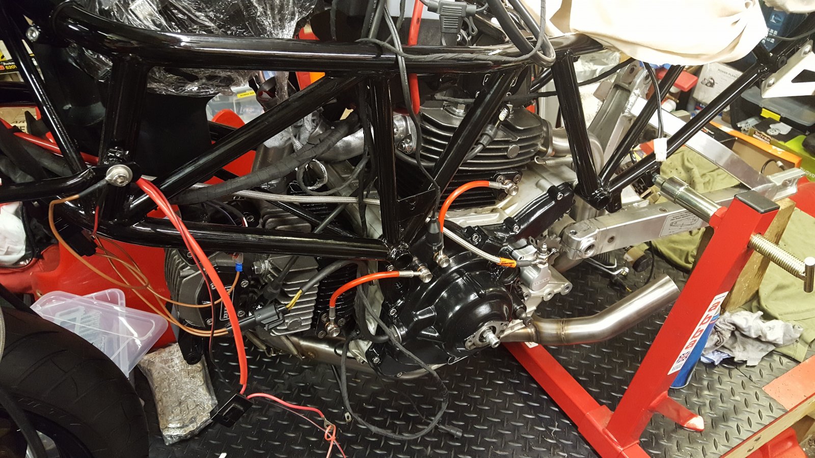

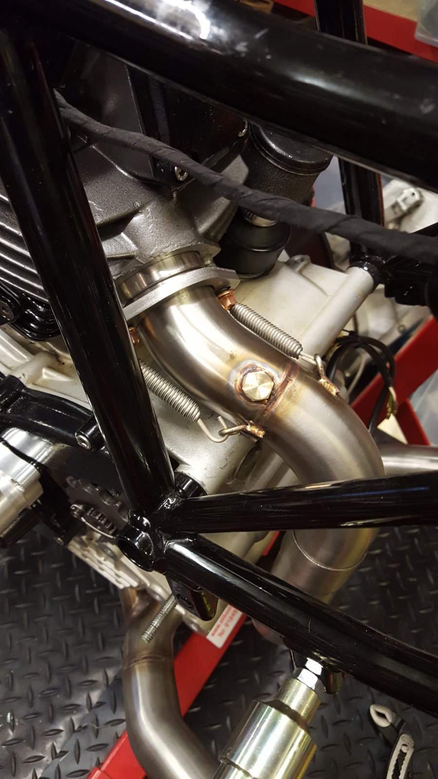

    Todays work.... 20160612_211450.jpg 20160612_203940.jpg 20160612_203922.jpg 20160612_211905.jpg
  14. Coming together very nicely.
  15. Its Sil motor Sev, full system. Its nice.
    The rear downpipe springs only seem to go on as in the pic where the holes are on the underside, if I have the holes on the bracket on the top then the springs aren't stretched. If that makes sense.
  16. Cool, looks a bit wierd in the pic just made me wonder. Thanks Sev.

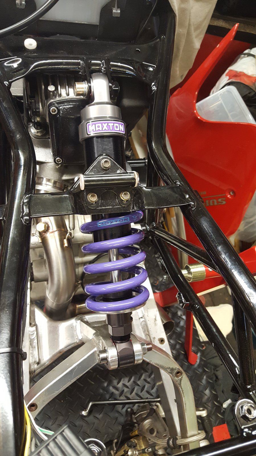

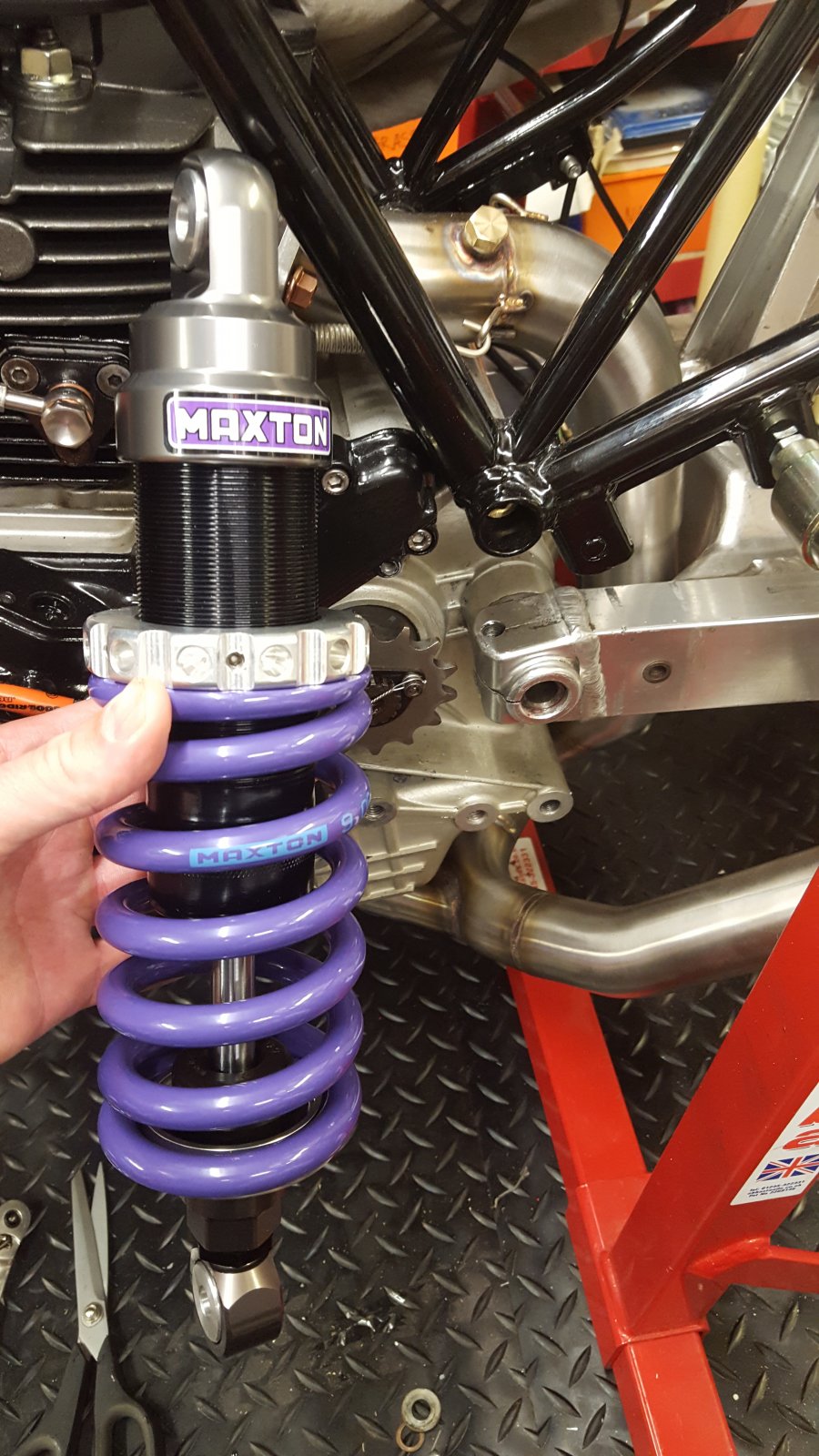

    Purple spring means awesomeness
  18. Looking great! But what about that impending panging feeling the chunky swingarm and Ohlins shock?
  19. Rich, I dont want an Ohlins, hence the reason I bought Maxton. I have however thought about Metmachex...
