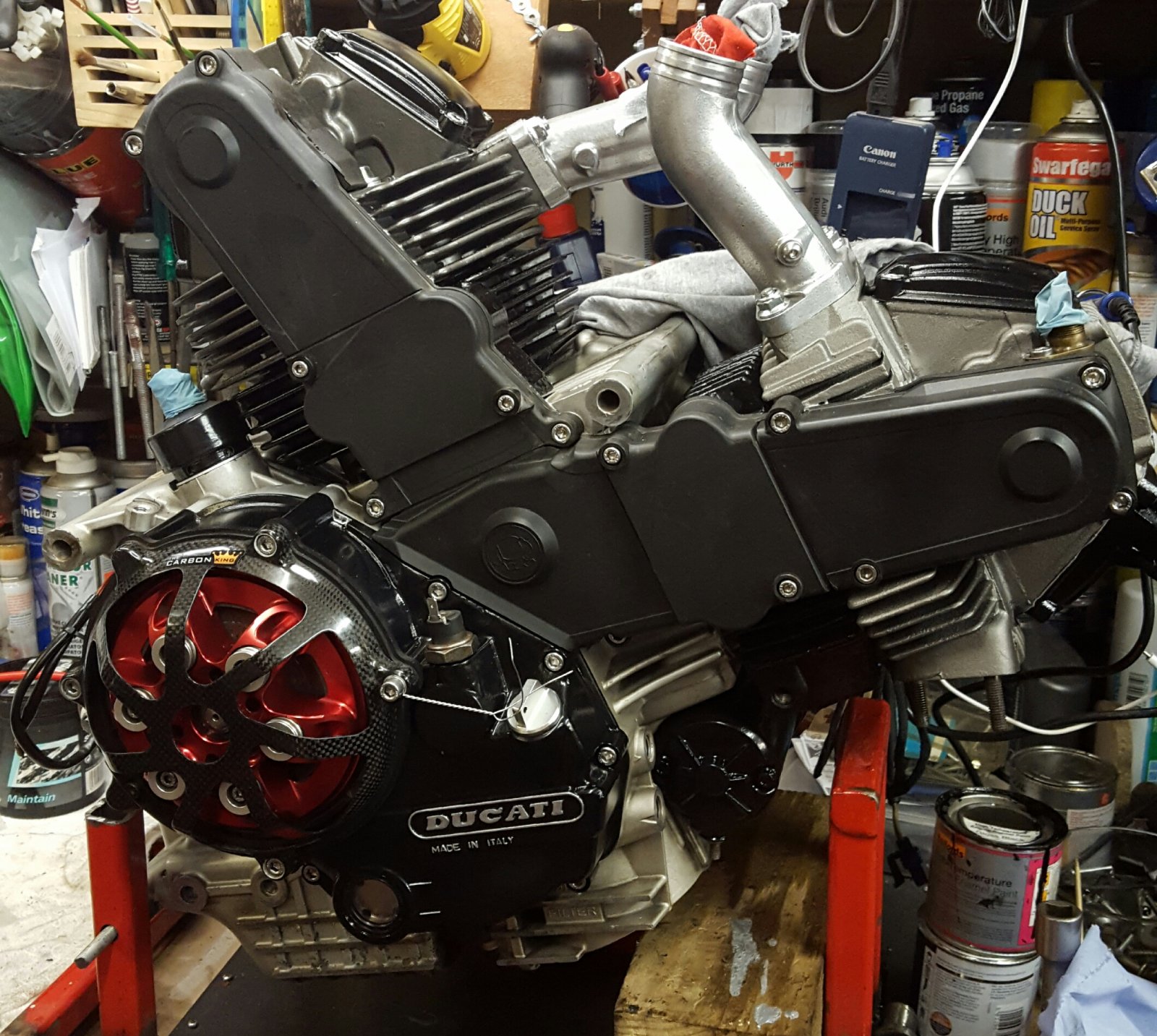

  3. SHES ALIVE!! :screamcat::screamcat::flushed::tearsofjoy::tearsofjoy::tonguewink::tonguewink::sweatsmile::sweatsmile:
    Rough but timing need sorted for high comps.
    2 years work and started first time!

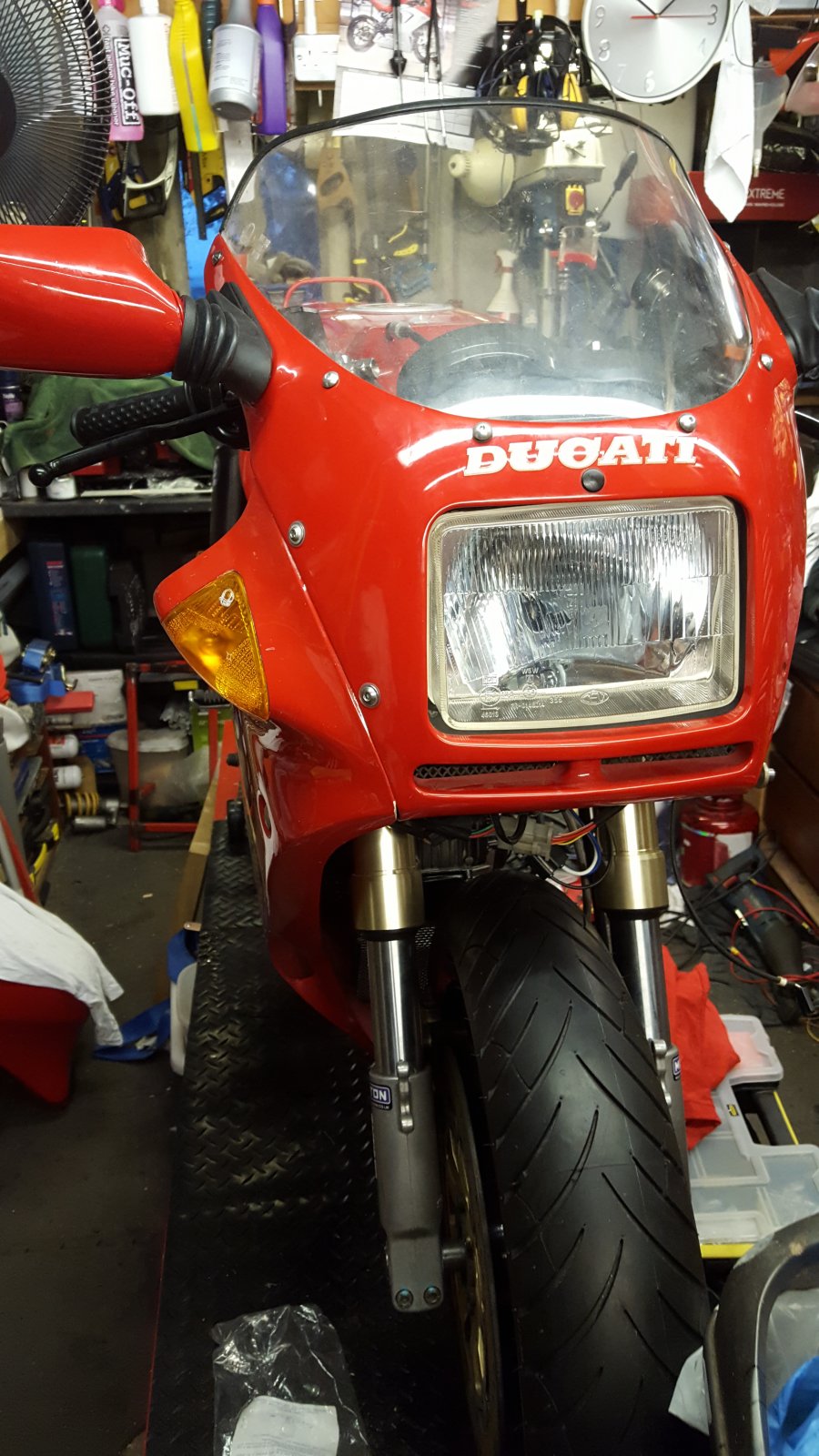

    Nearly there, will get some decent pics when shes outside
  5. excellent, well done. (do you get confined space allowance working in there?);)
  6. Thats it tidy! Filled with bike bits, tools etc.

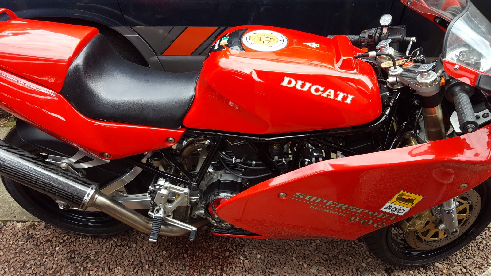

  8. You've done a great job there. Feel proud.
  9. Thankyou, I am very happy.
  10. She looks lovely, good job.
    Nasher

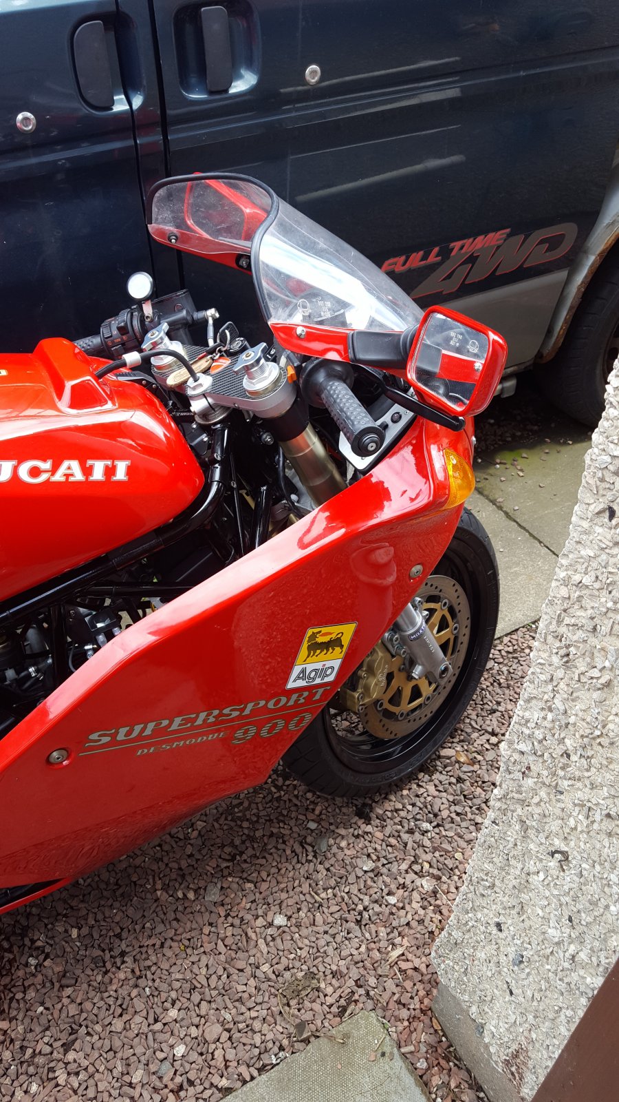

  12. It passed MOT!!!!
    So happy, running a bit rough at idle but once going sounds awesome. Baffles still in too, mwahahah. Gotta get it set up at dyno methinks.
