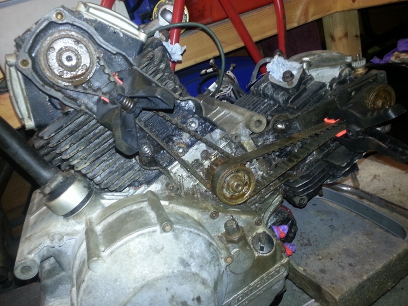

  1. Just a little update. Both sets of adjustable rollers and both fixed rollers came out with no problems what so ever. Nice easy progressive force. Starting to look better already! I am going to see if I can get the adjustable bearings from work before buying them, (found them at £3 each approx), the fixed bearings have an SKF number on the bolt head but are proving more difficult to source (I see a lot of other people have had the same problem). Anyone found them for cheaper than Ducati prices? Cheers

  2. Well Done Stew, you have obviously got the magic touch !! It does not look half so bad now the fur is all off ! Nice use of welders clamps, you must be a power station guy !
  3. S'better! :upyeah:
    I would at LEAST - pop the heads off tto check the barrel condition & do the shims etc?
    Dunno where to source the fixed roller bearing from? What do the old ones feel like? A little *crunchy*?
    ** loving the belt clamps!

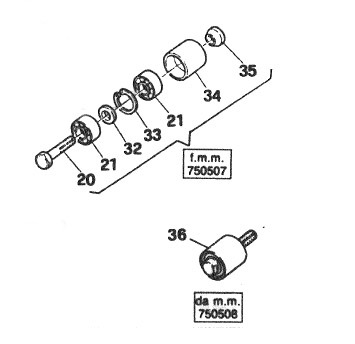

    I recently removed a couple of fixed pulleys and found them to be cemented in with blue Loctite and they were hard to get out, and incidentally the fixed pulleys come apart and there are 2 smaller conventional bearings inside.
    That internal circlip might give you some problems though :wink:
  12. Does the circlip have to come out, or can a bearing be pulled / pushed out of each end....?

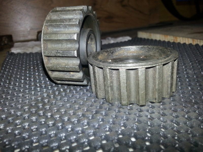

  16. I haven't a clue. I tried to take one apart several years ago but couldn't get the bolt out :rolleyes:
  17. Part 35 in the exploded diagram, is that a nut as such? Like a bicycle wheel or pedal bearing cone? Does the bolt screw into it to hold the lot together?
    Shouldnt be too much trouble to strip one down,I always assumed they were sealed as such. :)
  18. I don't know, I hadn't seen this diagram at the time and couldn't figure out how it cam to bits. :frown:
  19. Looks like a wheel-bearing arrangement? Get the bolt & nut out of the middle, then tap one out of one side through the middle with a drift, same for the other side? Circlip stays where it is! ;)

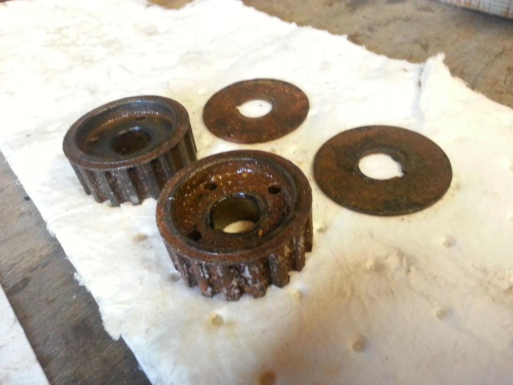

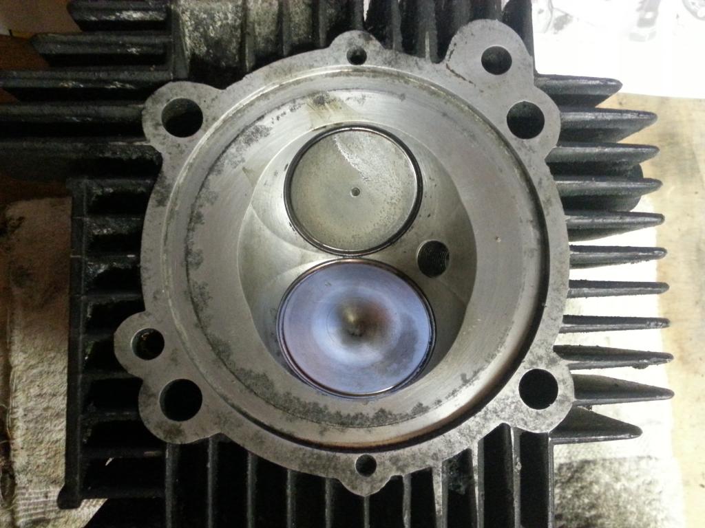

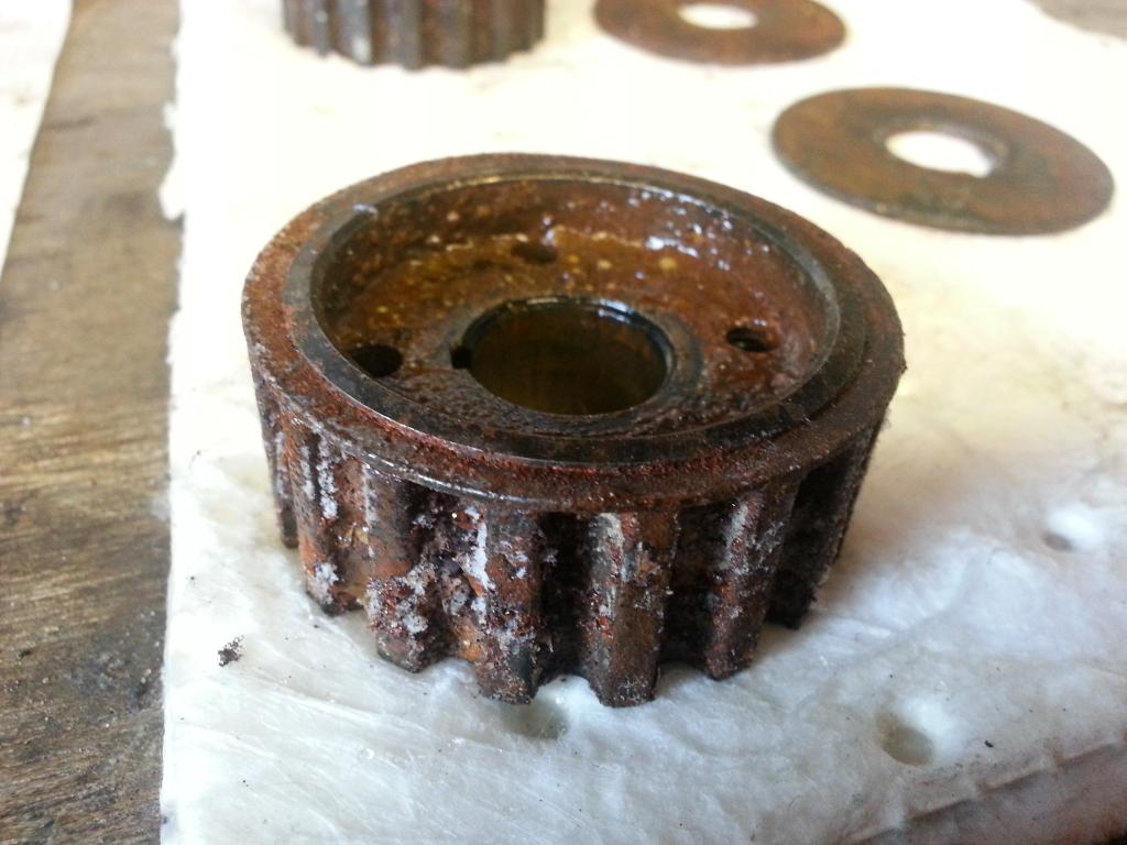

  20. Just to update: The cam pulleys were subjected to a bit of electrolysis and came up not too bad! Gave the horizontal cylinder head a bit of a clean too.
