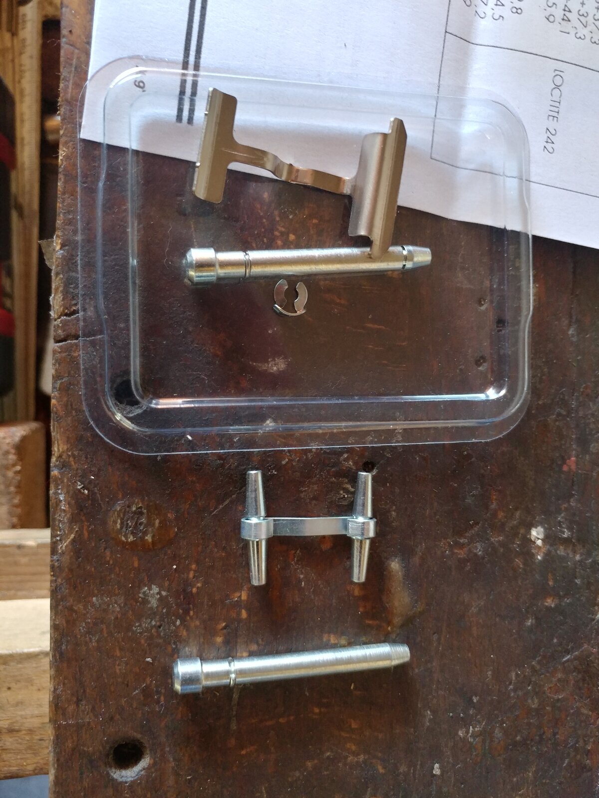

  1. Someone I know had some Brembo brake spare-parts and he had a set of the parts I needed:
    New parts on top, "old" parts below.
    As it was sunny outside I took a few pictures outside.
    Needs new Agip-stickers. :)
  2. Top ones are correct. The circlip is a pig to fit when the caliper is bolted on. I added a small R-clip by drilling a 1mm dia hole close-ish to the circlip.
  3. Yes. Yes, it is. :laughing:
    My RSV has the same circlip, it never fell of, even after changing the pads a few times, so I'll leave it as it is now.
    The pins on both sets have the same diametre, 4.8mm, so besides the groove they are identical.
  4. Looking at those pictures, the top set of parts are what I have fitted on the front calipers plus the addition of the hole for the R-clip. The lower set are what is fitted to the rear caliper, the retaining pin is in rock solid and I normally use a pin punch to knock it out. The pin is kept in place by the pressure of the anti-rattle spring, which tends to suggest that the spring is not applying enough upward pressure if you are getting movement on the retaining pin.
    Pictures to follow shortly
  5. In the pictures of the brake pins and springy things; the correct parts for the rear brake (Ducati Part Number 612.4.013.1A) are those in the clear plastic 'tray'.
  6. I Agree with AL.
    I've had 3 (still got 2) 900s and they all have the arrangement as per the top items in the photo above.
    I have never seen any items similar to those in the bottom of the photo.
  7. Perhaps you have a different caliper??
    Idiosyncrasy of Steine-dinse website - always use the parts diagrams for the 900SL - there you will see which are the correct items (like wot I have already mentioned).
    I cannot find any reference to that part number being superceded.
    But as I have said previously; maybe your parts are just an alternative for the same caliper (as fitted maybe to Aprilias) and if they work, then probably OK.
    The brake pads all seem to have a small dip / recess either side of the tags for your version of the springy thing, regardless of pad manufacturer.
    AL
  8. Hey this is Ducati we're talking about, given the age of the SS and how this relates to Ducati history and the parts they had to hand, I'm not surprised that something as small as an anti-rattle clip can be so different.
    As you say AL it works, and at some point someone has drilled a hole to put a split pin through the pin probably because they were worried about the pin coming out.
  9. Thanks a lot!
    Perhaps those parts have been replaced with the sheet-metal as it's an easier manufacturing process and therefor cheaper - the functionality is the same. Both setups seem to work in my caliber, the sheet metal has the same points of contact as those cone-ish pins. The pin doesn't really sit rock-solid, it wobbles a tiny bit, but with the circlip it should be good.

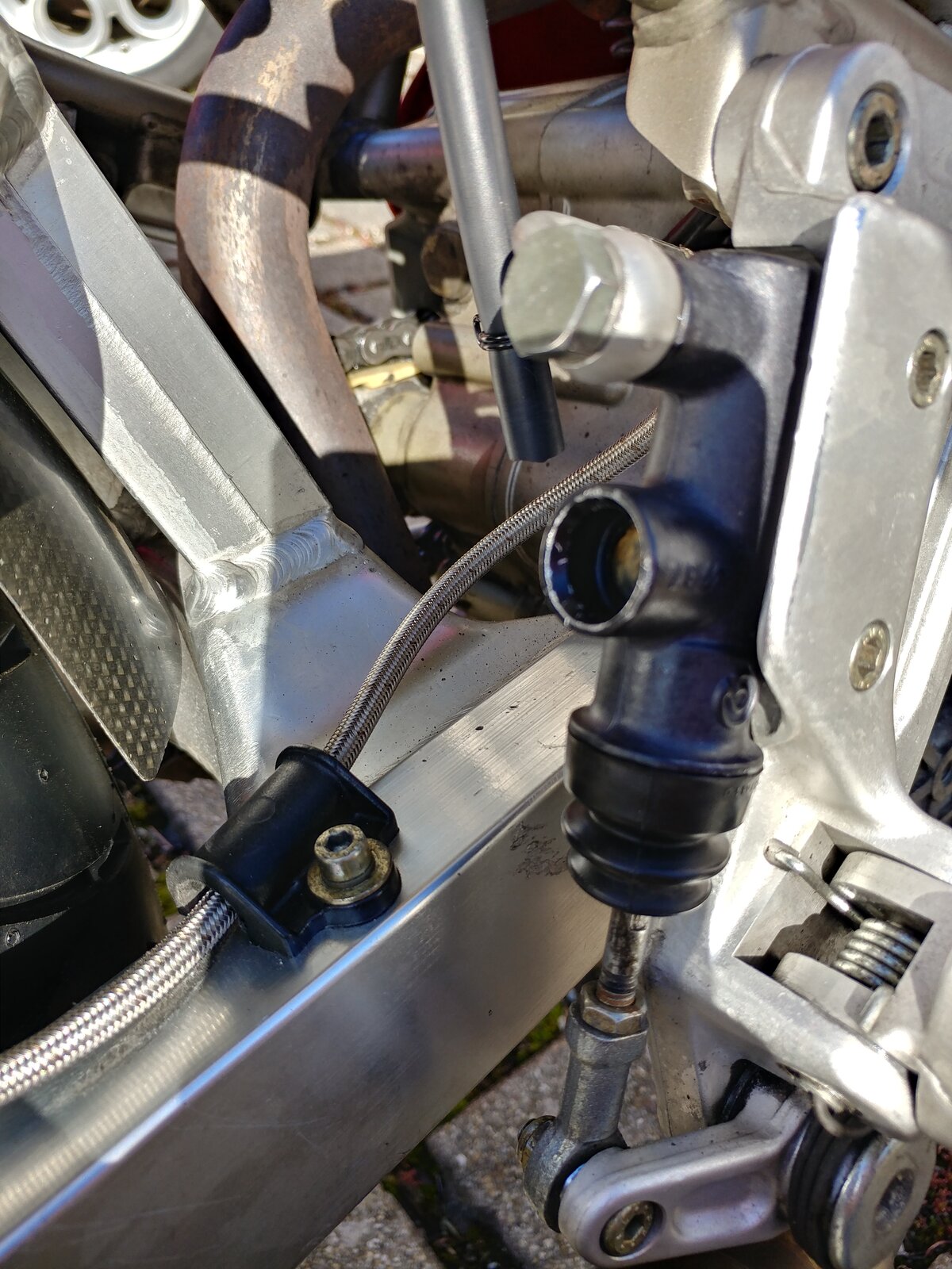

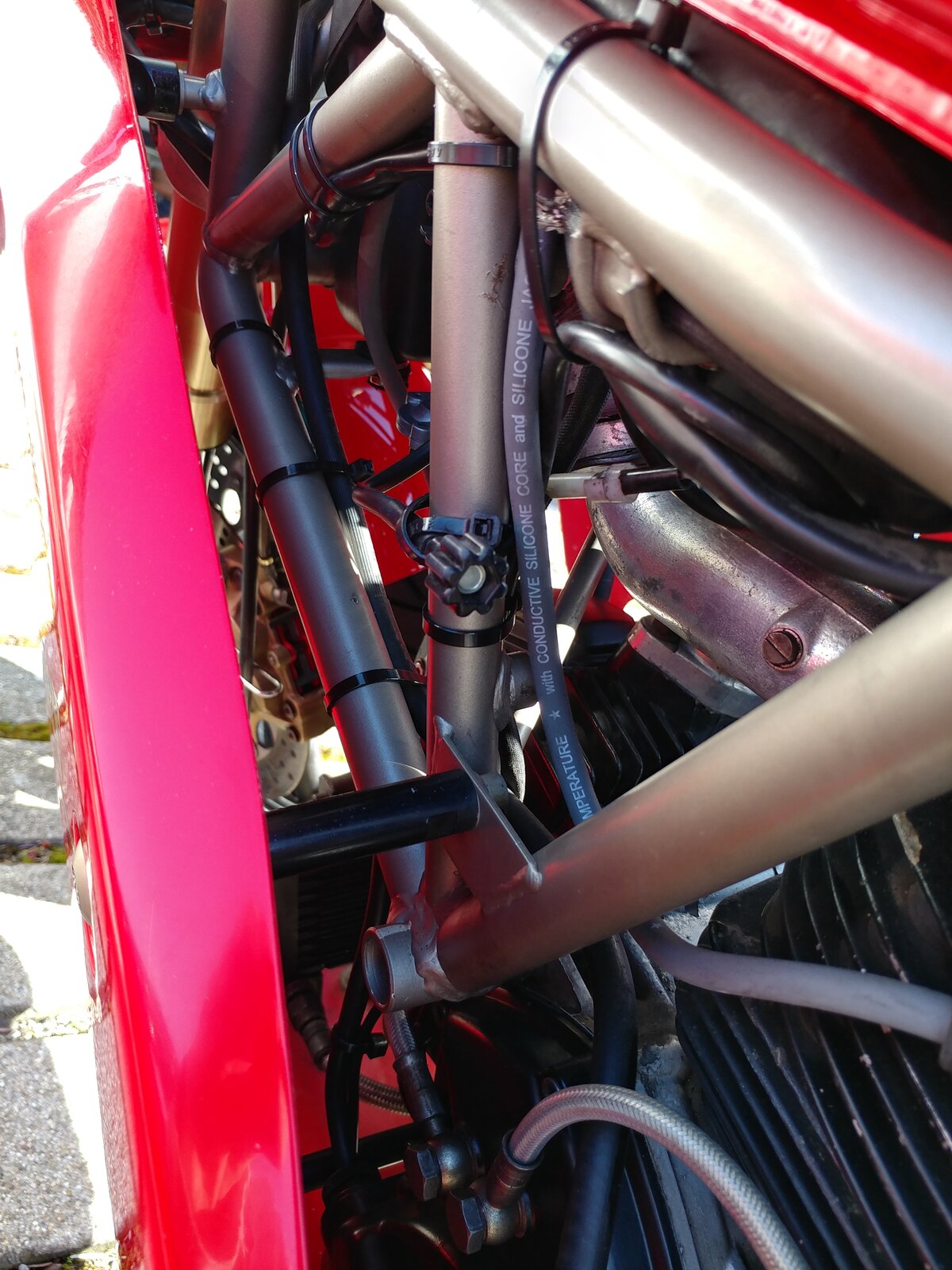

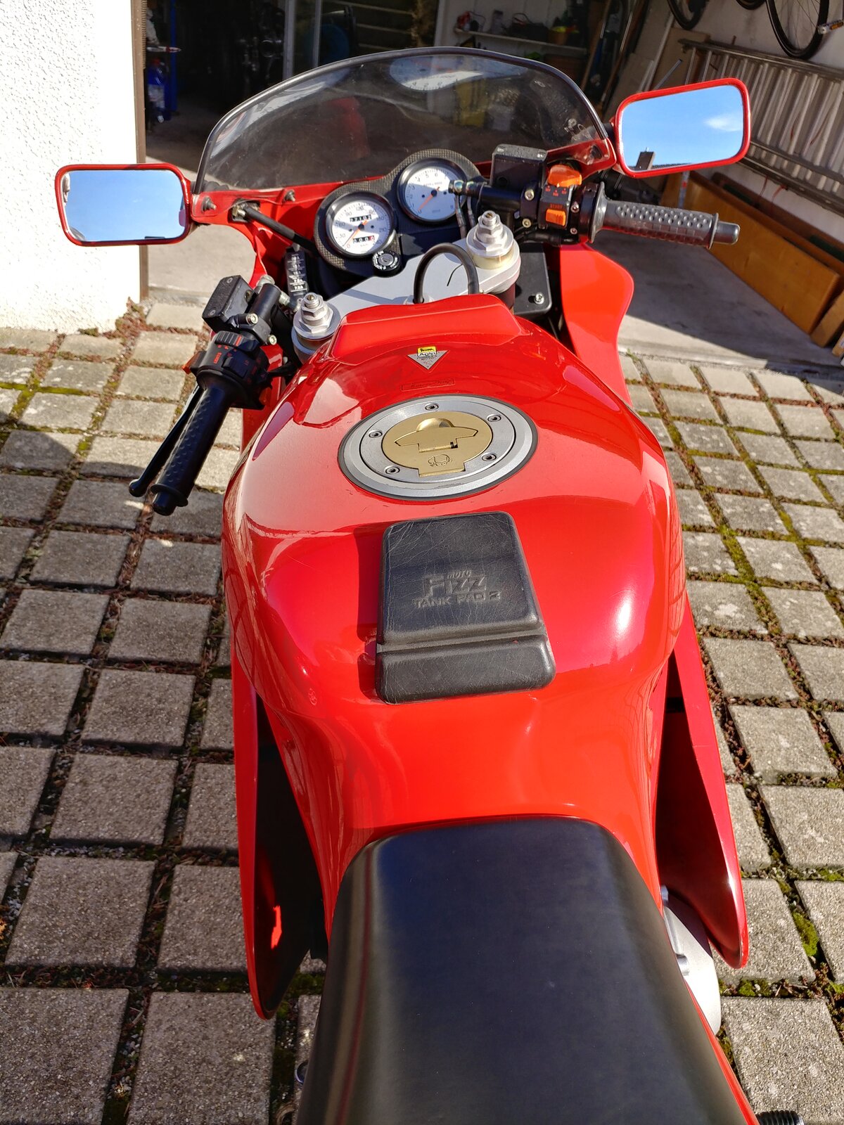

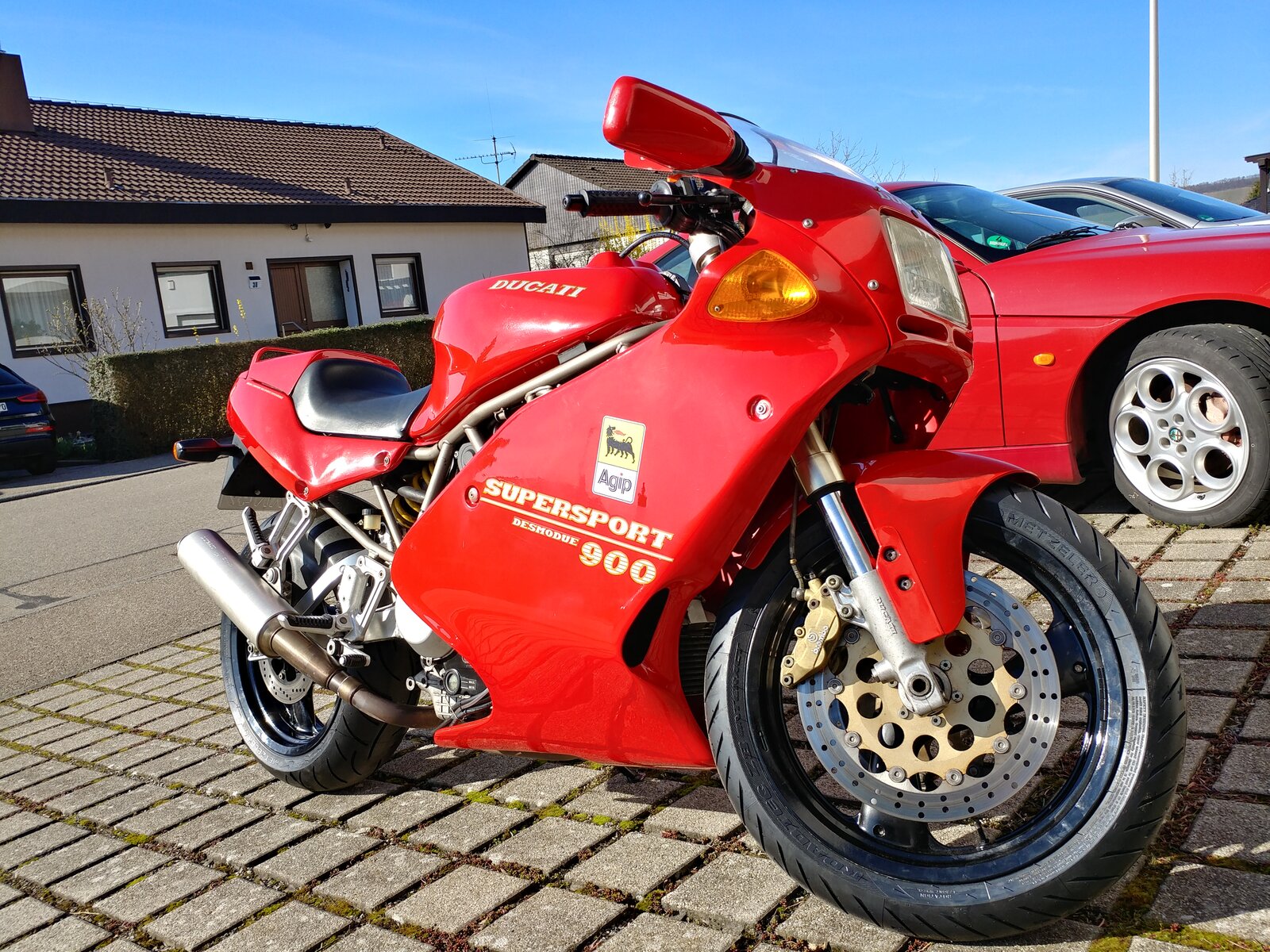

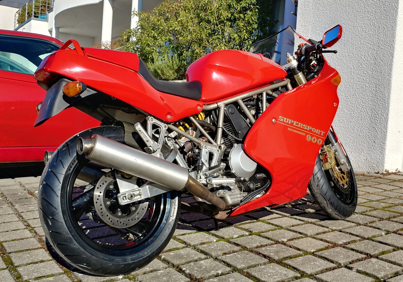

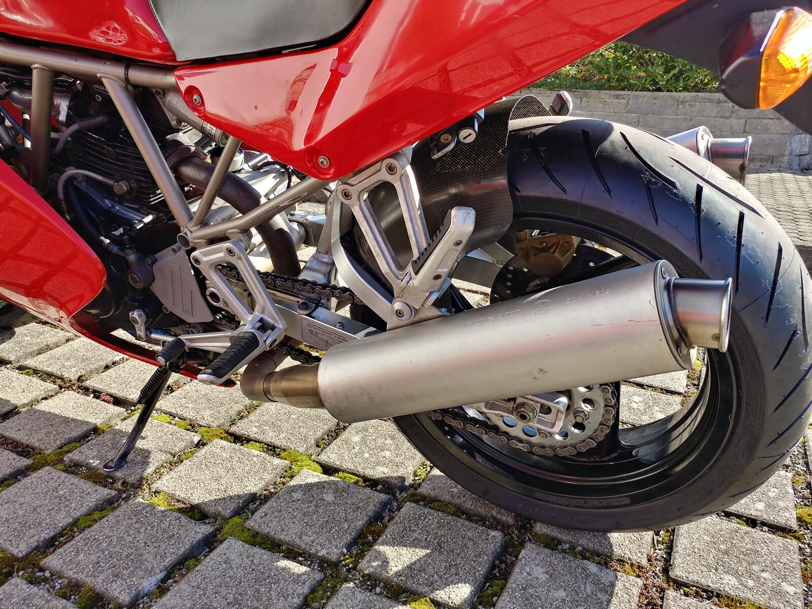

  10. Done a few more minor things and - after I install a final seal tomorrow - it'll be ready to go:
    Agip stickers where put where the original ones probably were.
    Rubber tubes.
    After refilling and bleeding the brake I noticed there is fluid leaking out of the seal when there is pressure to the pedal so a new one was ordered.
    Routing the brake lines etc. took a while but worked out well. the Triumph accelerator cable seems to fit in nicely.
    So clean. Won't last long.
    Cable ties for the idle screw. I'll fabricate a proper solution in the next holidays. Probably.
    The 90s tank pad got re-installed with fresh sticky stuff.

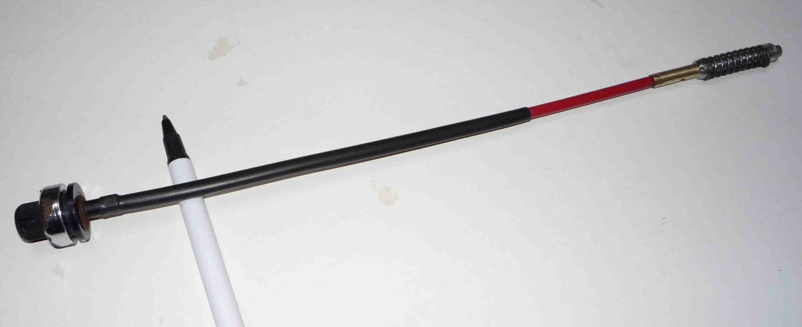

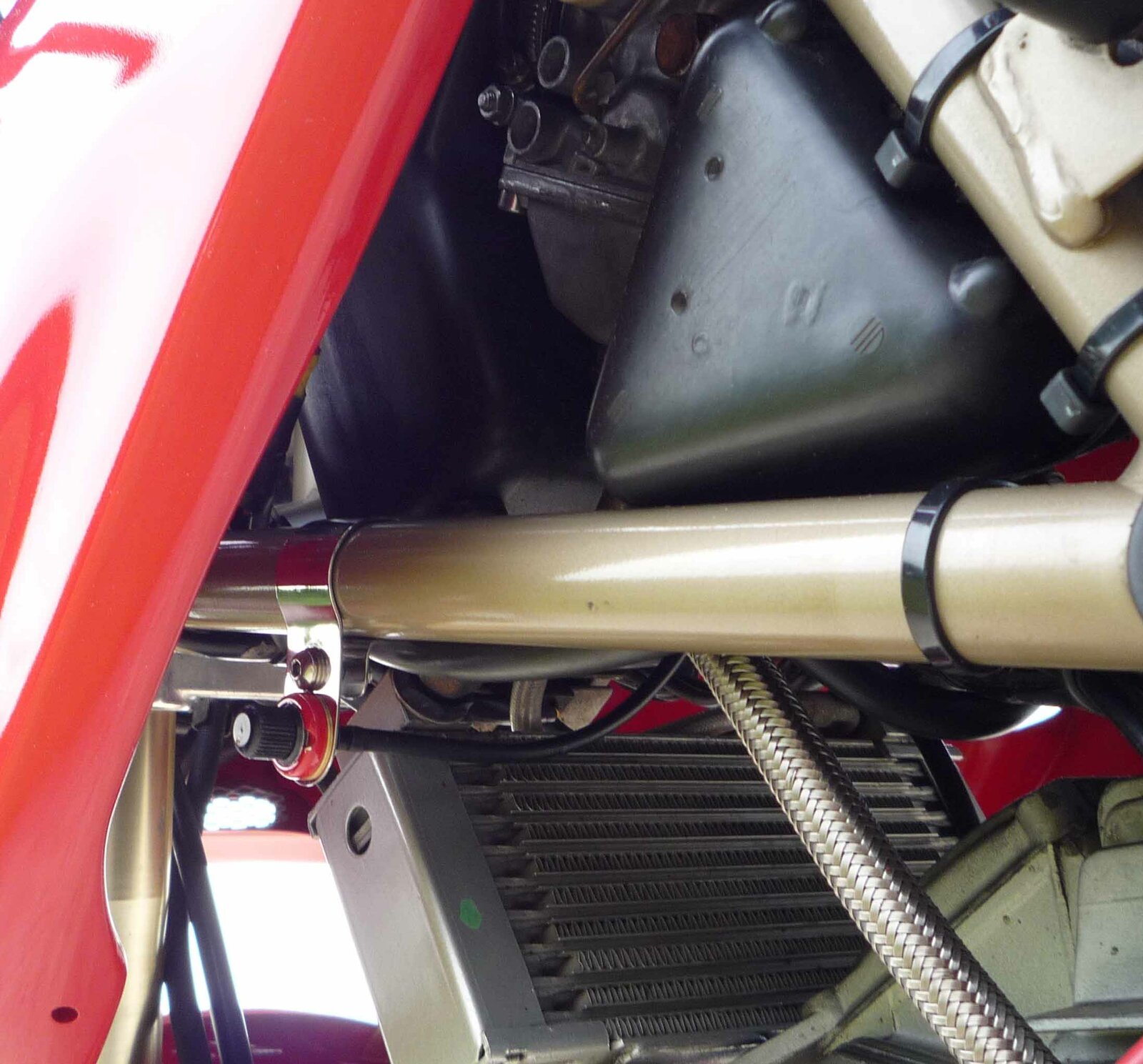

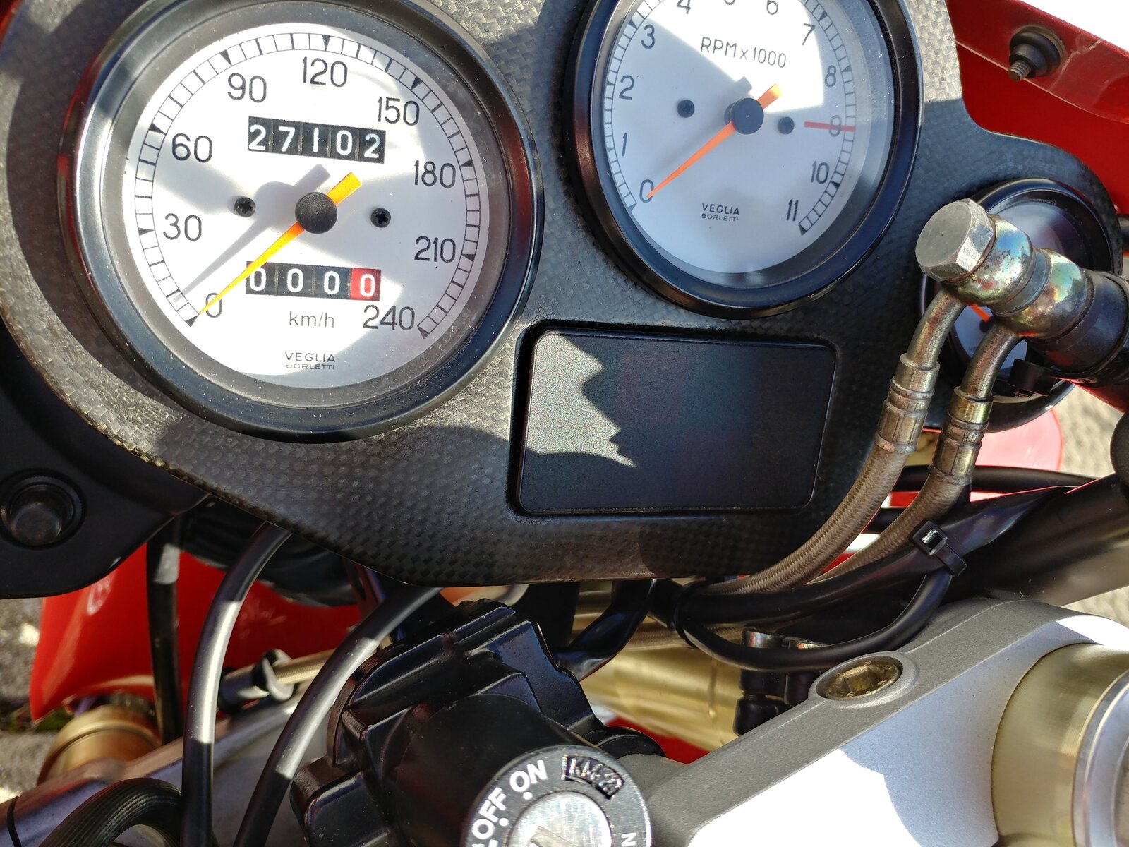

  12. I made a remote idle screw adjuster from a spare trip meter knob and cable, plus a spare idle screw.
    You can see my knob below.
  13. Great idea and I see I’m not the only one to polish my frame.
  14. Great idea. And that's one shiney knob. :laughing:

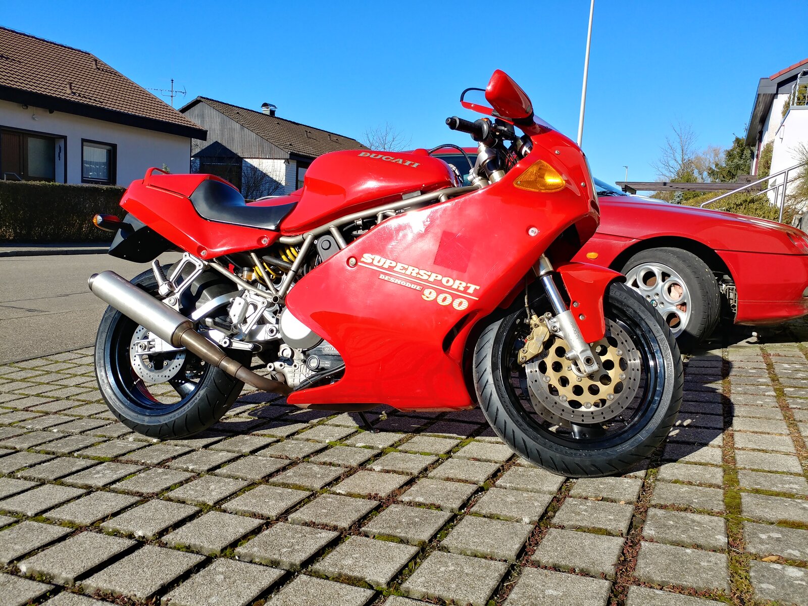

  15. First ride, roughly 5 miles, drove half of them. :motorcycleduc:
