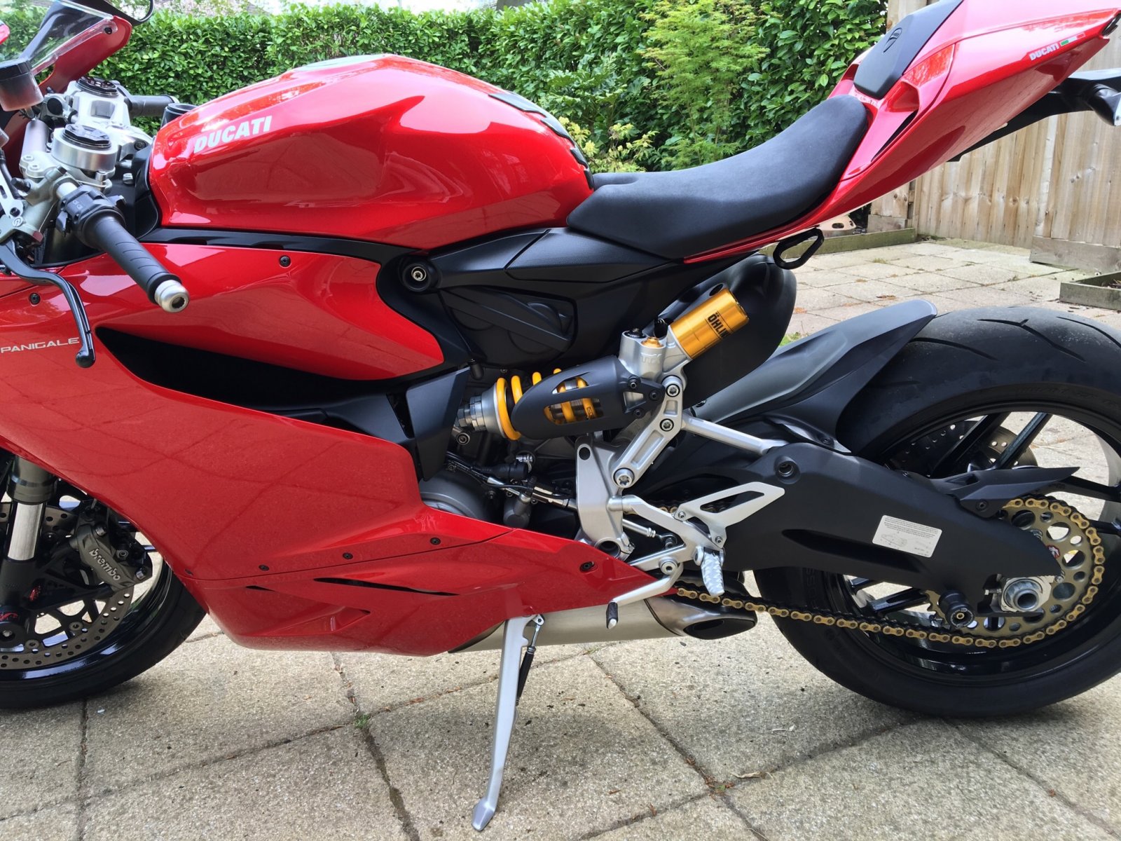

  3. IMG_8169.JPG Just to balance things up Ohlins gold,maybe for sale soon along with steering damper and r&t forks.

  8. All off a 899,was sprung for a 15stone chubb,who now is near a 16stone chubb,would be looking for the going rate, £600 shock,£1650 forks,£180 damper,will know by the end of the month if they will be for sale,

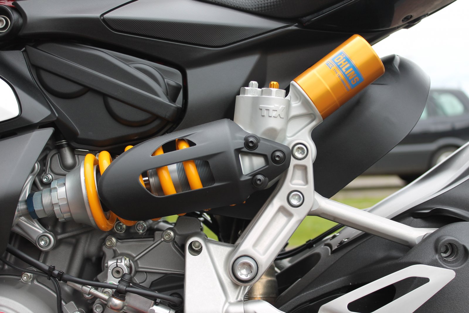

  14. Here is mine. A converted ohlins TTX from an 1199s. All in was £400
