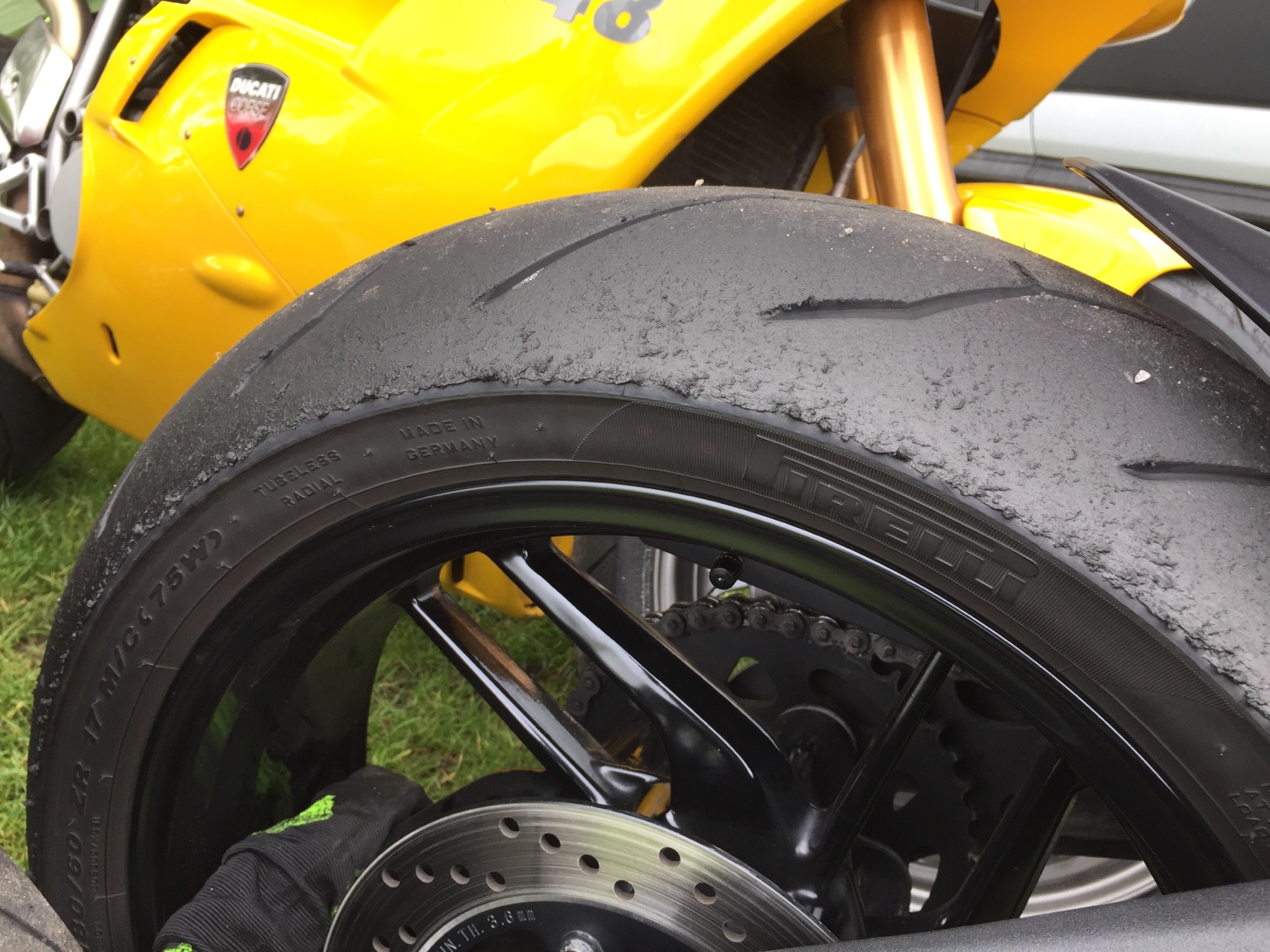

  20. Glad u like it! I've got a really grainy warn rear tyre on mine now after the trackday from a few weeks back and I'm still getting loads of feel from the rear. Also, this is the wear pattern which I would say is a sign of the shock doing a really good job supporting the rear now....
