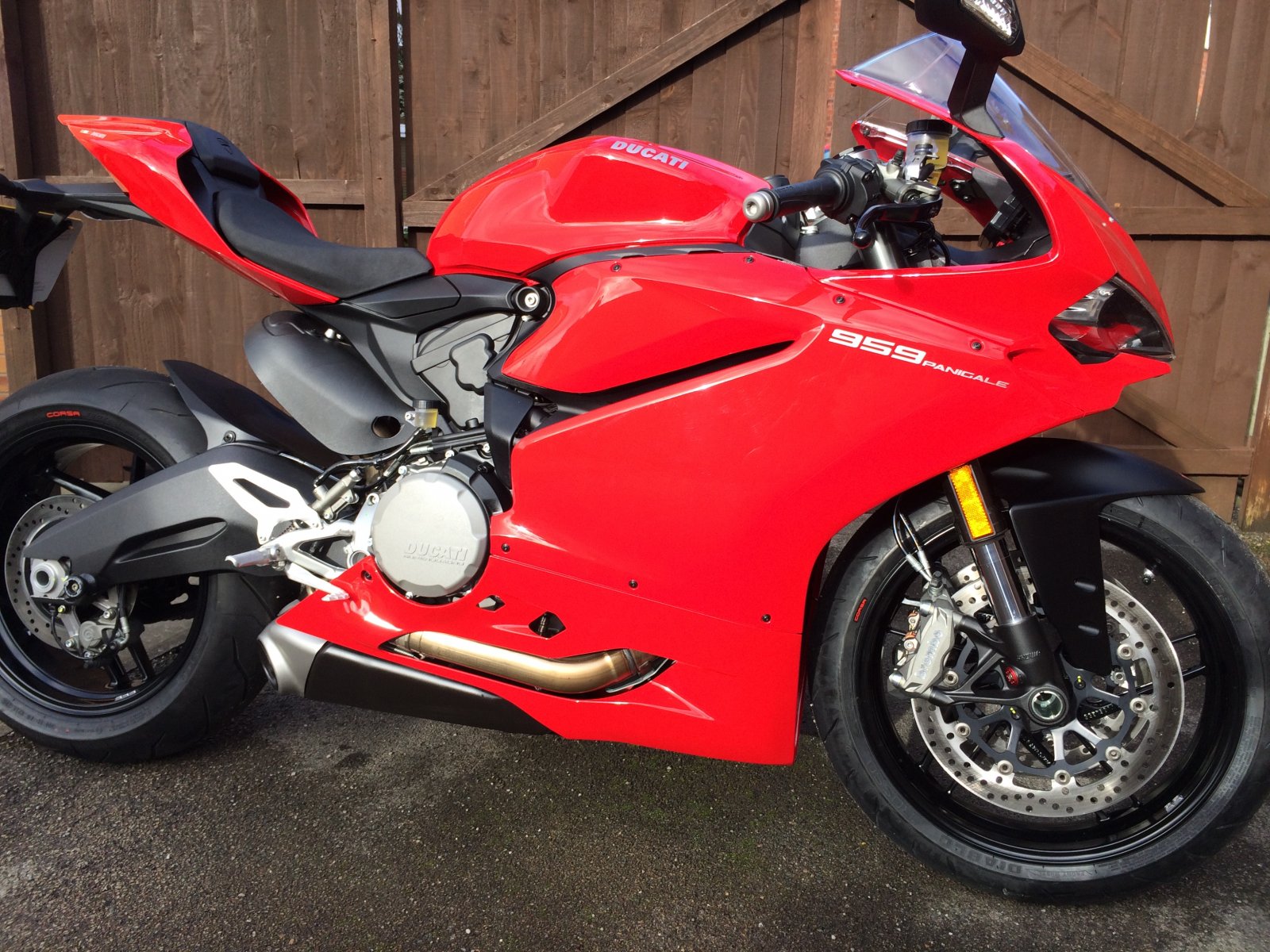

  6. Personally I love the look of the 959 without the 'Shotgun' effect. In my opinion Ducati made a knee jerk reaction to the Euro 4 ruling, did a great job in improving the engine but seems to have forgotten about the cans. I managed to source the full 1299 system for £175 and the lower fairings for £180 + fitting £180 total £535. Anyway here's my 959....

  7. Most dealers are struggling for stock the 959 has been more popular than expected and deals aren't being done.
    I got £600 off the price off mine and after ringing round the best I could get anywhere else was £300 off. I don't think the exhaust had put people off really as it's got such good reviews in the press.
    £535 for that conversion is really good - you did well there. I will keep my eye out for some fairings if they're cheap enough it opens up more options when I come to change the exhaust.
