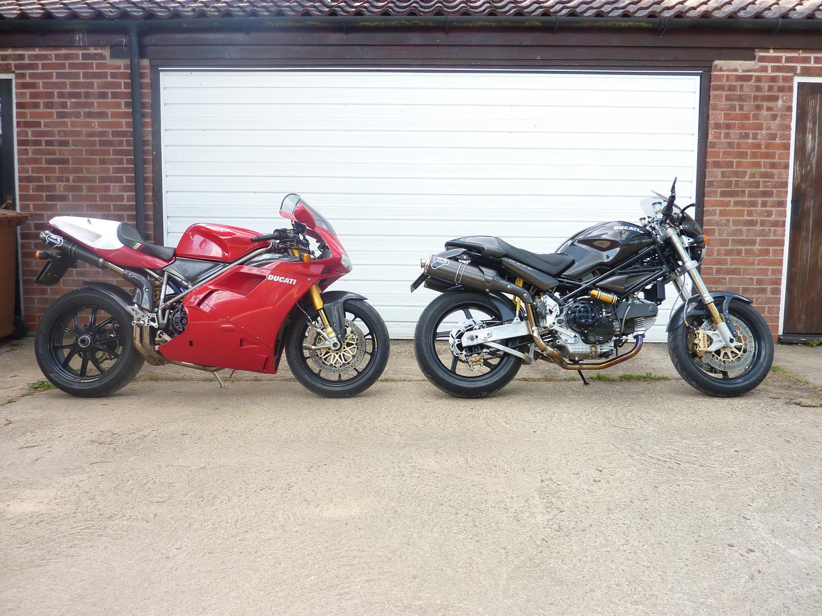

    Here's what I did, some may suggest it is overkill; [​IMG] 916 has 1198 Ohlins forks with Brembo HP calipers and the Monster has 916 forks with radial mounts and Brembo M4 monoblocs, both have Brembo radial master cylinders. I have to say neither are wanting in the stopping department...:upyeah:

    You finitoed the Monster now?
  12. Yes although still 'optimising'. Fitted new fork springs this week as it was too hard at the front but it's running very well. Pulls very hard from low revs, power delivery is about as subtle as a punch in the face... :biggrin:
  13. You should post the spec up and some photocinegraphs :upyeah:
