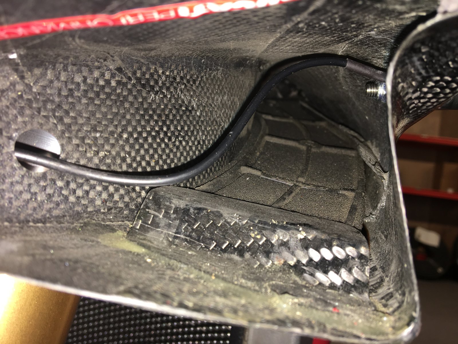

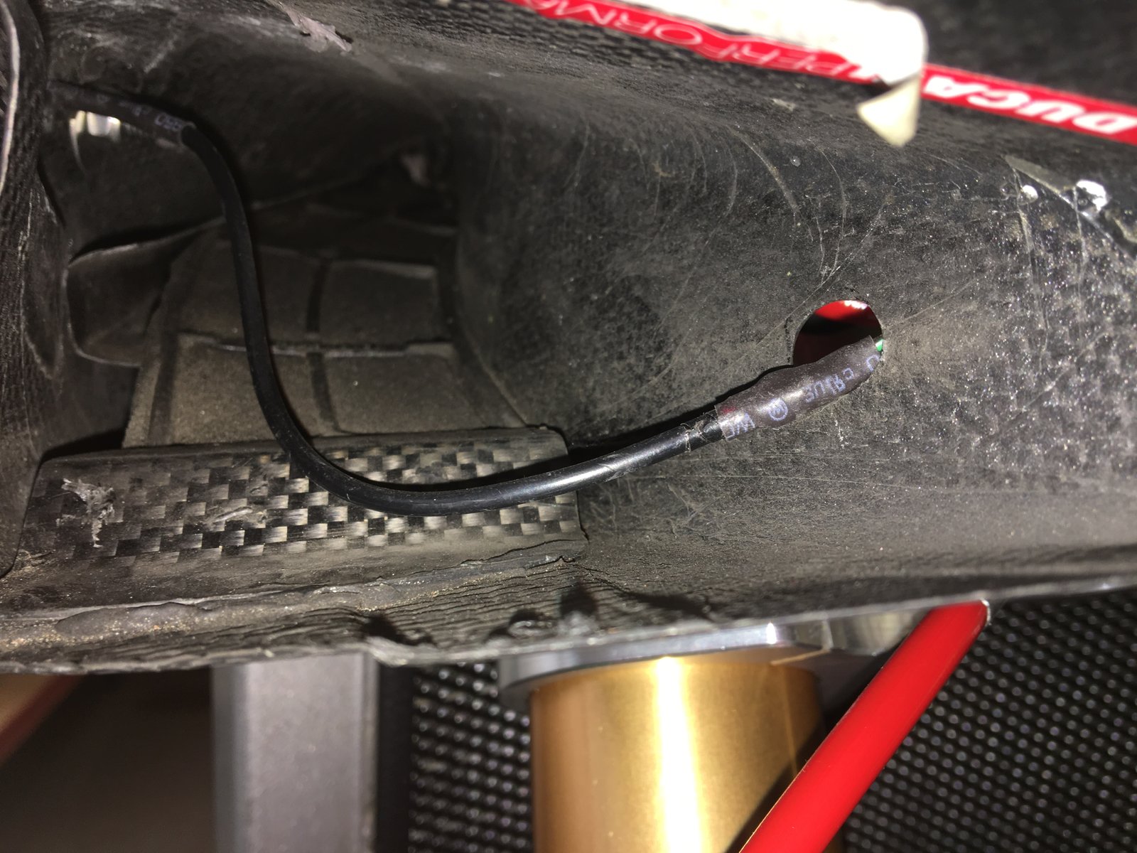

  1. Ok. @Rosie
    Thanks for the photos. They’re not like my DP ones. Mine have a bent back tab inside at the front and the U sections inside for the cages. I unfortunately have to go into work this aft and if I can, i’ll Take a few photos of what it looks like.
    So maybe DP made two versions of the small air runners...
    But why would they make one with and one without unless your U sections were inside and they’ve just come off? Possible as a couple of the CF tabs on mine were missing when I bought the runners.
    Ian
  2. Thinking about it... it might have been from when DP switched manufacturers.. (happened a few times).
    Another difference is mine don’t have the Ducati Performance printed on the outside. Just the little DP labels inside the runners...
  3. Just a thought but I could have race ones.
  4. Unlikely ,as they have indicator mounts.
  5. Didn't think about that. Now I can make mounts for my original filters to go back in or just add an after market set to the mouth openings. Would it be better to keep to the originals ?
  6. Not if they're anything like the flimsy affairs that are OEM on a 999.
    The Pipercross filters are enormously better made.

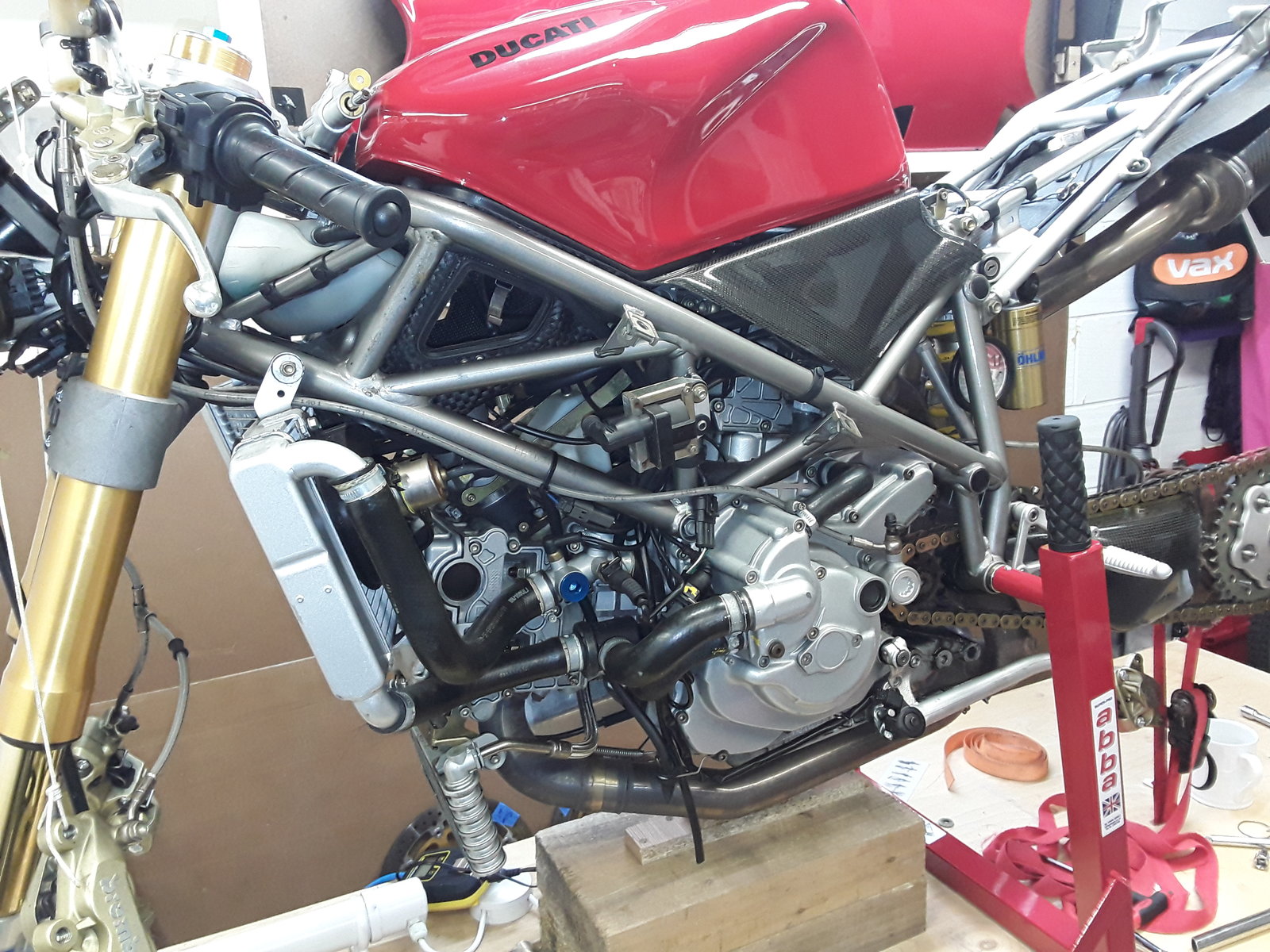

  7. These are mine.
    34FE0B11-49F2-407F-885F-EA4EF4C83075.jpeg A3FD7A8E-6A9E-45B1-9ADD-B0E753E4679C.jpeg
  8. Thanks for the photos. Looks like you are right they are quite different. Will look to add a bmc or pipercross filter in the air box. Getting bike stripped down as having all the nuts and bolts re-anodised. Even when I thought the bike was very clean when I bought it last year you always find dirt everywhere.
