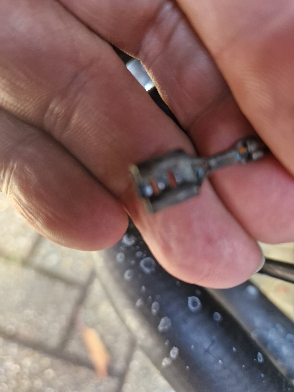

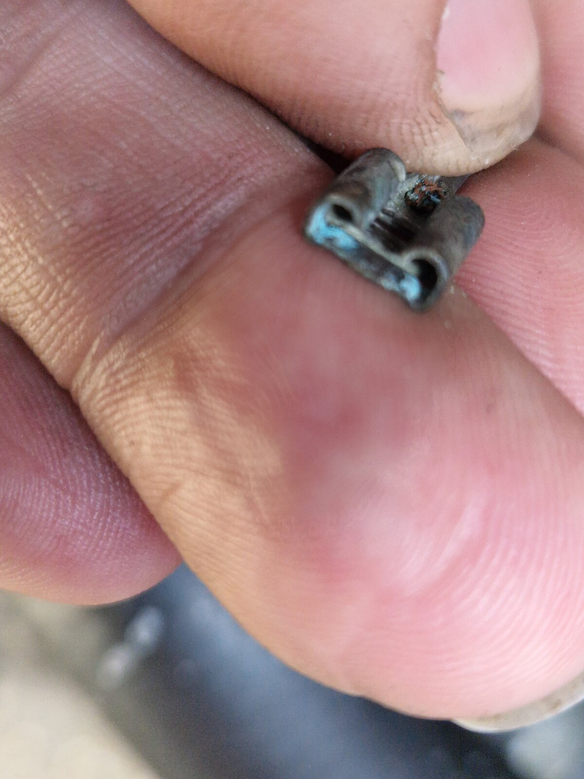

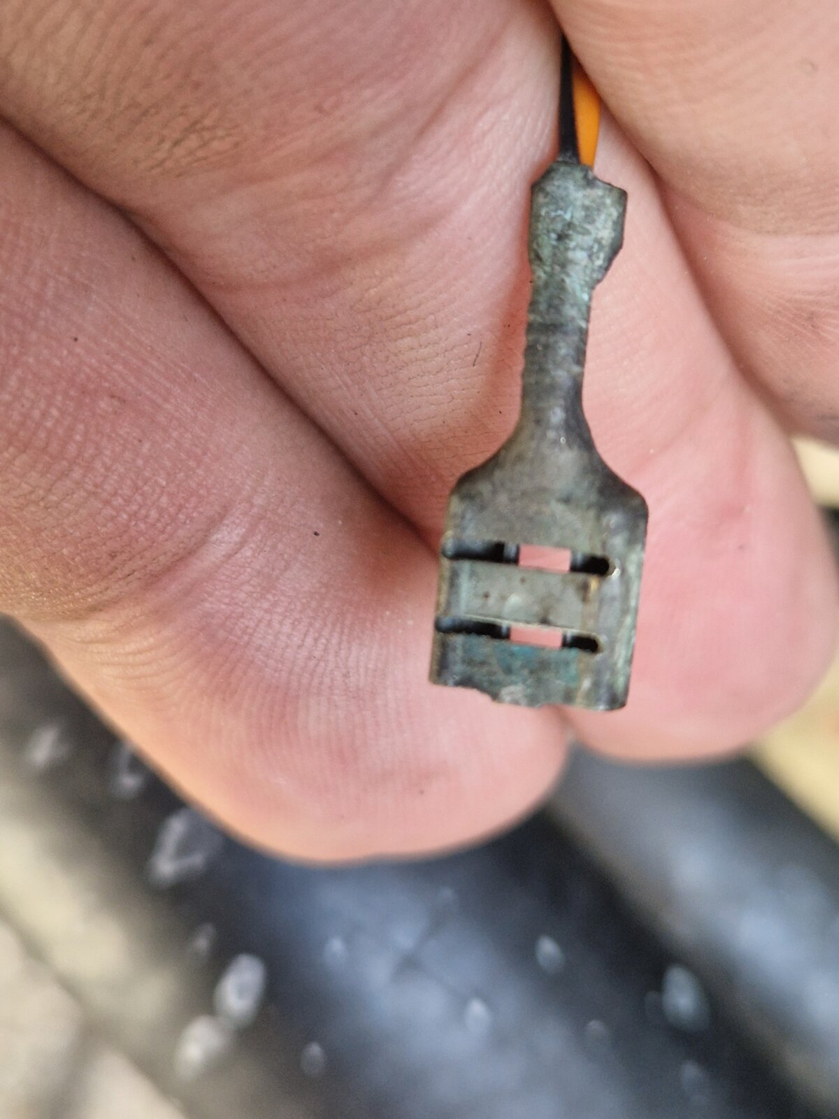

  20. Could this be a possible cause for the temp gauge fluctuation?
    Bit of corrosion on the terminal for the thermistor
    Just got to check my toolbox, see if I have any new terminal ends, so I can replace it
