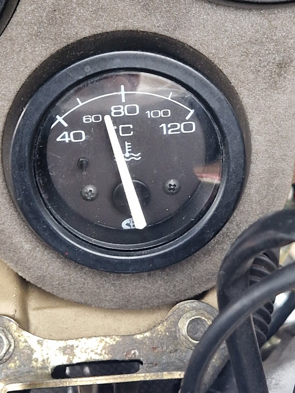

  1. Will change the resistance value for sure
  2. Managed to clean a bit of the outer surface, to ground it to the engine casing, temp gauge went slowly to max, it didn't move when trying to ground it to the frame though
    From what I have read, that shows the gauge is working correctly
    I have a new thermistor, and I will replace the connector, and report back

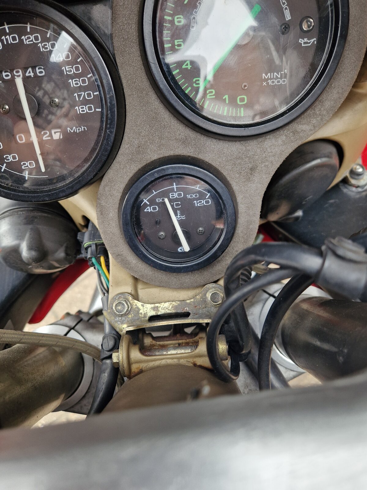

  3. 20 minute gentle ride, scenic route to the MoT, temp gauge sat at just over 50 whilst riding, raised a little when stopped

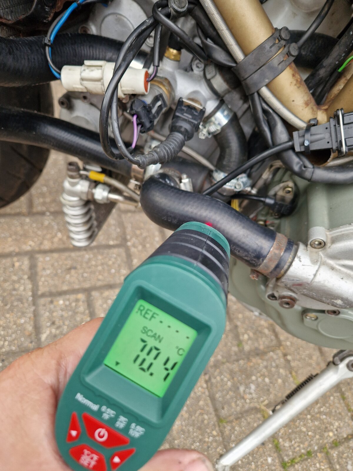

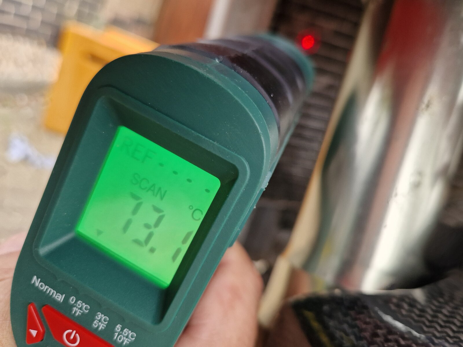

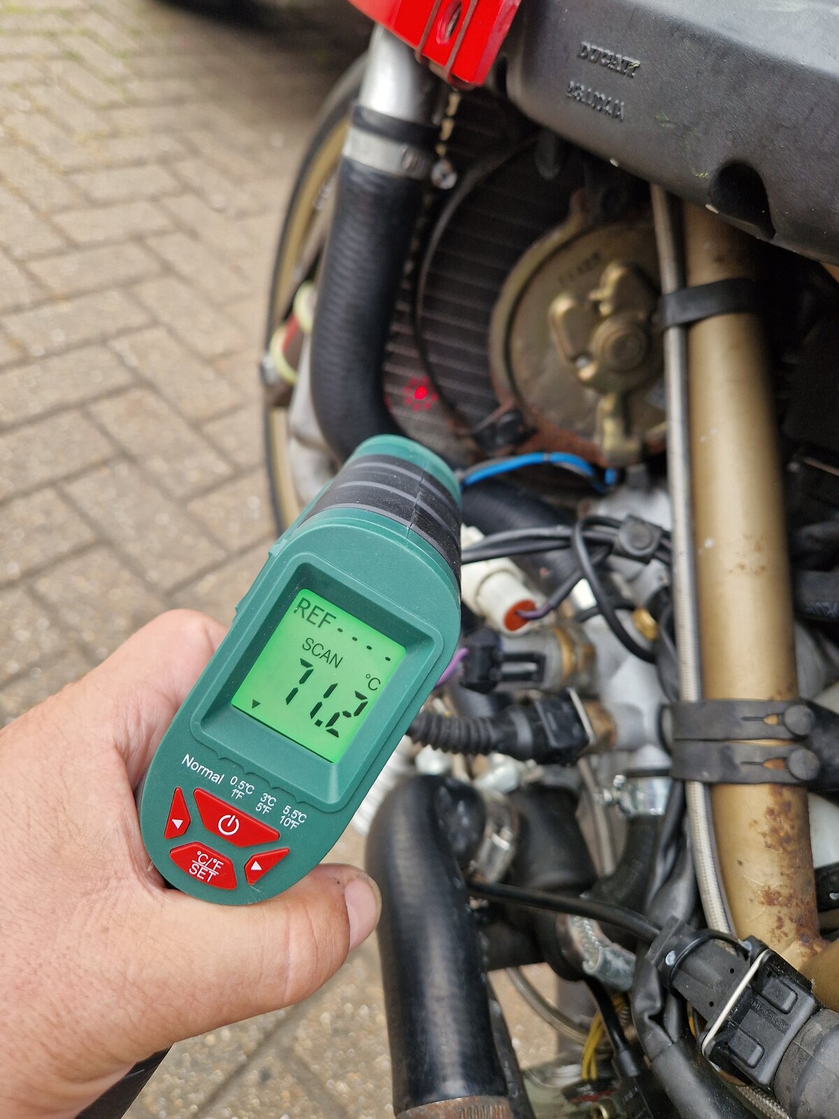

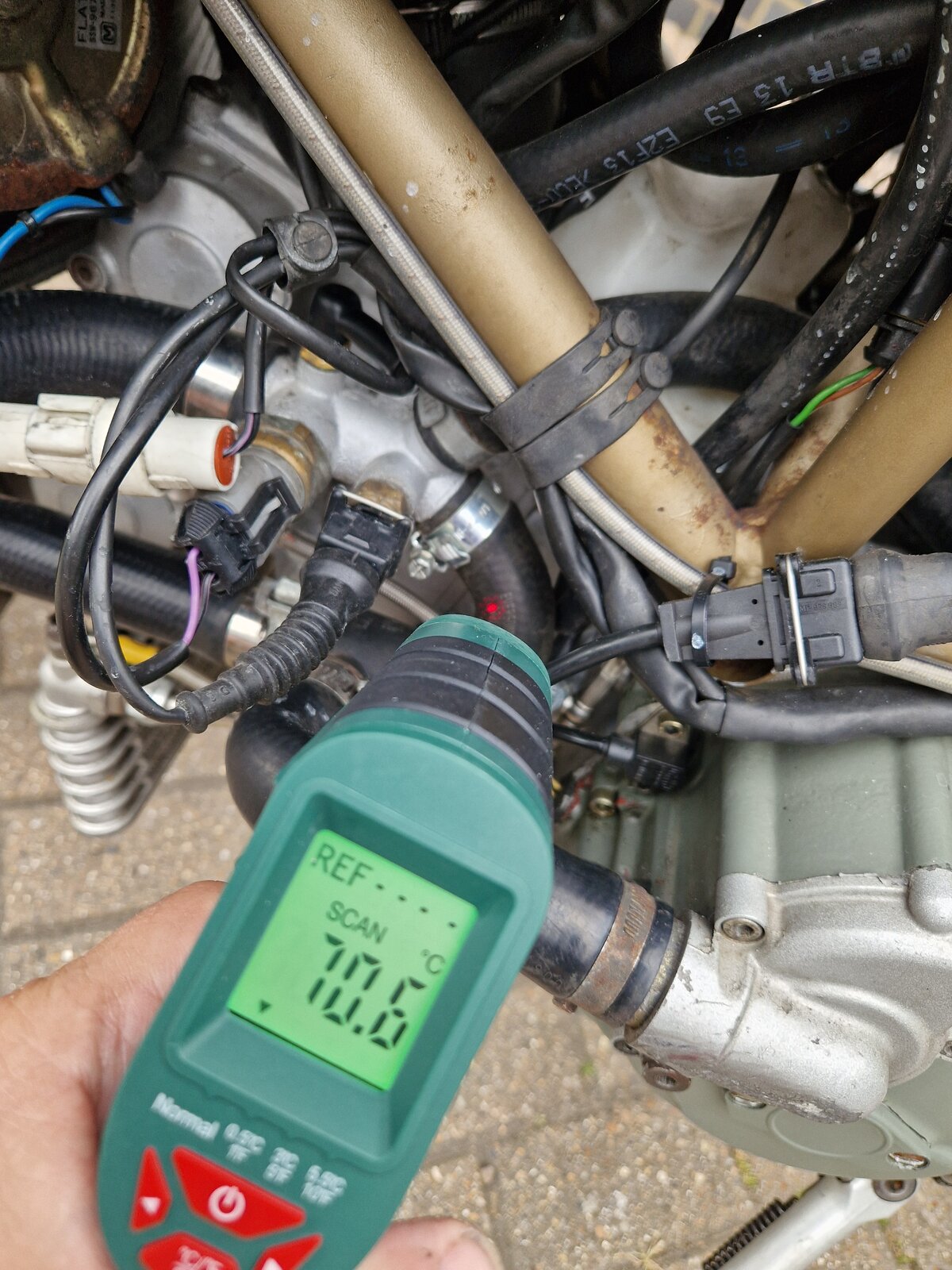

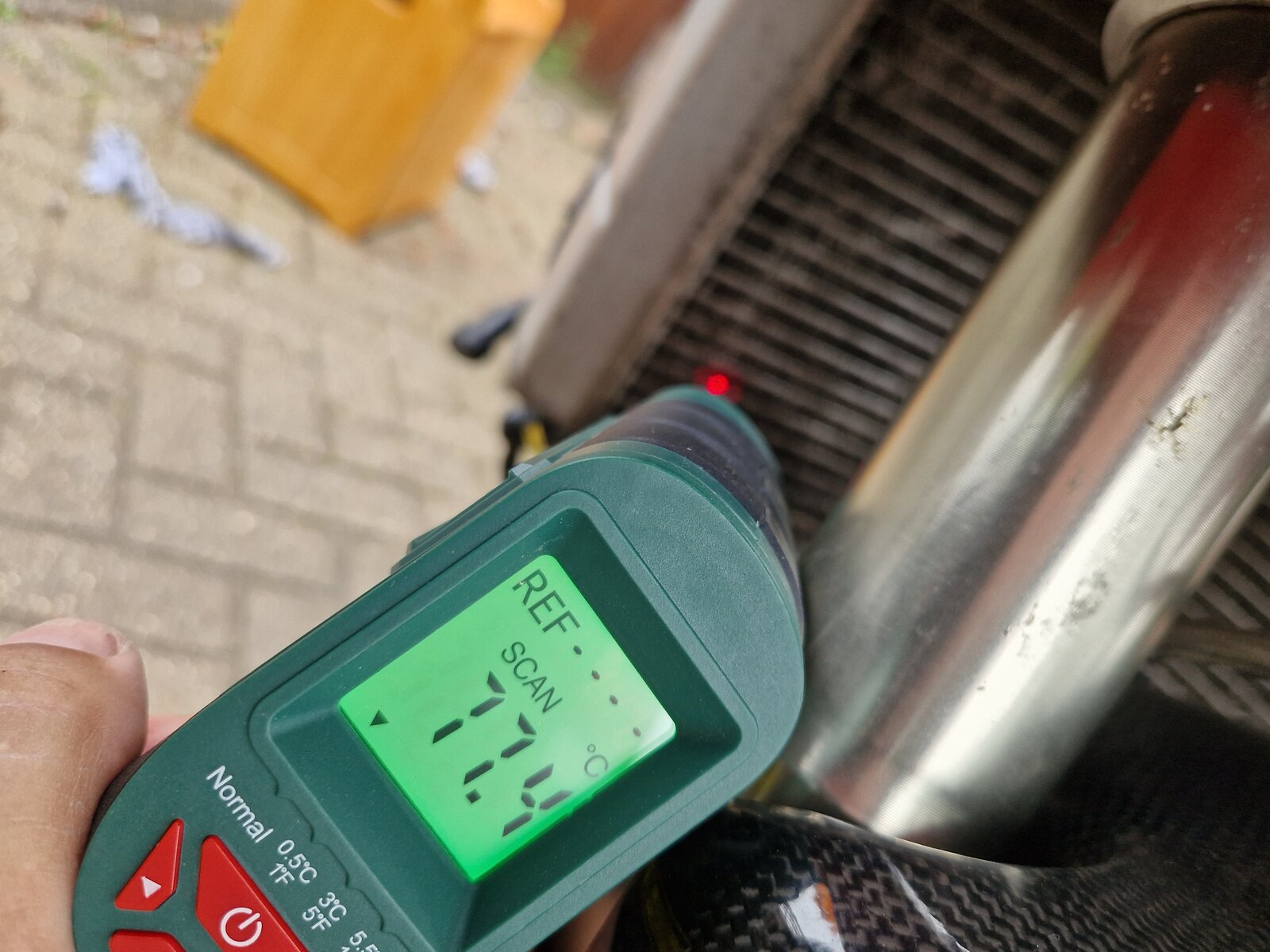

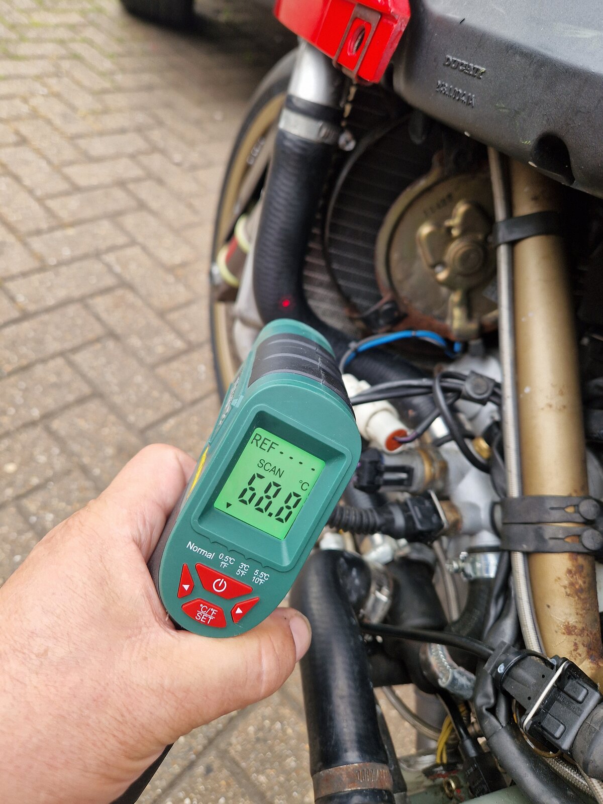

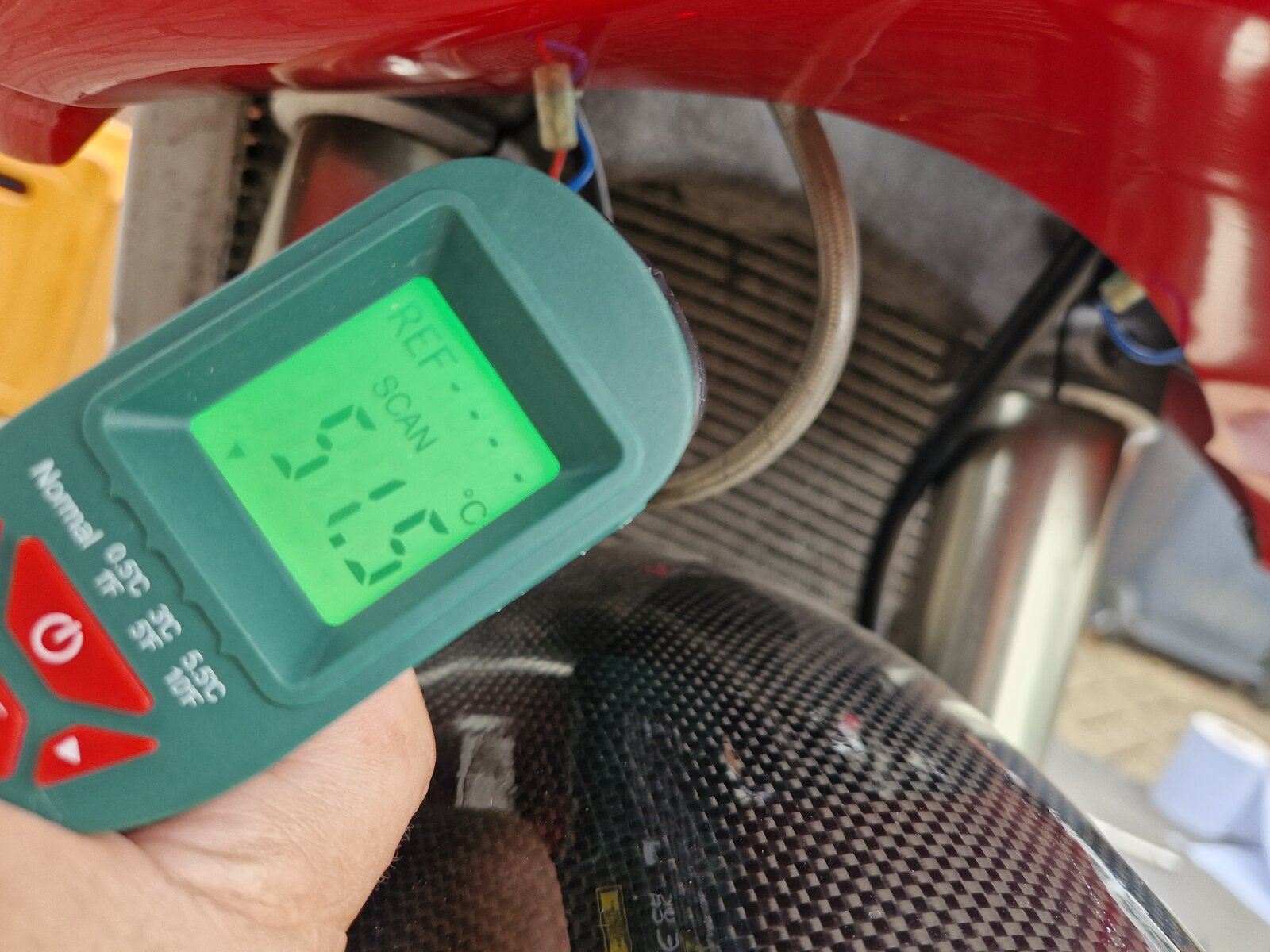

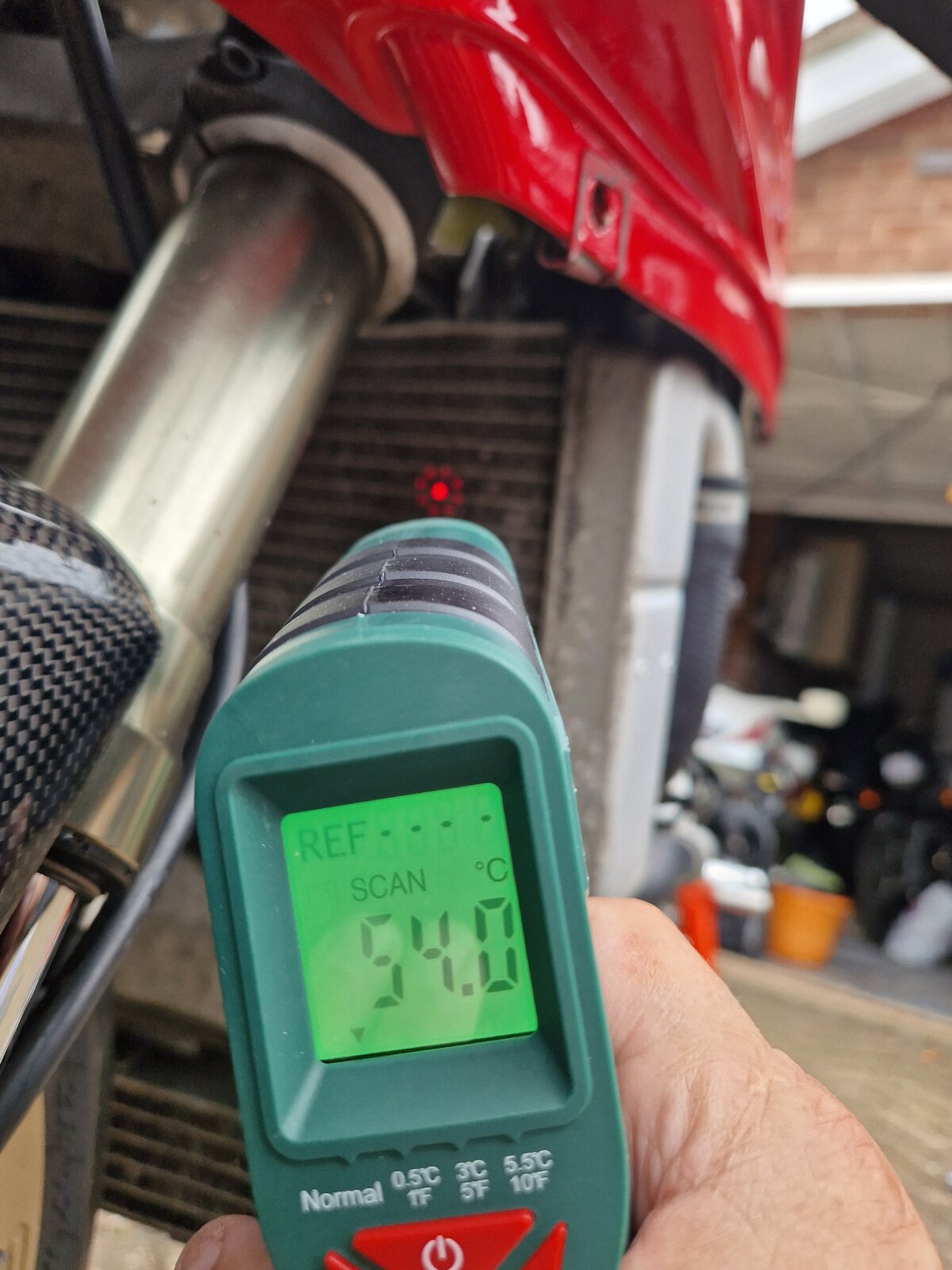

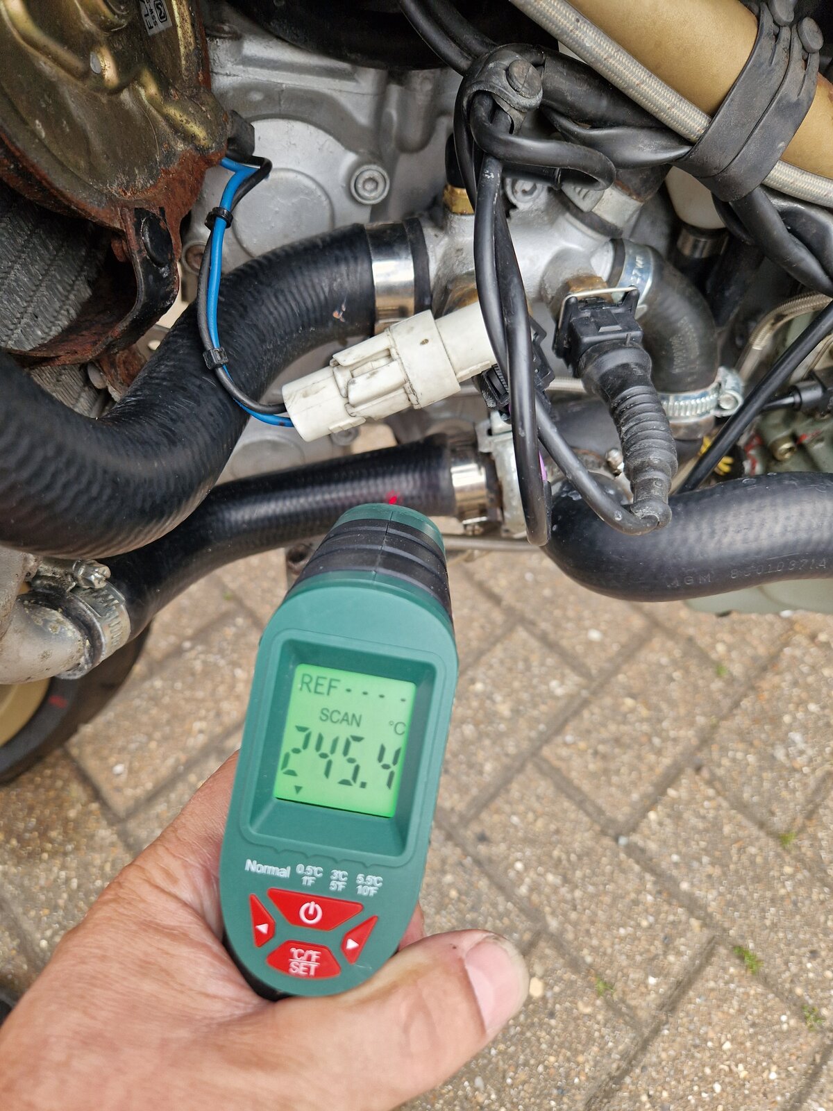

  4. Had another look at the temps when I got back from MoT today,
    After 20 minutes, no issues, took some temp readings from various locations with a digital temp gauge
    20240817_154648.jpg 20240817_154713.jpg 20240817_154717.jpg 20240817_154737.jpg 20240817_154746.jpg 20240817_154848.jpg 20240817_154904.jpg 20240817_154918.jpg 20240817_154929.jpg 20240817_155309.jpg

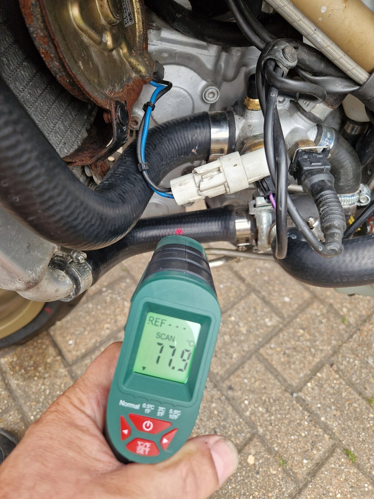

    After 30 minutes, it started hissing from the same place, between the expansion tank and the filler neck, temp reading normal as per pic above, but, some interesting readings on the digi gauge, first pic, close to thermostat, second pic, same pipe, about 2 inches further from thermostat, third pic, back close to thermostat

  8. 339.1deg c ? really ? is your temp gun a bit haywire
  9. It's probably susceptible to EM fields generated by the HT or alternator cables if held too close.

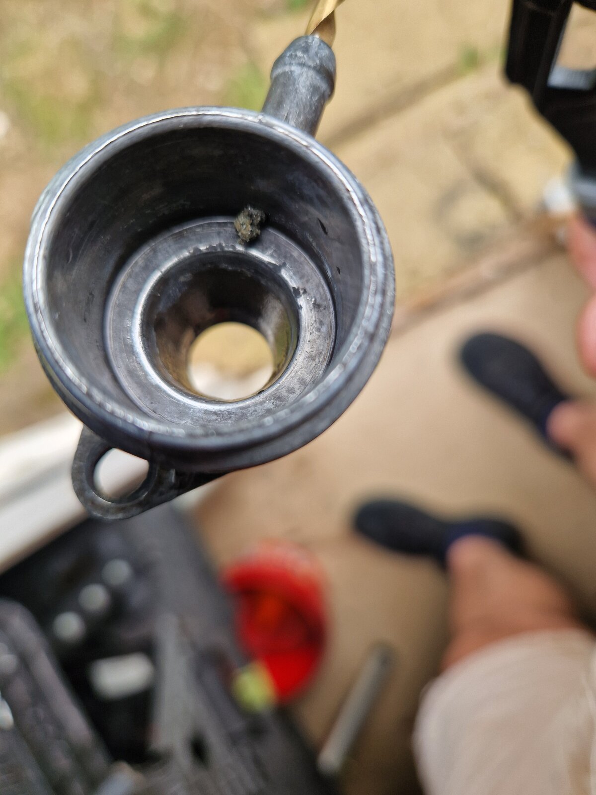

  10. Bit of an update, collected a new thermostat today from Ducati Coventry, whilst there, I was having a chat with the owner, Mr Hackett, I told him about the coolant issue, he suggested the thermostat, at which point, I showed him the new one I had just purchased, he asked about the radiator, which I told him what I had checked, he then suggested removing the hose from the filler neck that goes to the secondary expansion tank, and run a 4mm drill bit through the metal union on yhe filler neck, as that has been known to clog up
    I didn't think it looked that bad, until I put the drill bit through it, you can see the crap that came out
    Net result, I had the bike ticking over for over 45 minutes, with no issues
    Don't know whether it was the thermostat or the breather hose, or a combination of both, but, it appears to have cured it, fingers crossed

  11. I think you found it, and one of us should have come up with the above. Happens on 2valve SS fuel tank breather quite often due to age, resulting in bike cutting out etc.
    also kind of owner to pass this on rather than insist you book it in - i know of a Classic Car outfit in Norfolk who would definitely do this in the past.
